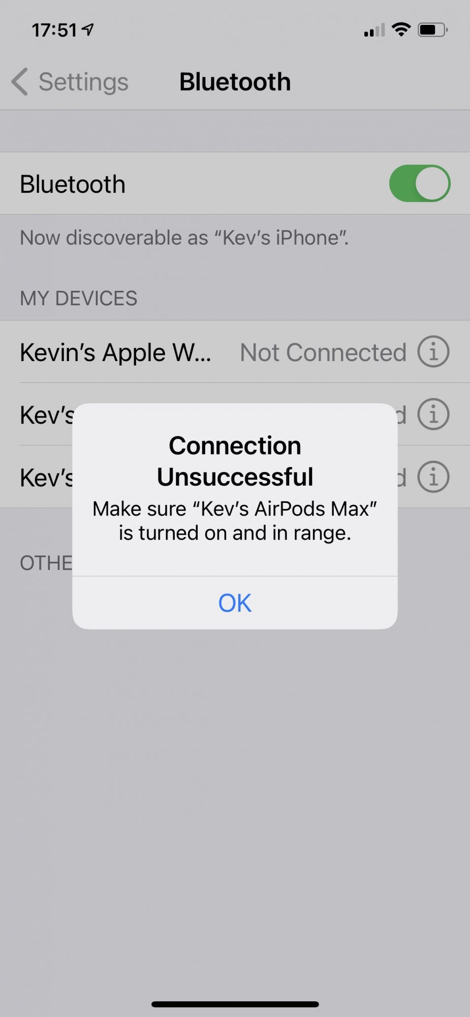

update - just checked and it’s dropped 2% in 9 hours and I can confirm that the headphones definitely go into deep sleep mode because i tried to connect them via my phone and got the message below. I have to take them out of the case to wake them up so they are definitely going to sleep in the case when disconnected from my phone

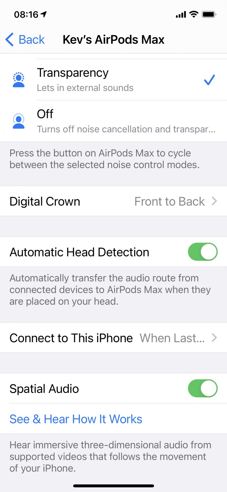

How are you disabling automatic switching ?
  • Connect your AirPods to the iPhone.
  • Open Settings.
  • Tap Bluetooth.
  • Find your AirPods in the connected devices list and press the small (i) button on the right of the row.
  • Tap ‘Connect to this iPhone’ setting.
  • Change the setting from ‘Automatically’ to ‘When Last Connected to This iPhone’.
Make sure you have done this on your other iOS devices as well.
It means it will only connect to that device if it was the last device you connected with
Exactly and if the headphones are in sleep mode, you may have to manually connect it. This means that the headphones has gone into low power mode Which is what should happen. This is working well for me as my battery is only losing between .25%and .33% per hour.
