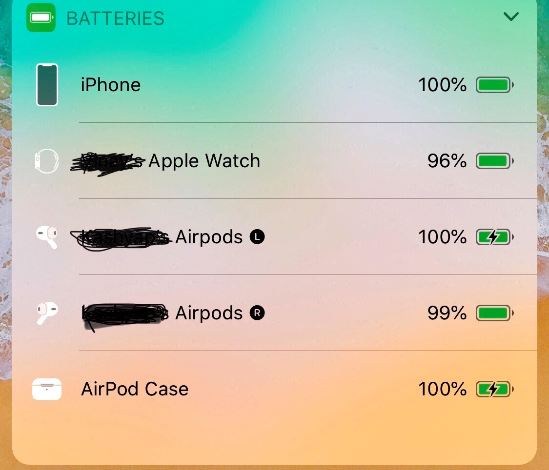

Hello all,
Weird thing just happened to me.
I was listening to some podcasts, watching YouTube videos, listening some music, etc. for some time with both AirPods.
When I put them back into the case I noticed the following:
Is this normal? I don't see a reason why my Right AirPod is drastically with lower battery level.

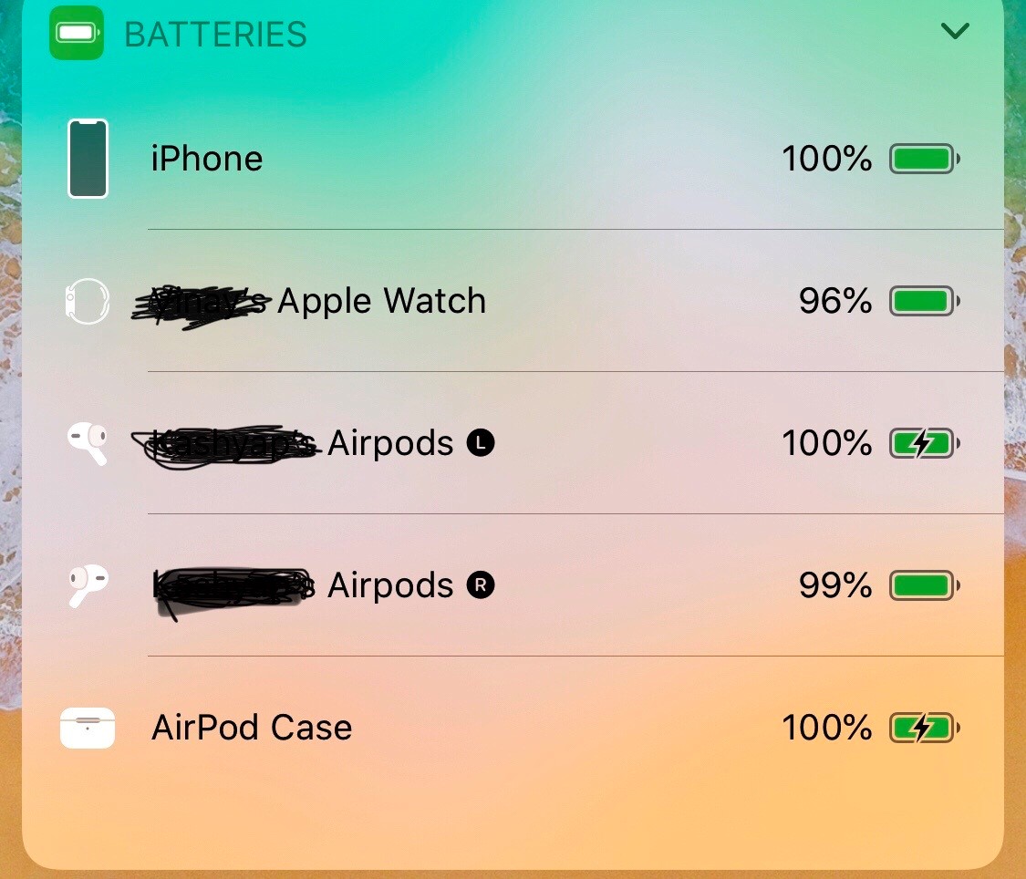

Also another thing that I have noticed is that when they are fully charged 100% (overnight charging) as soon as I take the right one the battery immediately drops down to 99%. With the Left AirPod that isn't the case.

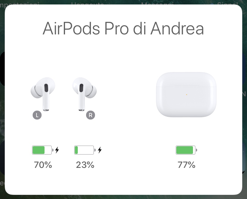

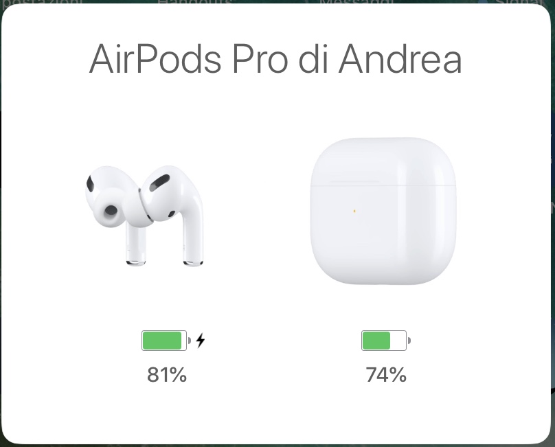

Hello folks, I'm having a similar issue and and I'm trying to conduct some tests.
Reading your messages, none of you have specified a very fundamental piece of information: are you using NOISE CANCELLING or not? Because it matters. A lot. NC feature is not "magic", it uses a microphone placed on the external part of the Airpods Pro to detect any noise/sound so that it can be "countered" by the chip.
From the tests I've done so far, when I use the Airpods with my Mac, I normally use the Mac microphone. I can do a 1 hour call, no NC activated and after 1 hour the battery difference is 1% or even none.
Yesterday evening I was listening to Spotify (so in theory no NC involved) with NC activated and when I placed my Airpods in the case one was 14% battery left and the other one was 43%.
It's possible that with NC activated the Airpods don't need to use both microphones (it would just consume double battery) but they pick one and stick with it for "a while". What Apple could surely improve is the algorithm that switches between the two microphones.
I will keep you updated when I discover more about this.
Update: I listened to Spotify (on my iPhone) for a few minutes, with NC off. When I put the Airpods in the case they were both 85% battery left.
Now I'm going to recharge them and then I will listen again to some music but with NC on this time.
Update 2: I listened to Spotify for ~30 minutes with NC on. When I put the Airpods in the case they were both 88% battery left 🤔 I have a suspect now, but I want to verify it before saying anything.

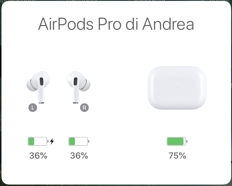

Update 4: my opinion is that battery widget is completely bugged and doesn’t reflect the real battery status.
Yesterday evening I put my Airpods away before going to bed and there was over 40% difference between the left and the right (I had not used any noise cancelling). After 6-7 minutes in the case they were both at 36% and after another 3 minutes they were at 81%
Reactions: Nietzking
Ok, so from the above tests, yet again, it proves that when faced with a discrepancy in battery levels between the L & R Pods, the higher reading is the accurate one.
In the above example, they were both at 70%, & after 10 minutes of charge, they were 81%.
