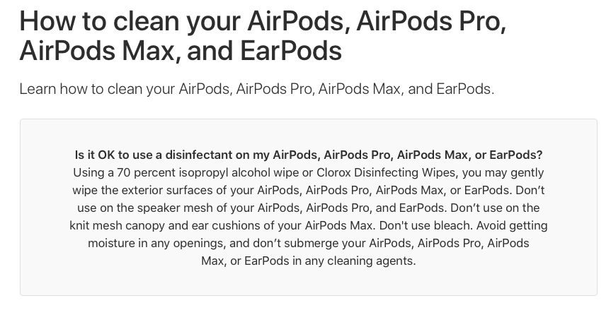

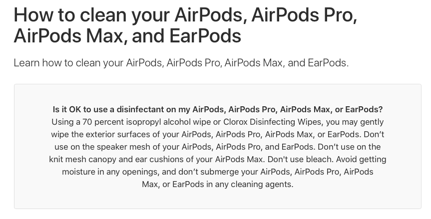

No they dont. They only suggest using alcohol on the charging case (See below for AirPods Pro directions, from Apple's site).
This screenshot is from the top of the support document found here: https://support.apple.com/en-us/HT208729.
vinegarshots
macrumors 6502a
Sep 24, 2018
982
1,349
Yeah, those are pandemic specific guidelines for "disinfectant" purposes. You're also not supposed to use alcohol on your iPhone because it damages the oleophobic coating on the screen, but they changed the guidelines on that, too, just to help reduce germs. Anyway, there's no point in arguing with me over this point-- AirPods Pro are using an established technology that has proven points of failure (Apple didn't use any of their "magic" on that...which is partly why there are so many issues with them). Use alcohol, and your risk of screwing them up increases, simple as that.
Also, pay attention to the part that reads "Avoid getting moisture in any openings"
That's their way of saying, "if you break it, it's your fault." :eek:

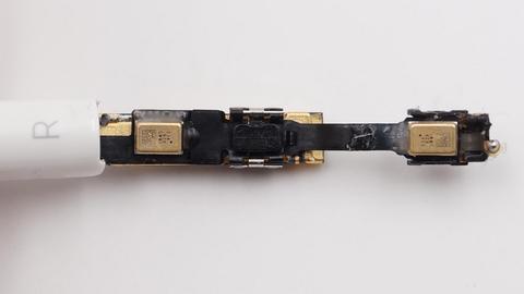

Seeing iFixIt tear down pictures I don’t think the AirPods pro microphones are the way you’re thinking and I never told anyone to soak them on alcohol, a cotton swab soaked is enough. Anyway I’m done talking to you. Apple clearly states it is a product you can use and if it was that dangerous for the outsides meshes they would state it like they mention speaker mesh. I’ll keep doing it and if it ever causes problems I’ll post here.
iFixit is a garbage teardown that doesn't show anything.
This is from a different site's teardown-- the two gold rectangles are the microphones. The opposite side that you can't see in this photo has a hole in each of them that faces the exterior mesh.
As long as you follow their directions and use an alcohol wipe (not a swab) to quickly wipe the outside, you probably won't get enough alcohol to seep through the mesh to get inside the mics. But it wouldn't be hard to use too much if you're using a an alcohol swab or a cotton ball, etc, instead.
You just can't underestimate how flimsy these things are. I managed to break two sets of mine. One by blowing into the mesh trying to clean it with air, and another set by sneezing too loudly when they were in my ears. (simple air pressure changes, if drastic enough, is enough to blow out these mics, too)
