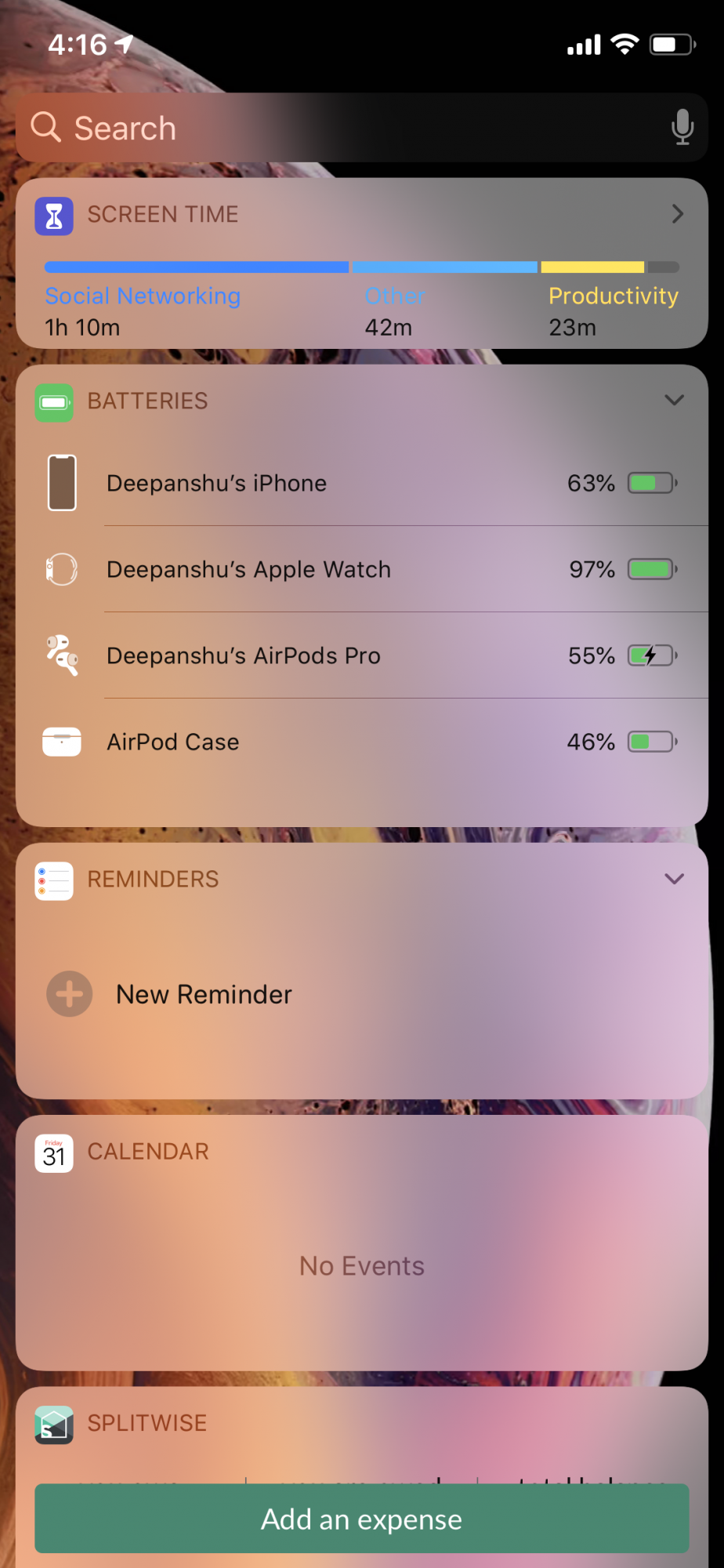

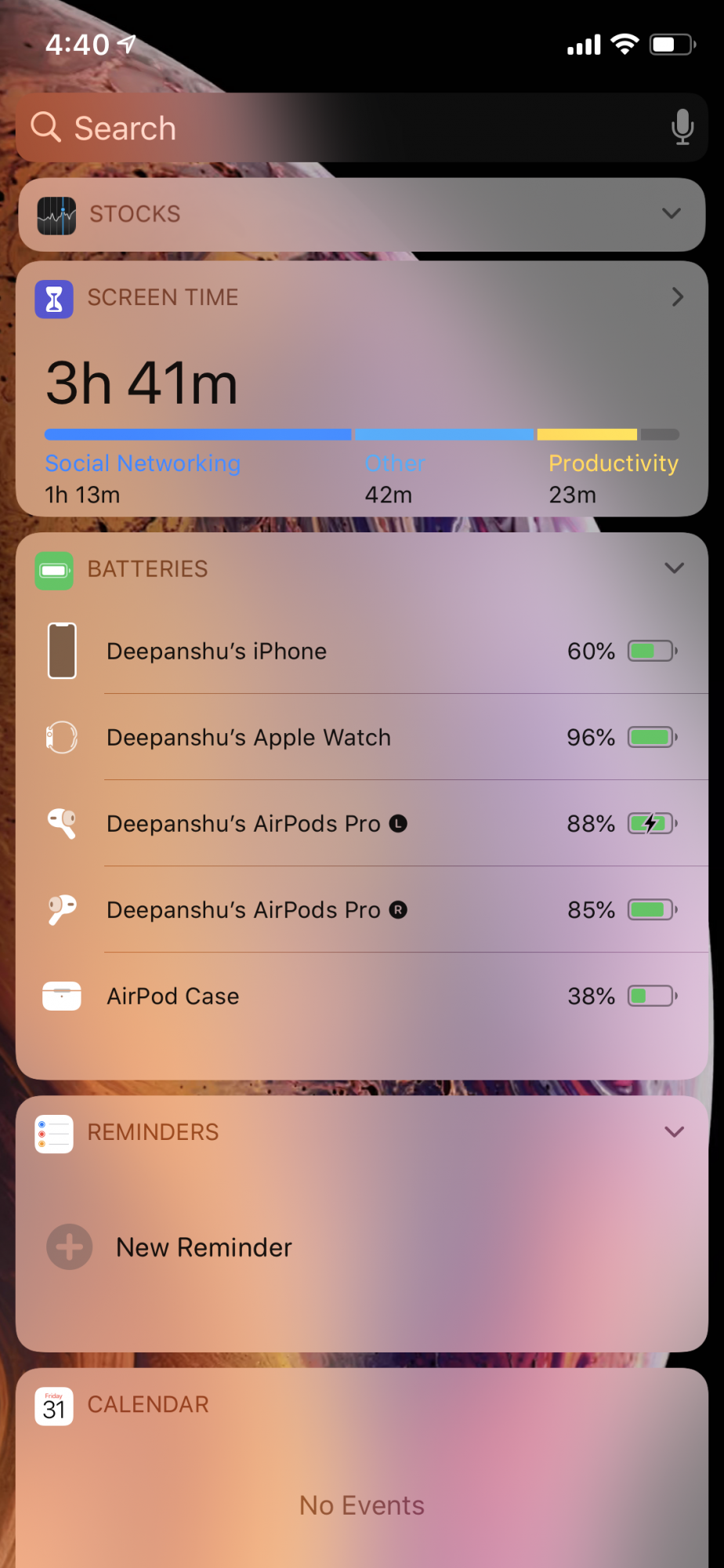

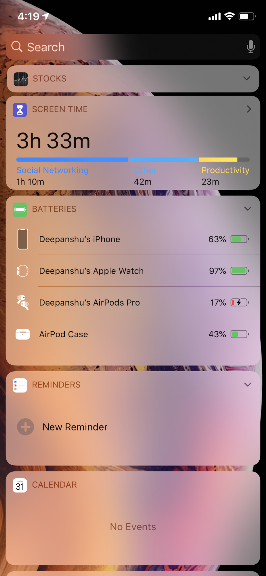

Hi,
I started my call when my battery was at 100%, after a call of one and a half hour airpods battery reached 55%. I put them into the case for charging. And opened the case after 2 minutes, suddenly charge was at 17%. Some software bug or a hardware issue? Attached images.
Hi,
I started my call when my battery was at 100%, after a call of one and a half hour airpods battery reached 55%. I put them into the case for charging. And opened the case after 2 minutes, suddenly charge was at 17%. Some software bug or a hardware issue? Attached images.View attachment 939370View attachment 939371View attachment 939369
Think it’s a software issue where if you close the case it reads the battery percentage wrong and that’s why it’s goes down so low when the battery is actually still at what it was before putting in case.
