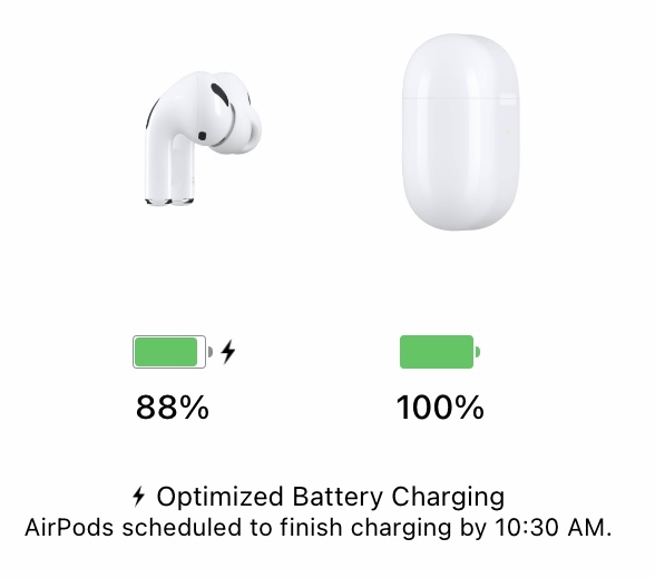

I made a seperate post on this, but maybe ‘optimized charging’ is causing the phantom drain, never noticed this before
I don't know but I have had it fixed since updating to IOS 14.5 and updating my AirPods Pro to 3E751 so if still having issues go to Apple as should be fixed
