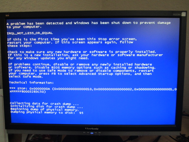

You are correct. I currently have the Vcore set to 1.36250V and it kicked it for 43 min into the OCCT test and then QUACKED on me. So now I'm up to 1.37500V. We'll see if this will work. If not then I'll notch it by 2 more and go from there. I'm trying to stay as low on the Vcore as I can go as I remember Tutor saying that not even he goes beyond 1.35 as he knows the risk of frying the CPUs is there if you go beyond that point.
1) If 1.40 in my Vcore works, would that be what I would use in my permanent Vcore settings if thats the only Voltage that does work, and is that safe?
2) Prior to this test I had the Vcore set at 1.35625V and it BSOD on me. Here's the pic. I was able to get it in the nick of time as I would have missed it had I not turned my head at the right time. It happened so fast, but I got it. What does this screen tell you?

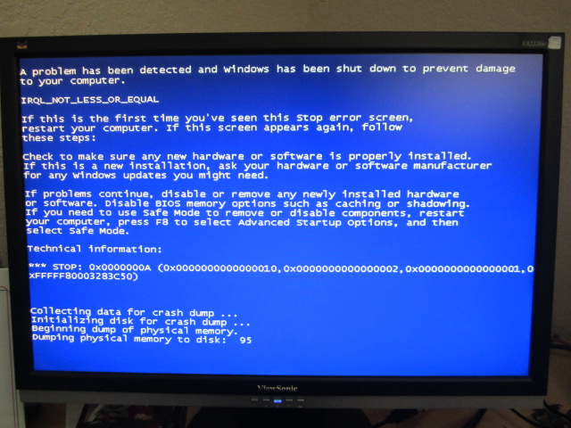

Near bottom, there are several numbers in Hex....The first one is the key, 0x0A indicates unstable memory controller, suggested fix for this is either to increase VTT or VCore if that doesn't work.
You'll see lots of people pushing VCore higher, you may not need to go quite so high because you are underclocking, and that is one of the touted benefits. I suspect that to get his very highest overclocks, Tutor had to turn up Vcore beyond 1.35, but only he can answer that directly. High VCores theoretically shorten life of the chip, but it depends on how good your cooling is as well. Yours are under water, so you should be running substantially cooler. I know for a fact that my overclocked chips run 10 to 15 C Cooler than my chips in my real Mac Pro run. Even 1.45 is very commonly deployed. At a notch below 1.45 my chips idle at 29-30 Celsius (ambient is 26) and IntelBurnTest at 58-72 Celsius (depending if in socket 1 or 2). For everyday use running my simulations, max temps are around 55-60 Celsius.
Thanks for that bit of education on the BSOD stuff. Man, you really have to be sitting in front of the screen to take that pic, because if you miss that info for more than 5 to 10 seconds, you're SOL and the next thing you know, you're system reboots. Now I'm sitting next to my system (using another one), but my back is to it, because I'm working and don't have time to sit and watch everything. I was just fortunate enough to catch it as I was turning around to check the screen and my camera was within reach. Is there a way to get that to info another way if I miss the BSOD when it happens (since there's a 10 sec window of opportunity)?

Command Rate - 1
But this time I entered Vcore - 1.39375 and it still FF'd on me. Then I tried yesterday's settings before it failed (after an 1hr 13min of OCCT TT'ing). That Vcore setting was: 1.3875. It still FF'd on me. Then I went back to Vcore 1.325 and still FF'd. Then just entered in the default and it started. For some reason it won't let me even try now, don't know why. I even disconnected everything (including the battery) and cleared CMOS, waited over 5 min., then reconnected everything and still the same problem... FF. So I don't know what to do at this point... 😕 Any thoughts? Thanks...
To still get my high scores, I have to do what I did to get them the first time. But I repeat, "Don't go over 1.35 Vcore unless YOU are willing to fully except all of the consequences." That's my disclaimer. My current settings are task based and, thus, vary based on my needs. If the task is light, I set my CPU 0 voltage low, e.g., ~ 1.25V + ~ 157 bclk; if it's moderate, e.g., ~ 1.28V + ~ 163 bclk; if it's high, e.g., ~1.34V + ~ 167 - 173 bclk; if all hell has broken lose, e.g., ~ 1.4V + ~ 183 bclk; and if its the end of time or I've had too much wine, the sky's the limit. But that's just the way I roll the dice.
Great, now I have a better idea of what you're talking about with your settings. Thanks...
BTW - That computer in the pic you last posted here is not mine! Mine also has fans underneath.
Again, I was just messin'... 😛
The only time I've hit FF recently is because the first signal tweak, IOH QPI 0 Signal, was set too negative. Right now, if I go below -76, I get FF.
Well, I'm at -75. I went down by 10 to -65 and nothing, then -55 and then -50 and it finally started. I have everything set as I did before. This time my Vcore is now 1.40V. We'll see if this passes the 2 hours OCCT TT.
BTW, what does putting the IOH QPI 0 at -XX do for the system? Thanks...
well, I'm at -75. So Should I try -70 or a bit higher like -60? Let me know, thanks...
Yeah, try -60 and see if that helps. I just found what the lowest was that I could hit by changing it by 1, rebooting, seeing if I got FF, and repeating. It will probably change if I change voltages or anything...
