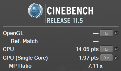

Not! For OGL performance in Cinebench 11.5, my overclocked 4890s score about forty (40) fps higher per test than my overclocked Galaxy 680s and about ten (10) fps higher per test than my overclocked EVGA GTX690. Thus, since it appears that Nvidia and ATI cards excel at different functions I'm going to put one of each of them in my WolfPacks, other than WolfPackPrime0.

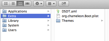

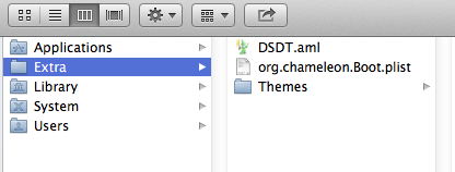

Well, I just did updated my SR-2 to 10.8.2 and wanted you to check out my Extra folder; pretty stremlined huh? 🙂 Also, had my EVGA 580 GTX 3GB GPU optimized to have CUDA, Mercury and Fermi work at their optimal level and tried that OpenGL app link that you provided. Let me know what you think... Later... 😎

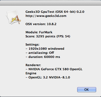

Much so.

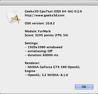

Excellent performance.

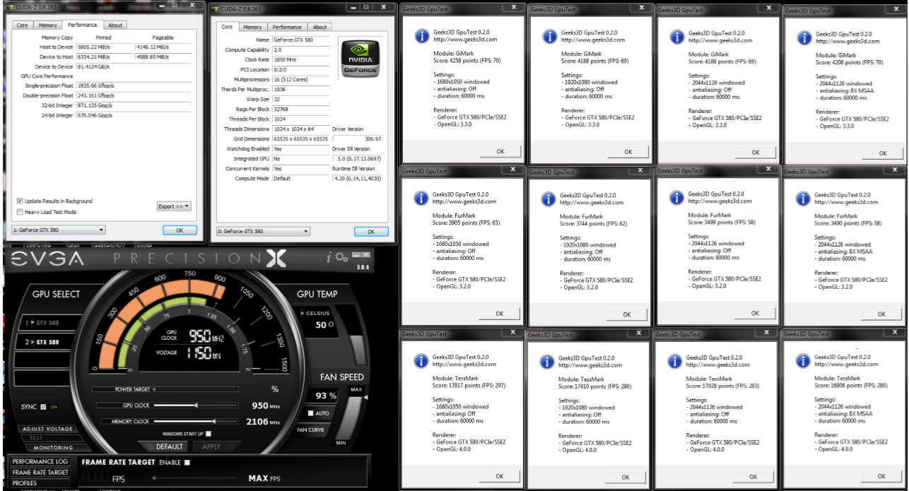

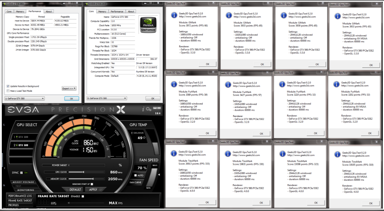

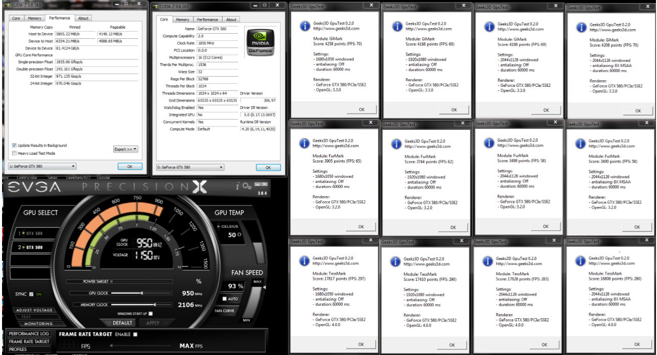

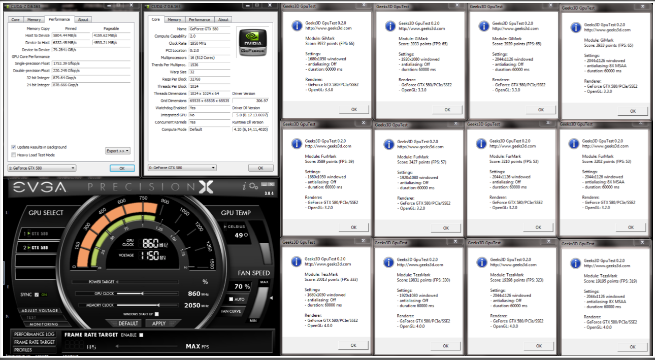

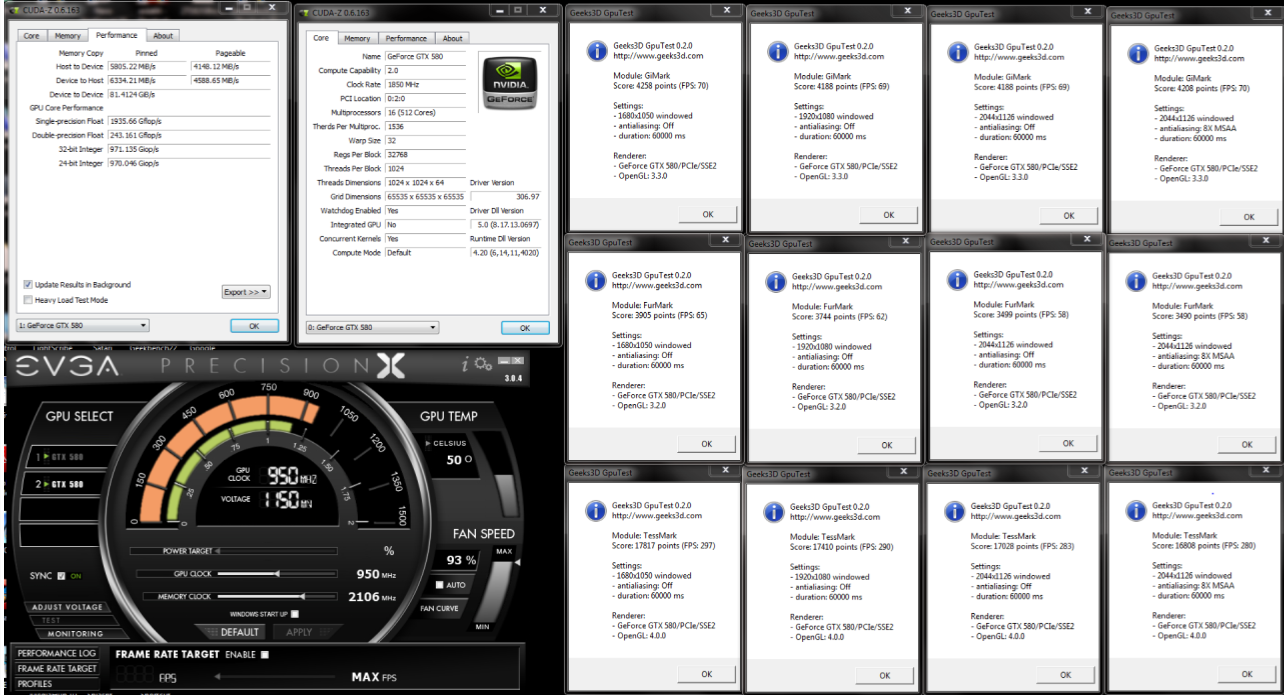

Tweaking the GTX 580 GPU for Maximum, Safe Rendering Performance in Octane
Software Tools Used
(1) CUDA-Z-0.6.163 - used to measure CUDA performance and other GPU related parameters [ http://cuda-z.sourceforge.net/ ],
(2) GpuTest_GUI - used to benchmark certain GPU functions and ensure GPU stability [ http://www.geeks3d.com/20121113/gpu...gl-benchmark-furmark-lands-on-linux-and-os-x/ ],
(3) EVGA Precision X - used to over- and under-clock the GPU and affect a variety of the GPU's other settings [ http://www.evga.com/precision/ ],
(4) CINEBENCH 11.5 - Used to measure CPU and OGL performance and tune CPU and GPU for maximum performance [ http://www.maxon.net/products/cinebench/overview.html ],
(5) Geekbench 2 - Used to measure CPU and memory performance and tune CPU and memory for maximum performance [ http://www.primatelabs.com/geekbench/ ], and
(5) Octane Demo - used for GPU/CUDA based rendering [ http://render.otoy.com/downloads.php ]
Octane is owned by Otoy. Octane is a CUDA-based rendering solution that relies solely on the CUDA capabilities in Nvidia-based video cards. As such it is probably the fastest rendering solution now on the market. Since it uses only the GPU, the user can use his/her system's CPU(s) to performance any other tasks just as if Octane were not rendering away. But because Octane will max out one or more GPUs capabilities while its rendering, Otoy recommends that the user have another video card installed for interactivity and for doing other CPU bound tasks while Octane is doing its thing. At last, those GT 120's have a task made for their continued use. My MSI (aka WolfPack5) uses a GT 640 4-gig for interactivity and CPU bound tasks.
Octane has been in beta for a few years. Octane Render 1.0 Final was released last month. There are a variety of 3d packages for which some of the Octane forum members have created exporters. There are plug-ins in the works: there are betas for Maya and Poser and a finished version for 3d Max. For other 3d apps the plug-ins are in various pre-beta stages.
Rendering an animation in Otoy's Octane has two phases. The first phase involves perfecting the scene's look such as the lighting, materials/textures, camera(s) and object placement [ http://render.otoy.com/videos.php ]. This phase is much harder on the animator than it is on the system. The second phase involves the initiation of the renderer. This phase is very easy on the animator, but heavily taxes the GPU(s). During the first phase, I was able to overclock my two GTX 580s in my MSI 6-core Sandy Bridge 3930k system (total system cost, including 2 GTX 580s, under $2.25k), by about 6%, setting the the fans to run at 93% to keep the temperature at or below 50 degrees C. Since my CPU is overclocked to run at 4.13 GHz (non-turbo) and at 4.901 GHz (turbo), I set my GPUs' temperature max to 50 to avoid even the hint of any thermal issues. During the second phase, I underclocked my two GTX 580s by about 5%, setting the the fans to run at 70% to keep the temperature at or below 50 degrees C during render times of, at least, 3 hrs.
The first pic shows settings relevant to the first phase, related benchmarks and that all important small increase in CUDA capability to enhance interactivity. The second pic shows settings relevant to the second phase, related benchmarks and that all important small decrease in CUDA capability to keep everything cool. The third and fourth pics show CPU performance tests made while Octane was rendering. The last pic shows how the system benches under OSX.

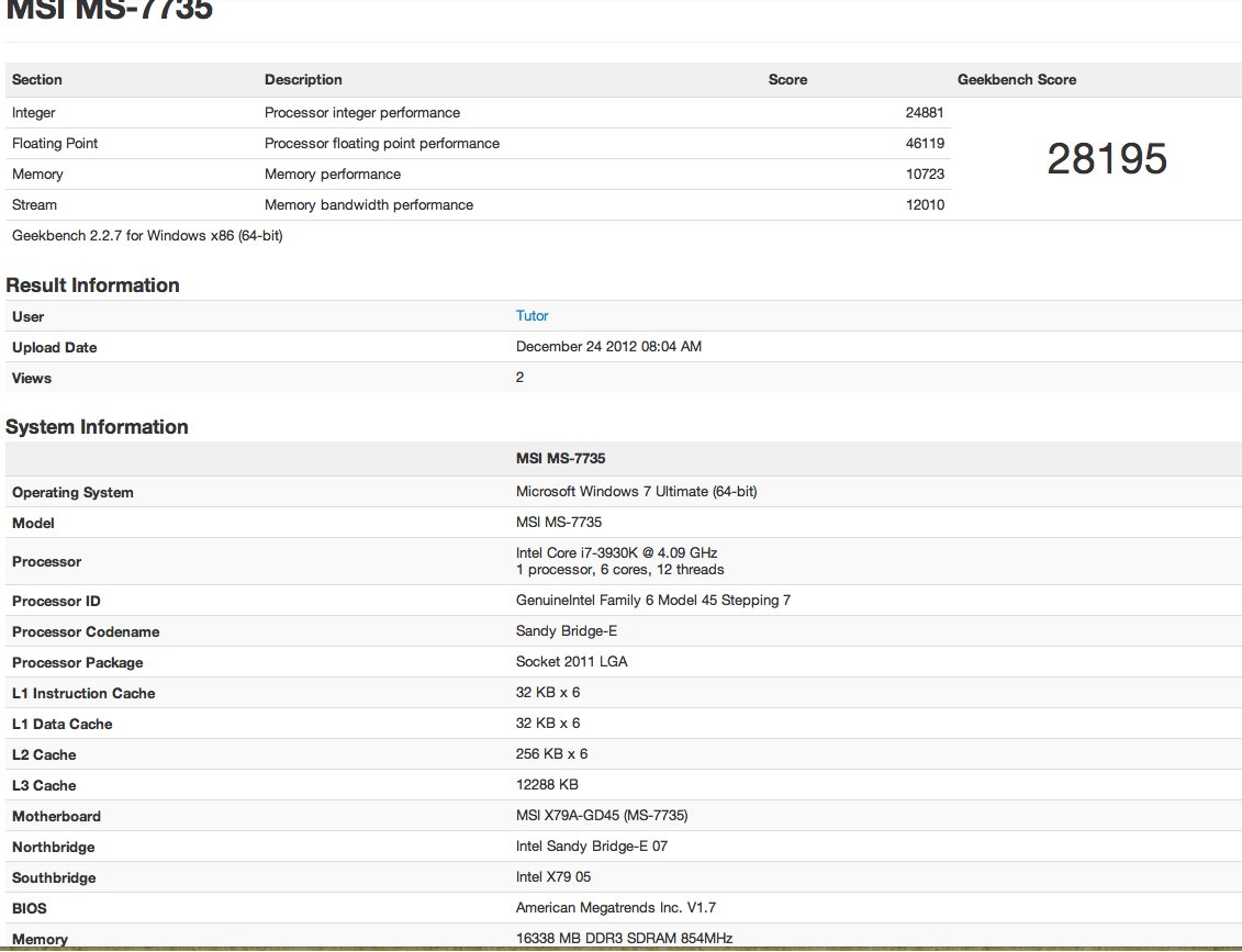

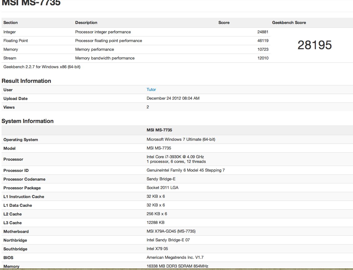

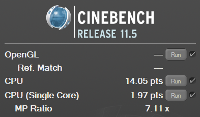

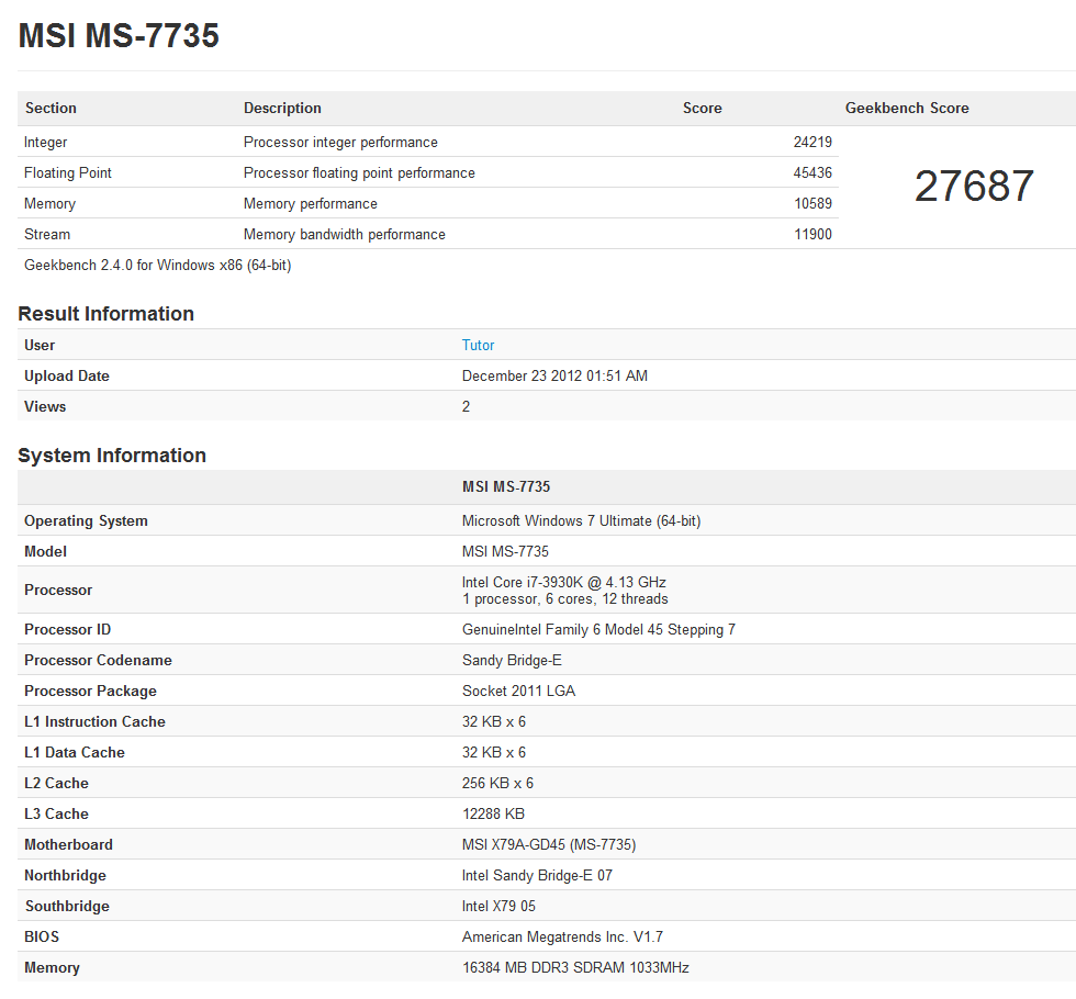

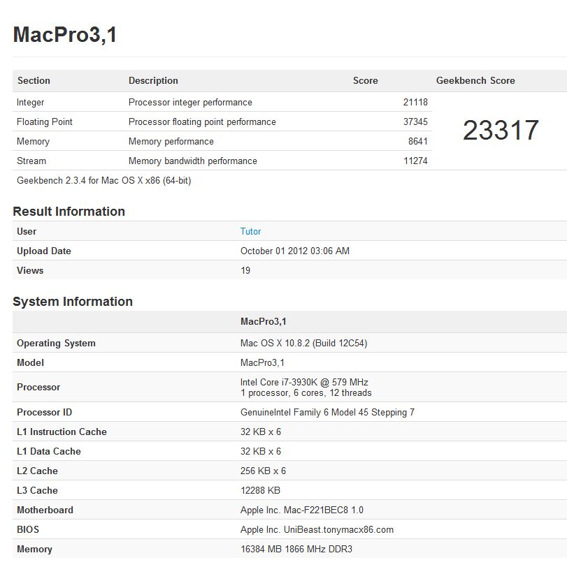

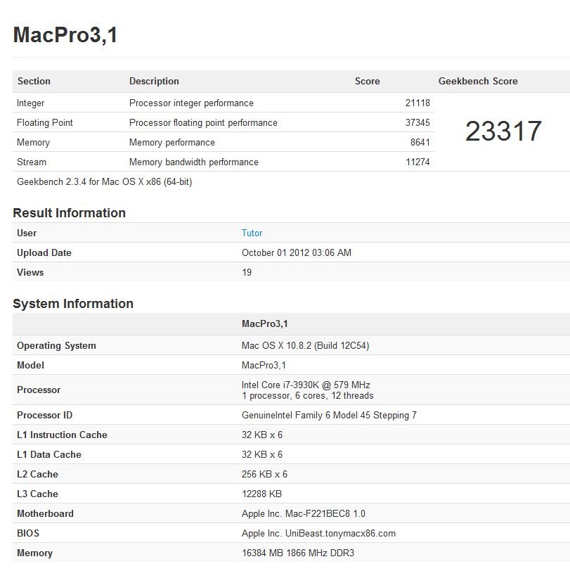

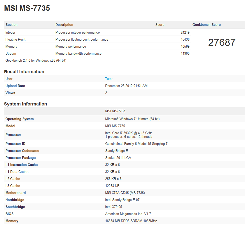

Good job Tutor. My thing though, how was your GB score when OC'ing in Mac OS X 10.8.2? Also I see that you were able to to get the CPU@579MHz. If I'm not mistaken it appears that you were able to UC it, how? Especially since (from what you mentioned before) you cannot UC in 10.8.2...
That 5th pic shows the GB score for ML 10.8.2.
Nope. Just how Geekbench 2 erroneously read it when it was overclocked to 4.13 GHz. I can still get it to turbo 5 bins, but only 5 bins.
I can underclock it. I just can't get it to increase the bins from idle to turbo. So - so far underclocking it just makes it slower. Underclocking won't be advantageous until I can figure out how to get it to turbo more than 5 bins above the underclock or MSI changes the bios to give me a working CPU strap higher than the current 1.67 CPU base strap that doesn't even work.

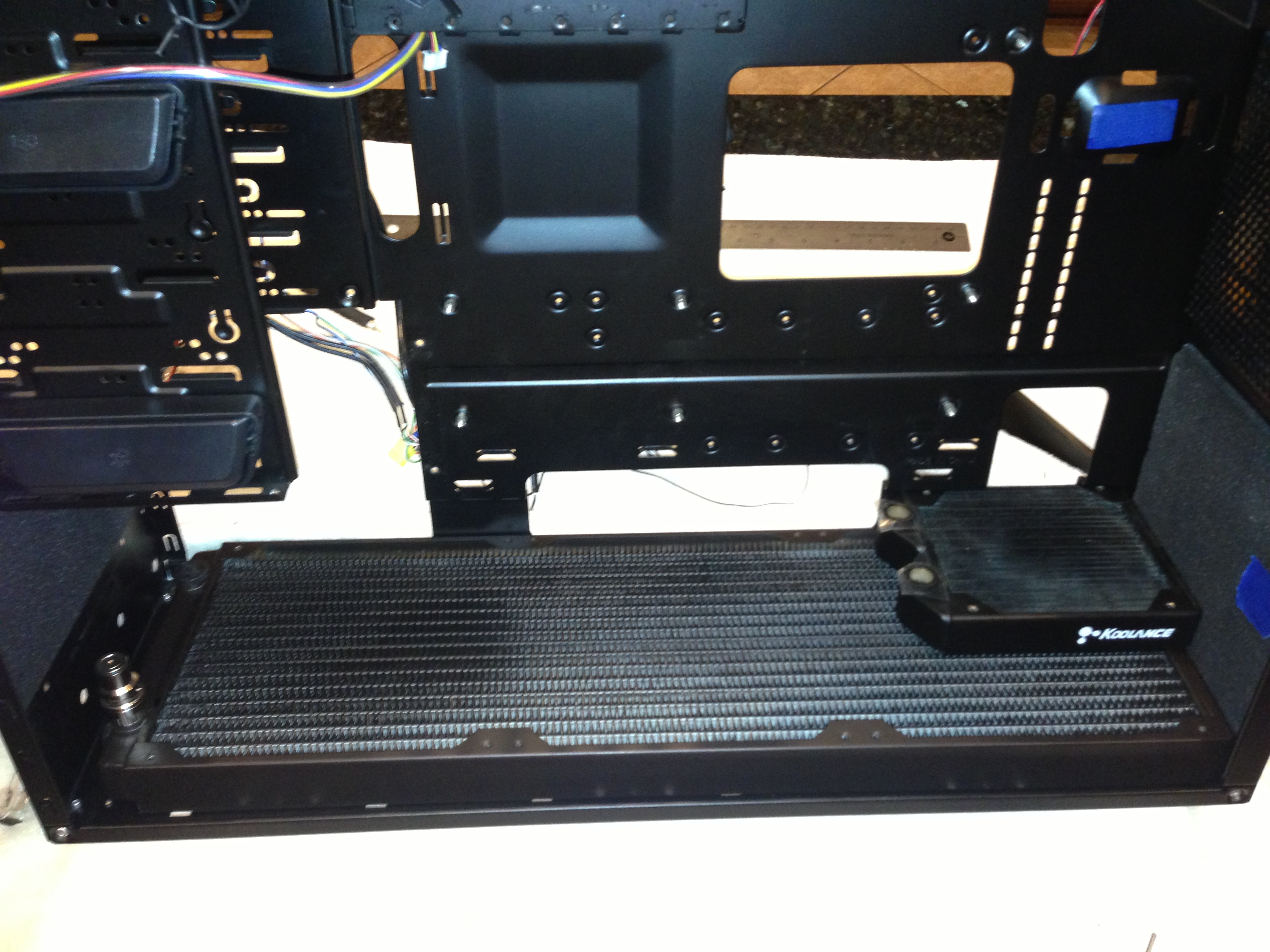

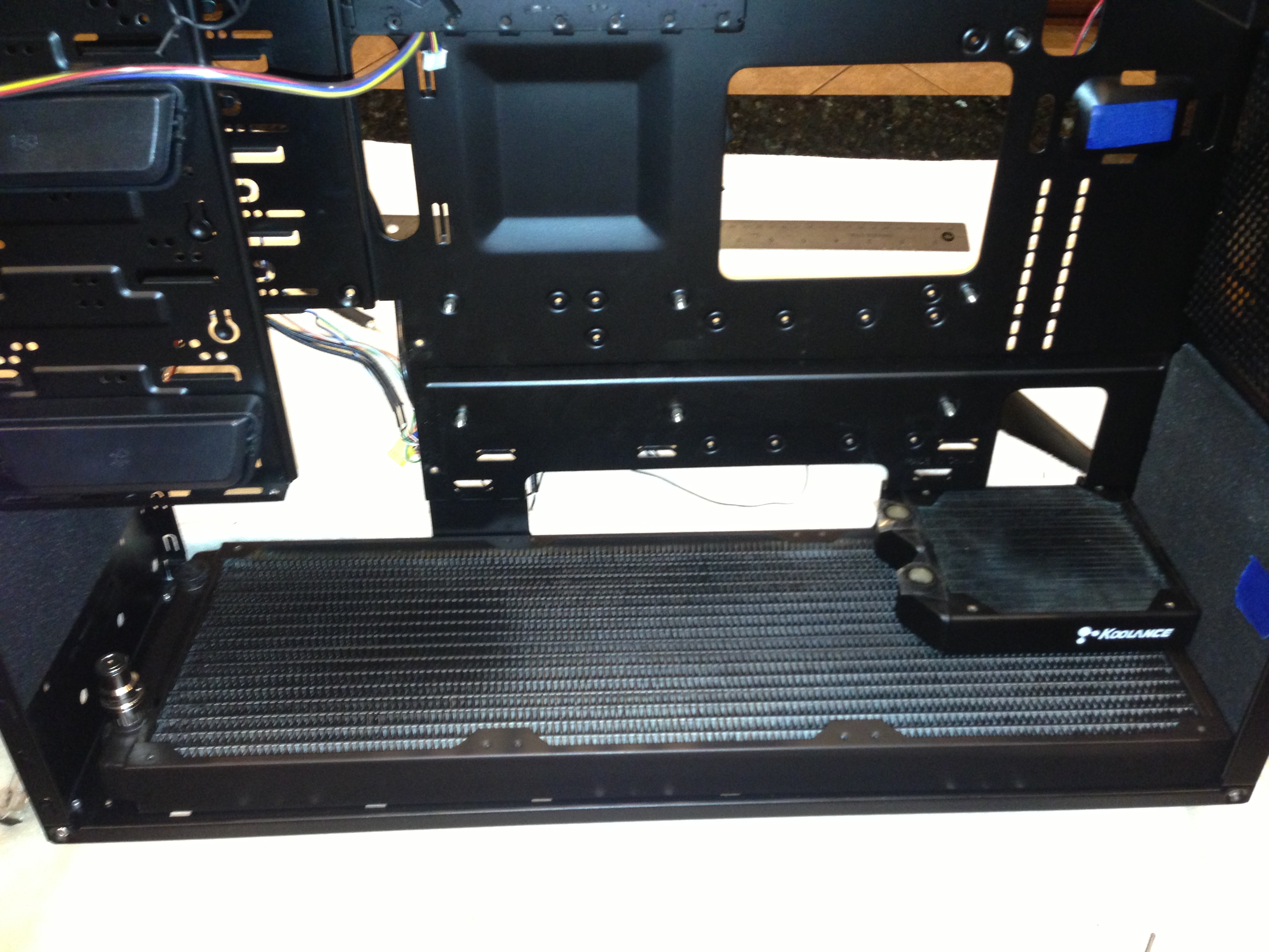

PS - Take a look at my new build I'm working on. Here's a pic of the largest Rad that I could find that fit PERFECTLY. It's a Magicool 540mm Radiator. The 120 mm radiator that's in the corner will give you some perspective on how big the radiator below it is. It takes up the whole bottom part of the case from end to end this you can see and takes three 180 mm fans. It's not like it hasn't been done before I'm just going to do mine a little bit differently that's going to create even more airflow that I'm looking for. I'll be posting this up pretty soon within the next week or so once I get all the parts in…

PunkNugget,
I'm disinclined to spend much more time tweaking WolfPack5 - the MSI - 3930k 6-core system. I do not expect that I can improve this system's performance by much more. WolfPacks 1 to 4 and 6 to 13, my Mac Pros (and yes, I'm hackintoshing [per netkas's forum] all of my old Mac Pros to give them new lives, but their hardware I'll leave in tack) and WolfPackPrime0, as well as my GPUs, will get the remainder of my free time these holidays. My Mac portables are next.
