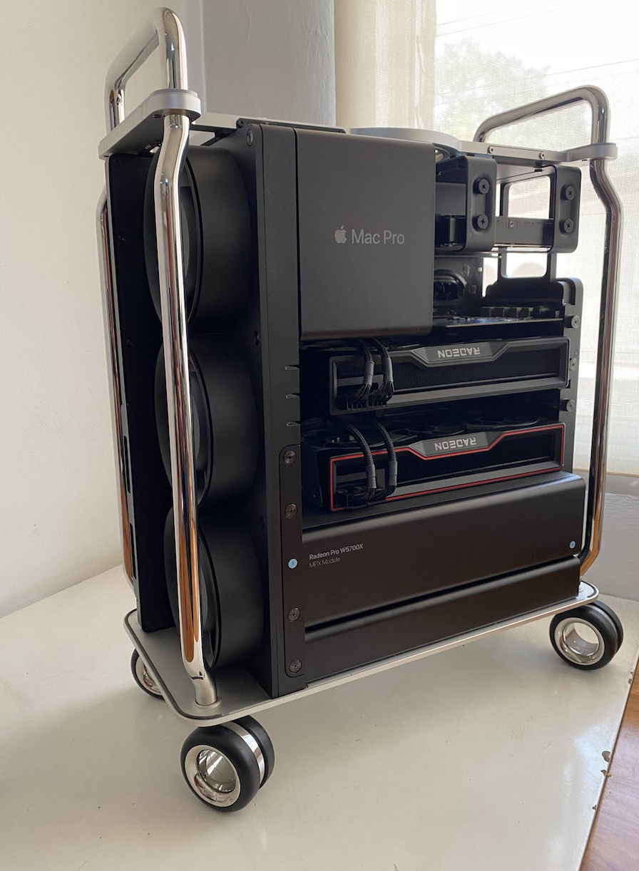

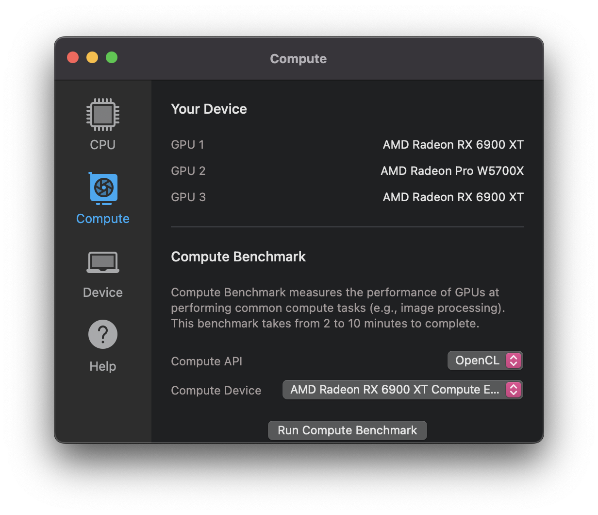

I'm trying to get a 6950xt running on MacOS on my Mac Pro 7,1 as 6900xt. For a couple of days Ive seen all this guides and videos but they are meant for hackintosh, I'm not sure Im doing it right for a legit Mac. Any help or reference is welcome.
Thanks a bunch
---- Update: Okay, I did it!
So to anyone maverick enough to try to achieve this, its pretty simple
Its easy to flash the card using windows and bootcamp
Heres the guide
1. Download the AMD GPU flash application
https://www.techpowerup.com/download/ati-atiflash/
2. Download GPU Z and make a back up of the original 6950XT ROM
https://www.techpowerup.com/download/techpowerup-gpu-z/
3. Download the 6900XT ROM
https://www.techpowerup.com/vgabios...r=&model=&interface=&memType=&memSize=&since=
4. Use this guide to the letter to flash the firmware
https://www.techpowerup.com/forums/...nd-line-cmd-syntax-mini-guide-windows.291671/
Please consider this is an intrusive procedure, theres a risk of bricking the card if you don't understand what you are doing, but you should be fine If I was able to do it.

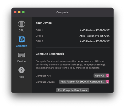

Okay so I did it guys! It wasn't so hard having the tools around and the time to be fooling around
To anyone trying to achieve this its pretty possible.

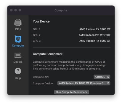

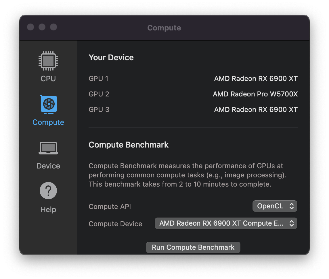

Can you do some benchmarks on your machine? It would be interesting to see if it's faster than 6900XT and if so, by how much.
Kudos and great job!
Sure, I ran some random benchmarks when I first fired it up, it was about 3% superior performance but that was just geek bench and Valley.
Which benchmarks would you like to see?
Reactions: ZombiePhysicist
