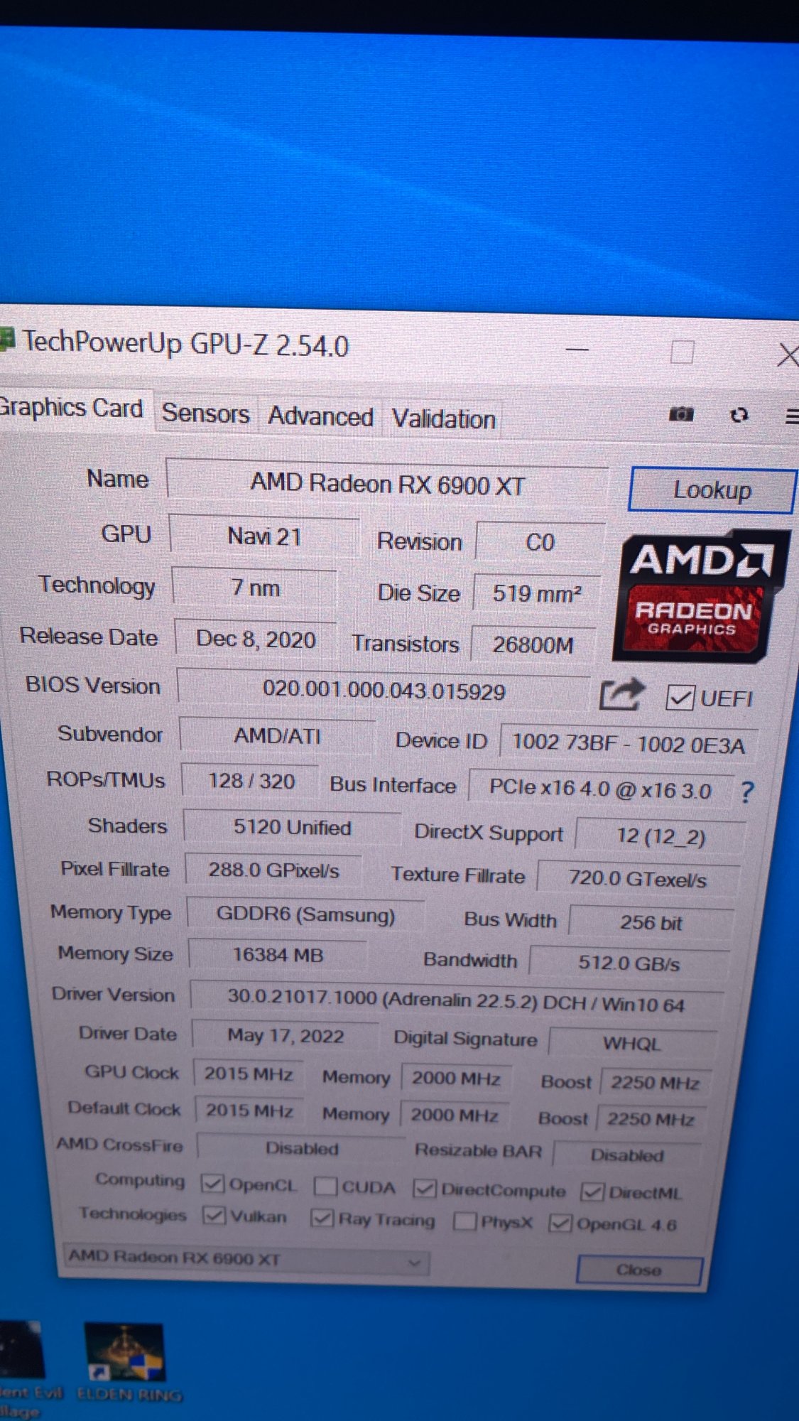

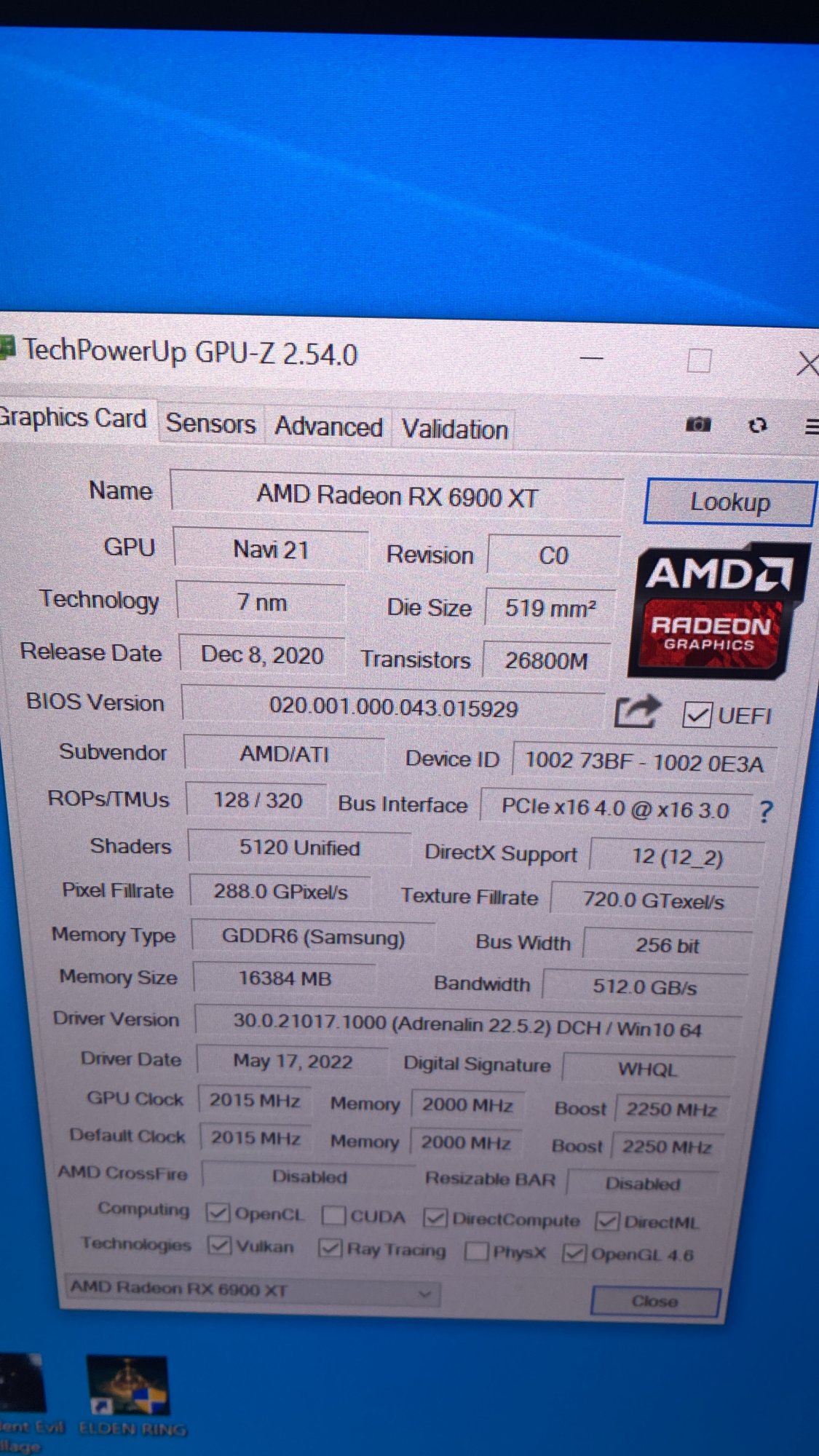

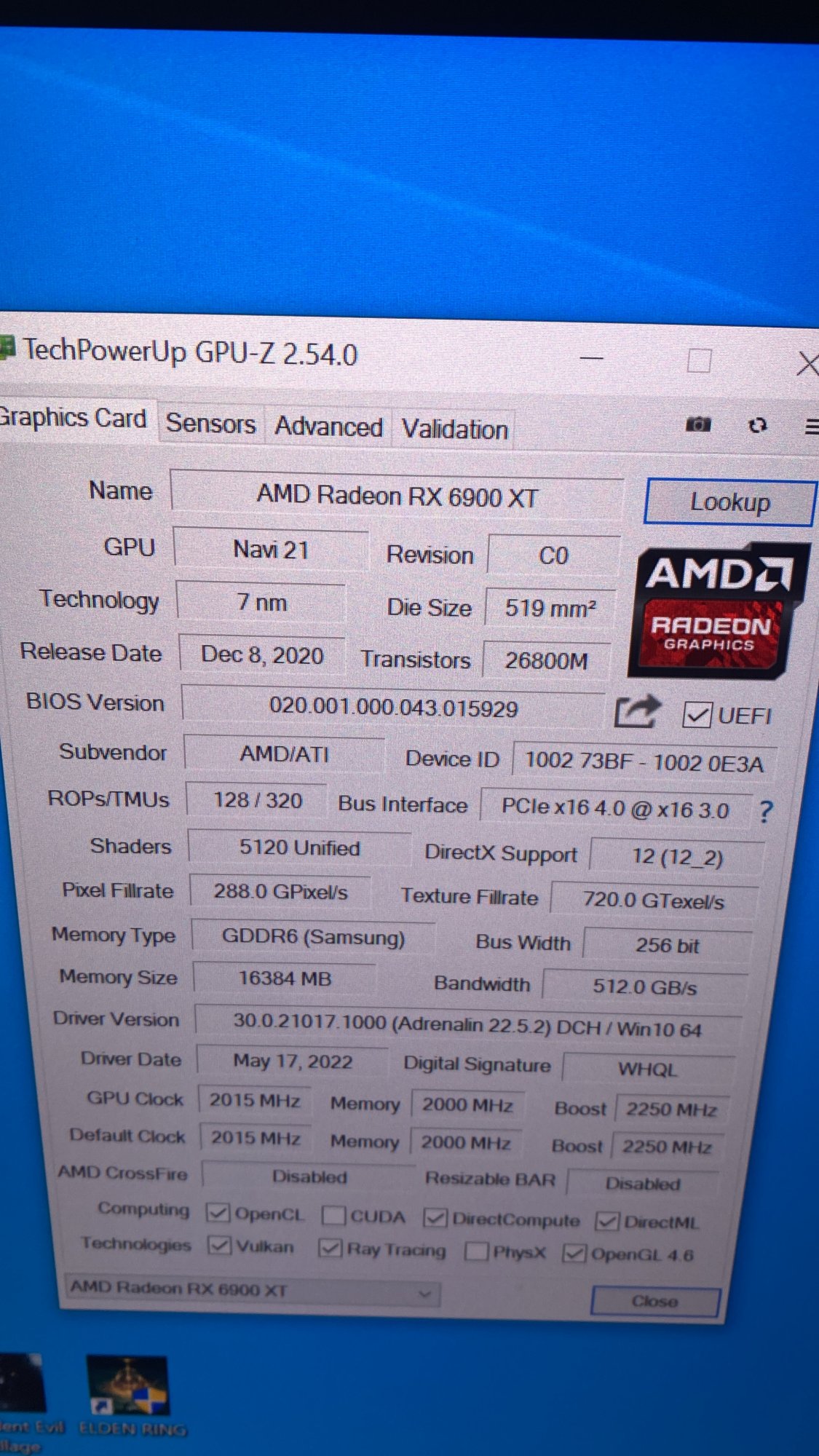

Do you have a screenshot of the GPU-Z for the original vBios? Or the original vBios itself?
Just took a photo of the flashed card BIOS after the reboot

Usb-c port working fine for video displays on MacOs, not sure if thunderbolt displays, I will check.
update: On MacOs no video for Apple XDR display using Apple thunderbolt cable, maybe with other specialized cable.
update 2: Apple XDR display working on Windows with Thunderbolt Cable, connected to the 6950xt usb-c Port

Flashed 6950XT on MacOs USB-C port working confirmed as a video output for standard displays.
Likewise the official 6900XT
Usbc functions other than video and audio not currently working on the USB-C of the card, at least on MacOs
Reactions: kvic
