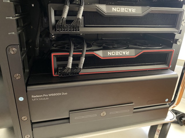

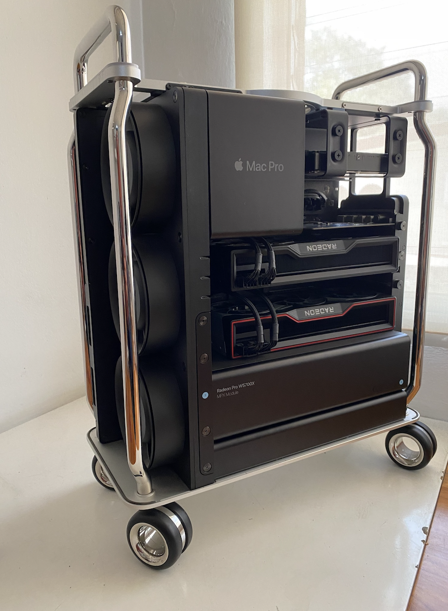

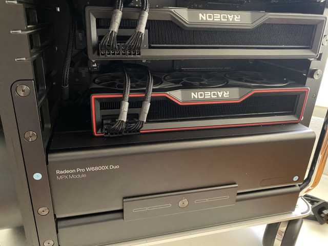

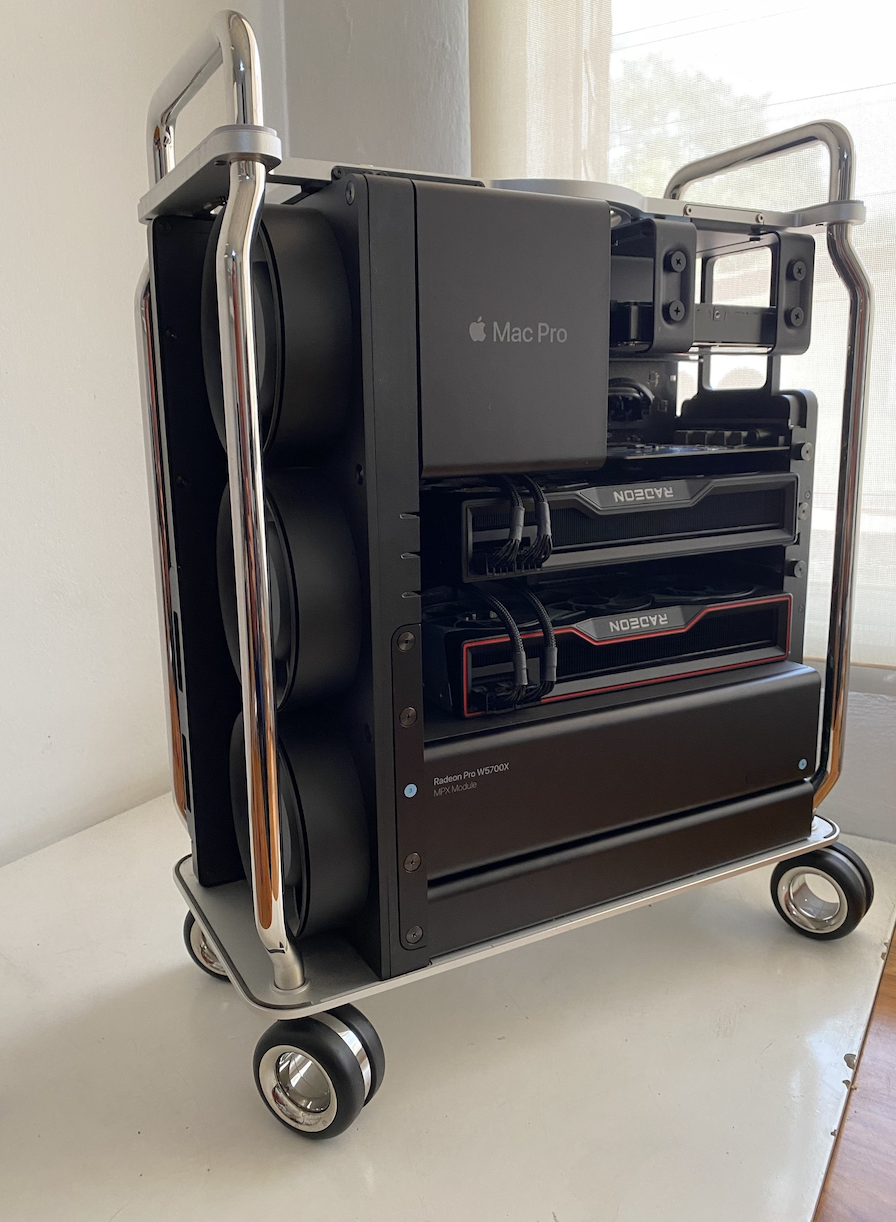

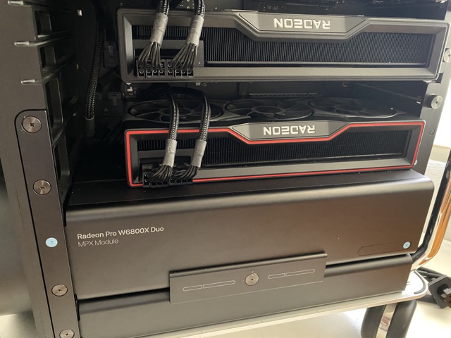

I get what you mean, I read your comment just as I was picking up my W6800x duo.
The Mac Pro 7,1 is a very expensive but well built computer, its a shame that as Apples best customers we always get the worst treatment. They decided they don't want our money anymore and Ive come to make peace with that. when the time comes I will move on.
But for now, this build looks like will be valid for a couple of years from now, with the option to keep expanding drives, ram and other components. And after that it could double as a Windows and nvidia machine. Its just opportunities from now on for the amazing 7,1. The last Mac Pro for many of us.
View attachment 2237296View attachment 2237437
Is w6800x duo the default configuration? Or was it added later?
