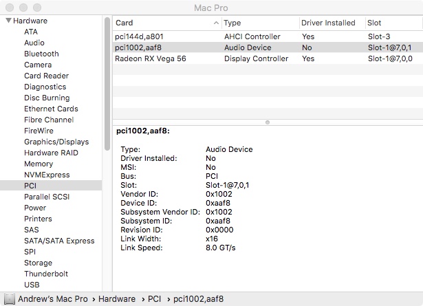

Interesting. I encourage those with Vegas that have the fan issue to test the latest beta. I could try it with a reference bios on my Pulse, but I don’t really want to keep risking putting different bioses on it. A couple things I noticed with the first 10.13.5 beta is that the HDMI audio kext didn’t load and a few times the Mac booted to a blank white screen. I haven’t tried the second beta yet. I reverted back to 10.13.4.

[doublepost=1524721479][/doublepost]Here's 10.13.5 beta 2 showing HDMI audio driver not installed.
