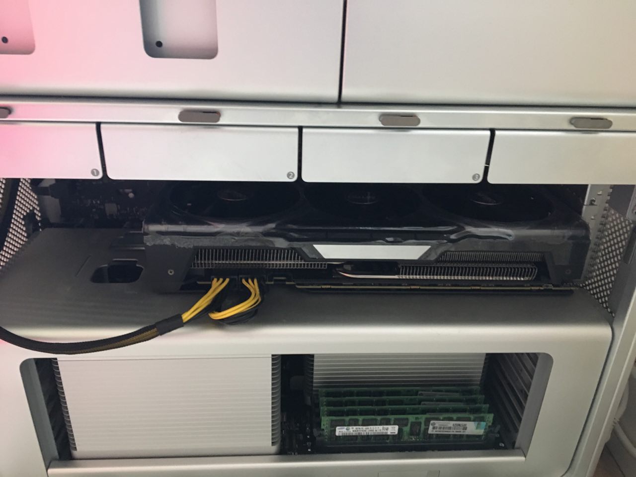

downside is card is HUUUUUUUGE, i can't even install it leaving the PCIE fan, because this one is blocking the card, she is too damn long. I'm thinking about modding my fan case so i can let it installed with the card. right now i had to remove the fan...
if anyone has an idea about this :)

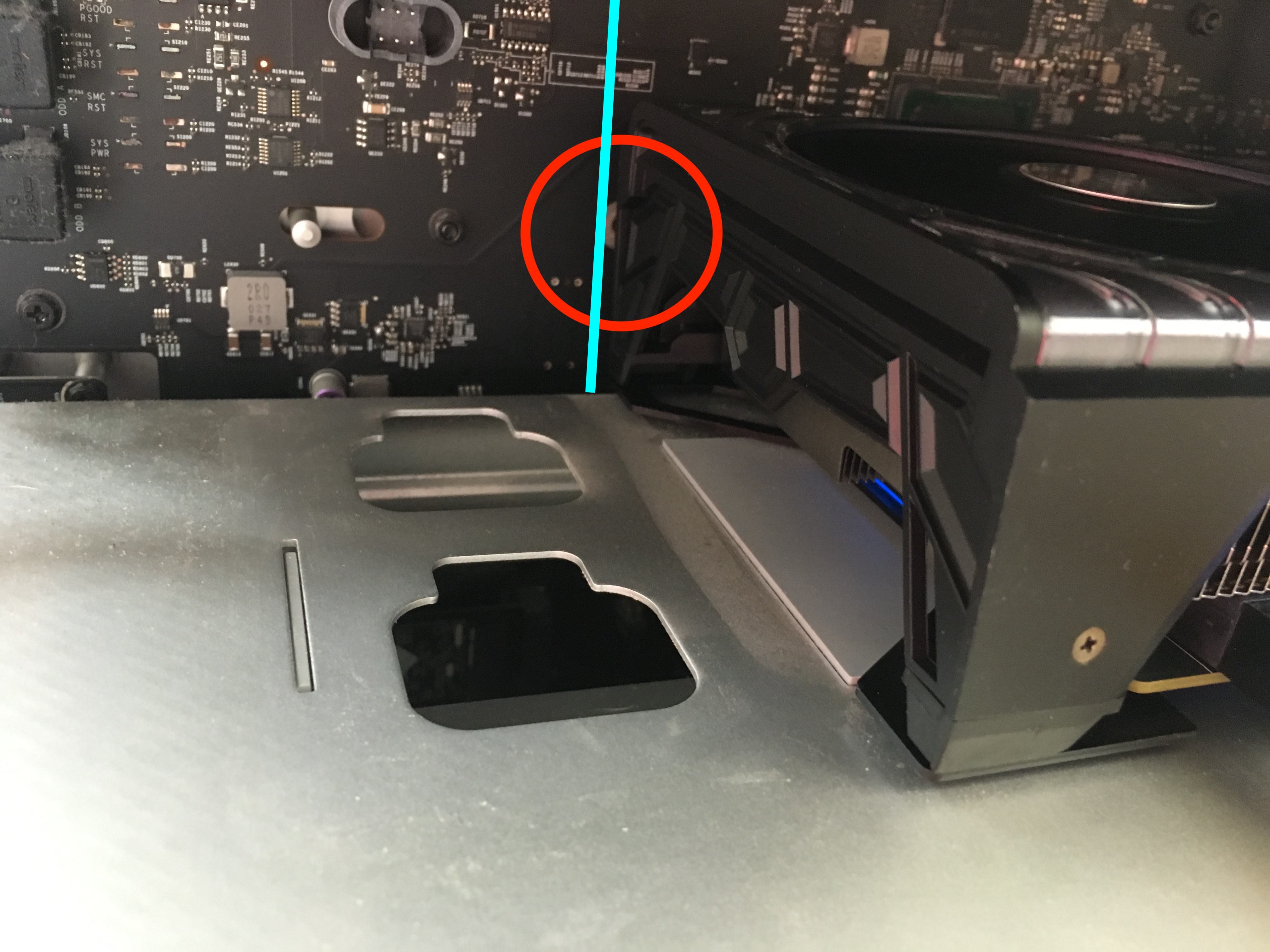

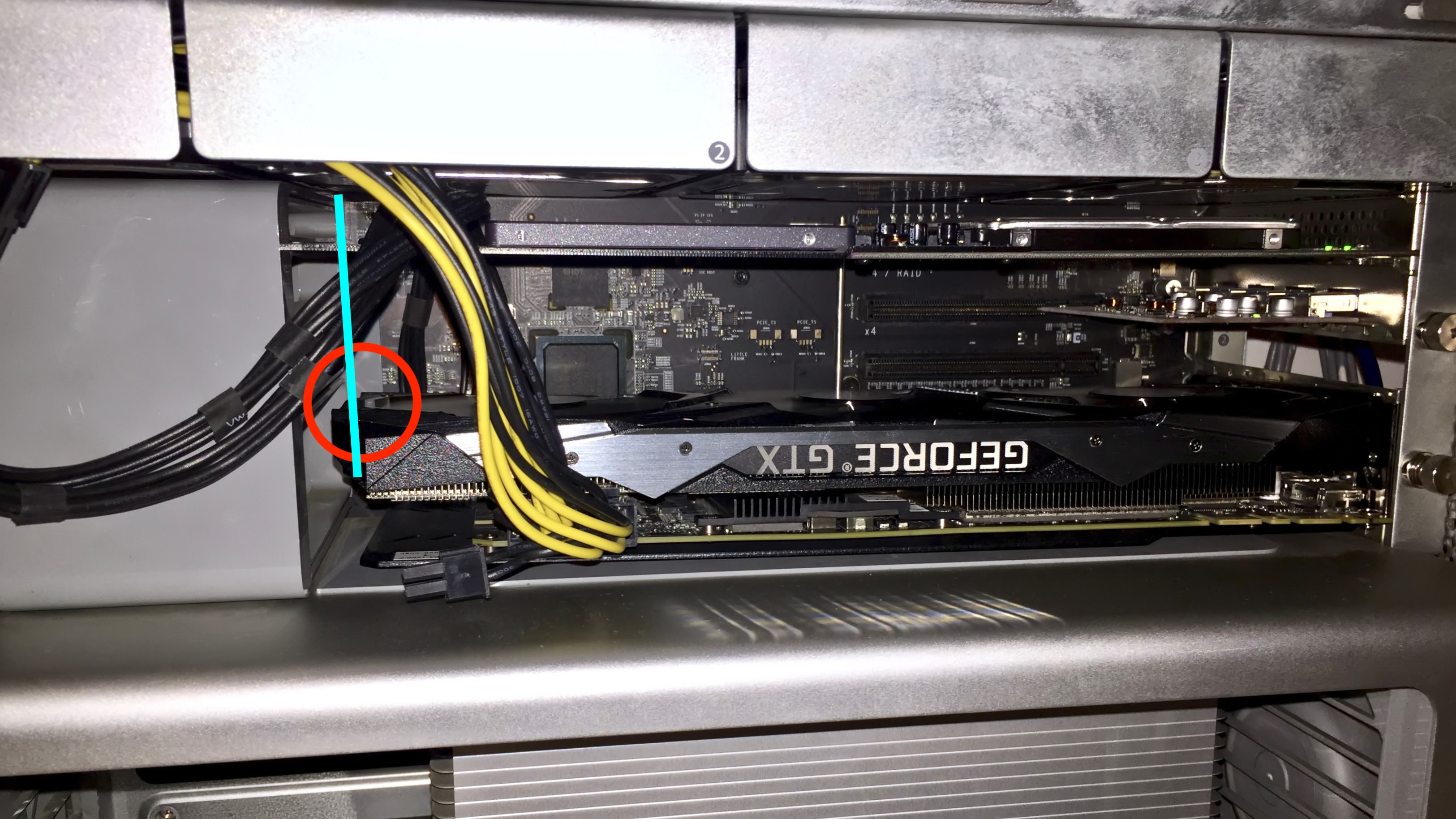

Sapphire says the card is 310mm Long. It shouldn't be a problem. My 1080Ti is 313mm long, and I can still install it properly.
Could you mind upload a photo, therefore, let us know how the situation looks like?

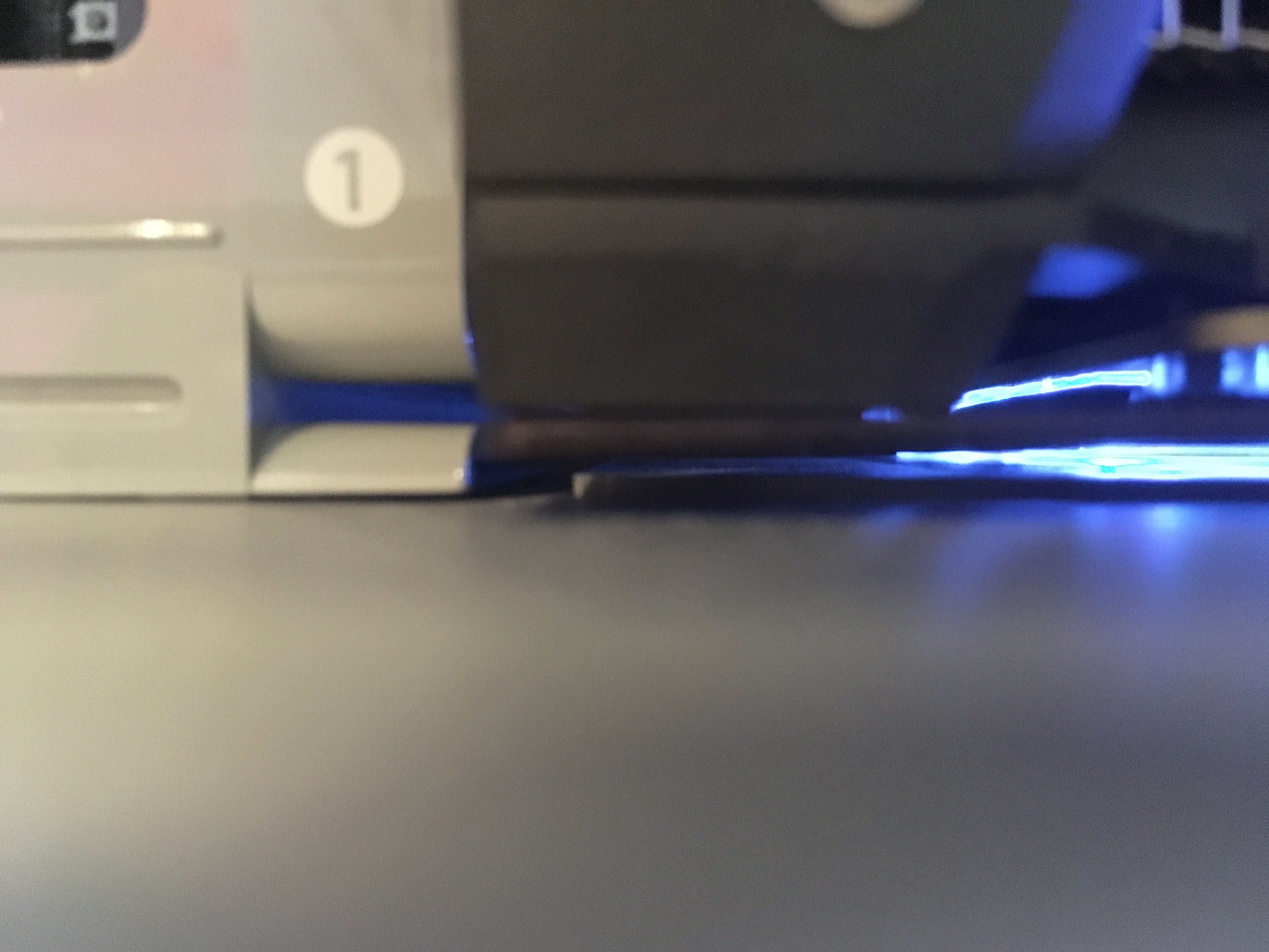

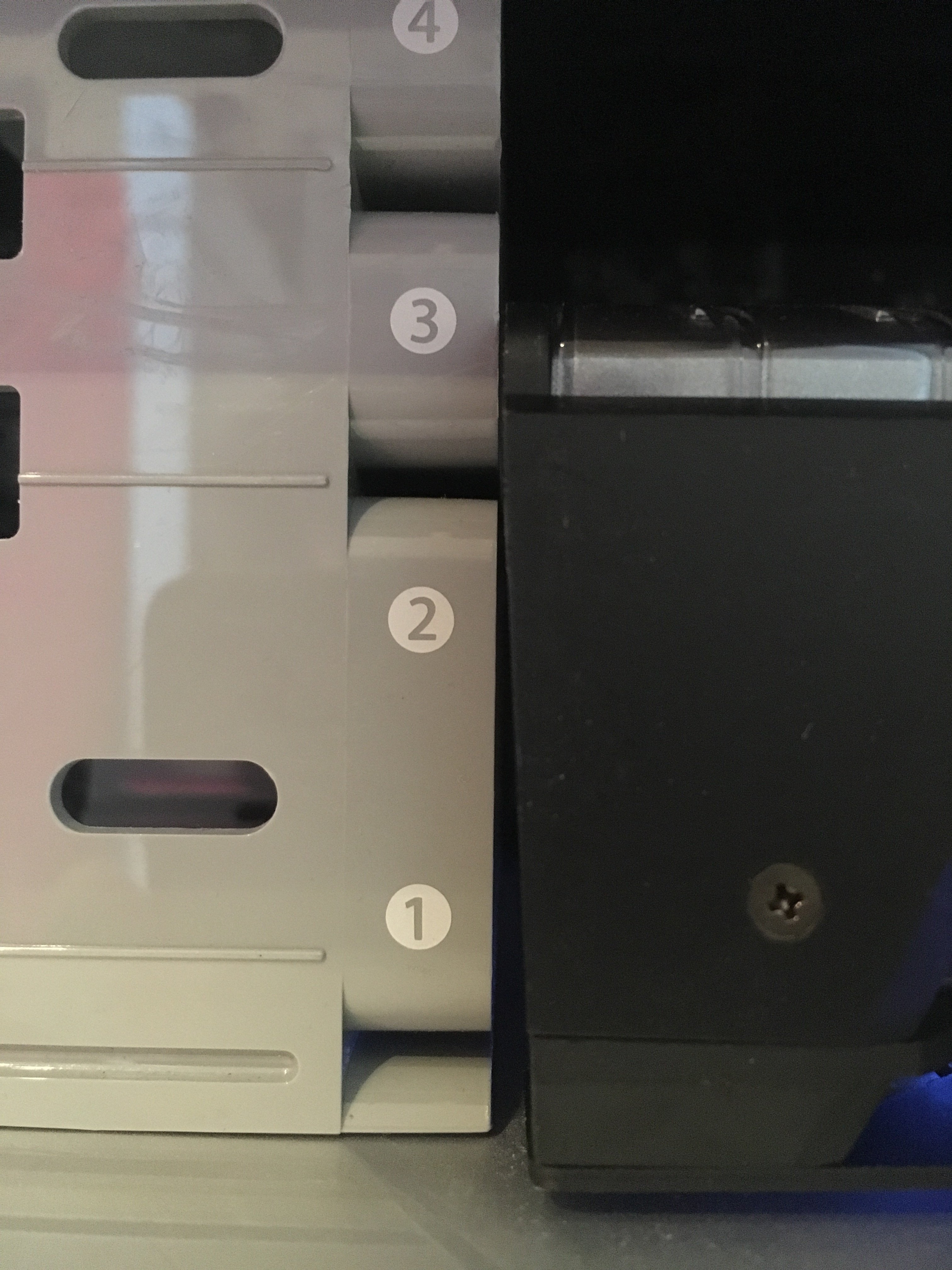

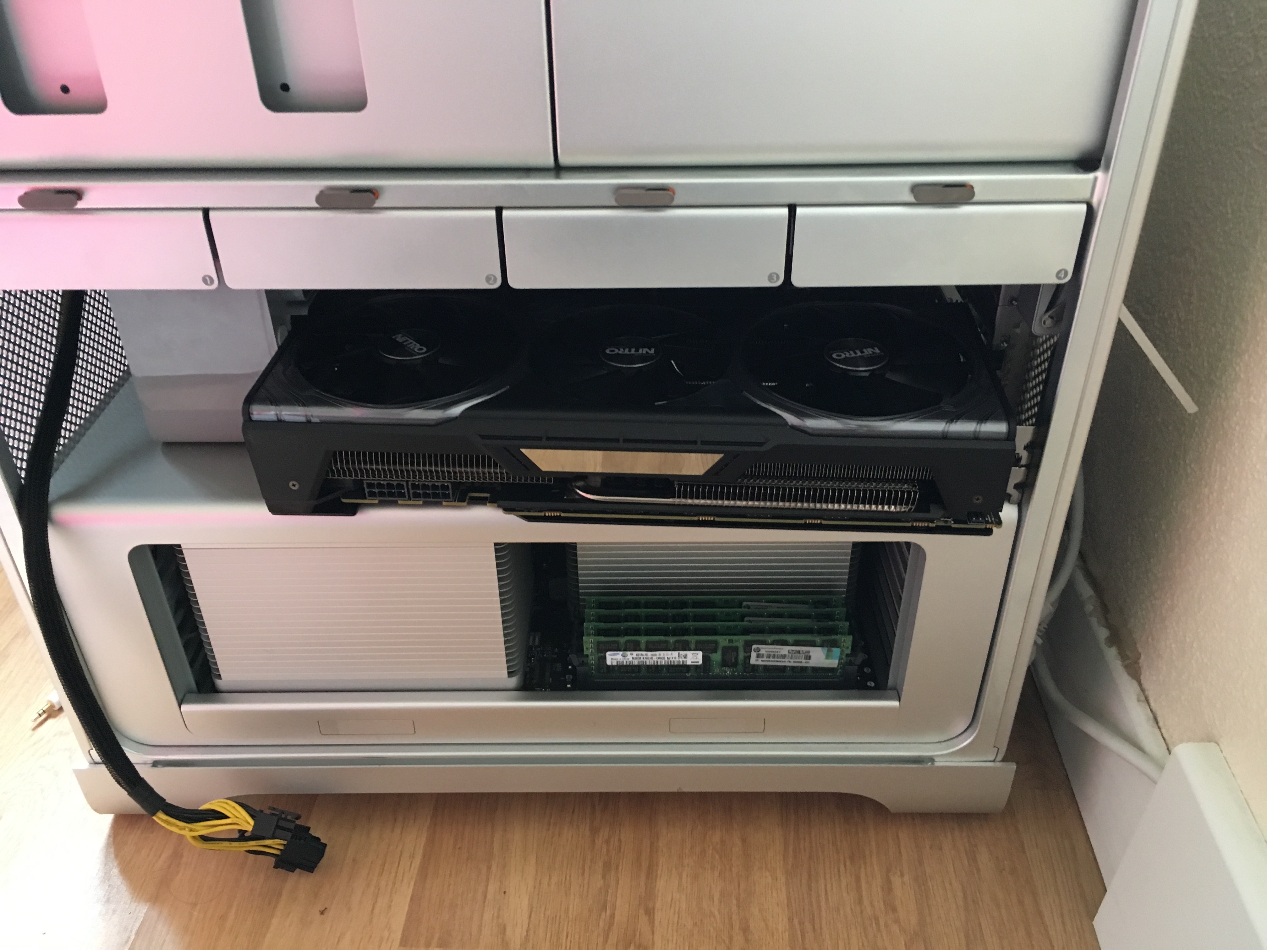

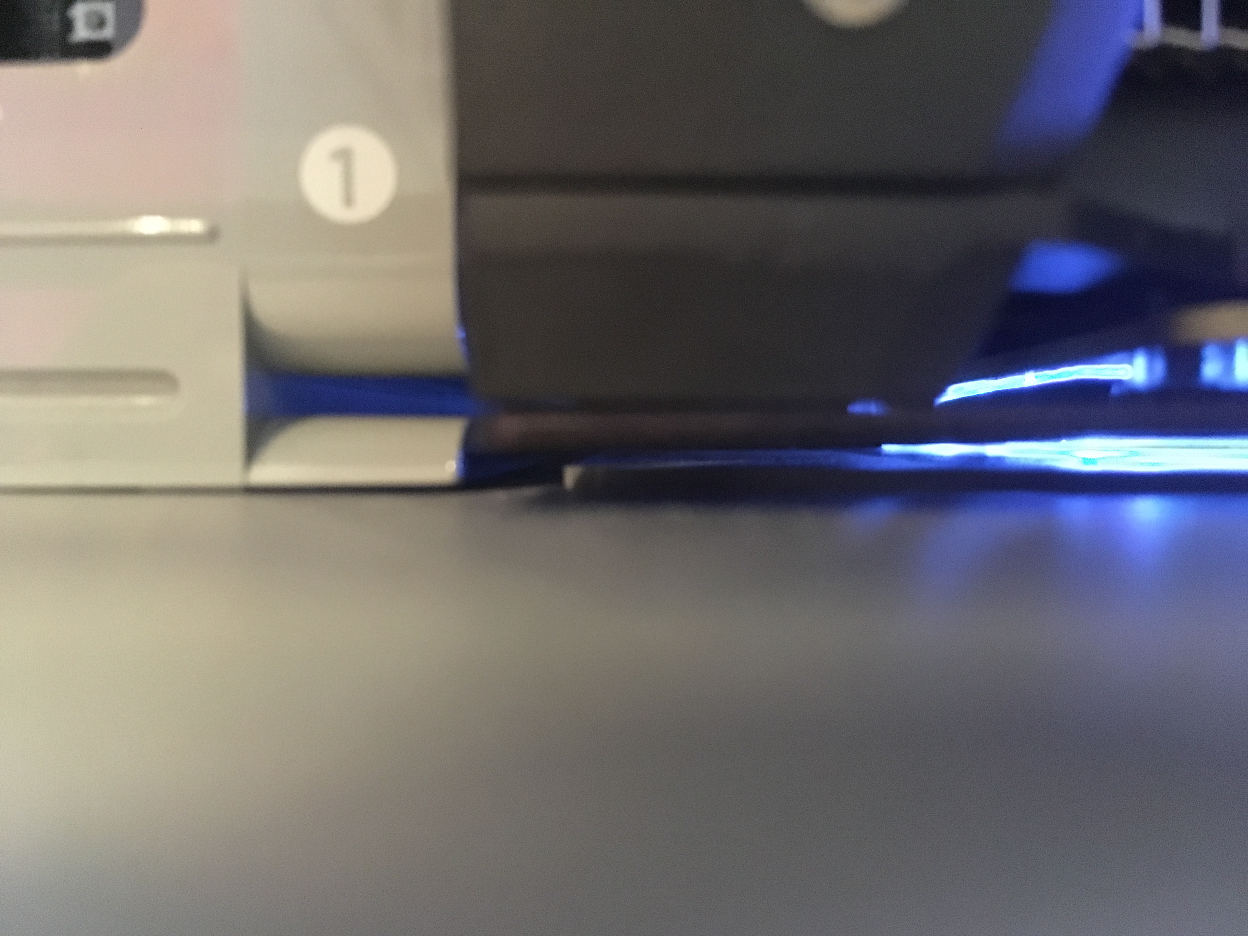

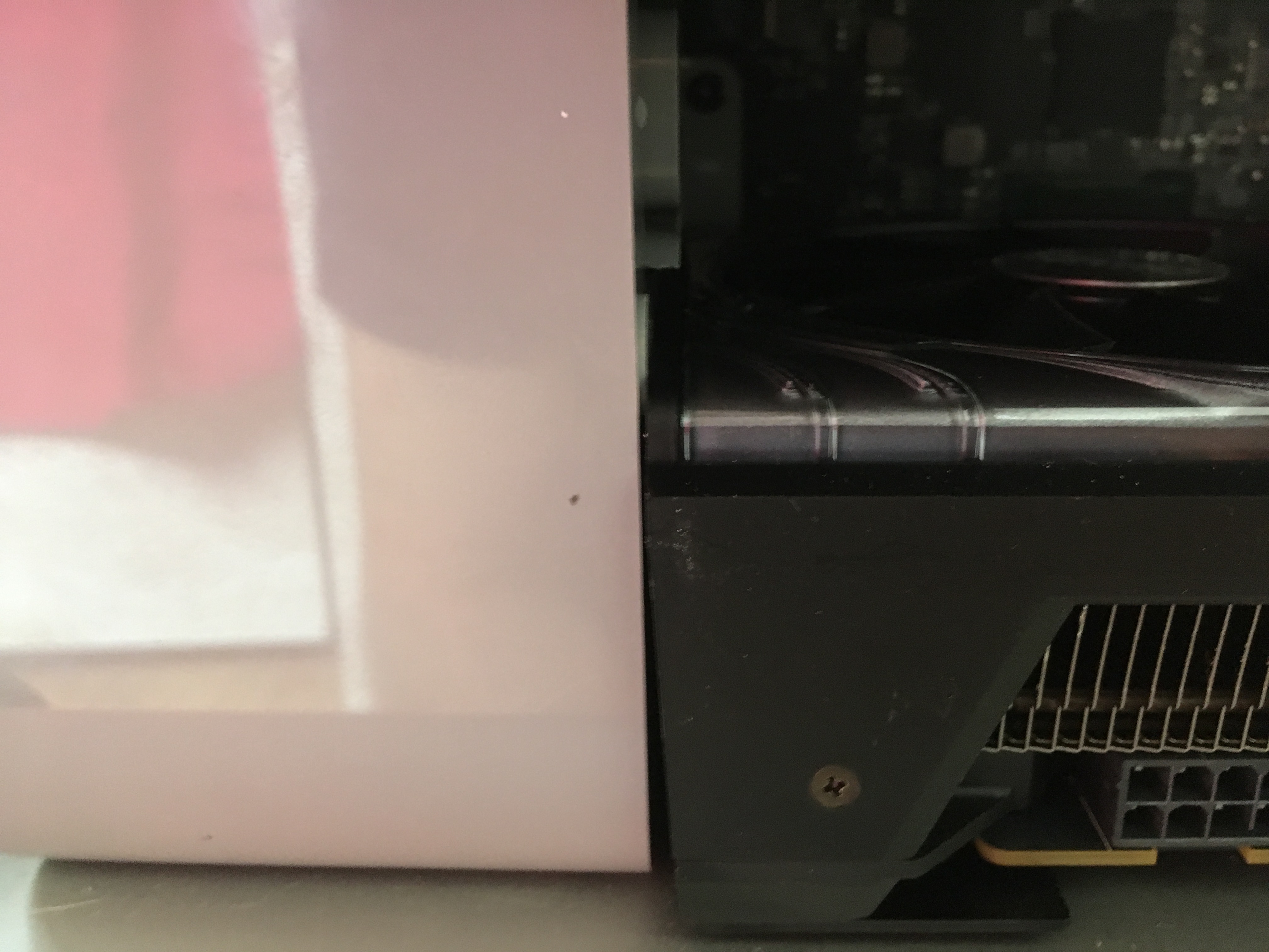

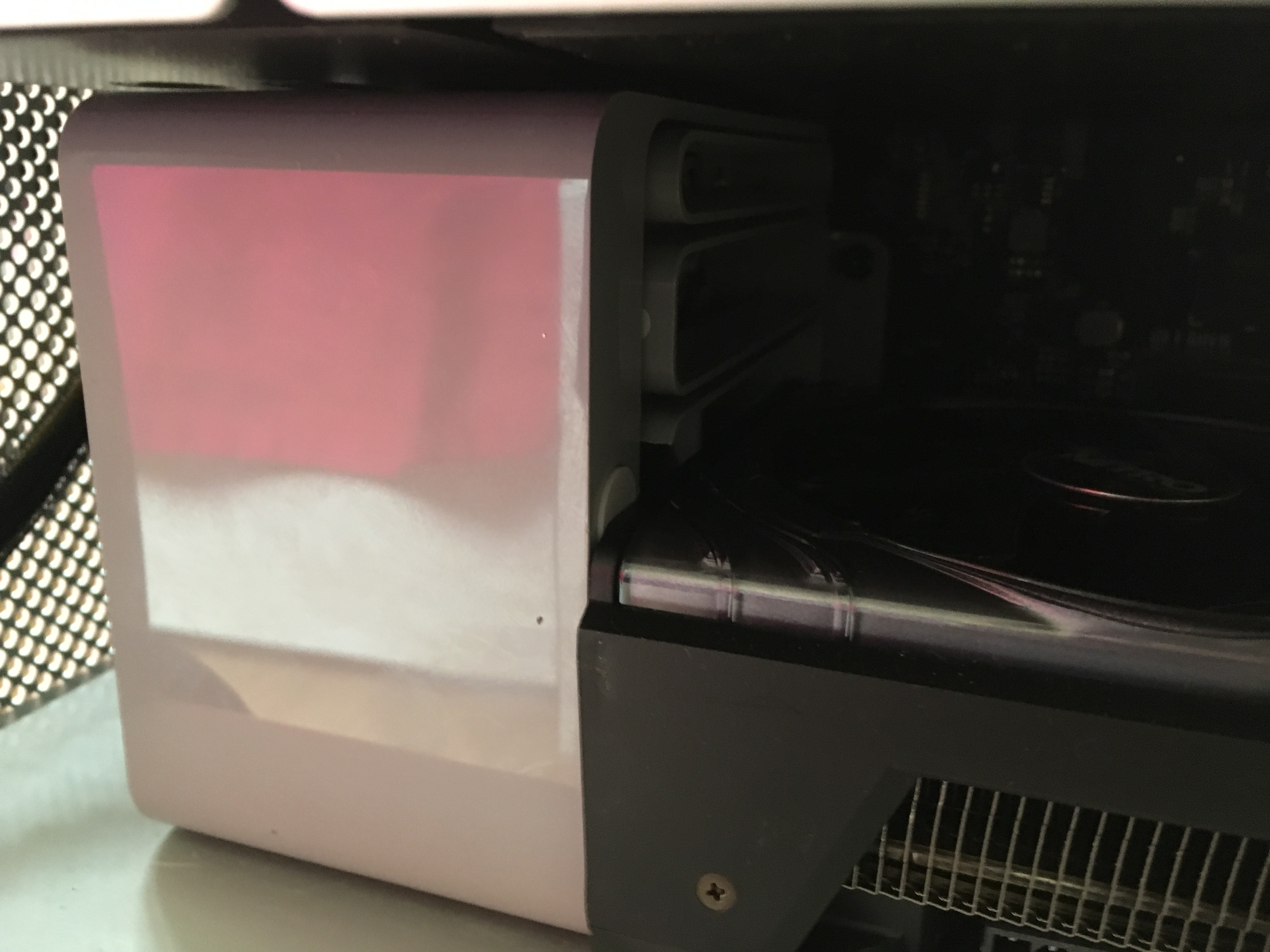

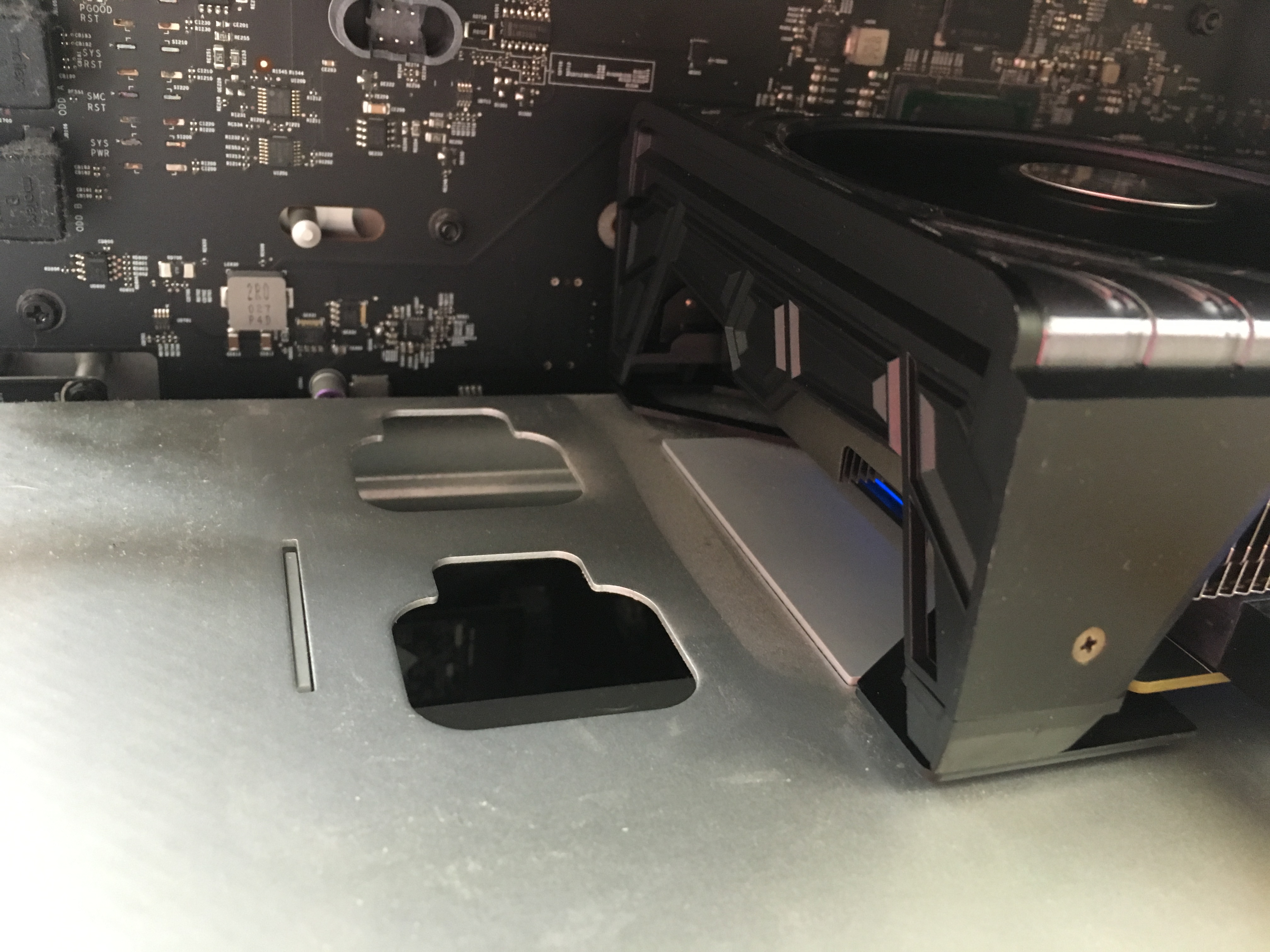

yep. here it is:
issue is: your card is less high, and only the top plastic case is a little longer so it can fit in the "hole" in front of the fan.
mine is 2,5 in size and it is as square as the maker could possibly do it: there is no room for it:
IMAGE 2018-05-02 15:22:54.jpg

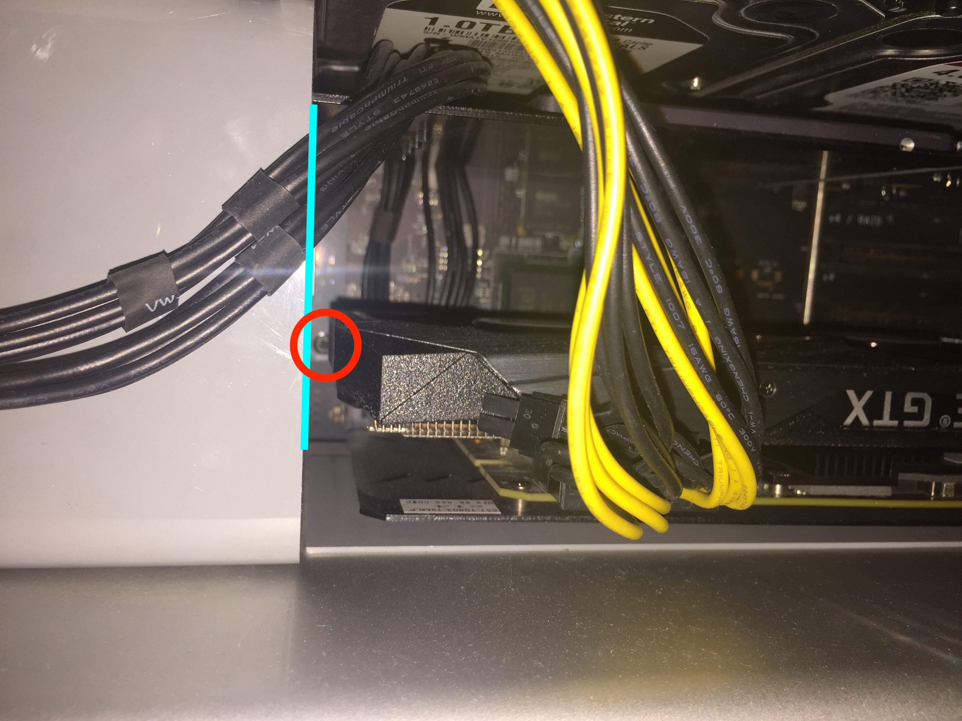

When i put the fan, the screw hole is 3-4 mm away, so i,m sure it does not fit. :)

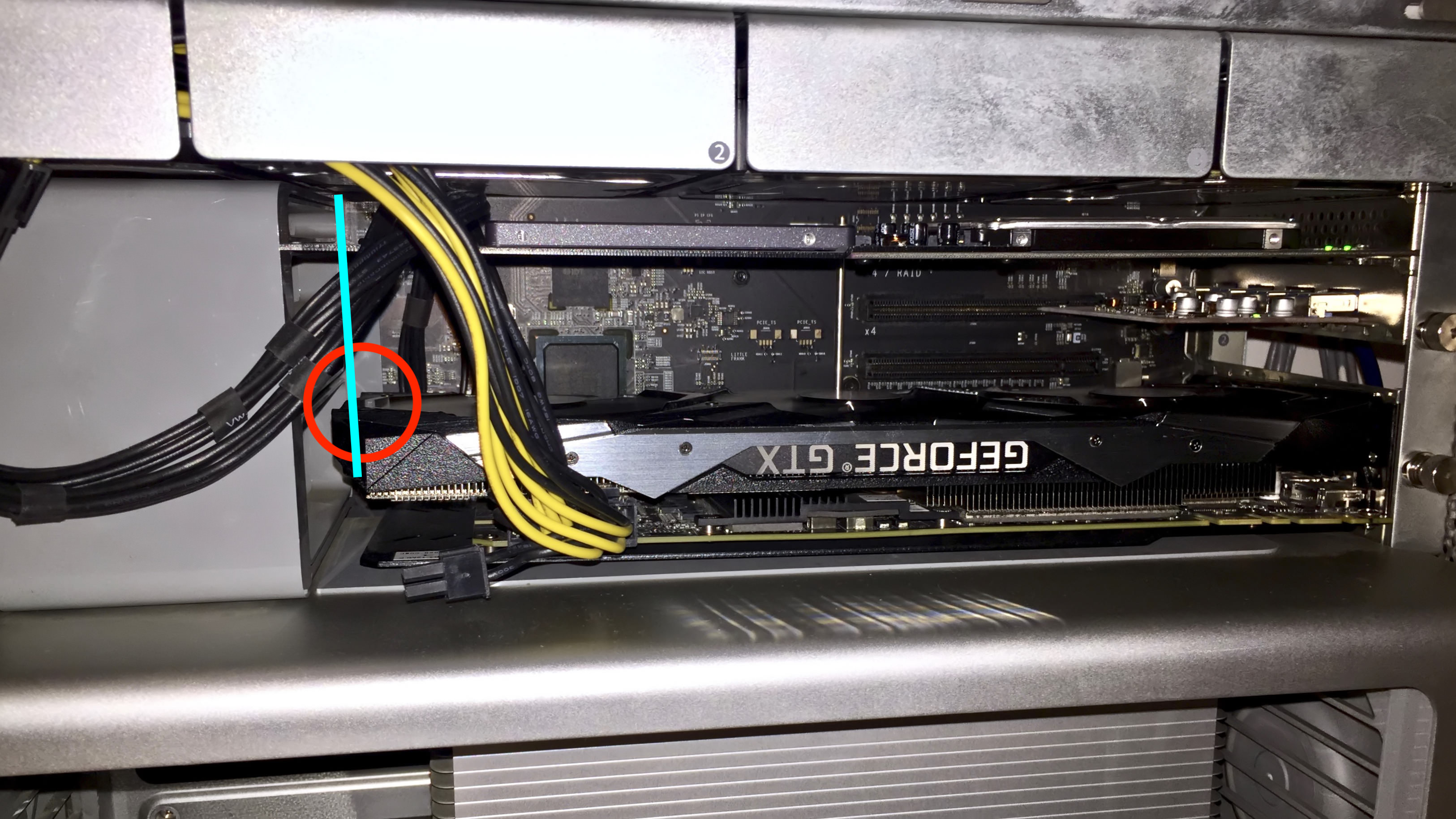

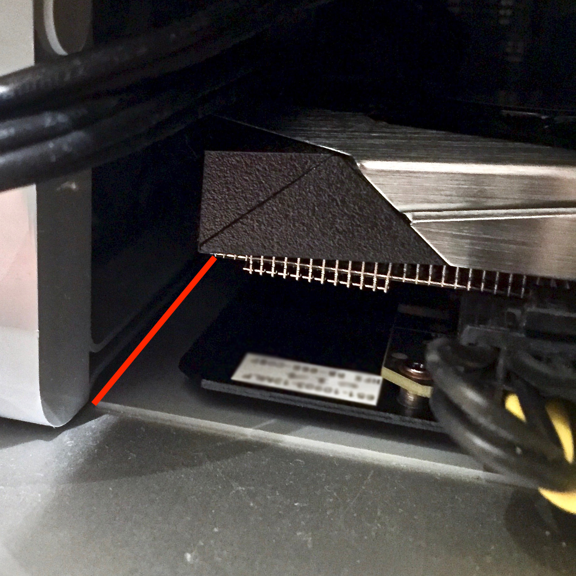

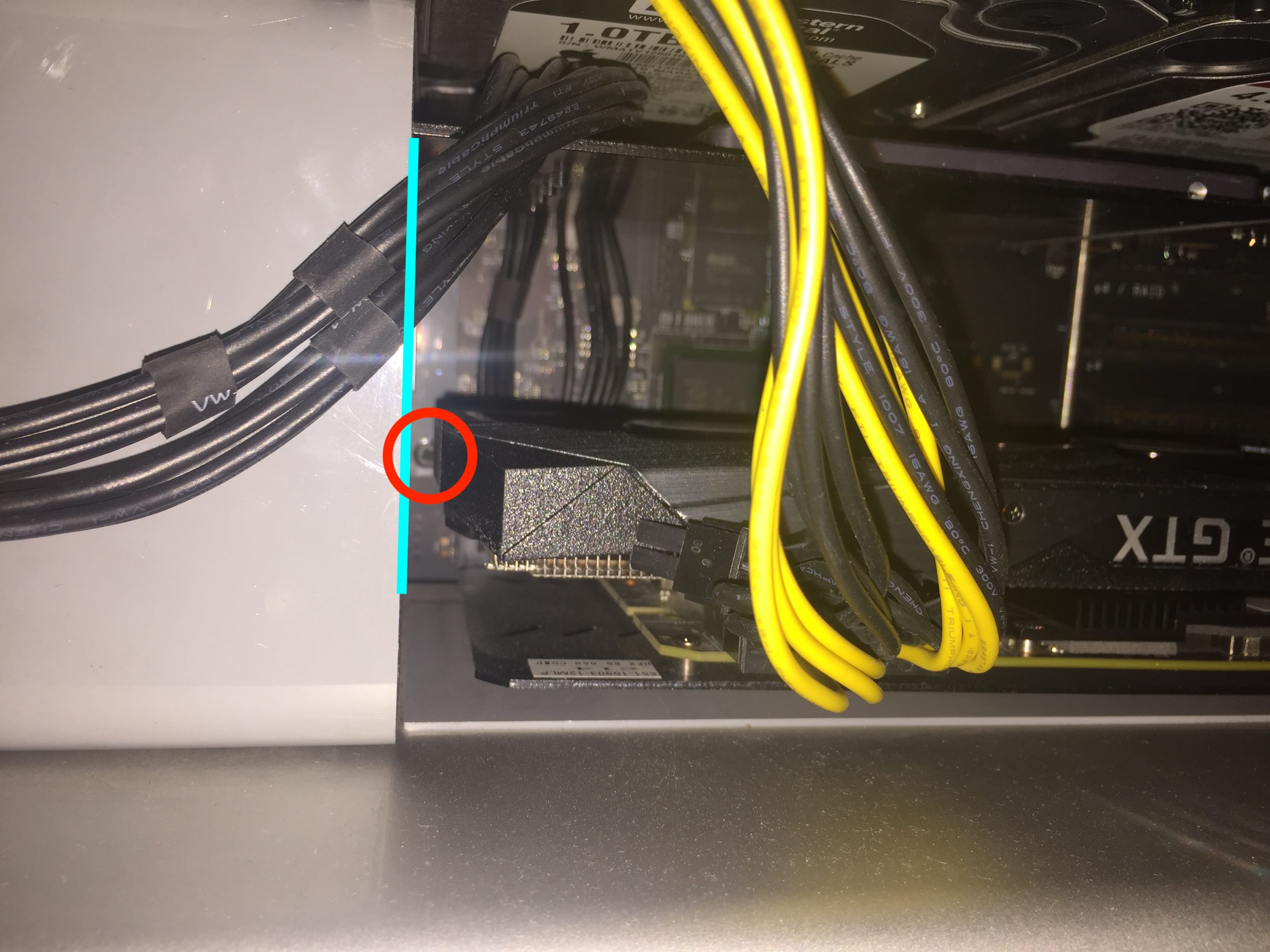

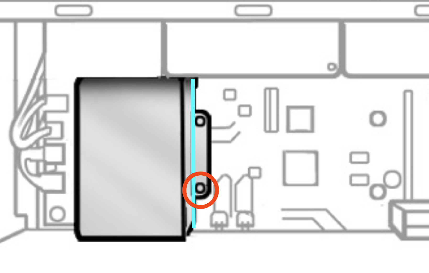

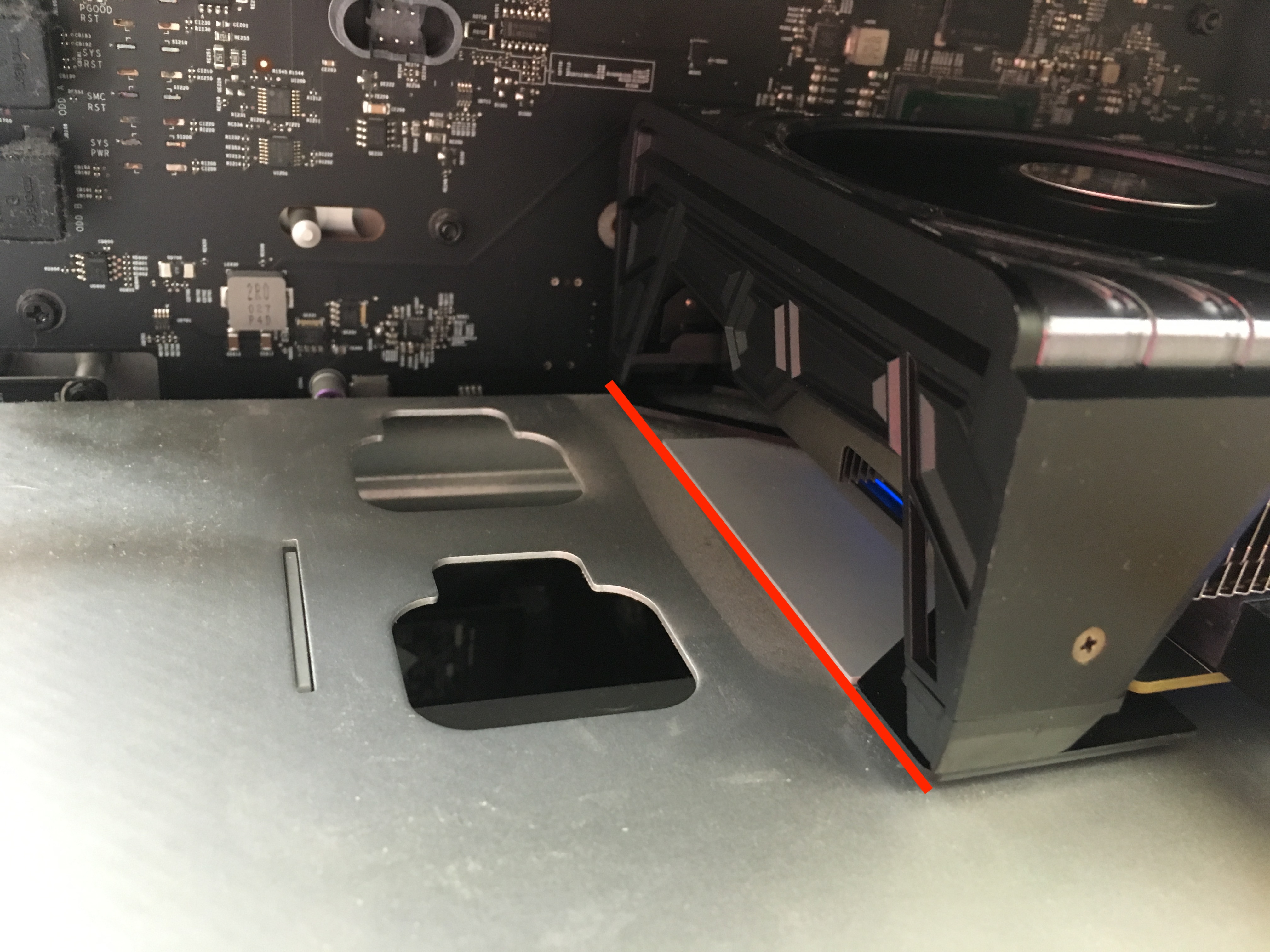

That sounds strange to me. Because it seems your card just touch the red line (exactly the same length as the grey plastic plate)
And as long as the card is not longer than the plastic plate, it should able to fit in. As I said, at least should be OK when the fan is at the "open" position.
So, if the PCIe fan is there, even at the "open" position, you still can't slide the card in?

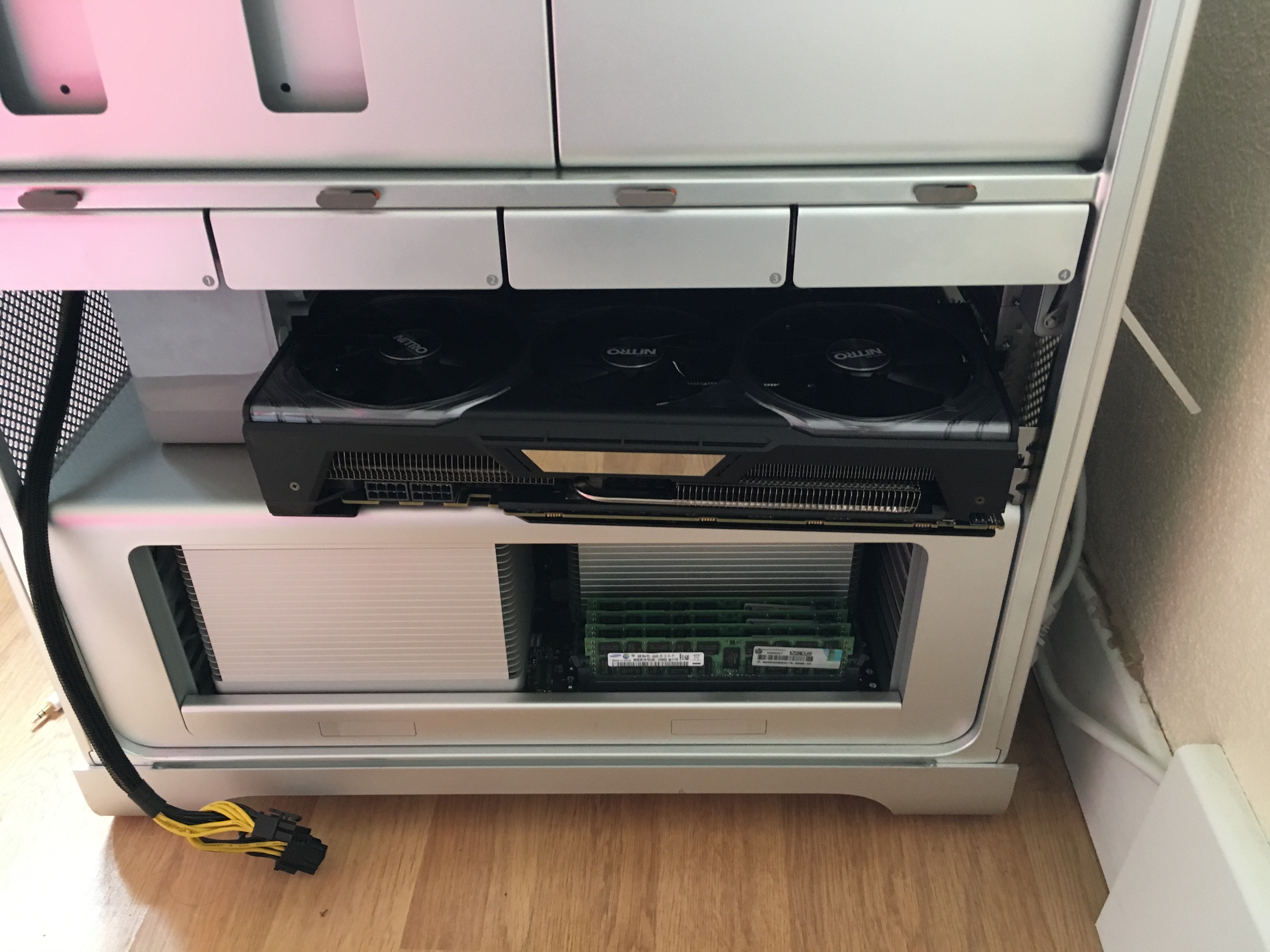

honestly i’m thinking about keeping the card, buying a spare pcie fan, and modding my actual Fan, hoping i can make something a little clean.
the card itself is amazing, even under load (about an hour of x-plane in 4k) the beast wasn’t making much more noise than when idling. it’s almost as quiet than the original 5770 idling
if i can putback the expansion slot fan and with some macfanscontrol i may be able to make the whole mac pro quieter than it is now :)

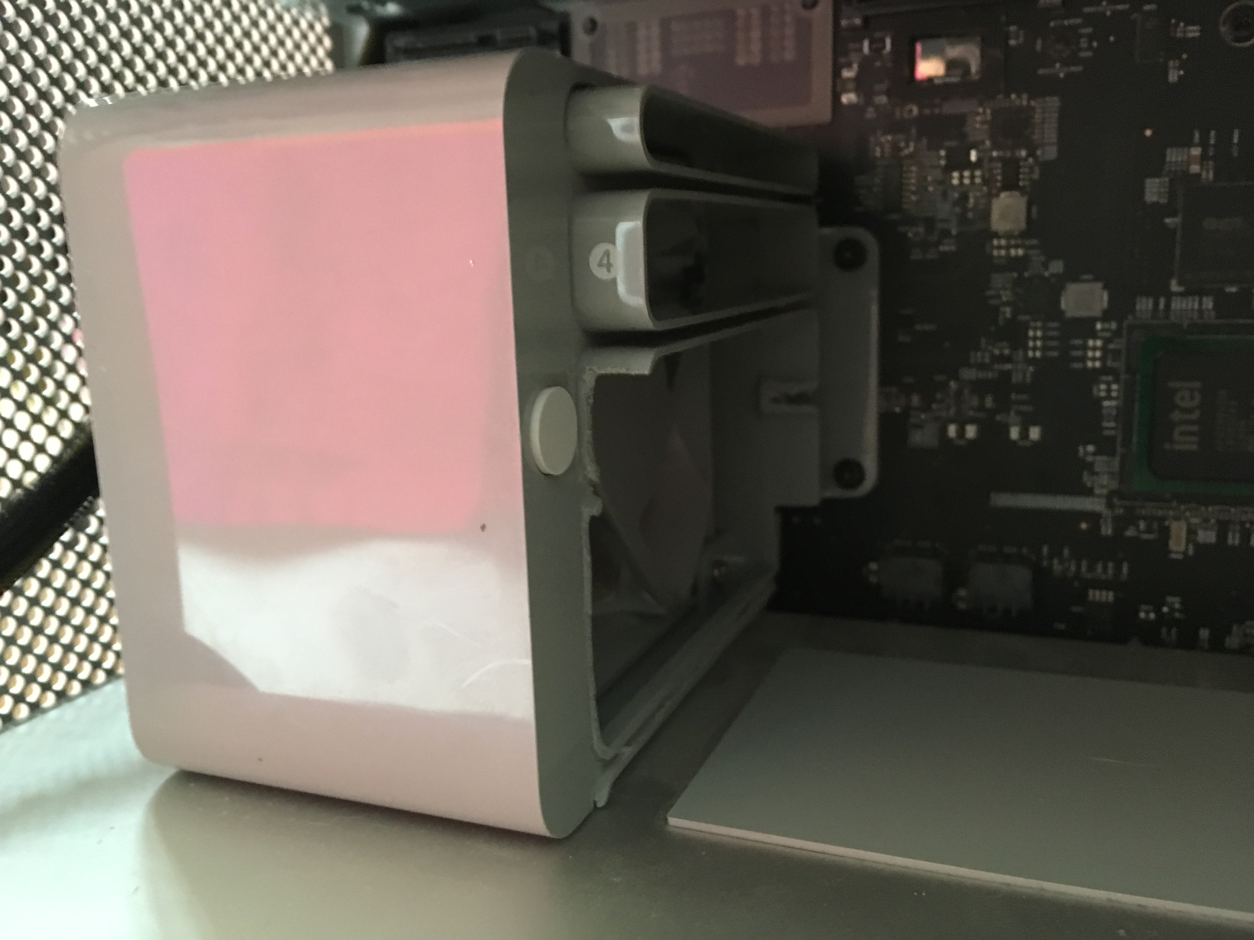

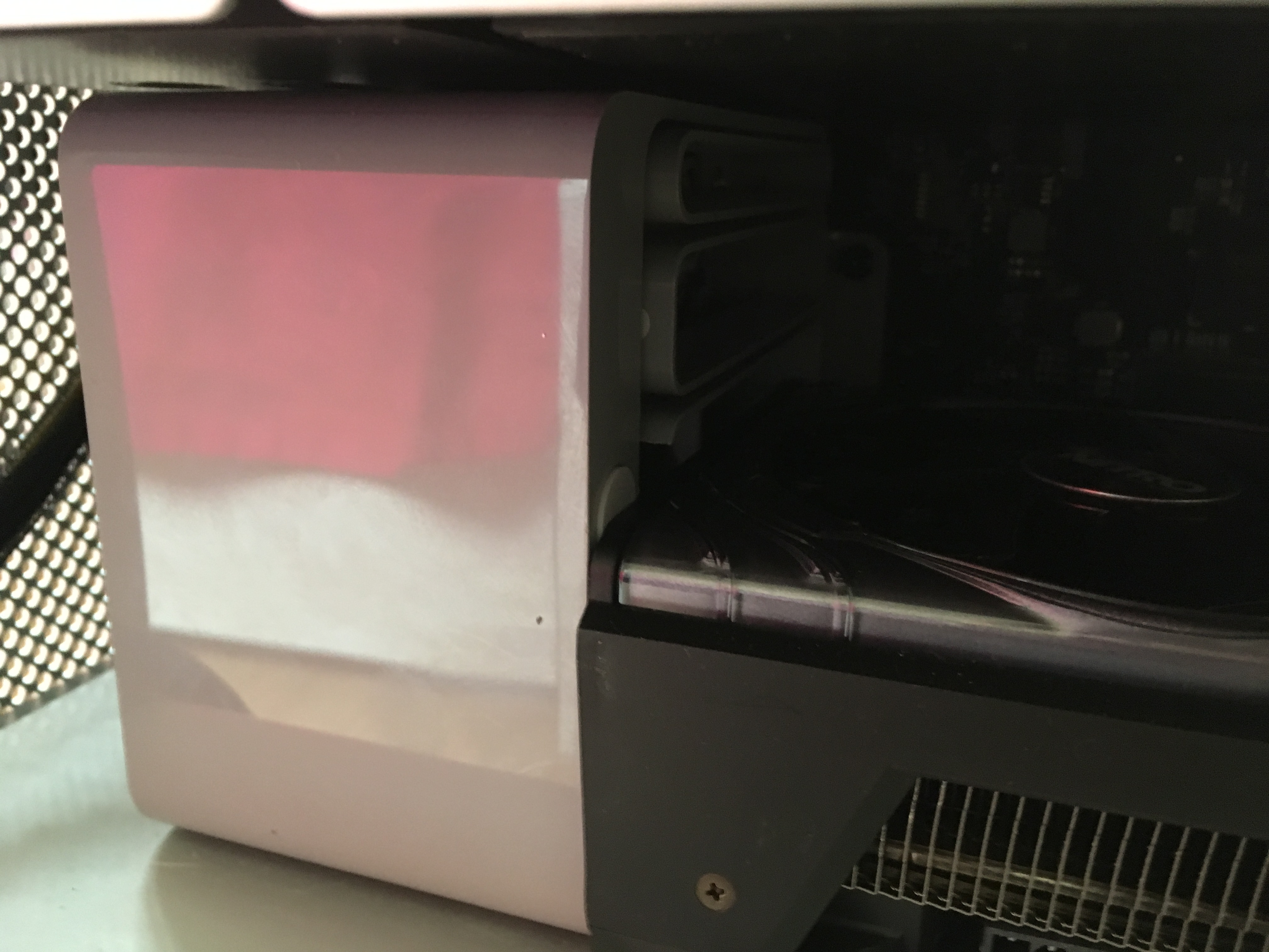

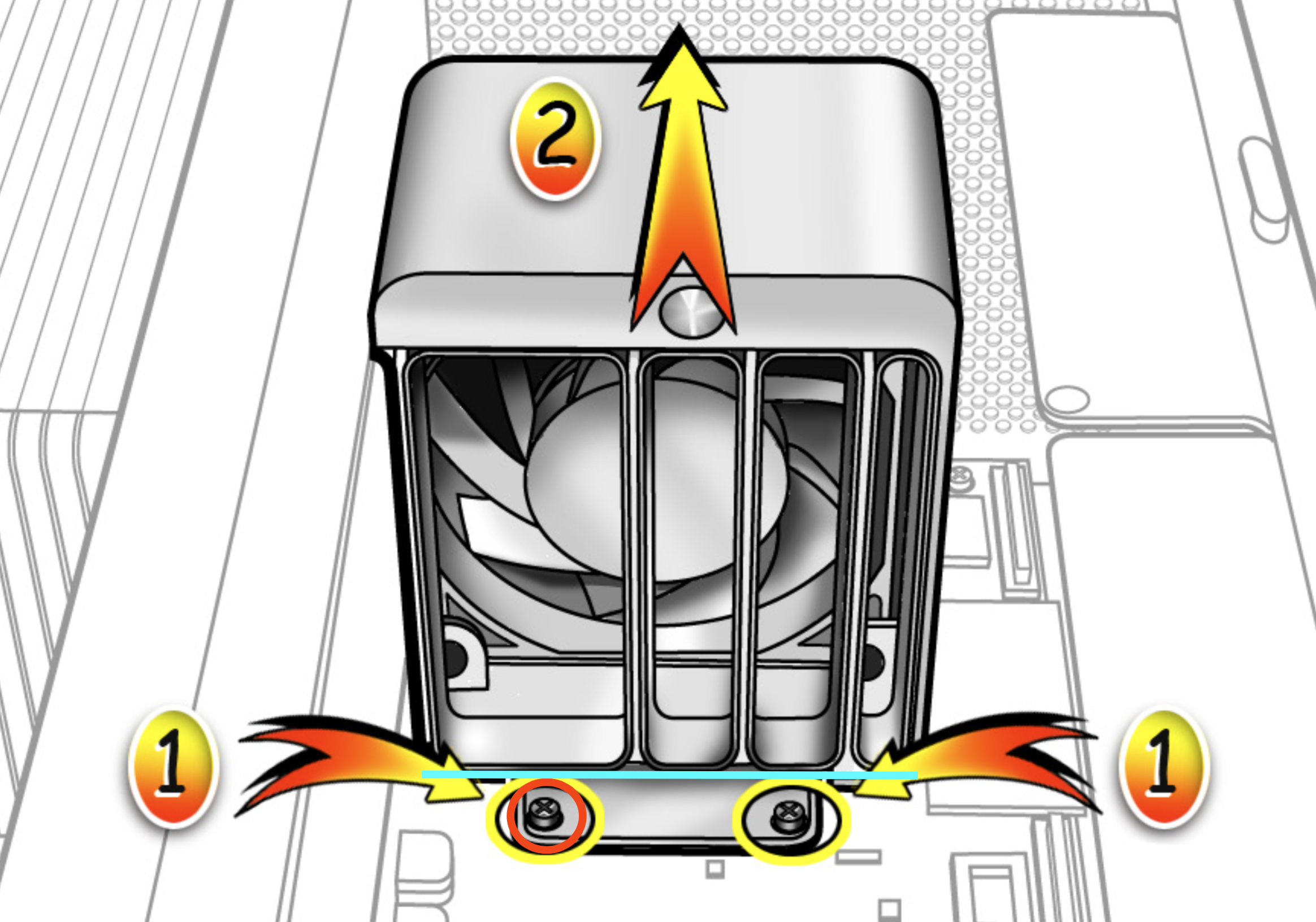

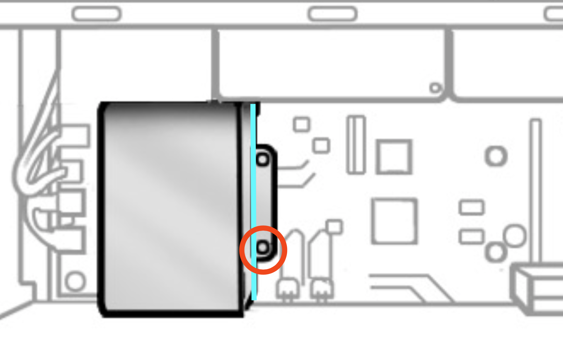

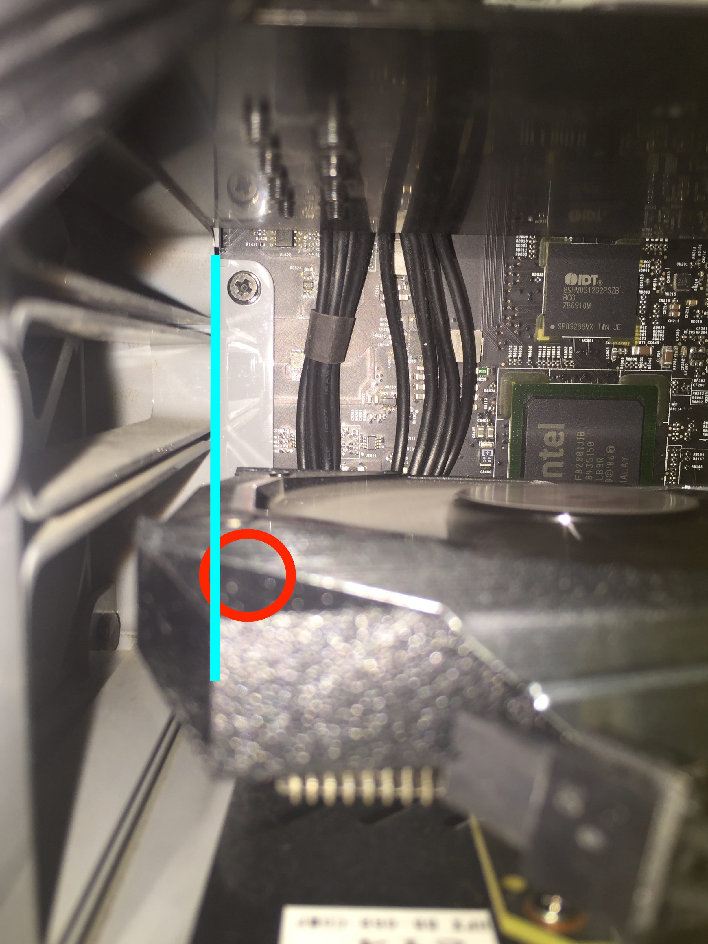

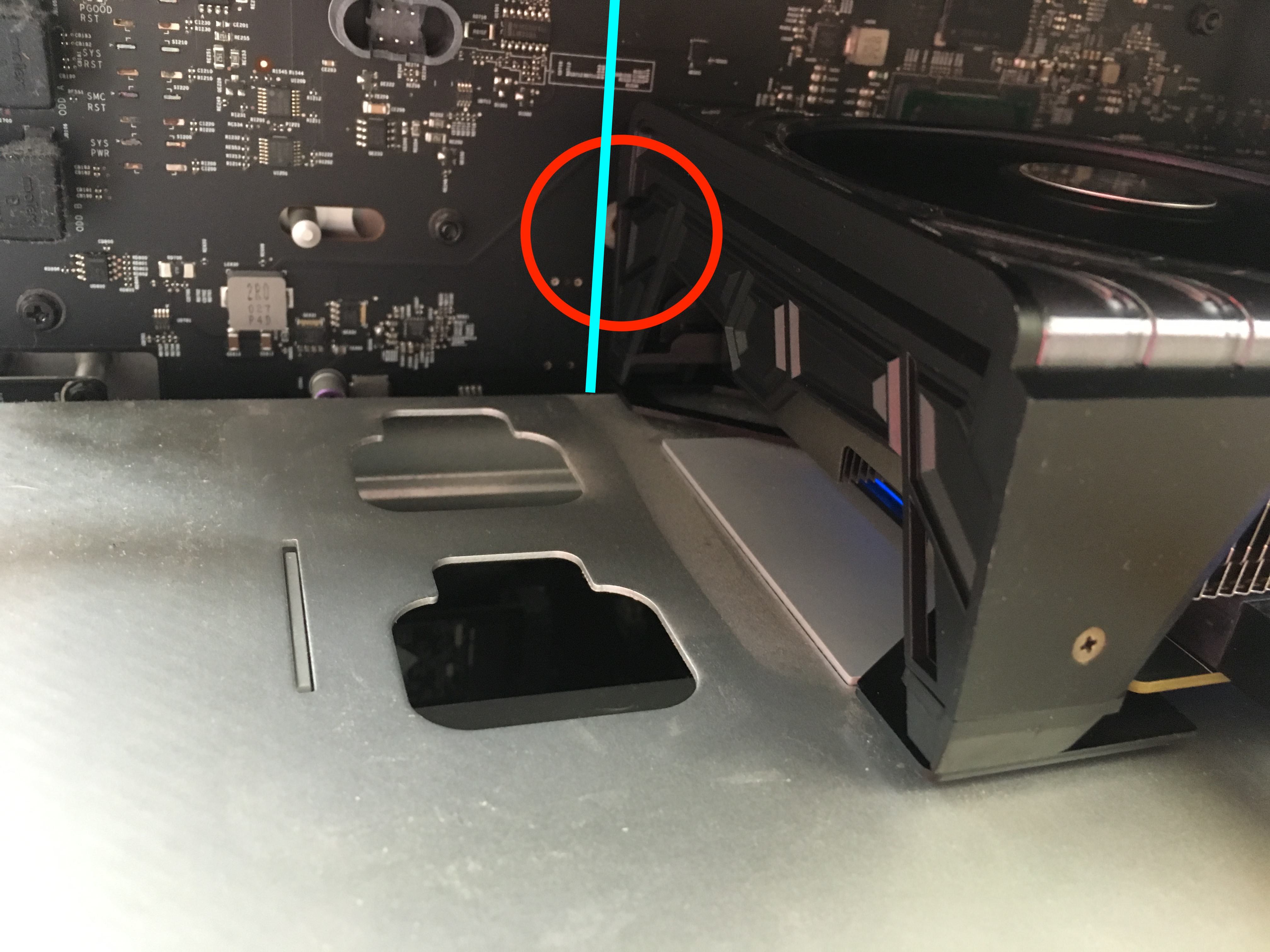

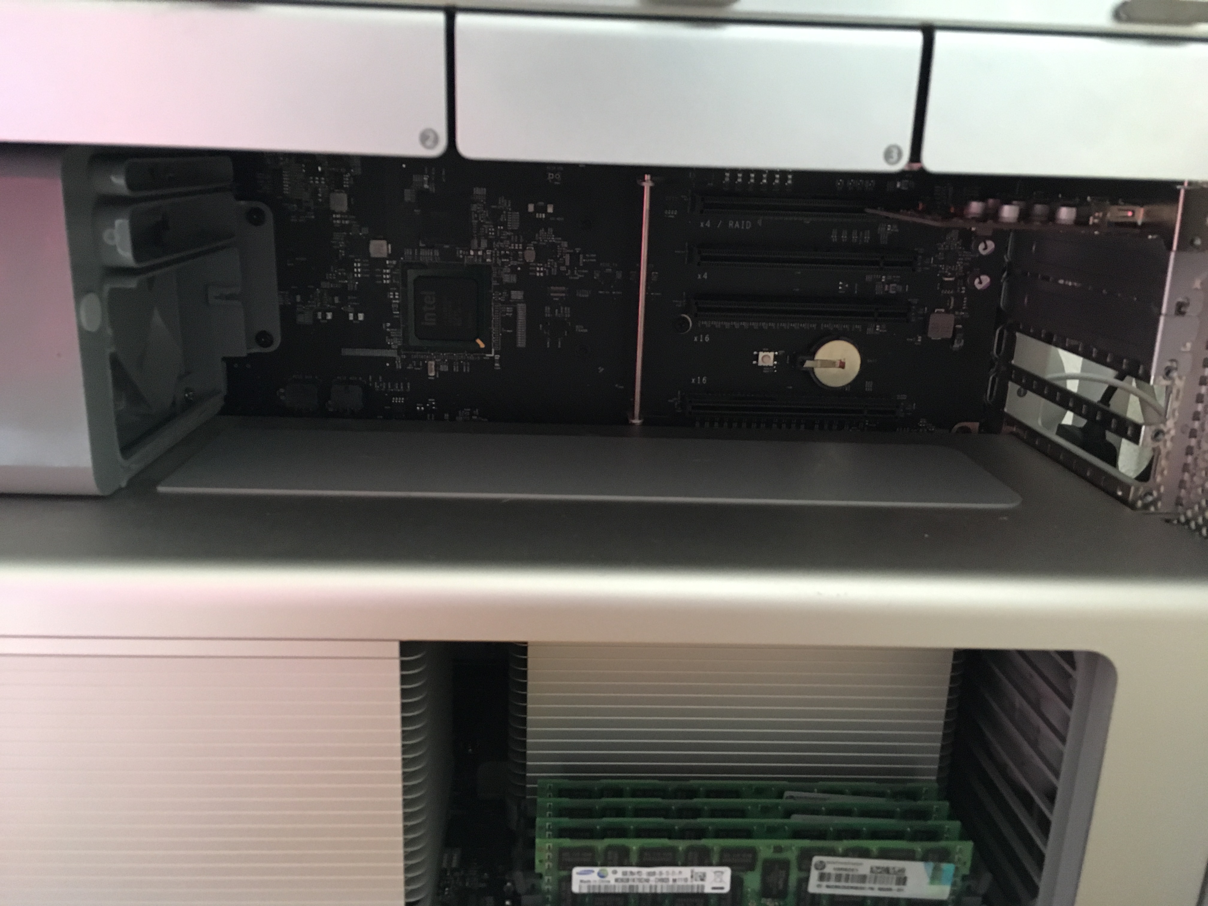

I double check your photos. I really suspect the card can just fit in with the PCIe fan installed.
I can still see the screw hole. That means the card hasn't pass the blue line (PCIe fan case) yet. Just cover the plastic plate which for mounting the fan.
It really looks like the PCIe fan can be there, even though may be the buffer is no more than 1-2mm.
I 100% trust you that there is some difficulties to install the graphic card with the PCIe fan still there. But I just wonder if that's "very hard to install, no room for error, must slide in at the exact correct position / direction" or "unable to install if the fan still there".
I can still see the screw hole. That means the card hasn't pass the blue line (PCIe fan case) yet. Just cover the plastic plate which for mounting the fan.View attachment 760469
View attachment 760471 View attachment 760474 View attachment 760473 View attachment 760470 View attachment 760472

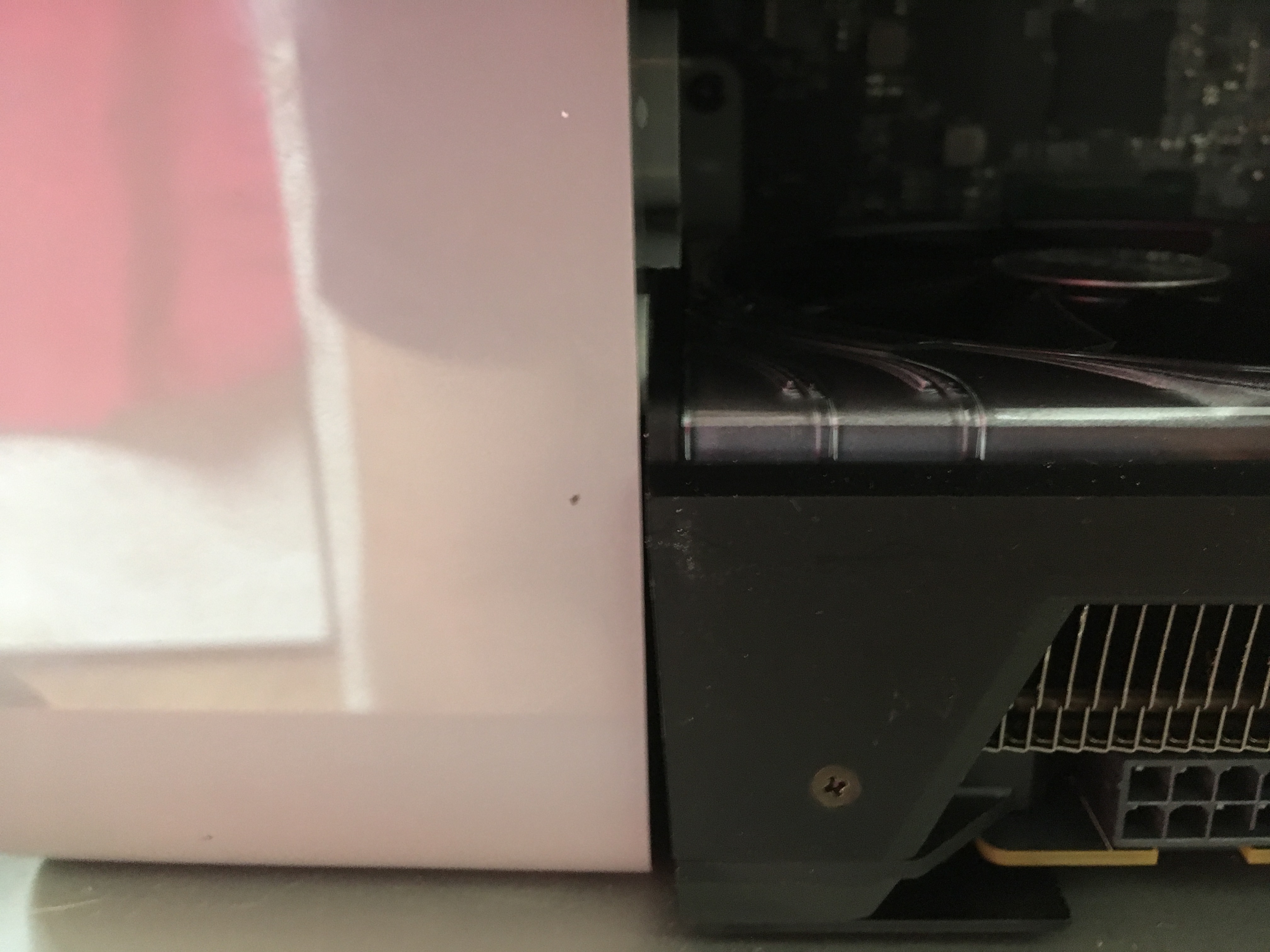

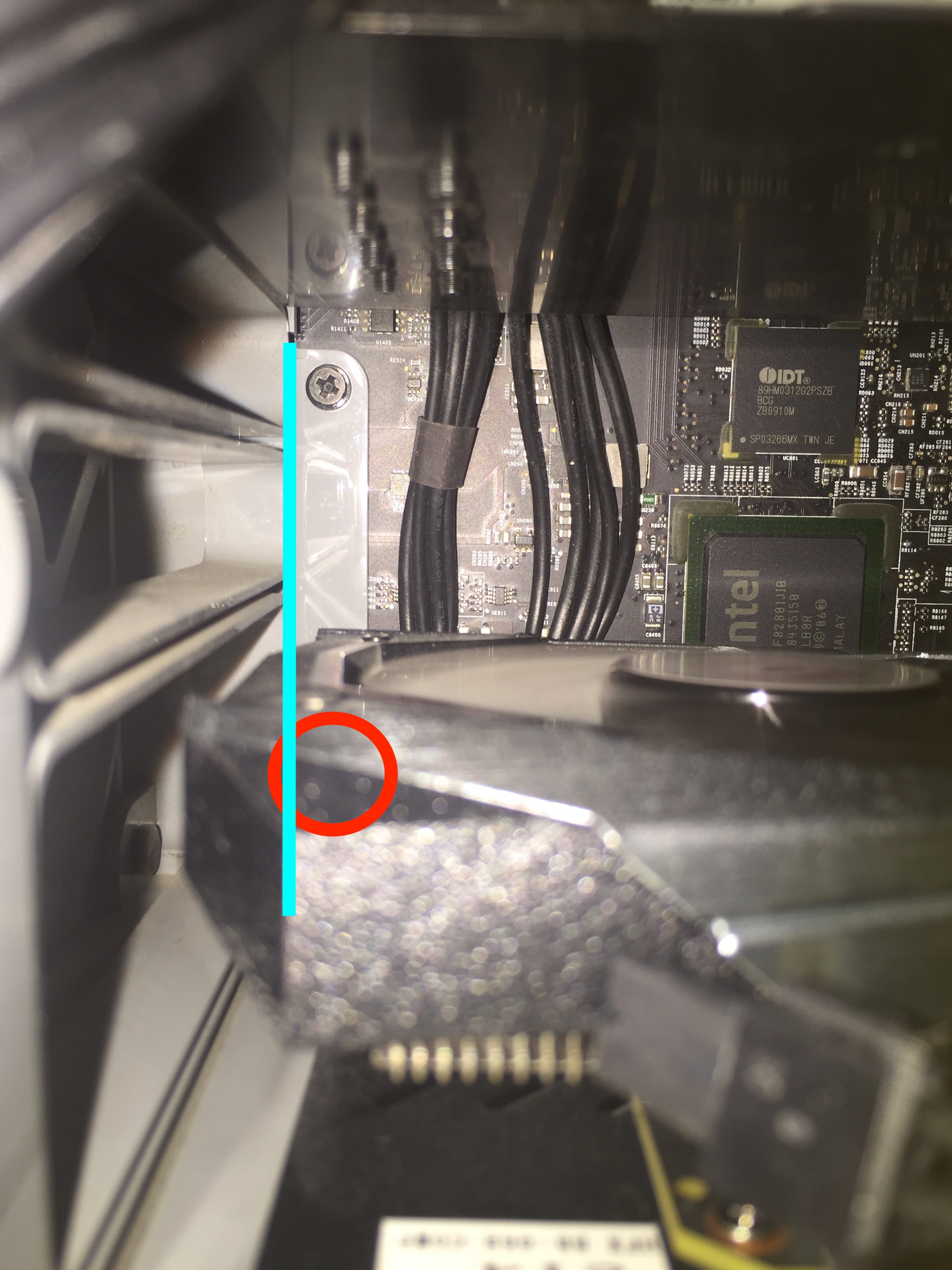

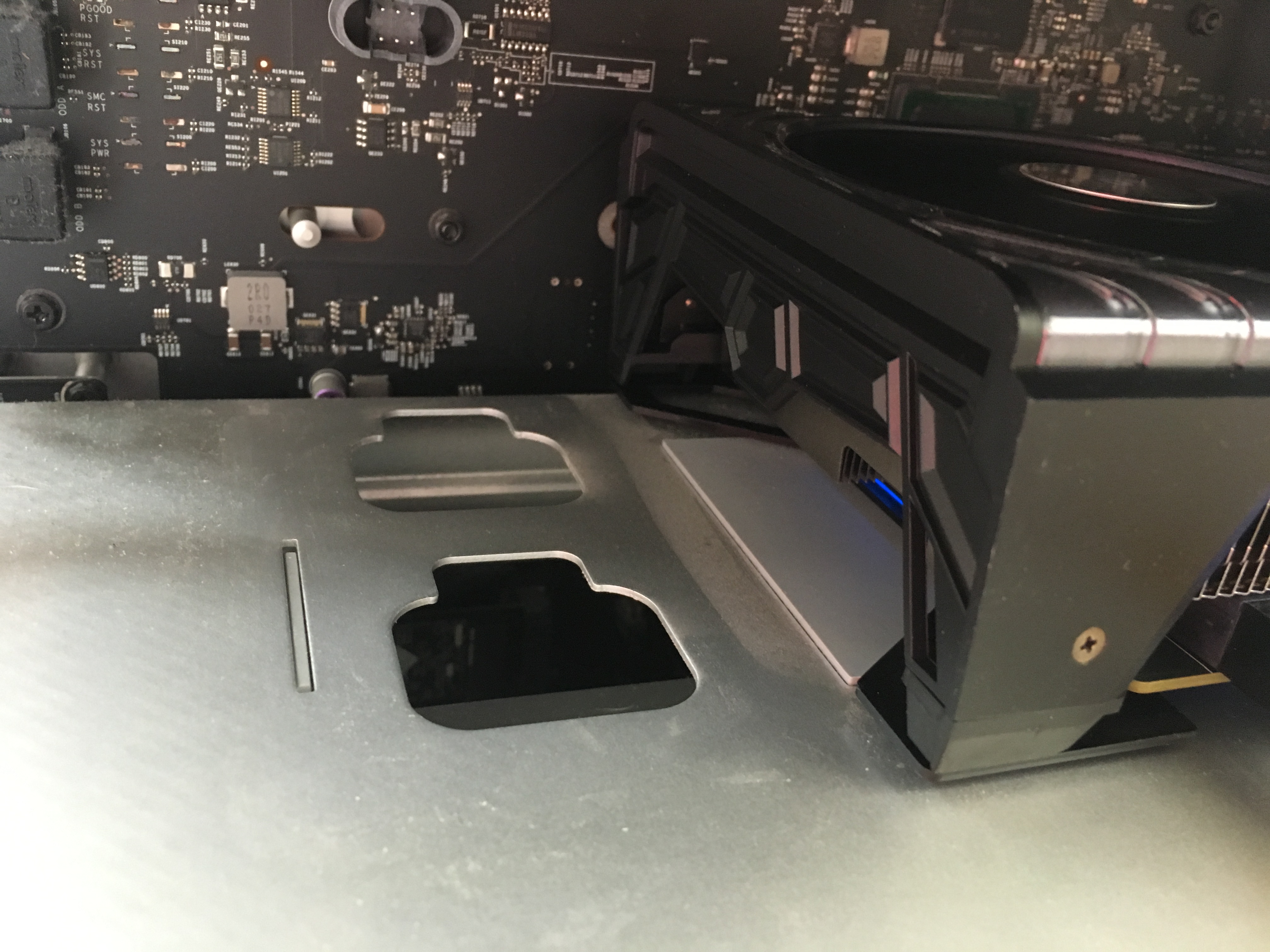

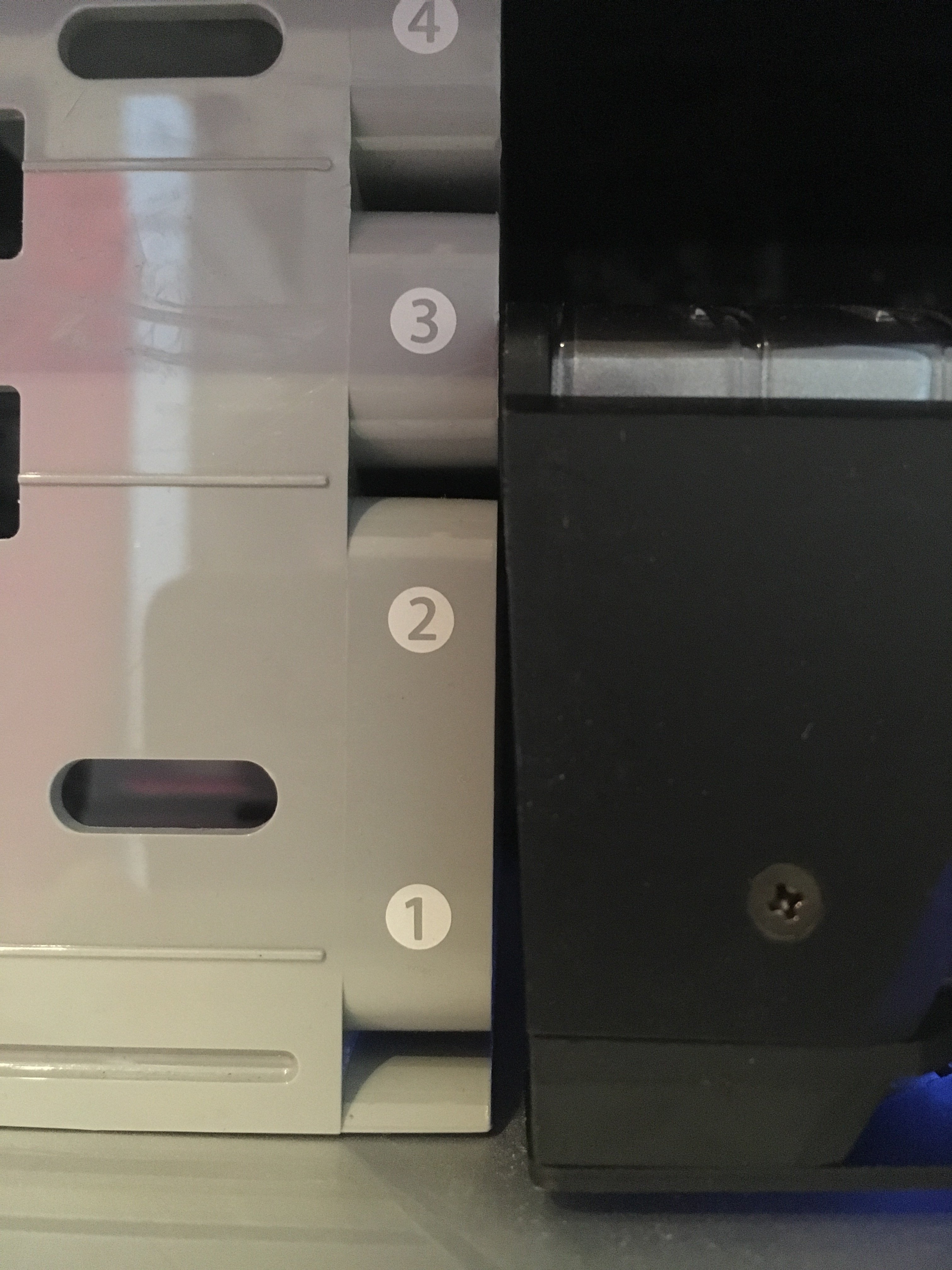

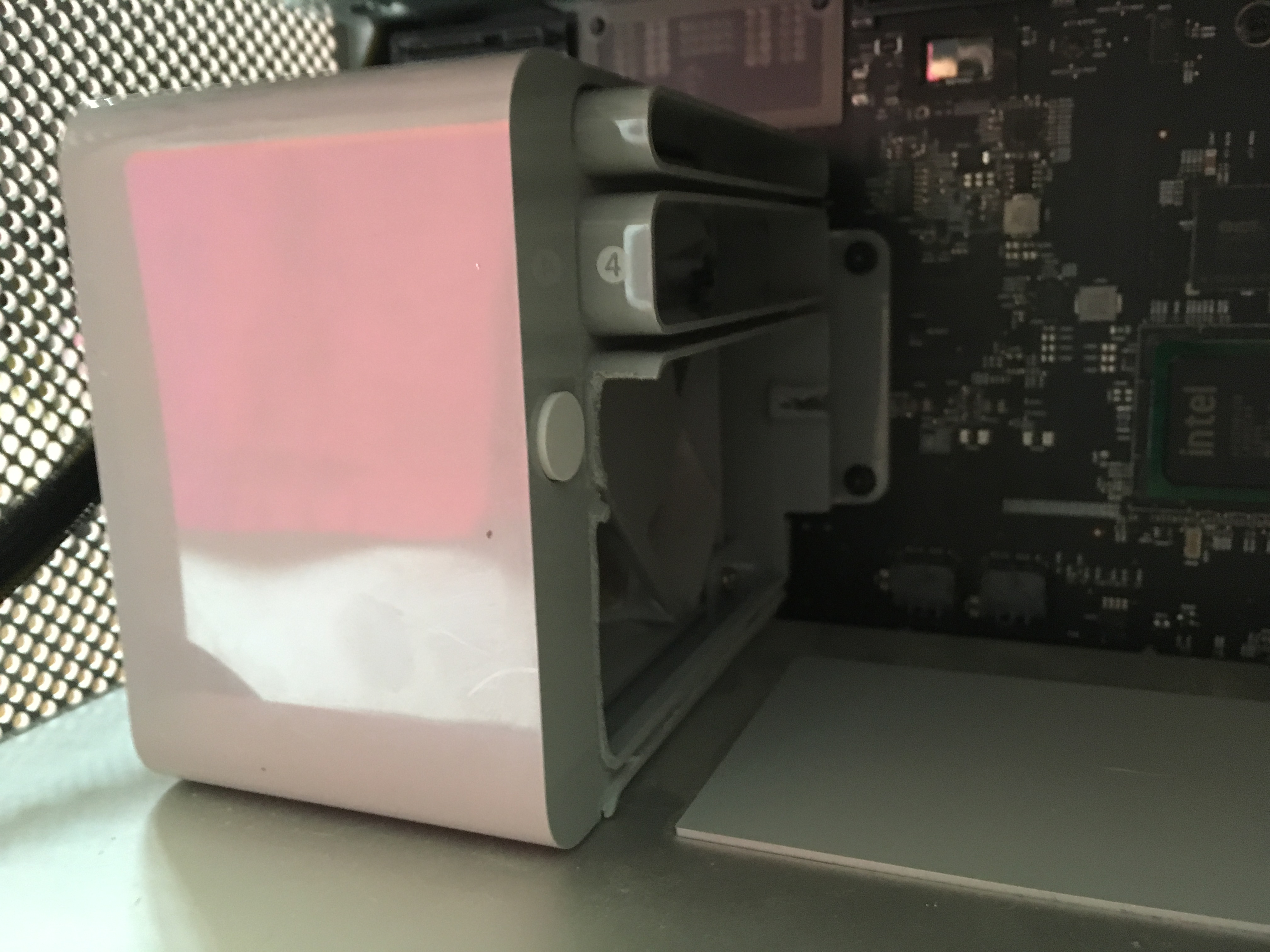

here you have better photos :)
1) top of card is longer than bottom
2) just in front the grey protection is shorter

I see. That explain why the card can't fit. Thanks for the photos. The pictures explain everything now.

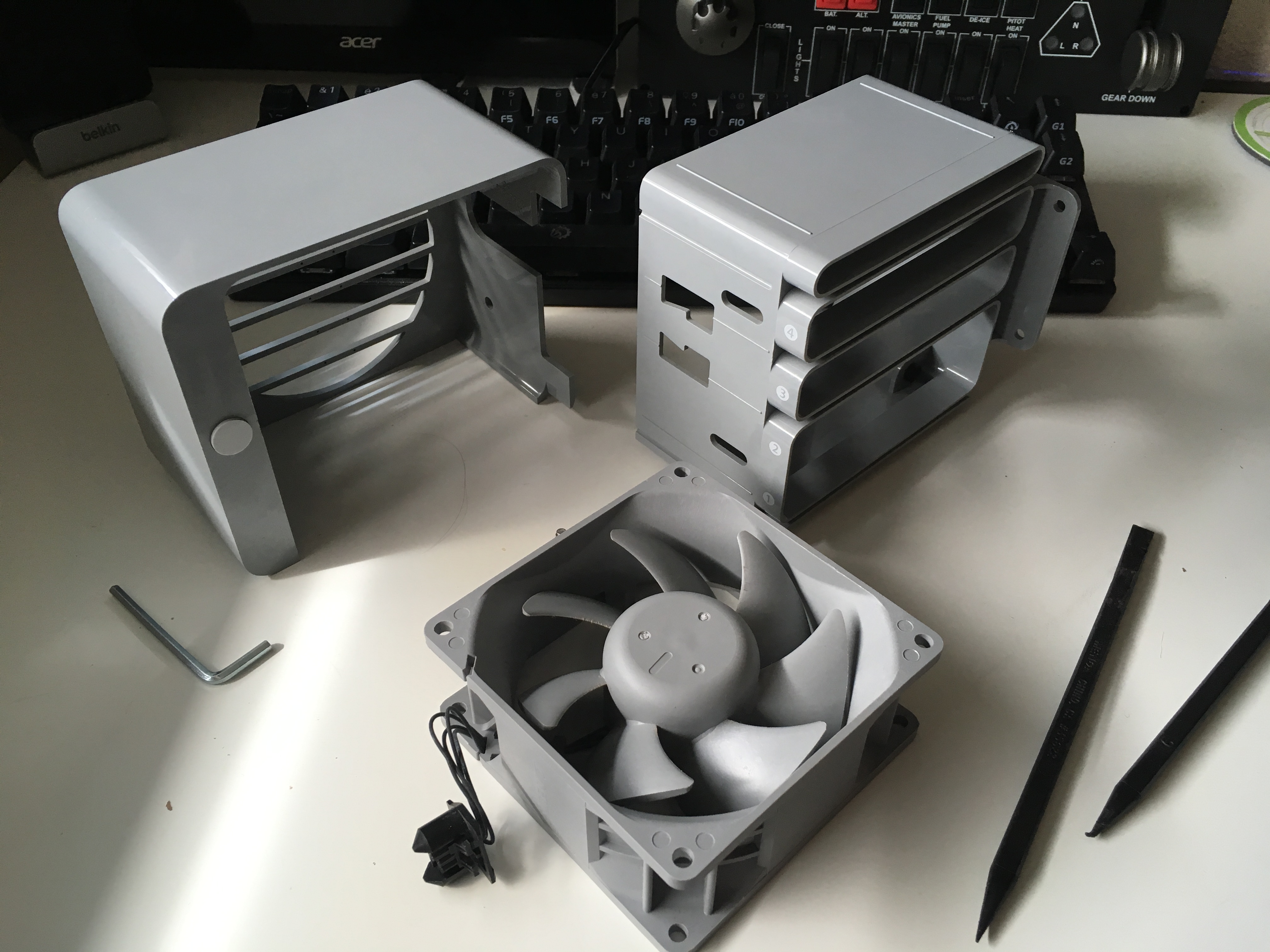

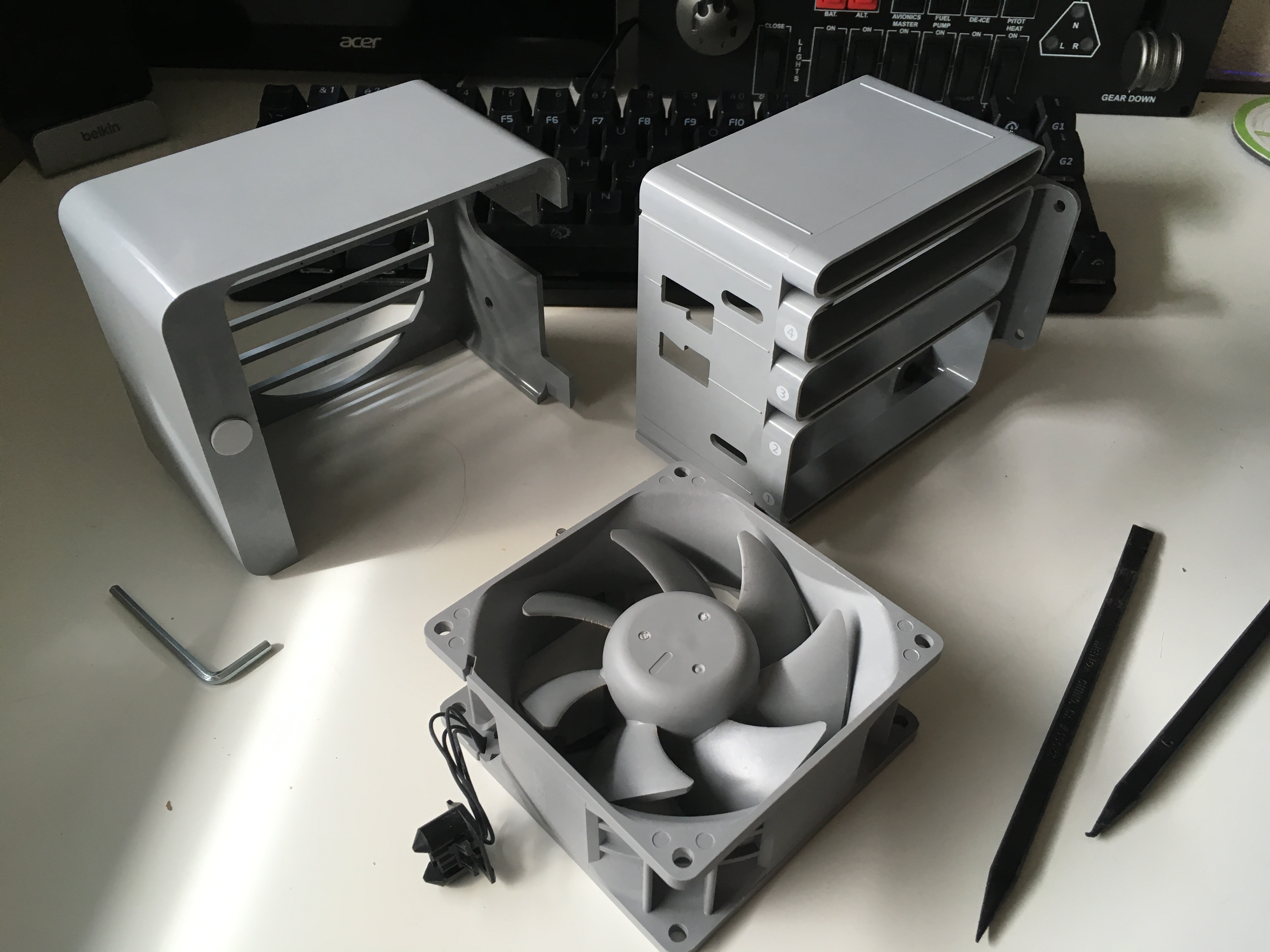

So here are my first fan modded pict. Not enought cause i cant close the security!!!
View attachment 760656 View attachment 760657 View attachment 760658 View attachment 760659 View attachment 760660
Leave the fan at open position is actually OK.
The metal plate on the other side is strong enough to hold the card into position. Especially the only large card you have is just the Vega 64, and it's basically sits on the CPU cage.
The fan itself can work at either open or close position. That's just a switch of that vertical metal bar.
Reactions: lilins

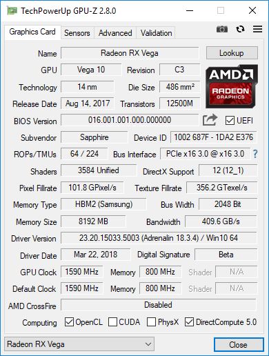

I've verified this is the primary BIOS for the Pulse 56 using GPU-Z: https://www.techpowerup.com/vgabios/199585/199585
And this is the secondary BIOS: https://www.techpowerup.com/vgabios/200514/200514
A nice surprise is that is has Samsung memory. If anyone's feeling adventurous you could try them on your reference 56 or 64 to see if it resolves the high fan speed issue. It looks like to bypass the subsystem ID mismatch you'd need to use these flags: atiflash -p 0 -f bios.rom
