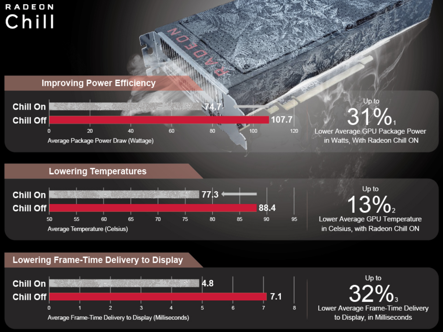

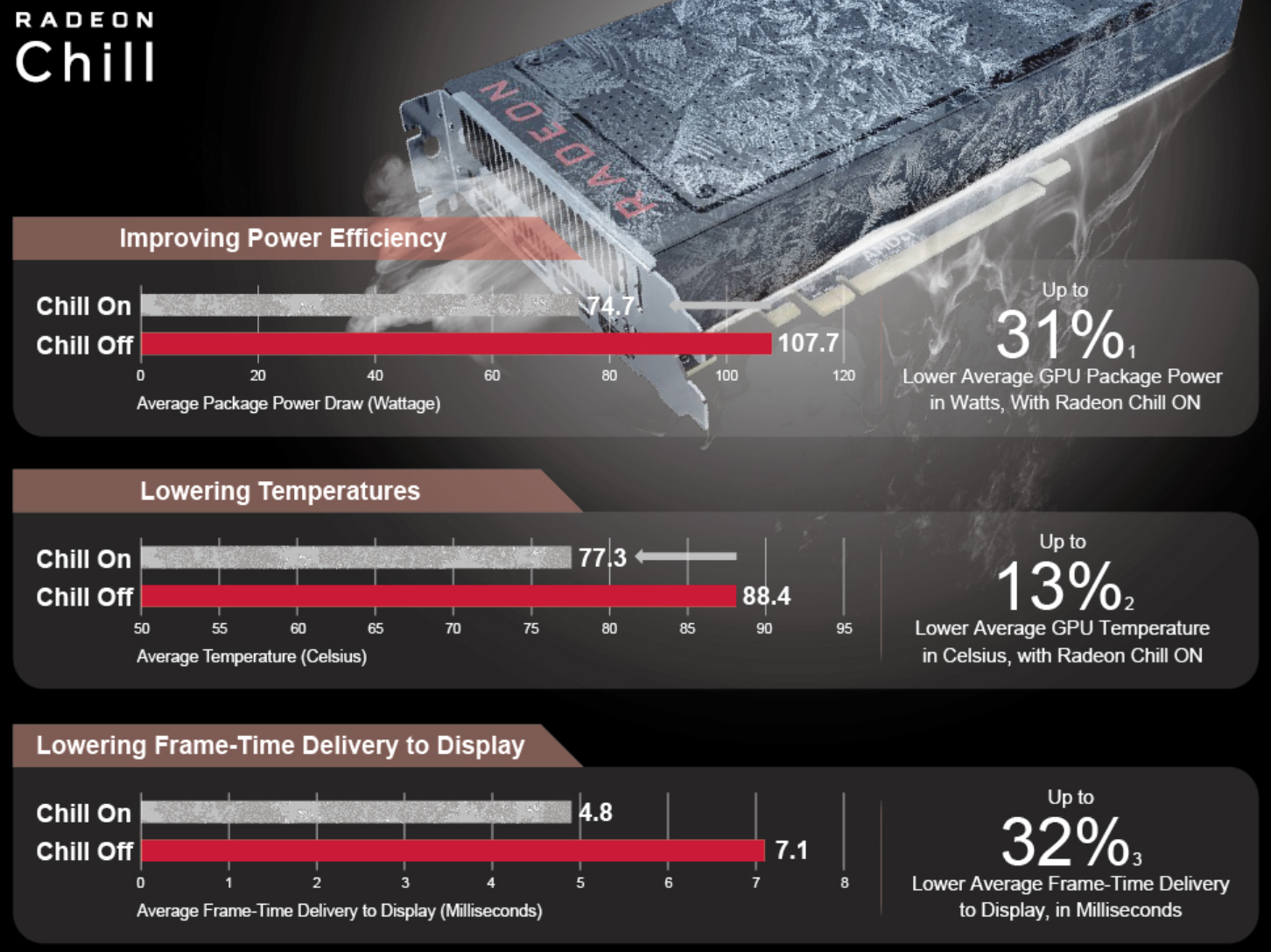

That Radeon Chill thing should has nothing to do with BIOS compatibility. It’s an AMD thing. All Vega GPU with the proper AMD Windows driver can do that. I bet they are just lazy to create their own chart, so, simply publish the reference chart from AMD. TBH, the card at the background looks like a RX580 but not any Vega.

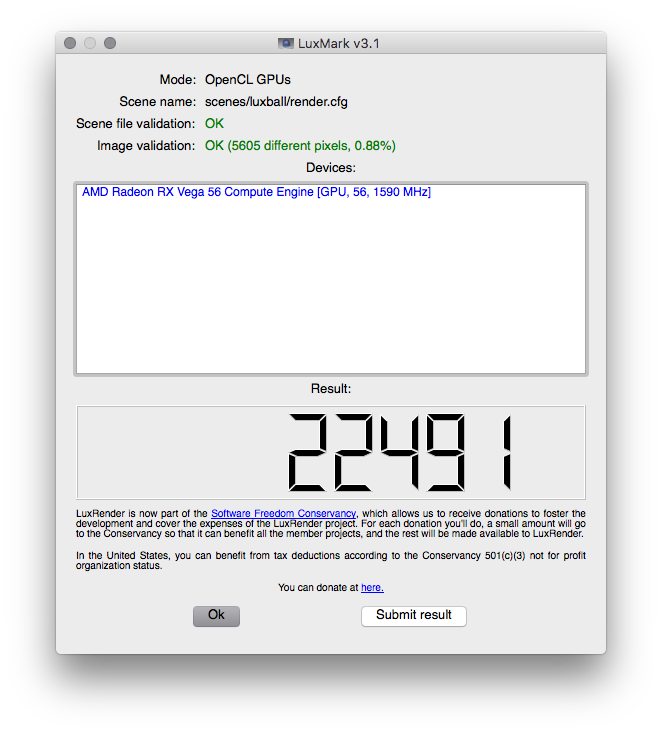

Luxmark:
I observed these values close to the end of a Luxmark run-through.
In addition to that I also observed the highest power draw during that test. Power draw on both PCI E Boost connectors was 7,99A. I didn't take a screenshot but it looked very much like being clamped to always stay below 8A. That equals 96W draw on each connector. No problem with that. But there was a problem with...

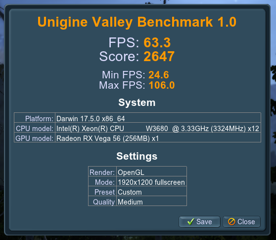

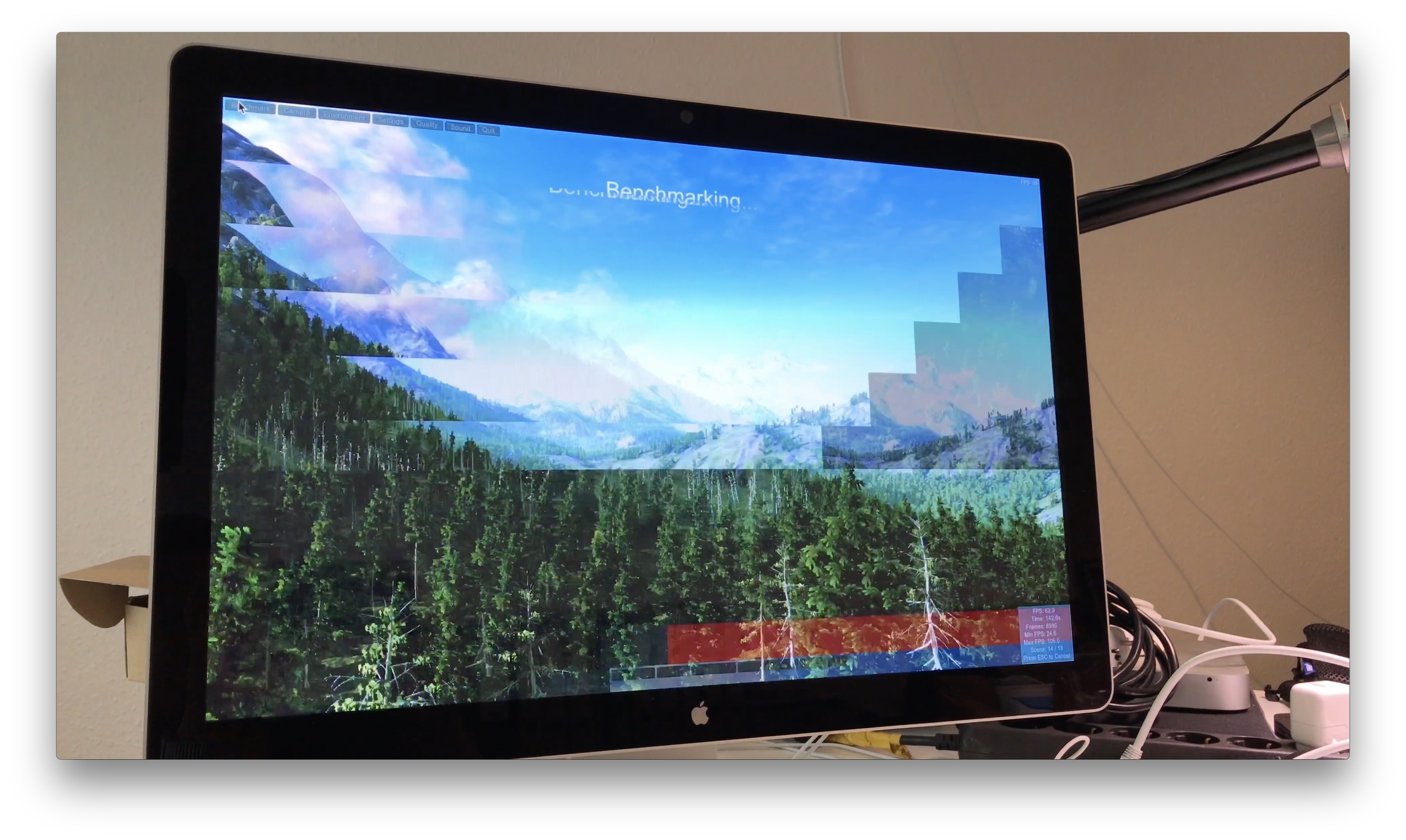

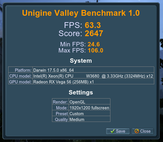

Unigine Valley:
Works. Power draw on both connectors barely crossed 6A (72W) during spikes.

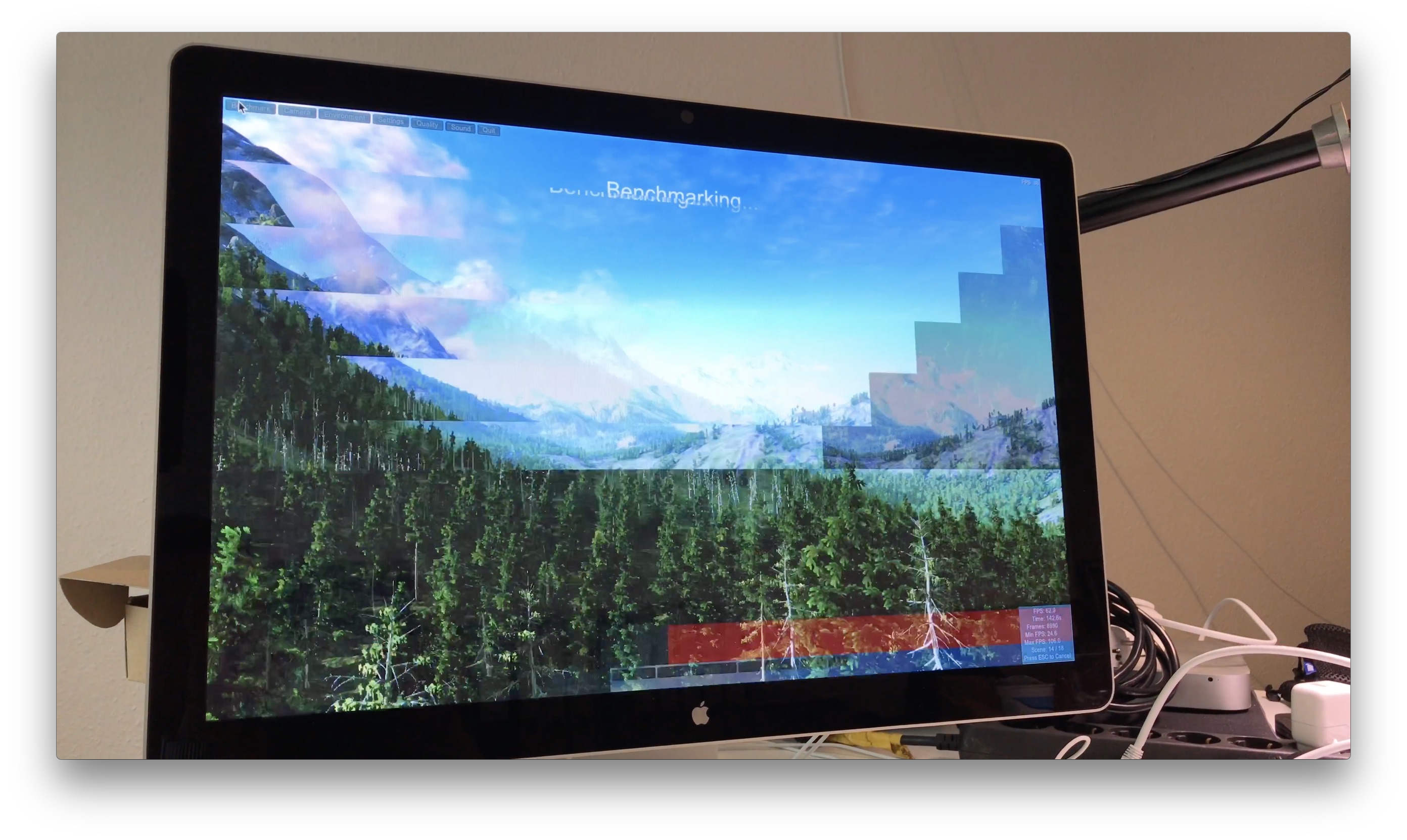

EDIT: The glitches mentioned below are only present with my old 24" Apple LED Cinema Display connected through a mDP to DP adapter. I just discovered that while connected to my main setup consisting of Sharp PN-K321 (needs a little hack to AppleGraphicsControl.kext to work in MST mode) and LG 27MU67 there are NO GLITCHES.
Sadly it's a good example for another major caveat. There are very short full-screen glitches from time to time (see below). They do happen immediately when some visually taxing application is running, so they are not temperature related. Maybe it's limited to OpenGL2, I will have to investigate this further.

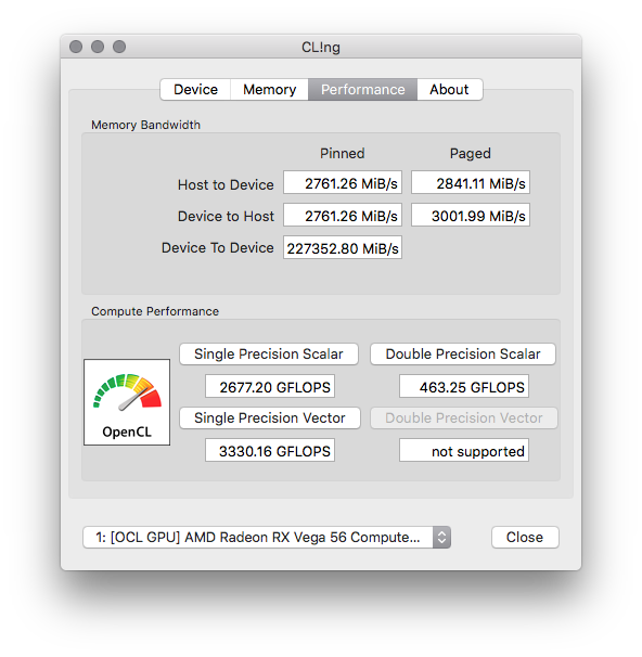

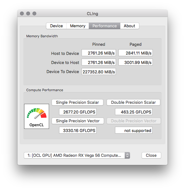

CLing:
Also threw that in for good measure.

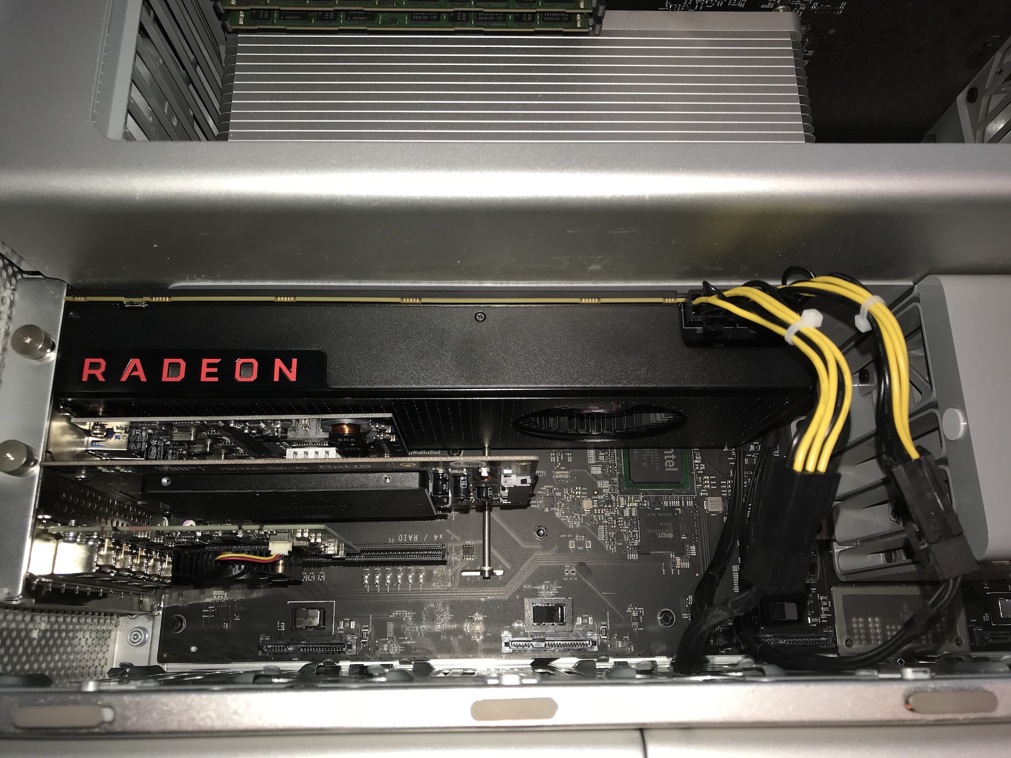

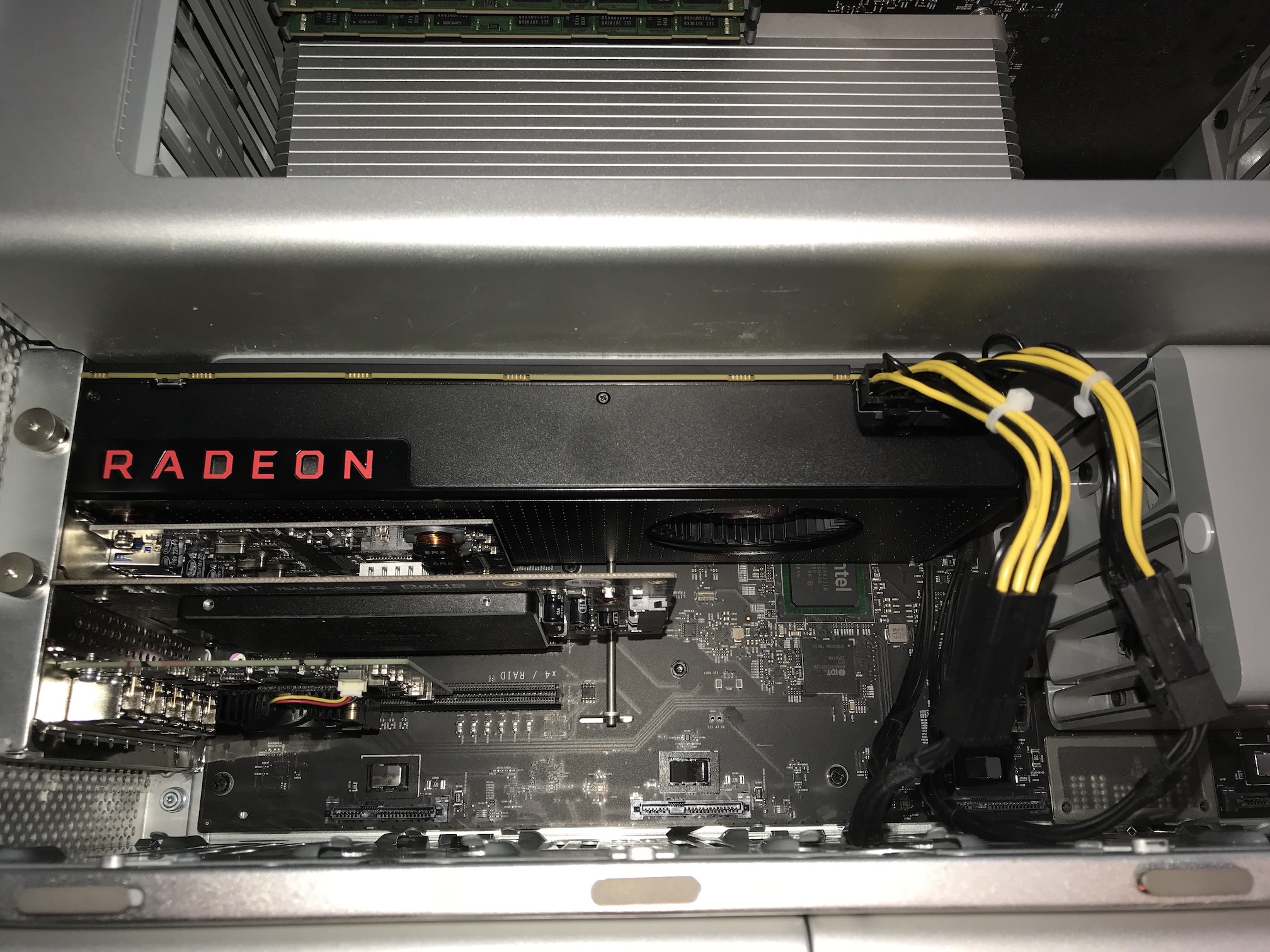

Setup:
This is how it looks inside right now:

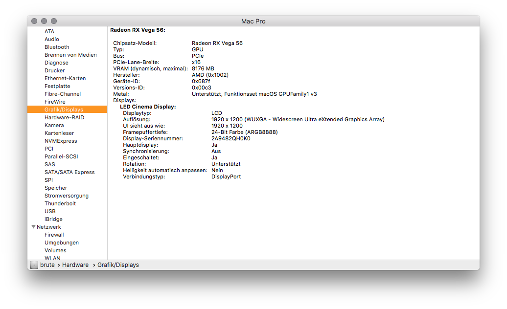

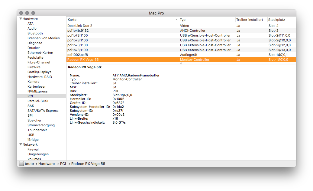

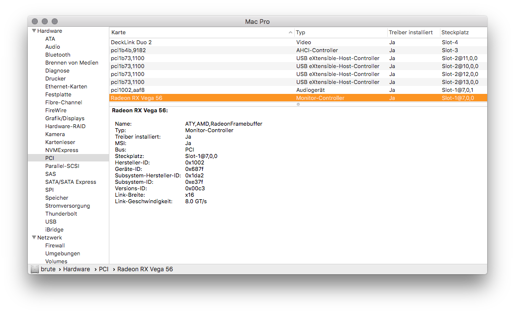

And this is what the system sees:
Bildschirmfoto 2018-05-15 um 12.57.55.png Bildschirmfoto 2018-05-15 um 11.05.15.png

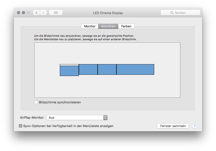

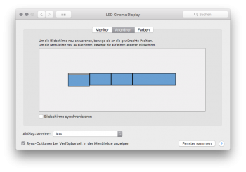

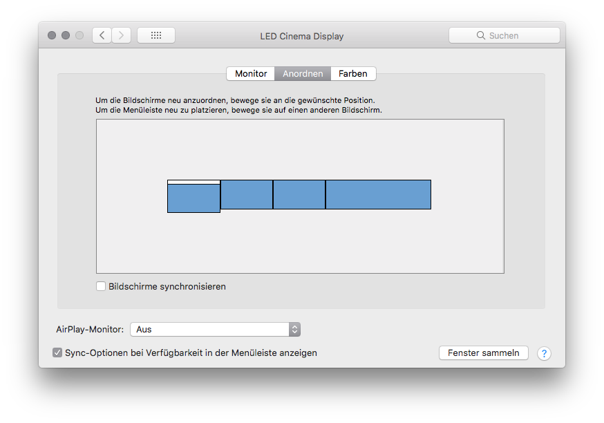

Ports:
As there's a mismatch in the port layout (reference 3x DP, 1x HDMI, nitro 2x DP, 2x HDMI) I was curious what would happen here. The two left-most DP work as expected, so does the HDMI port. They can all be used simultaneously. It was even possible to use a DP to HDMI adapter and get a second HDMI signal from the third DP. That unfortunatly produced UI-lag but I managed to take a screenshot.
Taking into account how finnicky the digital connections are nowadays I think it's completely possible that the use-all-four-ports scenario might as well work on another day without UI lag.

Overall I'm pretty happy with the result. EDIT: the glitches were caused by the connected monitor, not the card /*I can live with the glitches for now. I have some hope that they will improve with 10.13.5 or I'll find a way to mitigate them in my actual use case.*/ Aside from the looming system shutdown in extreme conditions the system seems very solid. I will edit this post with more observations as they happen.

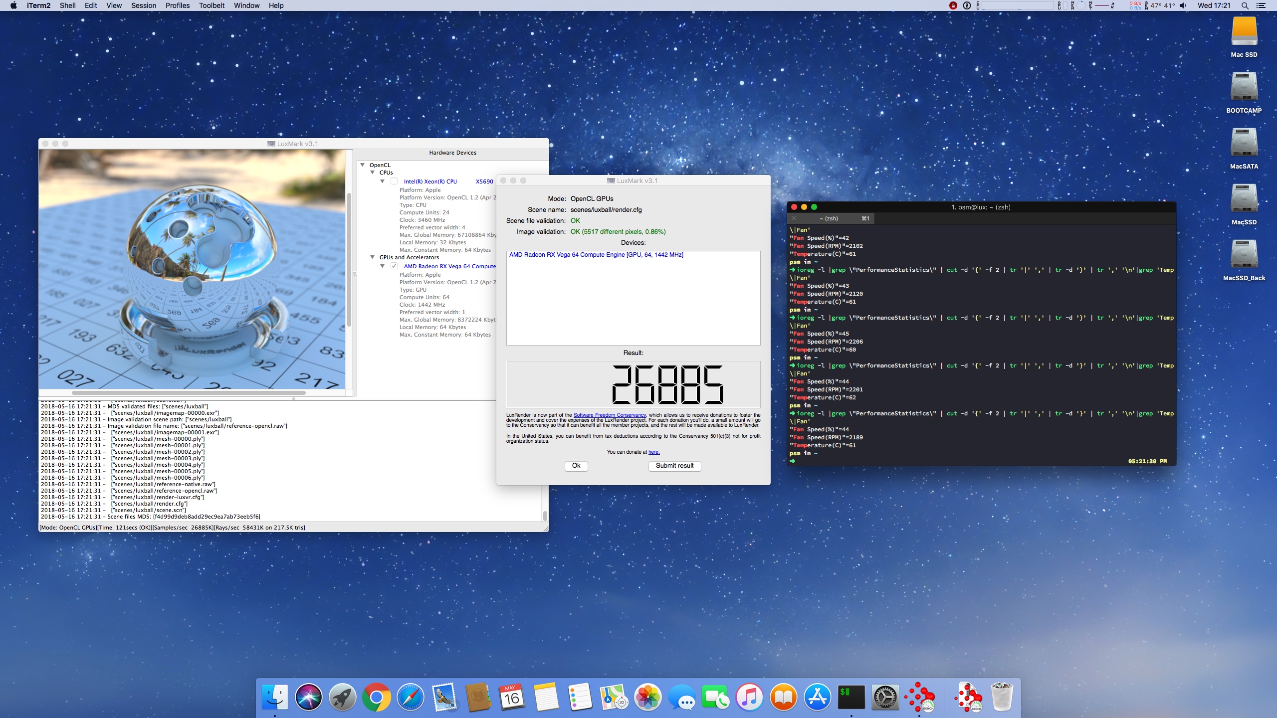

I agree, that was also my thinking. It really works for the most part. My observations until now follow below.
Fan behaviour:
The fans do shut off completely on idle, as you might have experienced with other cards before. Idle temp is around 35°. It's a little annoying that simple things like scrolling a web page can make the card turn its fan on and then quickly off again. Since it's just one blower, it's quite audible even with low RPM. Still, that's a LOT better than having it spin all the time like mad! Stressing the GPU let's it spin up the fan just as expected. The highest RPM I observed was close to 2500 RPM. Temp was 75° at that point. That brings me to the next point.
Luxmark:

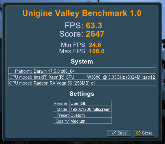

Unigine Valley:
Works. Power draw on both connectors barely crossed 6A (72W) during spikes. Sadly it's a good example for another major caveat. There are very short full-screen glitches from time to time (see below). They do happen immediately when some visually taxing application is running, so they are not temperature related. Maybe it's limited to OpenGL2, I will have to investigate this further.
CLing:

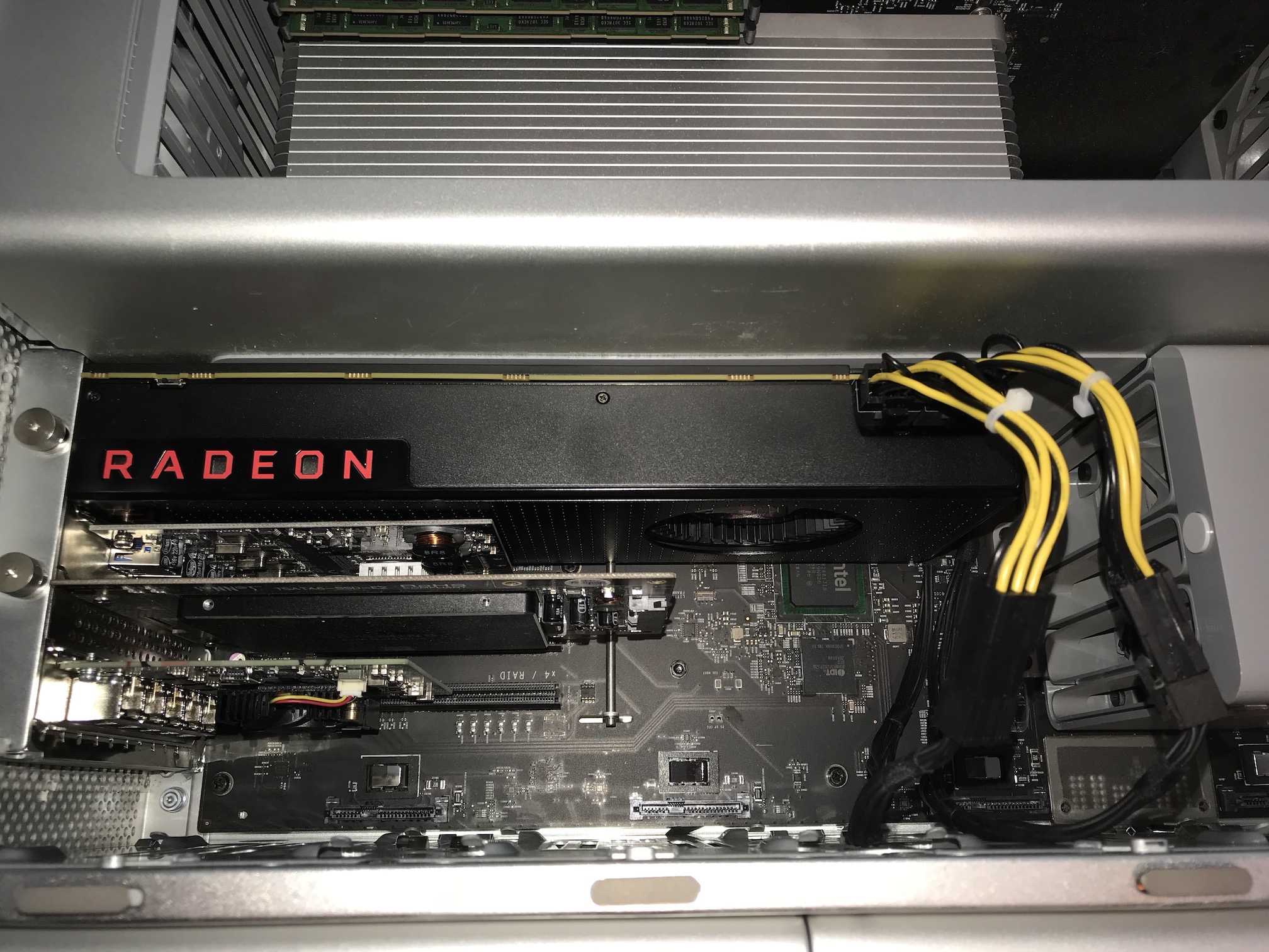

Setup:

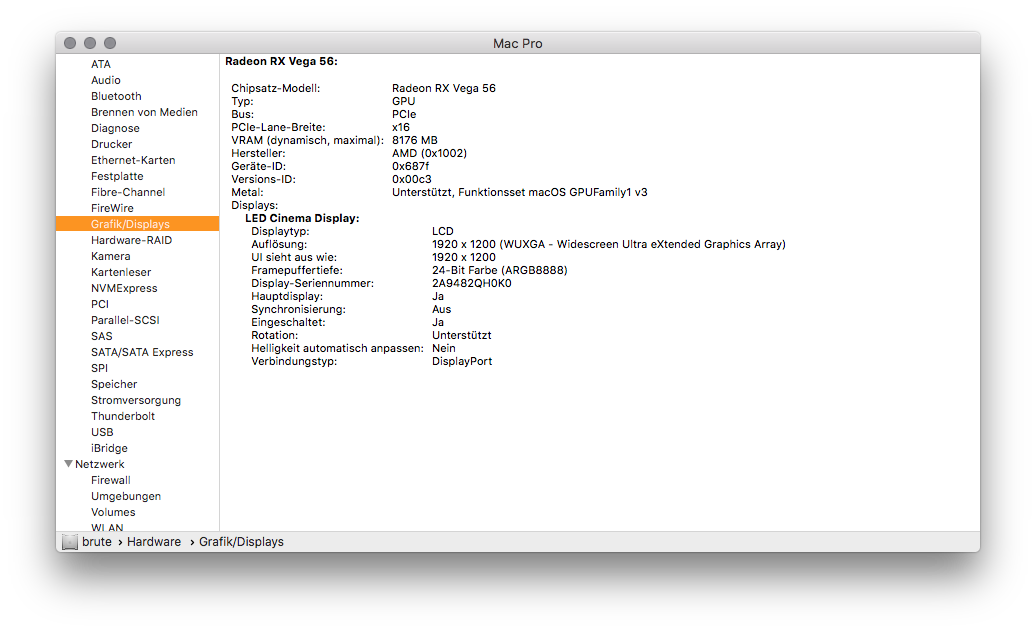

View attachment 761831 View attachment 761832

Ports:

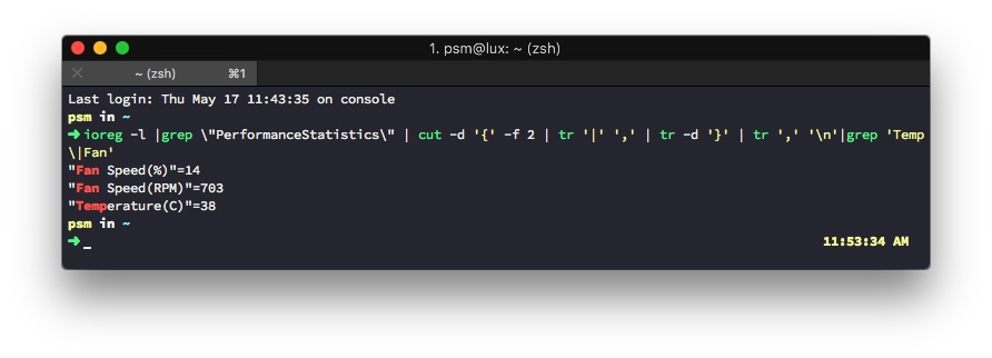

So, I've played a bit with the modifications that can be done in the kext and I managed to get my Asus ROG Strix Radeon RX VEGA 64 8G Gaming to work fine with correct fan speeds.
When in idle mode, the fans run at 700 rpm:
If I run a graphic test, luxmark, Valley, Heaven, I can see the fans speed going up starting 57°C (that's one of the settings set in the modified kext) and I've seen them going up to +3000 rpm, and also I get pretty good results (probably not as good as when not doing the modification though):
PROS: fan speed tunning is working fine
CONS: you need to disable SIP (or at least kext signing and filesystem modifications), the modification sets clock speed for the core lower than what my card can do, so I may try to modify that again.
I'm quite happy with that, I know I'll have to modify the kext if it gets updated over the following macOS updates but that's ok.
