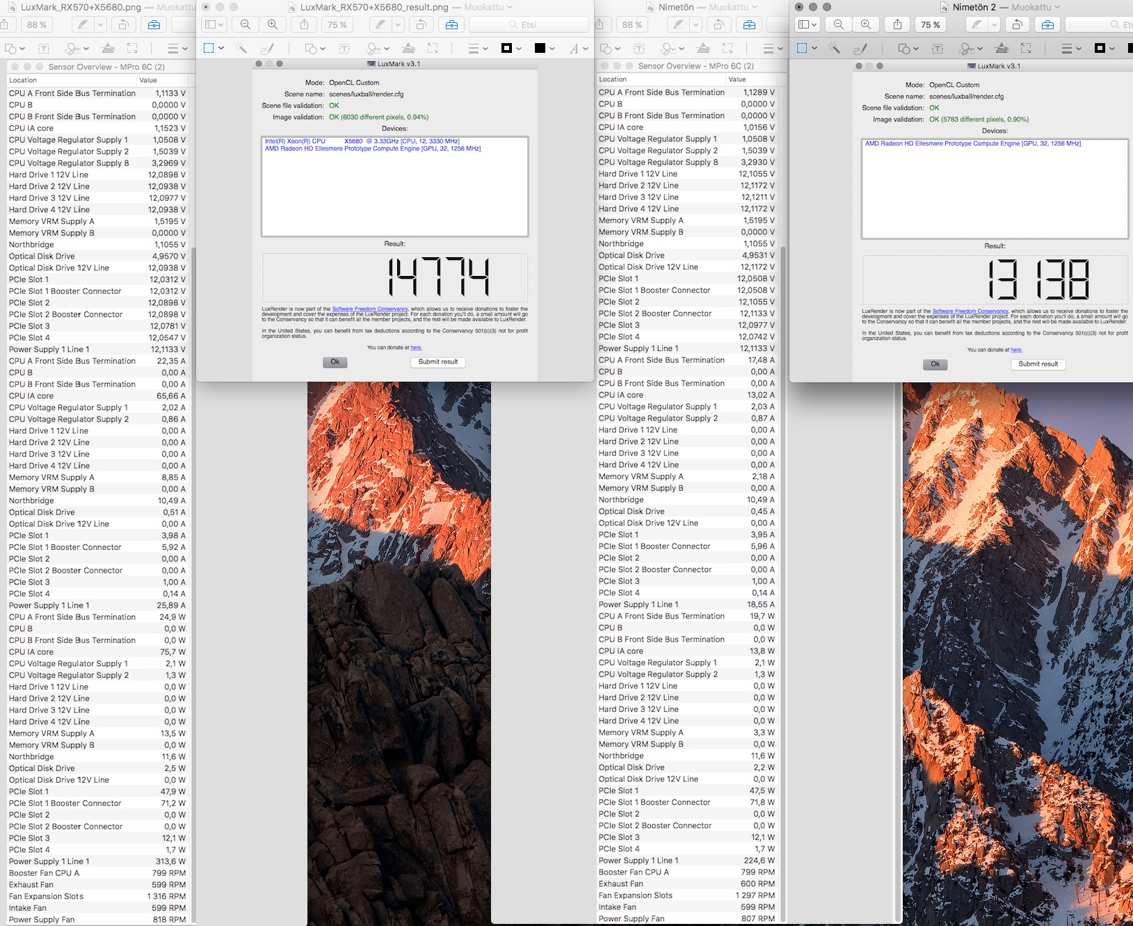

By booting the LuxMark bench the fans of the Mac Pro that increase in revolutions are those of Expansion Slots and Power Supply .... is it normal or should they stay at the default speed?
The LuxMark bench is 12913.
I noticed that with the old ati 5770 the fan that increased rpm with luxmark bench was only that of the Expansion Slots and not that of the Power Supply.

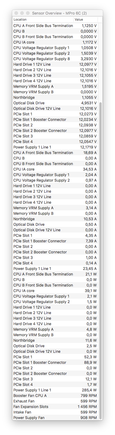

Asus RX570 OC 4GB: Power Supply Fan just about 900 RPM then card was loaded by extreme graphics, and that's after 10-15 minutes maybe with Unigine engine to make sure there is a good load.
In LuxMark the card didn't draw quite that much power than in Unigine. Watts stood just around 70W all the time, and fans stayed at around 800RPM:

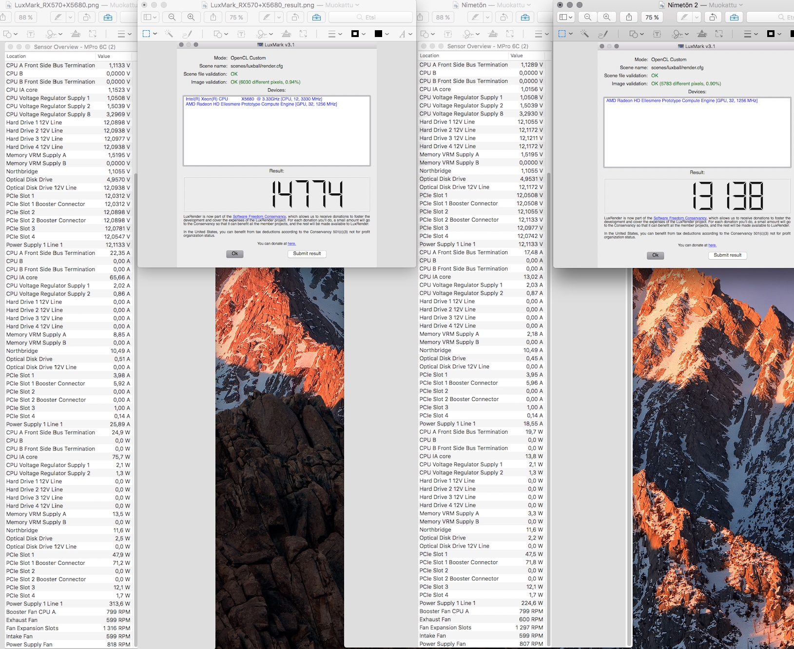

In Luxmark PS RPM gets up to 818 (after two minutes) if I test both RX580+X5680.
In Luxmark PS RPM gets up to 807 (after two minutes) if I test only RX580.
You can read the watts for CPU and RX570 from the tables.
I suppose it should depend whether you are testing multiple openCL devices, or just one. The more devices, the more watts consumed and the higher the RPMs. As we can read from my measurements, the difference is quite minimal in LuxMark - at least in my case it is.
By the way, I used only one mini 6-pin to 8-pin with RX570, and it worked just fine. You can see there was almost 90W drawn from a single mini 6-pin motherboard connector (The spec says 75 W). I ran out of cables because I bought a new card (Sapphire RX580 Pulse 8GB), and just wanted to test this scenario by myself too. I don't know if this was to have any effect to my measurements and their usefulness.
FYI: I'm gonna use 2x6-pin to 8-pin from now on, just received the new cable.

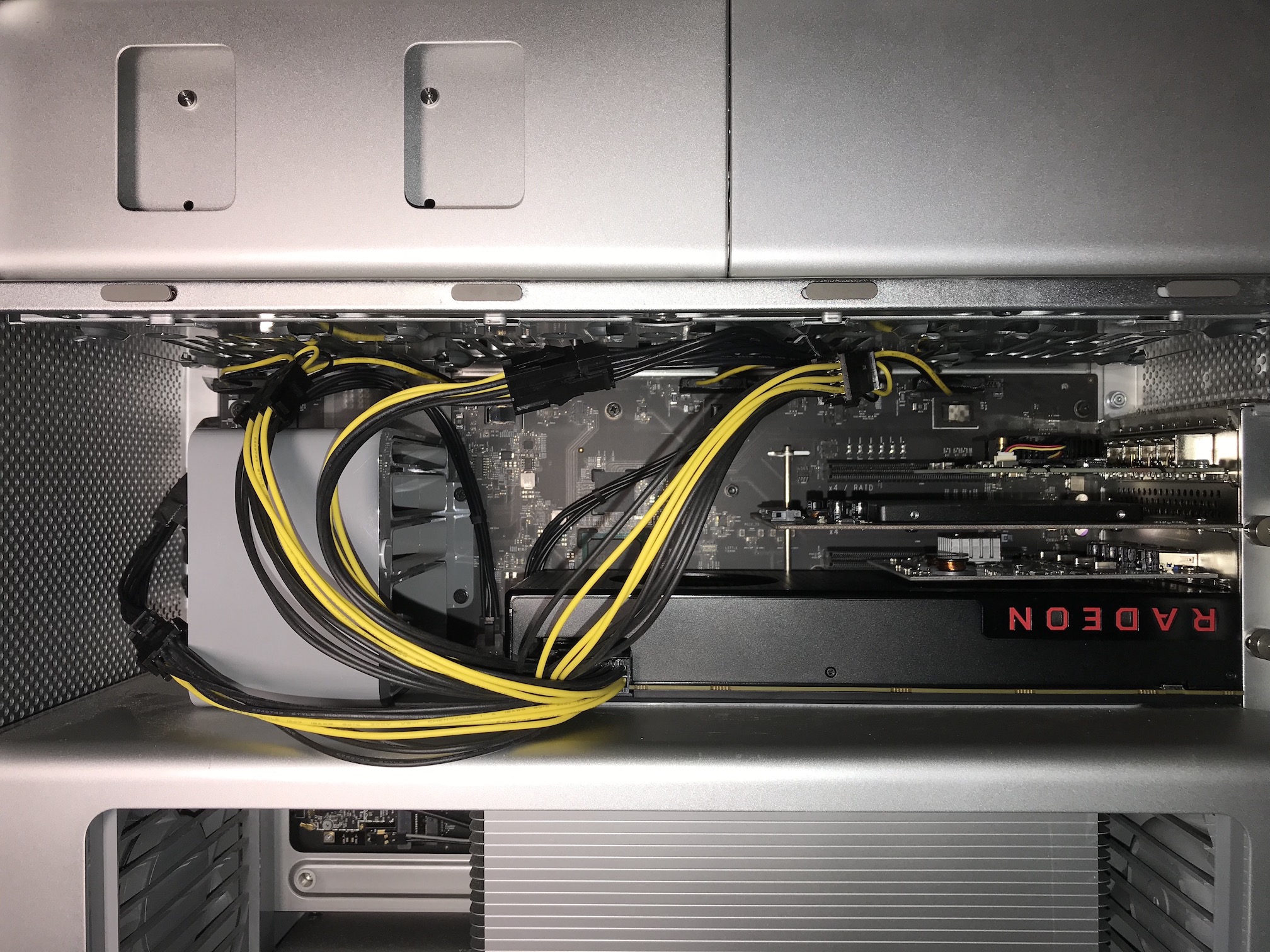

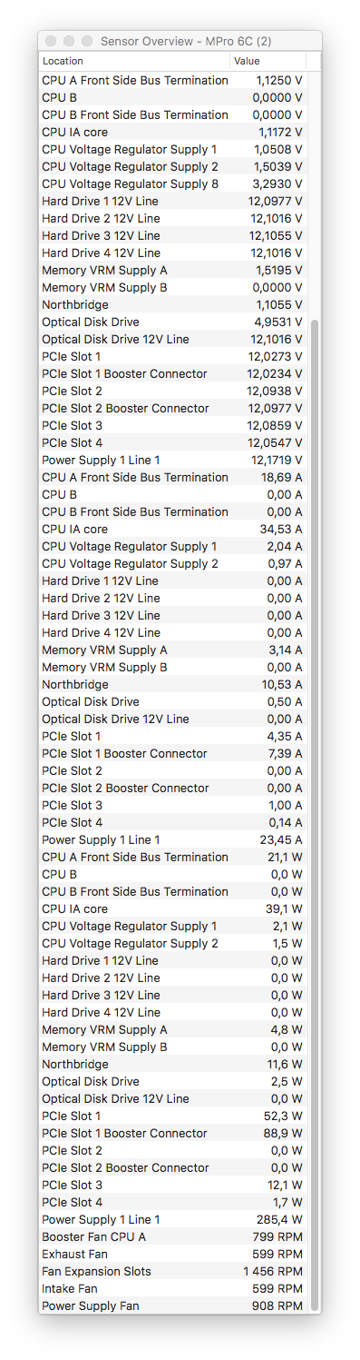

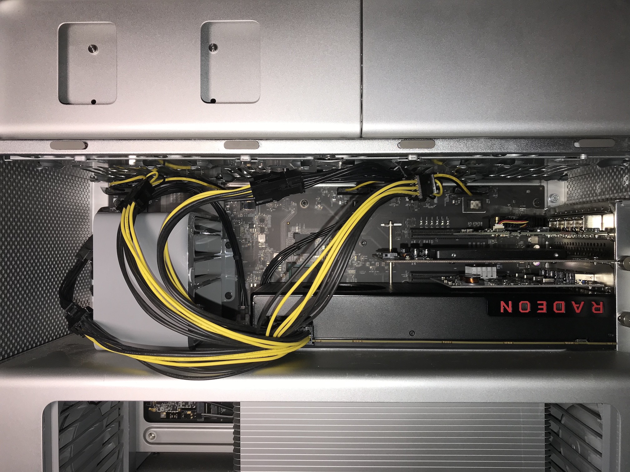

Today I tested what I had in mind. I‘m actually using all four HDD SATA connectors on the mainboard.
I merge HDD1 + HDD2 to one 6pin and merge this 6pin with one of the PCI-E 6pin connector from the mainboard to form one 8pin. Similarly I merge HDD3 + HDD4 to another 6pin and merge this one with the second PCI-E 6pin connector from the mainboard to get the second 8pin.
Result is that the card is running absolutely stable now. Maximum power draw if I add all absolute spikes together (not taking into account that it is unlikely that these spikes happen on all wires at the same moment) is 22A at 12V = 264W
I had 2,5A maximums at each of the HDD 12Vs. And 6A maximums on the PCI-E connectors.

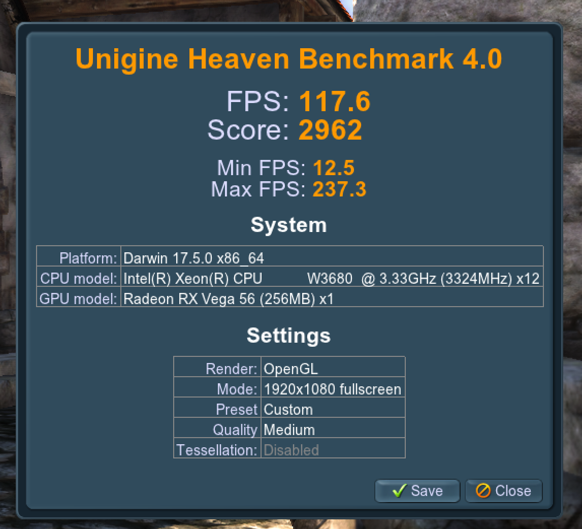

So here we go, I‘ve got a Reference Sapphire RX Vega 56 in a Mac Pro. Flashed with the Sapphire Nitro+ RX Vega 56 BIOS. Powered without Pixla mod. And it‘s working flawlessly now.
Glad I bought that thing for 500€ when it was new, and stuck to it until this point.
Thank you all for your valued input!
EDIT: some pics
Inside it's admittedly not so pretty anymore.

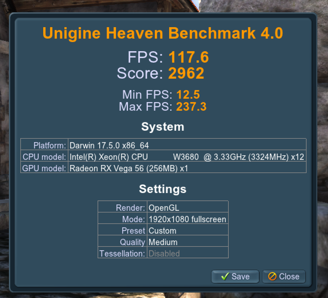

Unigine Heaven completes it run-through now.

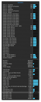

iStat while running Luxmark:
