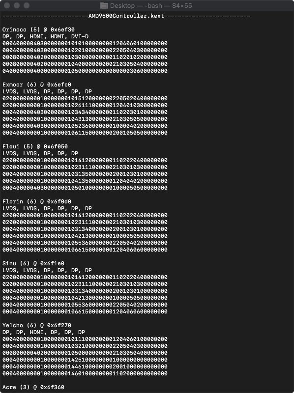

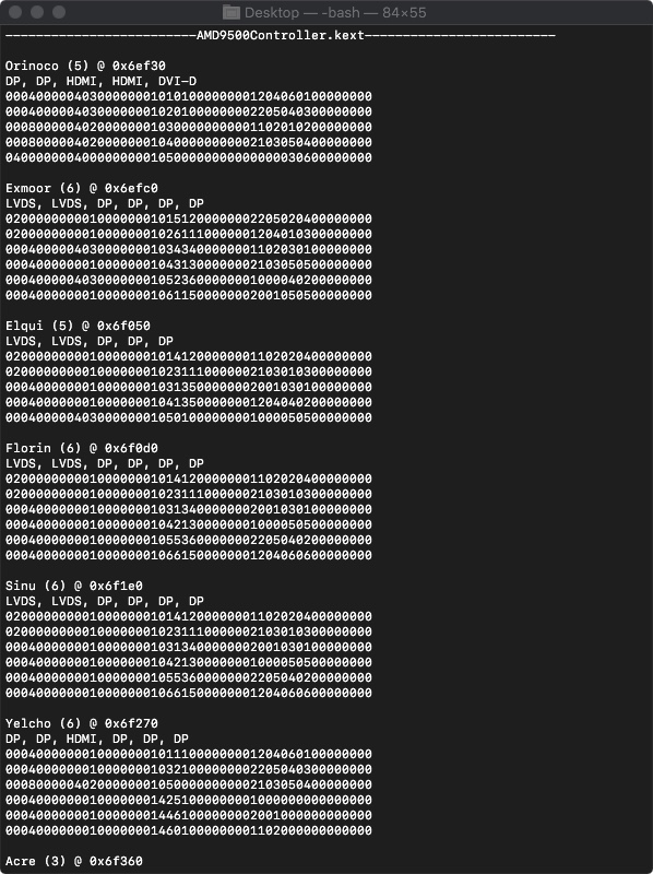

I just installed Mojave on my MBP and I tried the php file and it doesn't do anything.
try this :) (run in terminal assuming your in the same directory as the file: php frame-buffer-lister.php ) edit: remember to install otool, typing otool into terminal should trigger the xcode command line utilities installer
  • frame-buffer-lister.php.zip
It worked. At first it didn't, but I changed AMD6000Controller.kext to AMD9500Controller.kext and then it runs. It shows the GPU for Yelcho frame-buffer has 5 DP and 1 HDMI port. So I'm going to say it's probably not a PCIe card, but it could be (compared to the Orinoco frame-buffer for the Pulse RX 580 which has 2 DP, 2 HDMI, and 1 DVI).

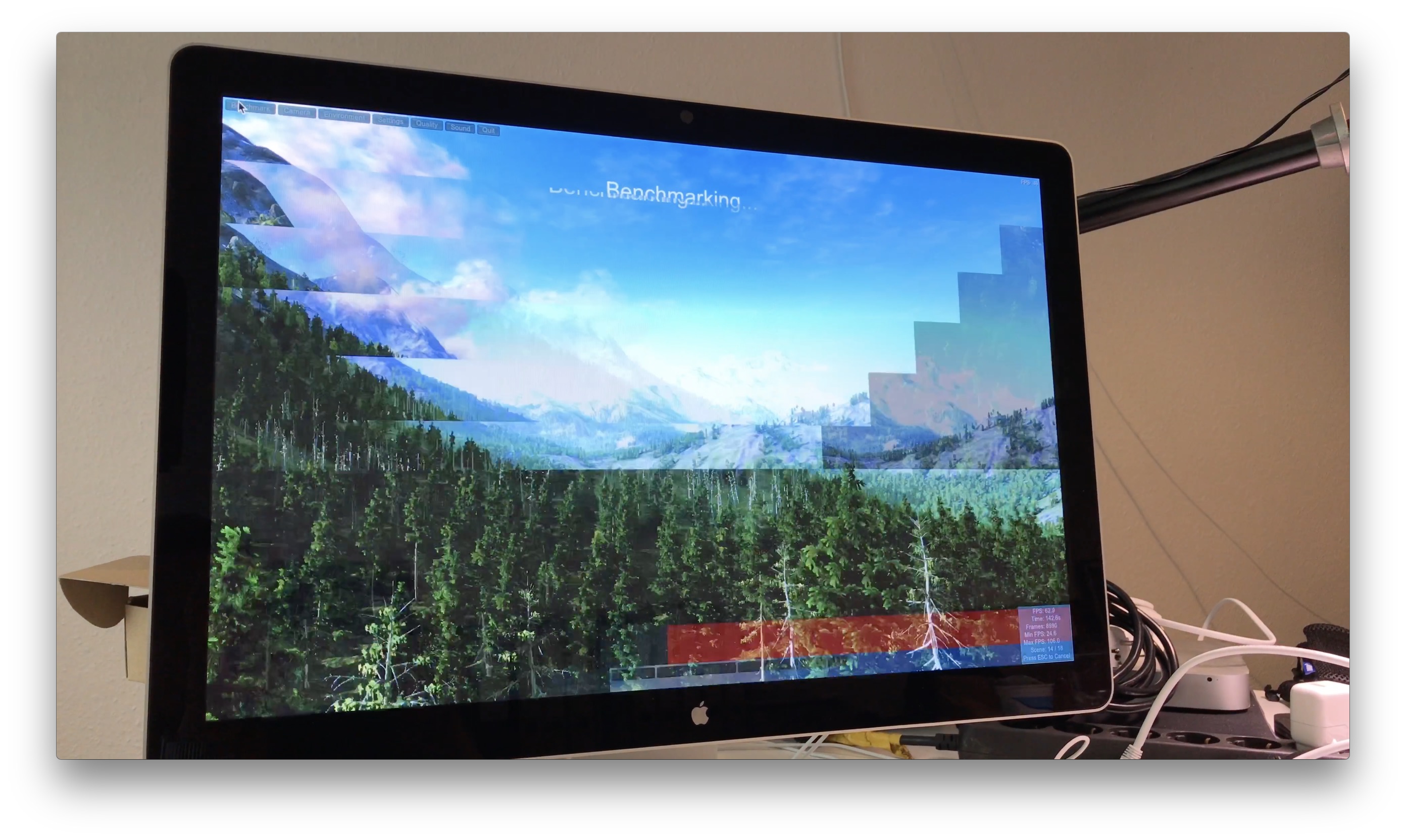

EDIT: The glitches mentioned below are only present with my old 24" Apple LED Cinema Display connected through a mDP to DP adapter. I just discovered that while connected to my main setup consisting of Sharp PN-K321 (needs a little hack to AppleGraphicsControl.kext to work in MST mode) and LG 27MU67 there are NO GLITCHES.
Sadly it's a good example for another major caveat. There are very short full-screen glitches from time to time (see below). They do happen immediately when some visually taxing application is running, so they are not temperature related. Maybe it's limited to OpenGL2, I will have to investigate this further.
I have exactly the same glitches on Frontier edition while under load, had to to a slow-mo movie to catch it to compare. Exactly same shape, for like a frame or two, repeating every 10 - 20 seconds. On Windows PC using the same card/monitor/cable it works fine, no artifacts. The kext you mentioned above was to enable DP 1.2? Did you do it yourself or got it from someplace, I can't find it, I'd appreciate a link. But that just sounds weird, I would expect more people reporting the same issue, because it looks like you need DP 1.2, which is not supported on cMP.
No the .kext modification is for re-enabling MST support over DP 1.2. DP 1.2 itself is supported when your card supports it. As far as I know this has nothing to do with the OS. I used my Sharp PN K321 (the first 4K screen that was publicly available) with a Sapphire 7950 Mac Edition card back in the day. I think with 10.9 Mavericks. The tricky thing about that screen is that it uses MST or MultiStreamTransport. That means that the screen is split in two halves and each of them appears as a seperate screen to the system and combining them needs support from the OS. In Mavericks and Yosemite that just worked but I think with some El Capitan Pointrelease they dropped it. I needed some time to find a way to re-enable it. In essence you open up that mentioned .kext and alter a string in a .plist resembling a blacklist of unsupported configurations for MST displays and suddenly it works again. I can write that up for anyone who needs the info on how to do that.

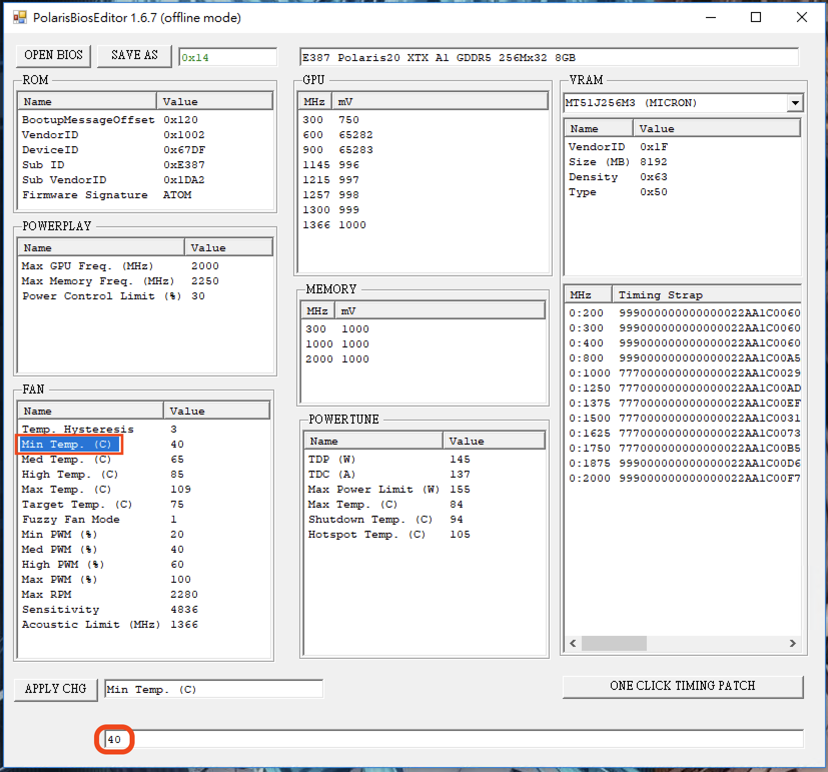

I installed this exact card in my flashed 4,1 Mac Pro to 5,1. It works well, but the fans on it only run during boot (which is black screen of course). Tested and works in 10.4 and 10.3.5. I wish the fans would cycle a little but but they just sit dead after log in. So far no issues. If I boot into boot camp and use Win 10, I can change the SAPPHIRE Led color, but any changes to fan settings do not hold in OSX. Seems to work well overall, but I'm not a gamer. I only installed it so that I can keep up to date with Mojave.
That's normal, the card is programmed to "zero dB (fan stop)" when GPU at low temperature.
And you can only override that by editing the ROM image and flash the card.
By considering the Nitro+ is a dual ROM card. It's very very safe to do that.
In fact, I also edited and flashed my single ROM PUSLE RX580, to lower the voltage, make it run faster (no thermal throttling), cooler, quieter.
The tool is quite easy to use. All you need is just PolarisBiosEditor 1.6.7 and the latest ATIWinFlash.
Use ATIWinFlash to dump the RX580's ROM.
Open it by the PolarisBiosEditor 1.6.7
Click on the Min Temp. (C) box, then edit the number at the bottom.
e.g. Change it to 20, then the fan should spin whenever the GPU is above 20C. Which effectively make the fan always spinning (assuming normal ambient temperature).
Then save the ROM, flash it back to the card.
Now, your RX580 should has "always on fan" in macOS.

Great instructions! Followed them to a T and modified the card Bios with your suggested minimum threshold at 20 deg. C. Booted up in both HS and Mojave and fans are both still full stop once I log in. It seems that maybe the Mac driver kext is overriding the bios? I didn't think that was possible but it is true that the Sapphire's TriXX software overrides the bios in win10. It was worth a try though, now I know how to save the card bios, flash it, and reprogram, so that's something :) Thanks for the education!
Interesting, I didn't expect that, may be you can try change the Fuzzy fan mode from 1 to 0.
P.S. Did you click "APPLY CHG" after replace the 40 by 20? Also, did you re-open the modded ROM to check if that number is changed?

If you want the card run cooler. One of the good way to do it is to downvolt the card.
As you can see from my screen capture, in the GPU section, I modded the voltage table. That 1000mV at 1366MHz is not random pick, but using Wattman and quite a few benchmarks / stress tests to find out this is the minimum stable voltage for my own RX580 at that max boost clock speed.
Your Nitro+ should come with a higher clock speed and voltage. You may try to find out the minimum stable voltage, and then mod that table. Once done that, the card will run cooler in macOS, this can also effectively avoid thermal throttling when under extreme stress.
You can fit 6 mDPs on a card like WX 9100, but not 5 mDPs and an HDMI in a single row. You could in 2 rows. So it would be an unusual card. If it was built-in to a Mac you wouldn’t think Apple would list the model number in the driver. I guess we’ll have to wait to see if Apple does release this custom Radeon Pro 580 card.

as I thought
http://forum.netkas.org/index.php/topic,13818.0.html
MVC got ahold the new black magic eGPU and indeed it uses the "Yelcho" frame-buffer.
best keep eyes peeled incase any more frame-buffer personalities show up :D
Code:
------------------------AMD10000Controller.kext-------------------------
Ucayali (6) @ 0x5e580
LVDS, LVDS, DP, DP, DP, DP
020000000001000008010141220000001102020400000000
020000000001000008010231130000002103010300000000
000400000001000000010313400000002001030100000000
000400000001000000010421300000001000050500000000
000400000001000000010553600000002205040200000000
000400000001000000010661500000001204060600000000

-------------------------AMD9500Controller.kext-------------------------
Orinoco (5) @ 0x6ef30
DP, DP, HDMI, HDMI, DVI-D
000400000403000000010101000000001204060100000000
000400000403000000010201000000002205040300000000
000800000402000000010300000000001102010200000000
000800000402000000010400000000002103050400000000
040000000400000000010500000000000000030600000000
Exmoor (6) @ 0x6efc0
020000000001000000010151200000002205020400000000
020000000001000000010261110000001204010300000000
000400000403000000010343400000001102030100000000
000400000001000000010431300000002103050500000000
000400000403000000010523600000001000040200000000
000400000001000000010611500000002001050500000000
Elqui (5) @ 0x6f050
020000000001000000010141200000001102020400000000
020000000001000000010231110000002103010300000000
000400000001000000010313500000002001030100000000
000400000001000000010413500000001204040200000000
000400000403000000010501000000001000050500000000
Florin (6) @ 0x6f0d0
Sinu (6) @ 0x6f1e0
Yelcho (6) @ 0x6f270
DP, DP, HDMI, DP, DP, DP
000400000001000000010111000000001204060100000000
000400000001000000010321000000002205040300000000
000800000402000000010500000000002103050400000000
000400000001000000014251000000001000000000000000
000400000001000000014461000000002001000000000000
000400000001000000014601000000001102000000000000
Acre (3) @ 0x6f360
DP, HDMI, DVI-D
000400000403000000010101000000001102020100000000
000800000402000000010200000000002103050400000000
040000000402000000010300000000000000030500000000
Huallaga (3) @ 0x6f3b0
DP, DP, HDMI
000400000403000000010101000000001204040300000000
000400000403000000010201000000001102010200000000
000800000402000000010300000000002103050400000000
Berbice (5) @ 0x6f430
020000000001000039050108000000002001010100000000
000400000001000000010243300000001000020200000000
000400000001000000010313200000002103030300000000
000400000001000000010453500000001102040400000000
000400000001000000010533400000001204050500000000
Longavi (5) @ 0x6f4b0
Tolten (5) @ 0x6f570
000400000001000000010501000000001000050500000000
Palena (5) @ 0x6f5f0
Caroni (5) @ 0x6f670
Salado (5) @ 0x6f6f0
DP, DP, DP, DP, DP
000400000403000000000001000000001000020200000000
000400000403000000000001000000002001010100000000
000400000403000000000001000000001102040400000000
000400000403000000000001000000002103030300000000
000400000403000000000001000000001204050500000000
Guariba (6) @ 0x6f770
DP, DP, DP, HDMI, DVI-D, DP
000400000403000000010301000000001102010200000000
040000000402000000010500000000000000030600000000
000400000001000000010601000000002001020500000000
Dayman (6) @ 0x6f800
Baladi (6) @ 0x6f890
DP, DP, DP, DP, DP, DP
000400000403000000010300000000001204030300000000
000400000403000000010100000000001102010100000000
000400000403000000010200000000002103020200000000
000400000403000000010400000000002205040400000000
000400000403000000010500000000001000050500000000
000400000403000000010600000000002001060600000000
OPM (5) @ 0x6f920
DP, DP, DP, DP, DP
000400000403000000000001000000001102020200000000
000400000403000000000001000000001204010100000000
000400000403000000000001000000001000040400000000
000400000403000000000001000000002001050500000000
