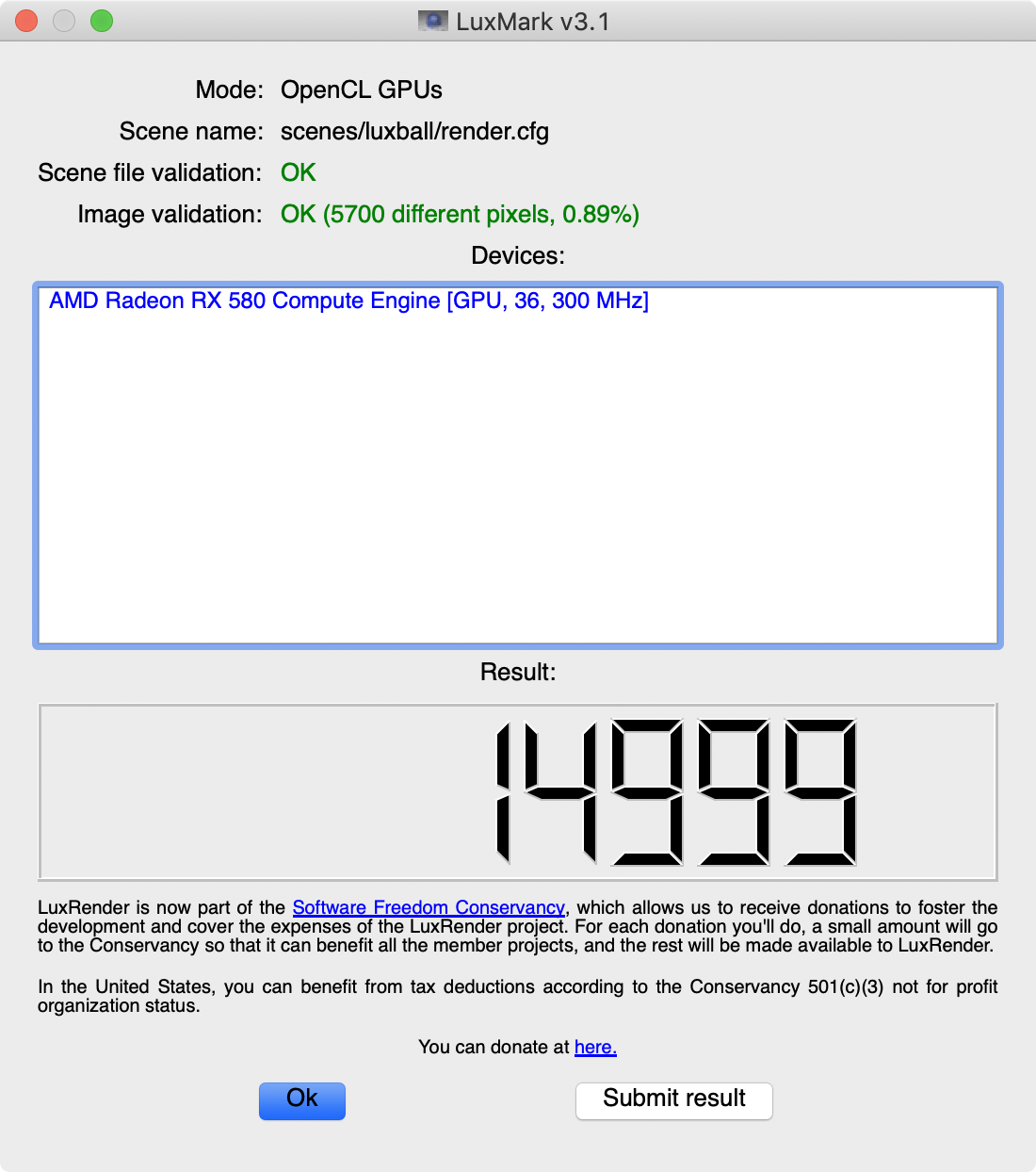

Anyone have a LuxMark luxball score in the latest Mojave beta for the Pulse RX 580?
Reactions: MisterAndrew

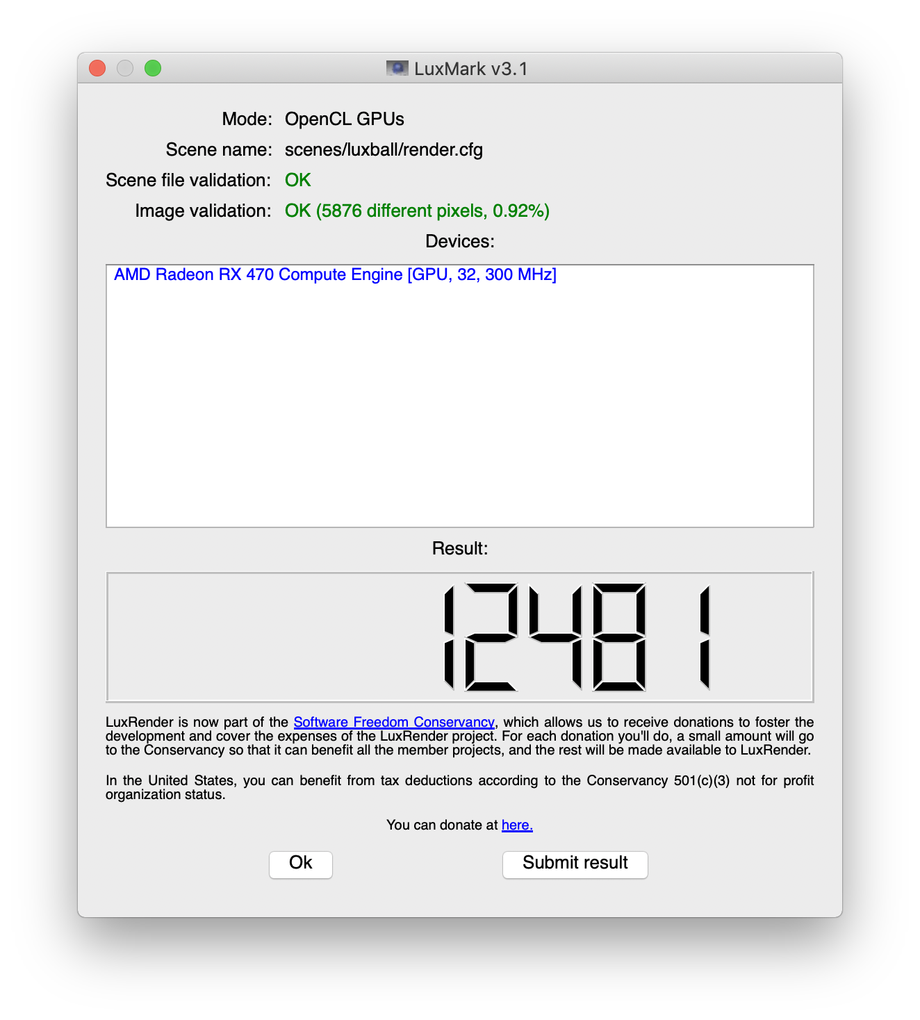

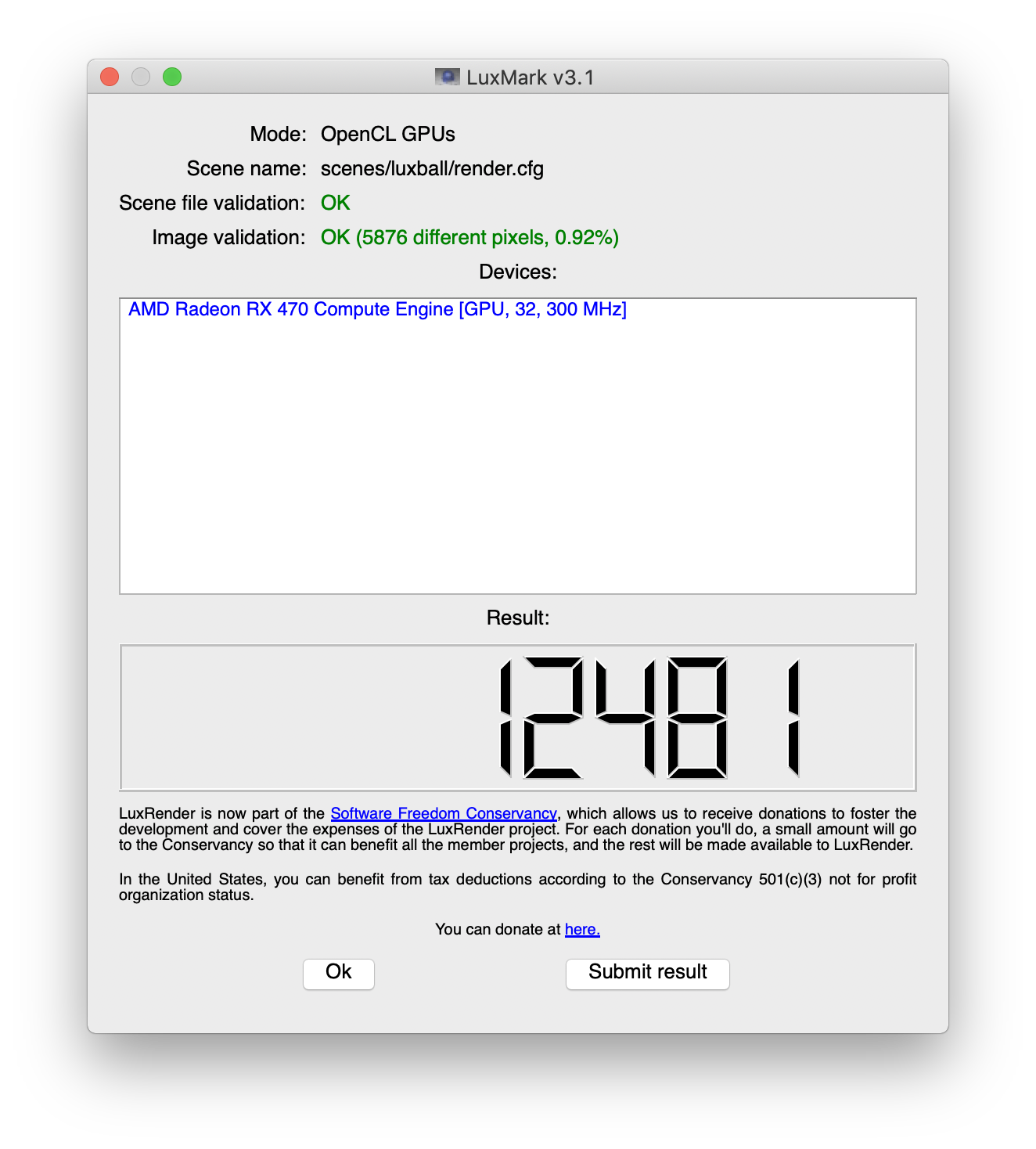

For comparison sake.. Sharing results from a 470 4GB. Considering the Pulse RX580 is newer/faster, I was expecting to see more than an 8% difference.
It is actually a bit more than 8% in my case.

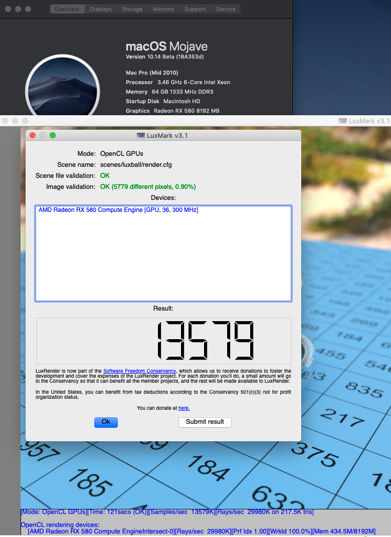

When I ran the above Luxmark test, I realised that 10.14 has more aggressive on the temperature control of the PULSE RX580. It keep my card at around 70C with higher fan speed (up to around 2000RPM, still quite quiet).
Same card, same cMP, same condition, I boot back to 10.13.6 and run Luxmark again, the card's fan spin slower (around 1600RPM) and allow the card run up to ~75C during benchmarking.

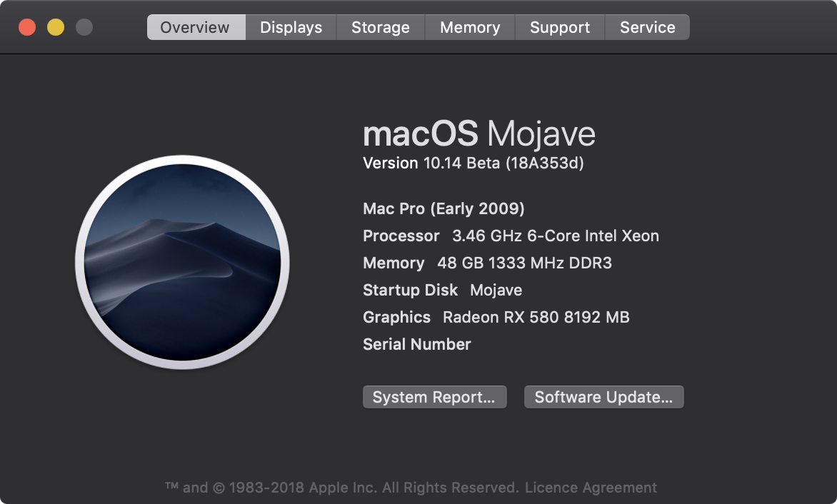

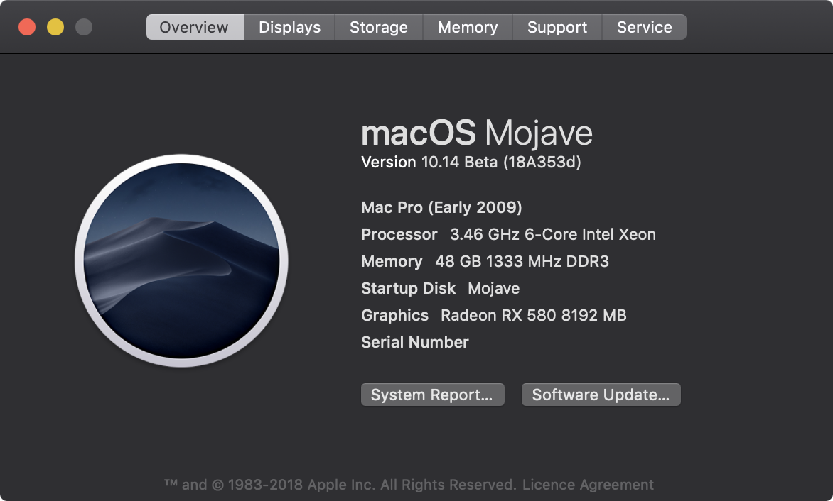

Mojave DP6?
PB5

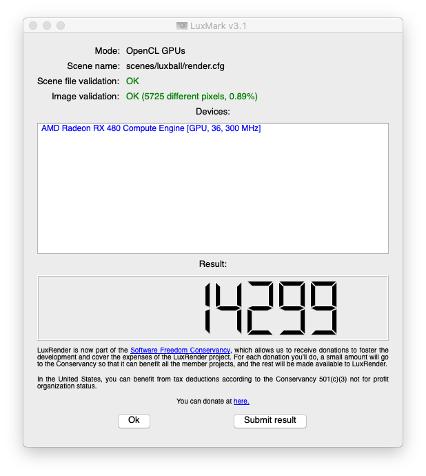

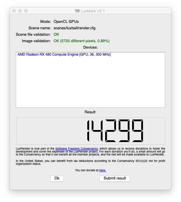

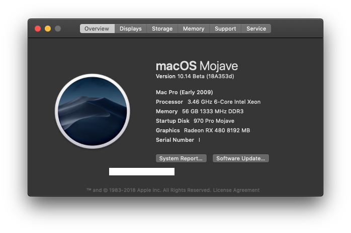

Following up with a reference rx480 in Mojave with a 4,1. Again, I thought the difference would have been greater. :)
The rx580 is not that much better than the rx480 from a couple years ago with stock firmware.

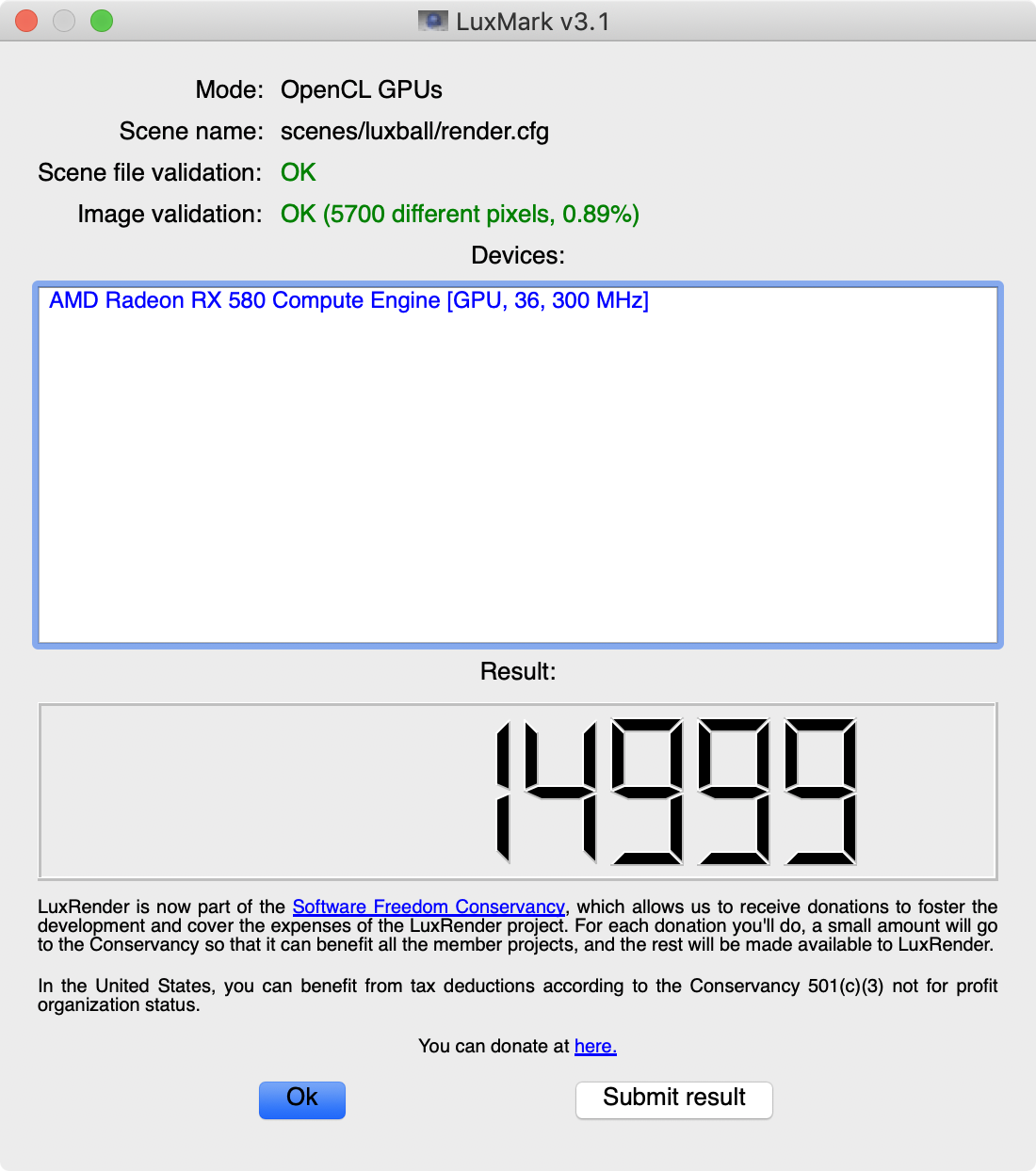

I'm trying to figure out why h9826790's score is much higher. Same card and same macOS build? Is everything stock, unmodified? Perhaps Pixlas mod powered vs. logic board connectors?
Very clean 10.14 beta. Only for testing purpose, almost nothing installed and use for real.
iStat menu loaded at startup by default. Terminal is opened to monitor GPU parameters. No other apps / software opened when running the test. I ran the tests a few times and confirmed Terminal has virtually no penalty for this test.
Yes, I flashed the original firmware back in and do the test, same score. Before that, I ran a downvolted VBIOS to let the card run cooler but at the same clock, which should able to avoid thermal throttling even under very extreme condition. But my observation is that the original setting won’t be throttled in just Luxmark test.
cMP itself with unmodified 0089.B00 firmware.
My card is powered by Pixlas mod, but this shouldn’t cause any difference for the PULSE RX580.
PCIe / PSU fans are NOT at native setting, but controlled by my own fan control software. However, they should run slower than stock setting (assuming the GPU is connected to the mini 6pins in the native way) when a RX580 is under stress. So, this should has negative effect if it really affect the GPU performance.
I ran the test few more times in 10.14 and 10.13.6. 10.13.6 always produce higher score. But I think my last observation about fan / temperature is wrong. The difference most likely coming from the fuzzy fan logic of the Polaris VBIOS. Not from the different OS / driver version.
