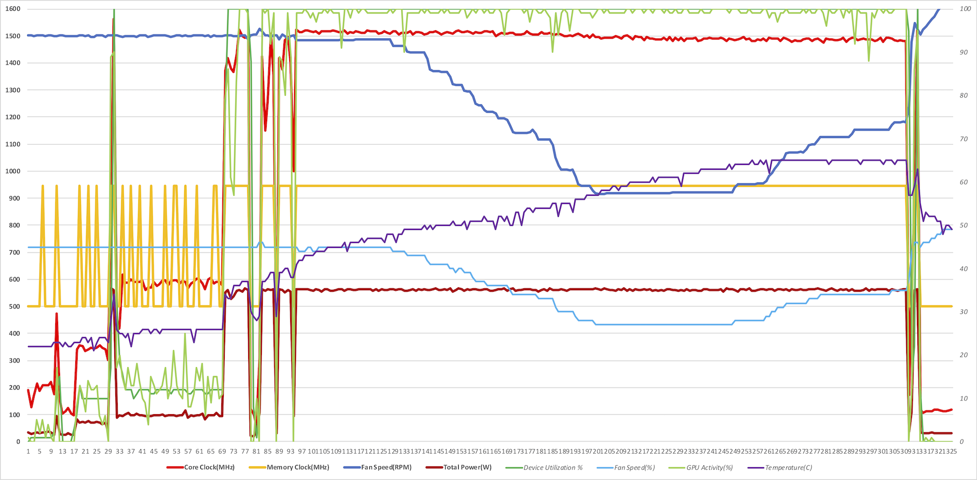

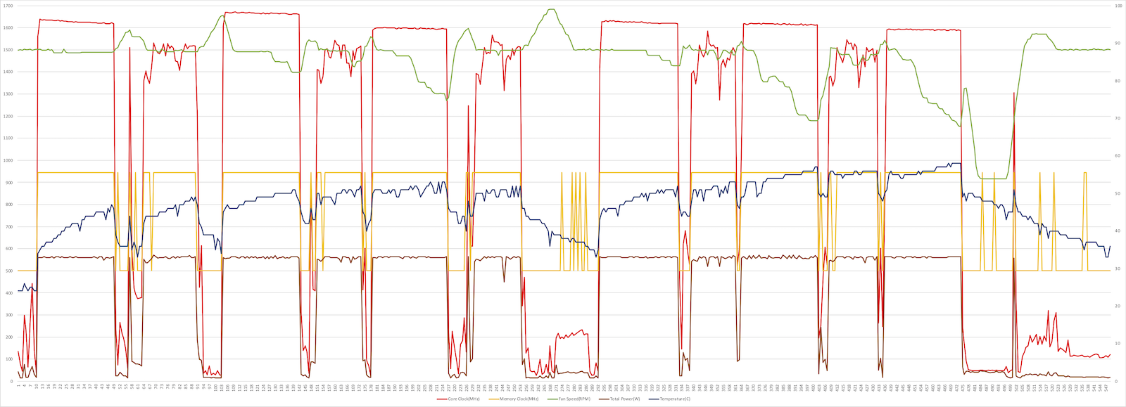

I noticed something odd while monitoring my Vega64 LC as I ran the Tomb Raider benchmark; according to ioreg my Fan speed drops when the temperature goes up... Purple = temp, blue = Fan Speed.
So is ioreg reliable?
MHz, RPM & Watt (bold) on the left axis, % and Temp (italic) on the right axis.
h9826790
macrumors P6
Apr 3, 2014
16,656
8,587
Hong Kong
ioreg is very reliable with my RX580.
Your graph suggest that your card’s fan was stuck at 1500 RPM at the beginning. Once you start the benchmark, the GPU under stress, and that actually triggered something and make the fan profile back to normal. The card suddenly realise for that kind of temperatures, no need 1500RPM, therefore, the fan speed drop.
Until the temperature rise to certain level, and the fan need to spin up again. This looks make sense to me actually.
Of course, this explaination only applicable if your card’s fan was incorrectly stuck at 1500 at the beginning. AFAIK, that’s quite common for Vega card.

True, I see that now, I thought the fan behaviour was fixed in the latest Mojave builds. This is the latest developer beta. I'll run some longer tests :)
Anyway, may I know how you get that graphic? I only know how to use terminal to extract the number on the spot. Don’t know how to plot them.

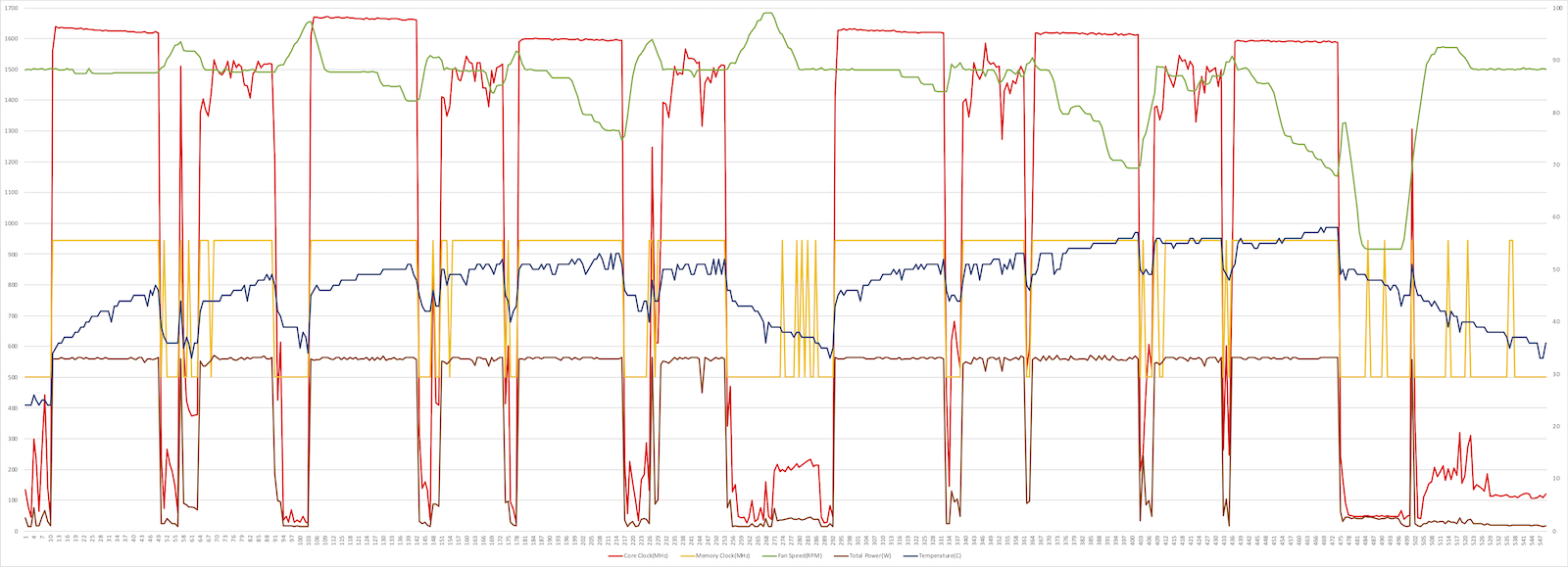

I run ioreg every second and redirect the output to a file in csv format, which I can then edit in any spreadsheet program and convert into a chart:
# Grab the column headers from ioreg's output:
ioreg -l |grep \"PerformanceStatistics\" | cut -d '{' -f 2 | tr '|' ',' | tr -d '}' | tr ',' '\n'|grep 'Temp\|Fan\|%\|(W)\|Hz'|cut -d\" -f2|tr '\n' ',' && printf '\n'
# Grab the values every second:
while true
do
ioreg -l |grep \"PerformanceStatistics\" | cut -d '{' -f 2 | tr '|' ',' | tr -d '}' | tr ',' '\n'|grep 'Temp\|Fan\|%\|(W)\|Hz'|cut -d\" -f3|tr -d '='|tr '\n' ',' && printf '\n'
sleep 1
done​
I should be limiting ioreg's output somehow, but documentation is scarce.
"ioreg -l -n display@0 -r" limits the output somewhat, but ideally I'd only like to see output for 'AMDRadeonX5000_AMDVega10GraphicsAccelerator', I've not figured out howto though.
I tested with the Eulysium sample but I just ran it once, I'll run it continuously in a minute.
Bench order for the following chart: Luxball, Tomb Raider's Benchmark (TRB), Neumann, TRB, Hotel Lobby, TRB, Elysium, Luxball, TRB, Neumann, TRB, Hotel Lobby, Elysium.
Red = Core MHz, Green = Fan Speed.

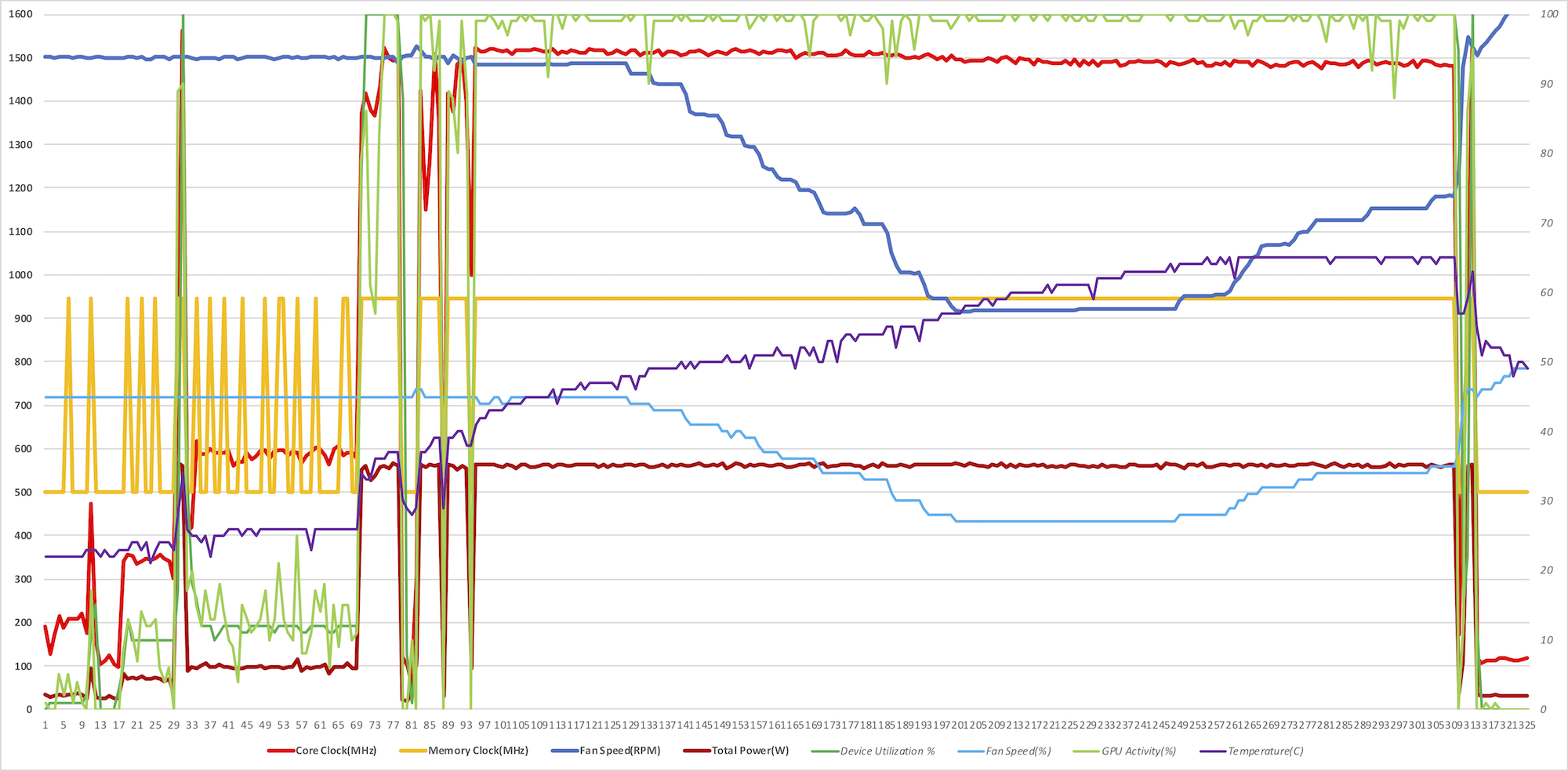

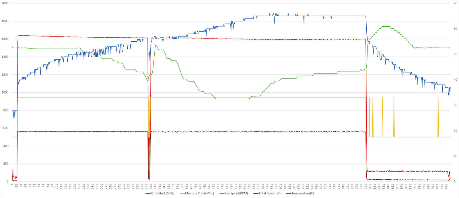

Alright, ran Eulysium for 30 minutes, no effect on my fan-speed.
Ran Luxball stress-test for 5 minutes and then Neumann for 8 minutes. Temperature went up to 66 degrees Celsius, fan seemed to kick in at 65 degrees, but really kicked in when I quit Luxmark:
Update: 1500 rpm is the default fan speed for the liquid cooled Vega64, still I opened a bug report with Apple as I see the fan speed drop under load, until it hits the target temperature of 65 degrees celsius, then it kicks in, but only to maintain the temperature. Once I quit the stress-test the fan speeds up to 1740 rpm and then slowly drops to the default 1500 rpm again as the temperature drops.
I'm looking at modifying the settings using the Vega Control Table Generator and edit the kext next.

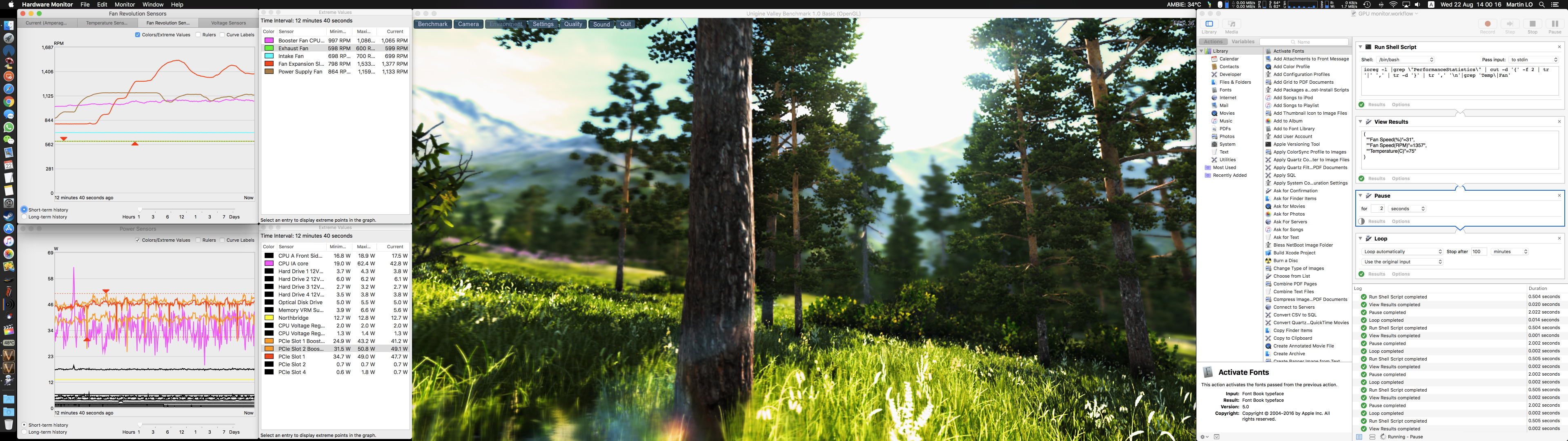

Thanks for the sharing, I use a much more stupid method, Automator :p
No graph or log, but it will self refresh the ioreg for every 2 seconds, good enough to monitor the parameters :D

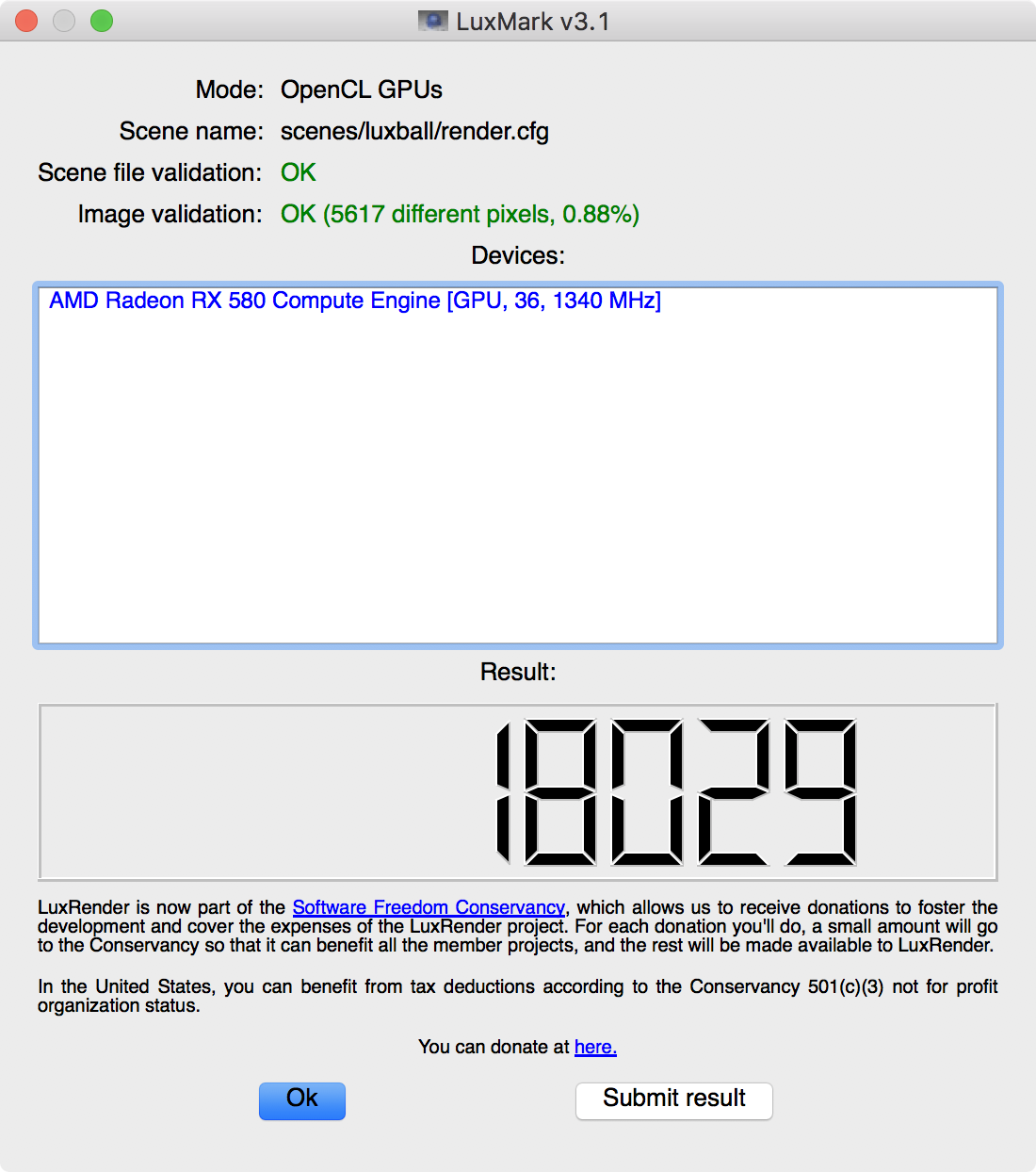

Little bit tweaking of the Sapphire PULSE RX580 8GB ROM.
Voltage pointer to 65283
GPU clock down a little bit to 1340MHz
VRAM clock up to 2250MHz
Automatic memory timing patch applied by the PolarisBiosEditor 1.6.7
End up have a RX580 that run 20% faster than stock setting.
GPU stay at or below 75C (native target temperature) with fans tiny bit below max 2280 RPM.
No thermal / power throttling observed.
No as powerful as Vega, but very good performance to cost ratio now. And of course, the card still can stay within the cMP's power envelope, no Pixlas mod / ePSU required.

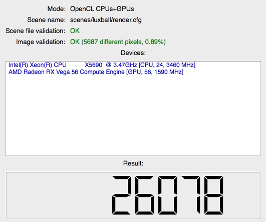

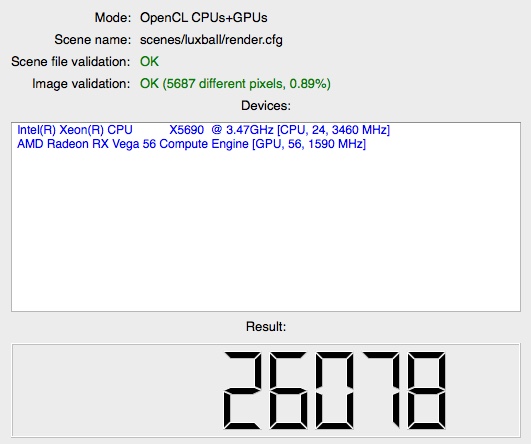

Just recently I got myself a MacPro 4.1 to upgrade it as much as possible. For at least two weeks I was reading every forum and post I could find ... regarding all possible updates.
For a while I was quite uncertain regarding what graphics adapter to use...
This thread here was THE major influence why I decided to try a:
Sapphire Pulse Radeon RX Vega 56
I got it today and put it into the computer: it just works! No hassle at all - it just(!) works!! -> awesome!
Thank you guys!!
here are some benchmarks I did run:
