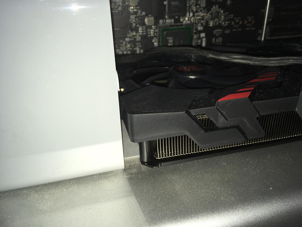

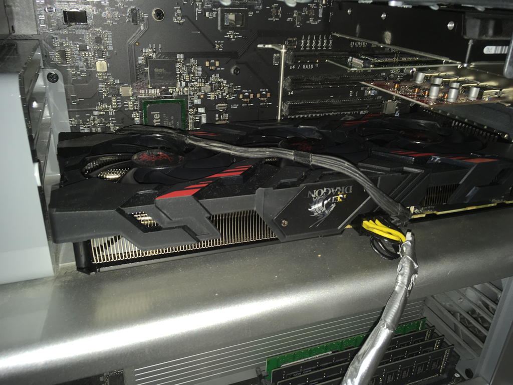

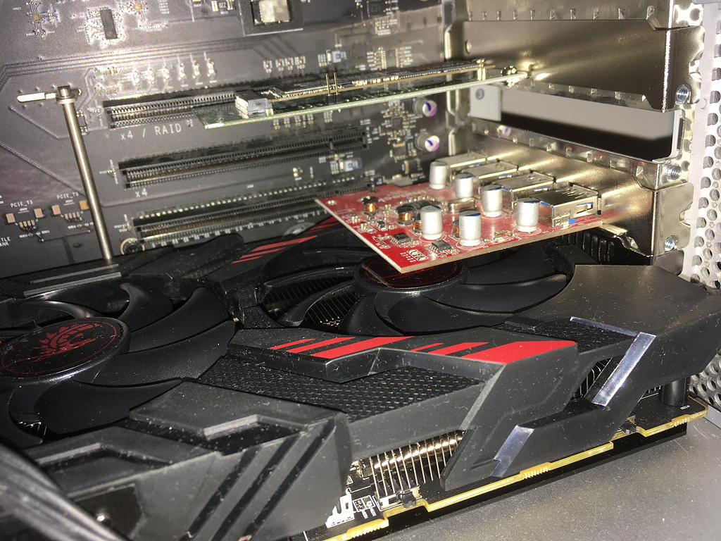

Here you are.

How did you install your RX Vega 64 Nitro on your Mac Pro? Did you remove the PCI fan? How are powering the card? Pixlas mod? Do you have any pictures of your mod? Thanks!
