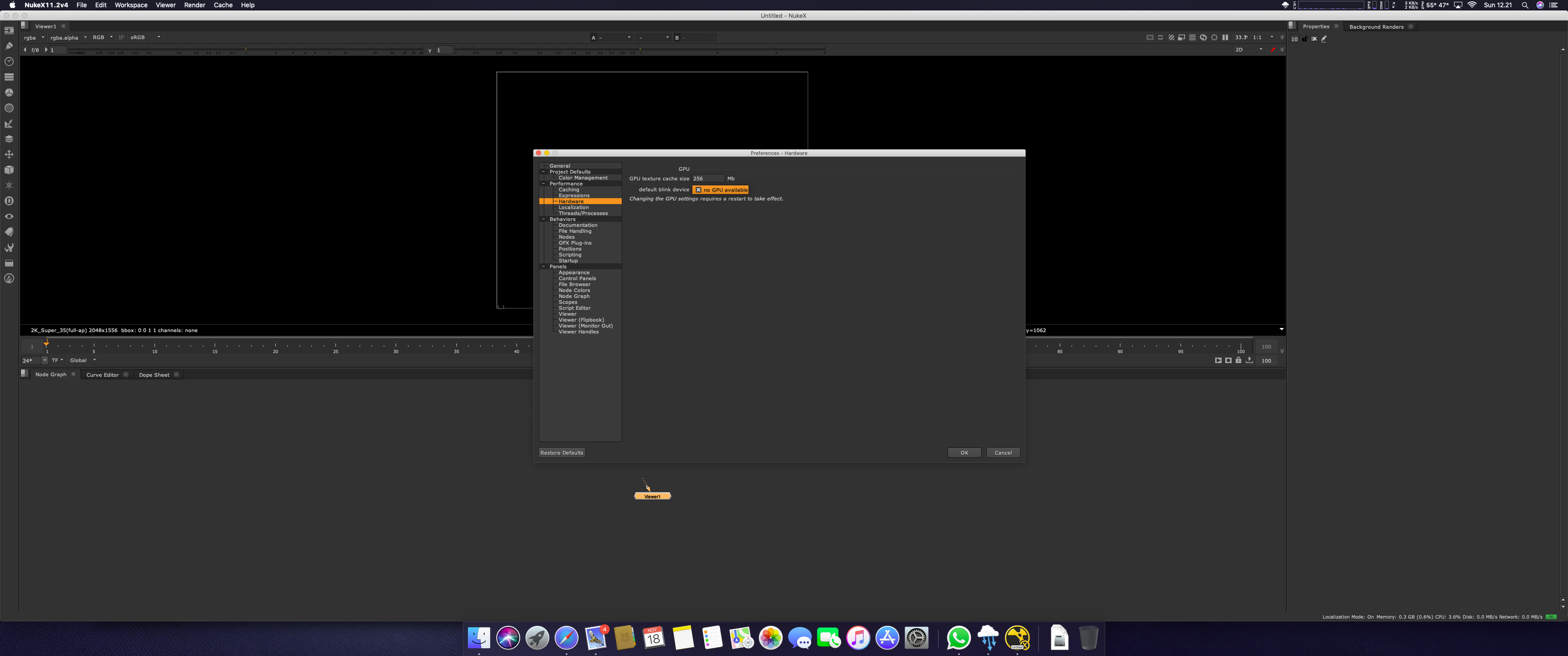

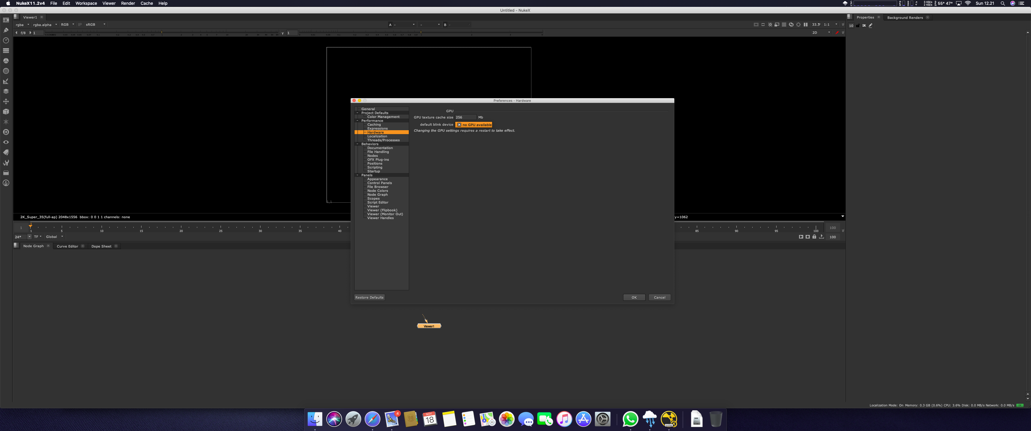

well it doesn't work
Nuke X doesn't recognise my VEGA 64

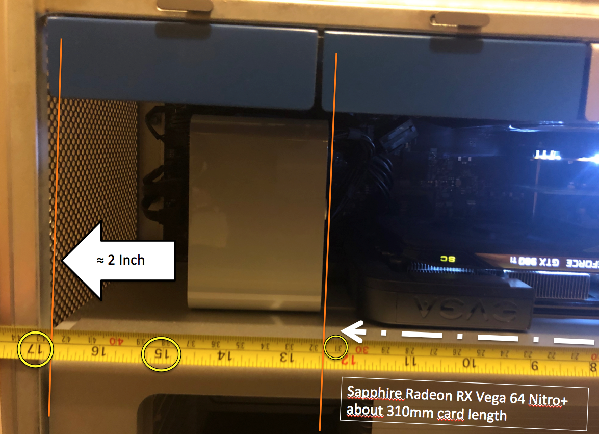

You will need to remove the PCIe fan cage.
The conventional wisdom is that in peak power draw scenarios, a Vega 56 is under the maximum power that can be drawn from the mini power plugs (~120 watts each), but you will need EVGA powerlink or some clever splitters and combiners to split the draw evenly across from the 6 & 8 pin.
The Vega 64, however, seem to go past that amount of draw, and should have pixlas. Also Vega cards don’t really like to draw any power through the PCIe slot, so just about the whole load goes through the power connectors.
Thank you for the info, will the other fans run normall when the pci fan is removed?

The card is the reference design, occupies only two slots and when installed in slot #1, slot #2 is still available. It totally fits, being the same length and slightly narrower than my MSI RX 580 card.
