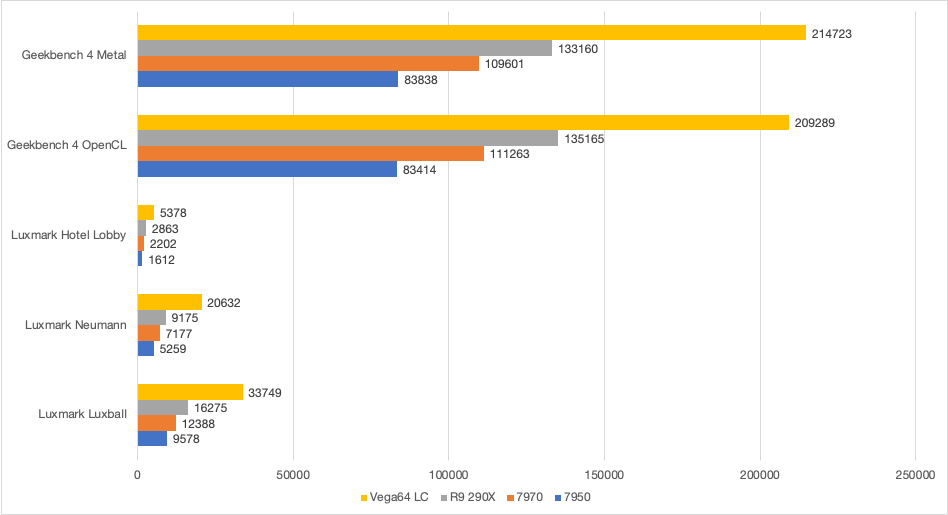

ps where's the chart from, did you make it?
edit when you say those results do you mean mine or there's?
there both look normal to me, there's lots of screen shots in the forum with vary close results.

Their results seemed odd to me, I may boot Windows to verify, but Luxmark says it's a cross-platform benchmark. Looking at the results it isn't or he tested wrongly, either that or the Vega64 is way faster on OSX than on Windows.
Searching for Vega64 Windows/Linux results on the Luxmark website, I found none only OSX, which is also odd.

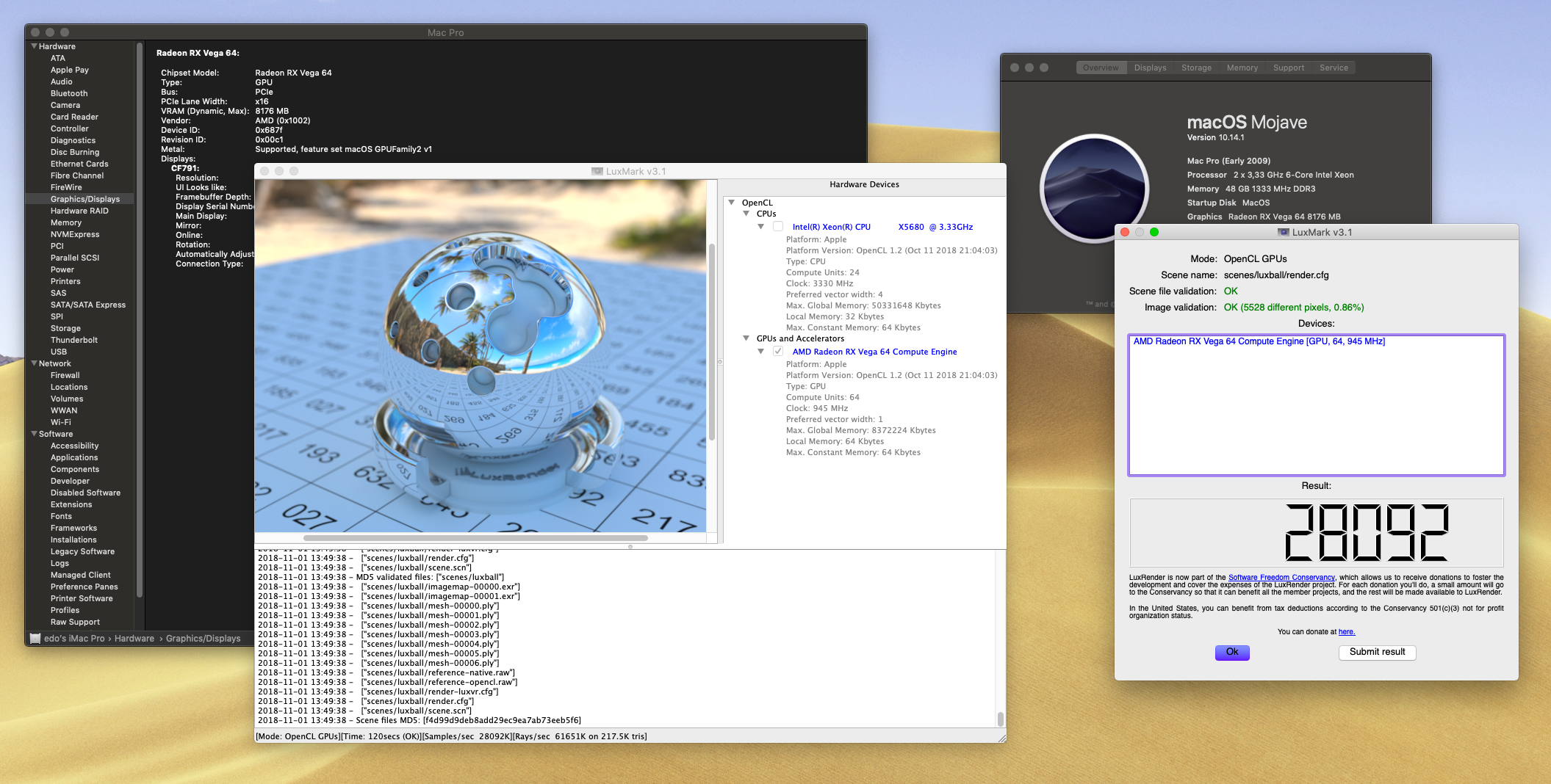

Anyway I had a go at it, entered the top-20 for the simple and medium tests, not so good on the complex test. Ran the tests 4 times, 34283 was my best result.
Yeah they're my results, it's just a simple excel chart.

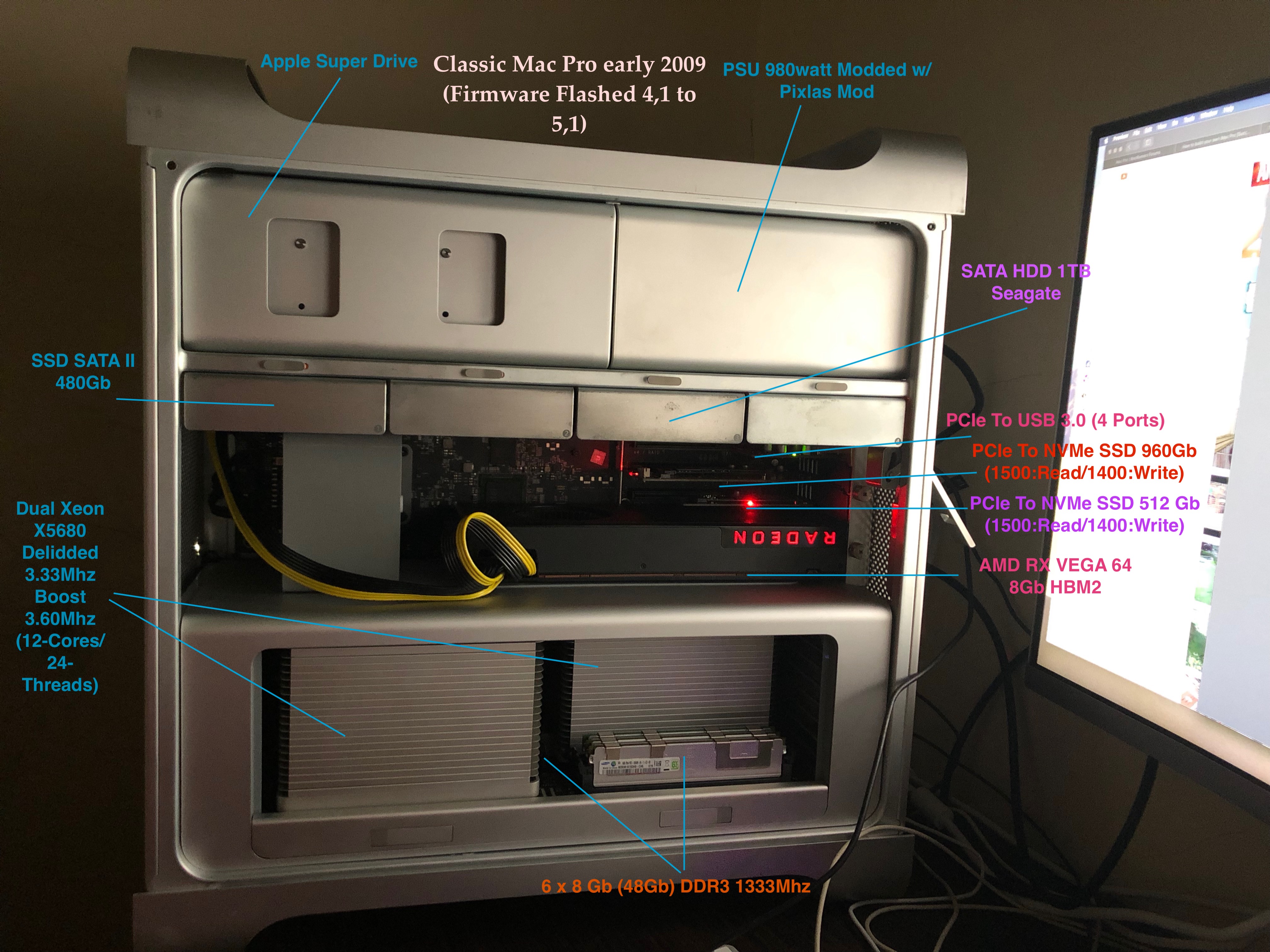

well finally doing Pixlas Mod and replaced my GTX680 to AMD RX Vega 64 (using PowerColor RX Vega 64), too bad it doesn't have boot screen
overall I have better UI experience using this new card
what about fan and noise while idling (while working or gaming i don't care cause that's what fans are here for!)
and no recognition issue on reference design?
Fan is working as it should but first I have to flashed the Bios to the nitro+ vega 64 bios.
Everything recognized by the OS.
So no problem whatsoever

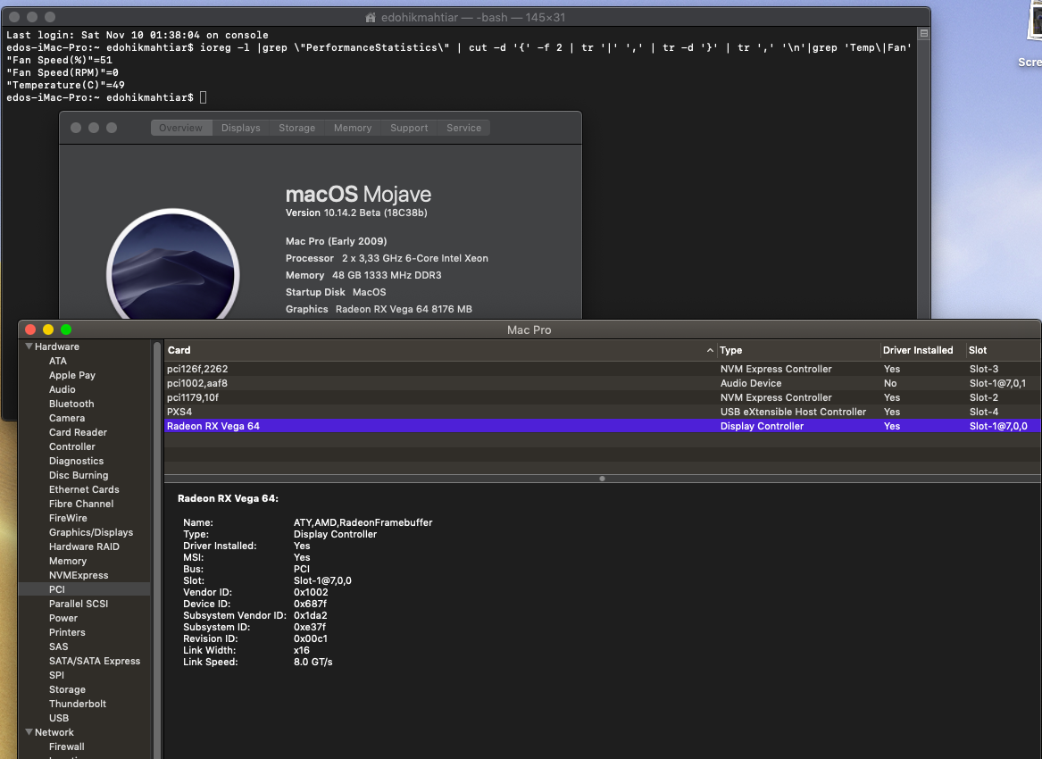

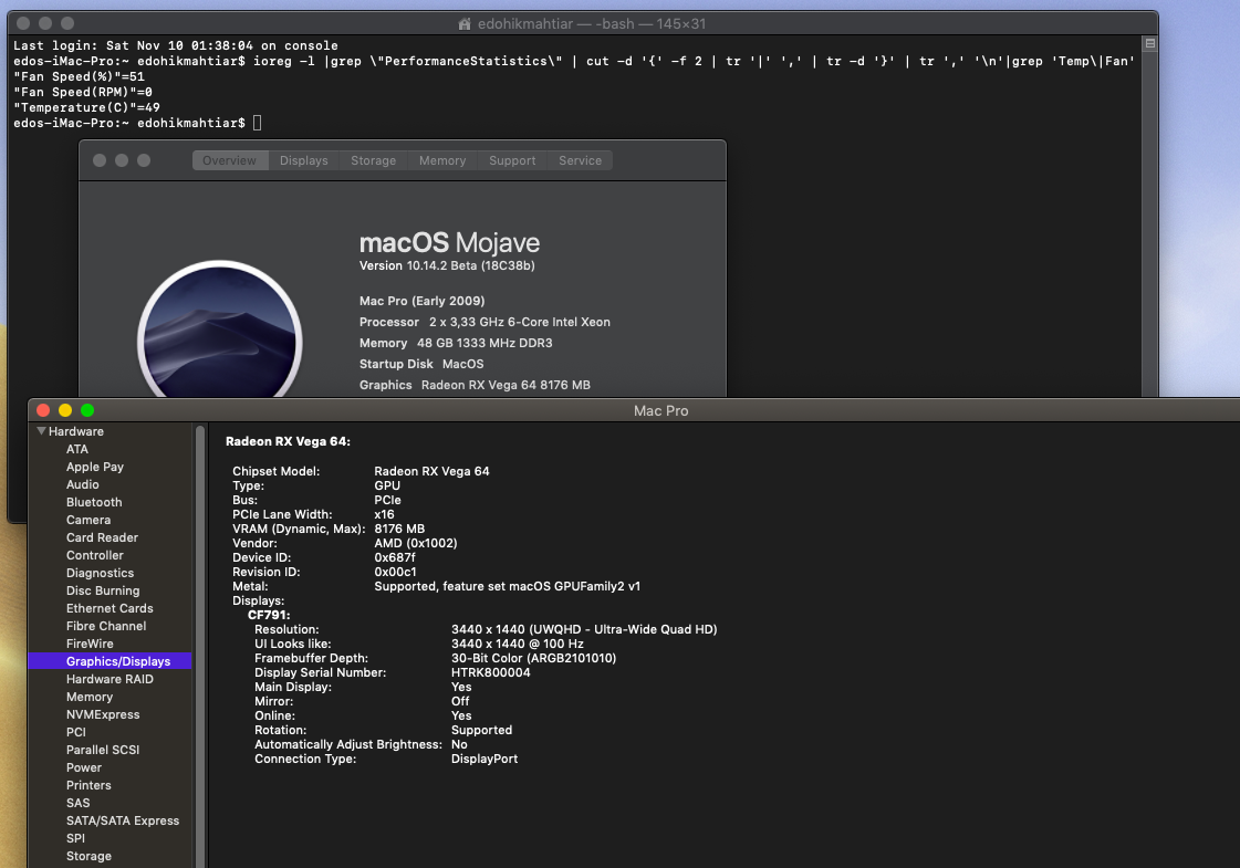

yes, correct, #1-2
#3. I'm now running Mojave 10.14.2 Beta 2
#4. The GPU fan running normal, when idle fan not running, spins up according to load and spins down according to load also temperature no need to play a H.265 video.
Boot fine (without boot screen for sure), sleep/wake normal without any issue(s).
