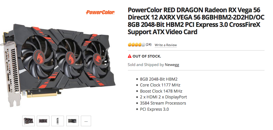

[doublepost=1541361760][/doublepost]lol that cards already sold out?
looks like postage is free to the uk but still 20% tax on import and no warranty
