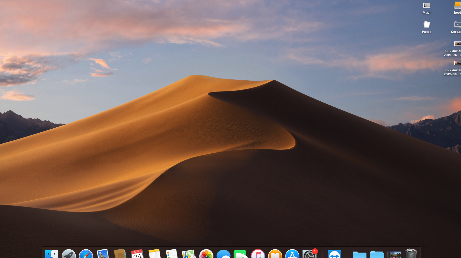

just one thing as Colombo used to say - the screen in attach.
i have toshiba tv plugged, 46 or 50 inch, the desktop looks like on the screen and in "about mac" says: 31,5-inch (1920 x 1080). `How can i adjust it to the size where all fits the screen?
that looks like an underscan/overscan setting.
there should be a slide bar to adjust this in the Display settings. It looks like you went "over" meaning not everything will fit on the screen. going "under" will create black areas around the edges of your screen.
read this article for more details
https://support.apple.com/en-us/HT202763
and do not care about what about this mac says your TV size is. it is cosmetic as far as I know. I have used a few TVs and some reported the proper size and others did not. it had zero impact on it's functions. my experience was the same as yours, having a 48" TV report it as 41"
i check the link, i do not have this overscan / underscan option in display settings-(
may i change them through terminal?

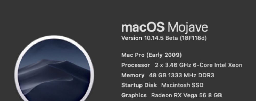

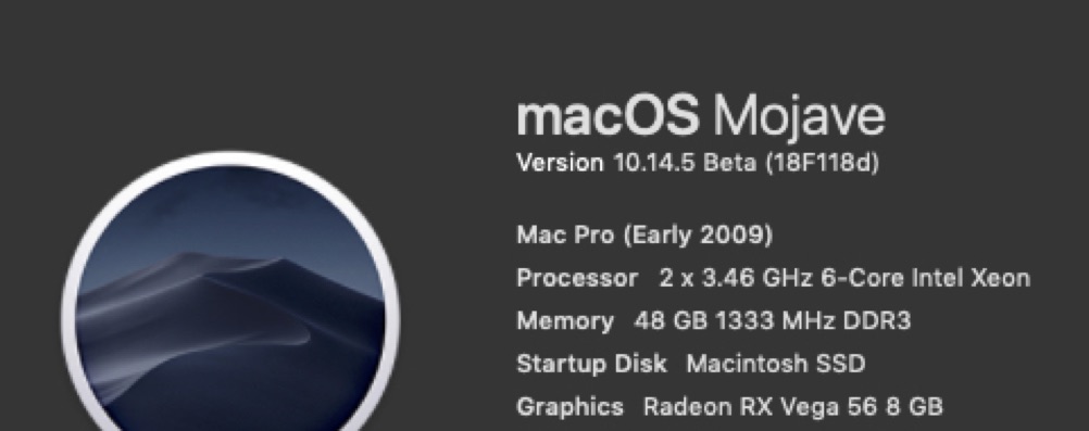

I just installed a Reference Sapphire Vega 56 into my 2009 4.1>5.1 mac pro running Mojave 10.14.5 beta 3
As others reported the fan is running quietly - I'm going to do some editing in FCPX to see if there are any performance improvements and if fan spins up.
I set the bios switch to the economy setting and I'm using two mini 6pin to 6 pin cables plugged into a EVGA Powerlink to balance the power load.
All seems good for now.....
