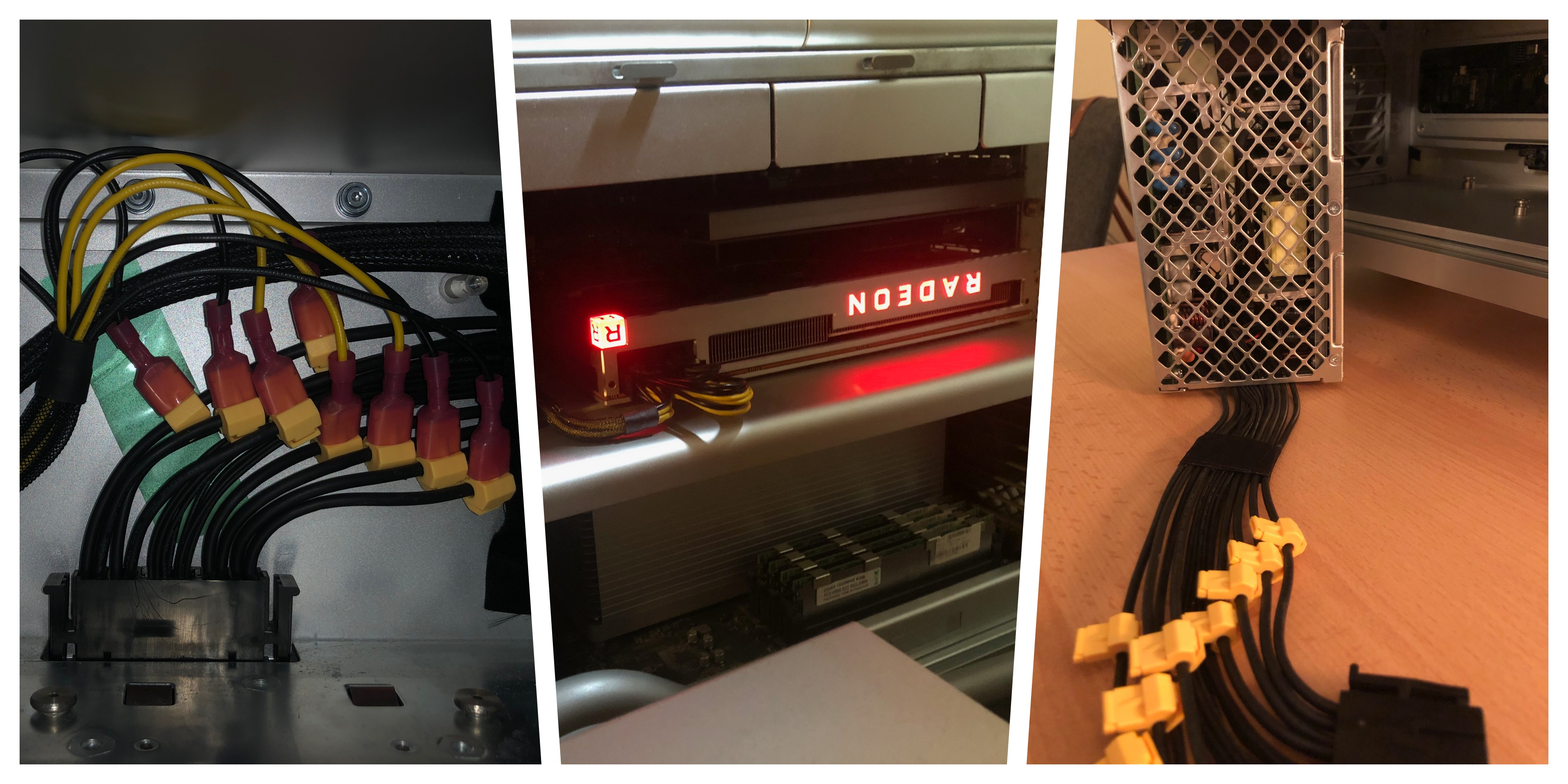

Wow, finally my Radeon VII arrived today which replaced my Vega 64 LE. I must say, I am really surprised how much better the cooling is on the new Vega 7 and how bad the reference cooler from the Vega 64 is. I thought it would be just a little bit, - incremental at best.
But the cooling is waaay better, Vega 7 can handle a lot more heat as it seems at first glance.
I will make an intense burn in the next weeks and put the new Vega under some pressure. But the first impression is actually really really nice. The fans are surprisingly quiet under low, normal conditions.

Here is the next finished 2019 Vega VII Facelift...
It runs like never before...
