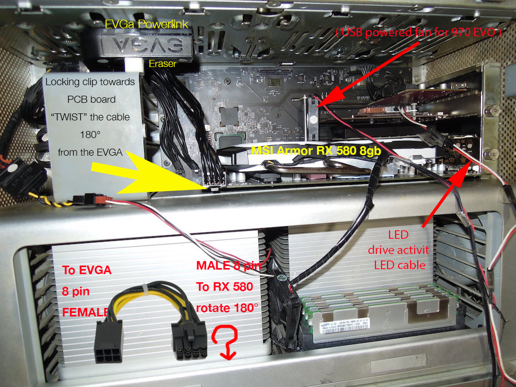

Looking at the RX 5700 XT pics from this link https://www.techpowerup.com/gpu-specs/radeon-rx-5700-xt.c3339
you could use an EVGa PowerLink either connected to the card if the power socket cable locks face upwards away from the GPU PCB ( like the HD 7xxxx & R9XXXX cards . . . . or . . . as a bridge PLUS extra 1 X 8 pin to 6 pin and 1 X 8 pin to 8 pin cable(s) FROM the PowerLink power out TO the GPU.
( NOTE : the PowerLink comes with a spare 6 pin installable socket. )
( NOTE : You can also add a TWO x SATA to 6pin or 8 pin TO the Powerlink power input. )
That way you'll have balanced power from . .
(a) 2 X Mini 6 pin to 8pin
(b) 2 X SATA to 6pin or 8 pin
(c) PCIe slot
Should be enough power and more.
I use the above to power my MSI Armor RX 580 8gb. It works seamlessly.
My PowerLink sits ( securely ) on top of my PCI area Intake fan.
As my RX 580 has only one 8 pin power socket I needed one female 8 pin to male 8 pin from the PowerLink to the RX 580.
For any 8 pin & 6 pin GPUs two cables from the PowerLink will be required.
The pic below shows my messy cMP case interior ; I've been mucking around with the cable layout tonight.
It usually looks much neater, runs quietly, cool, fast.
Below is an older pic showing how a 'bridged' EVGa PowerLink can be installed.
That 'eraser' really holds the PowerLink very securely.
Currently I have added 2 X SATA cable to the PowerLink input.
Reactions: BillyBobBongo

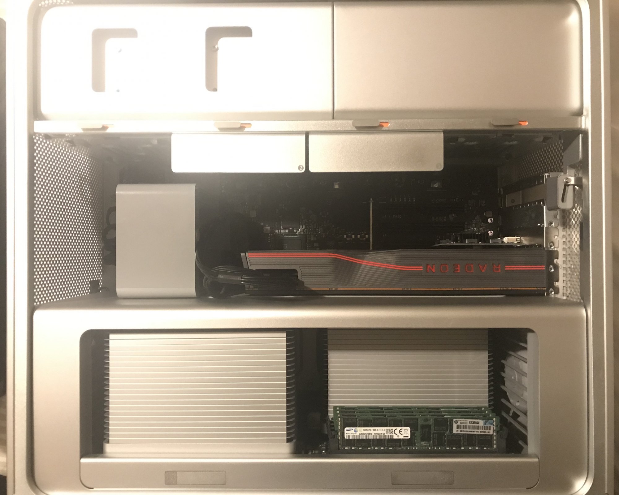

stupots
macrumors newbie
Mar 20, 2019
23
26
Kent, UK

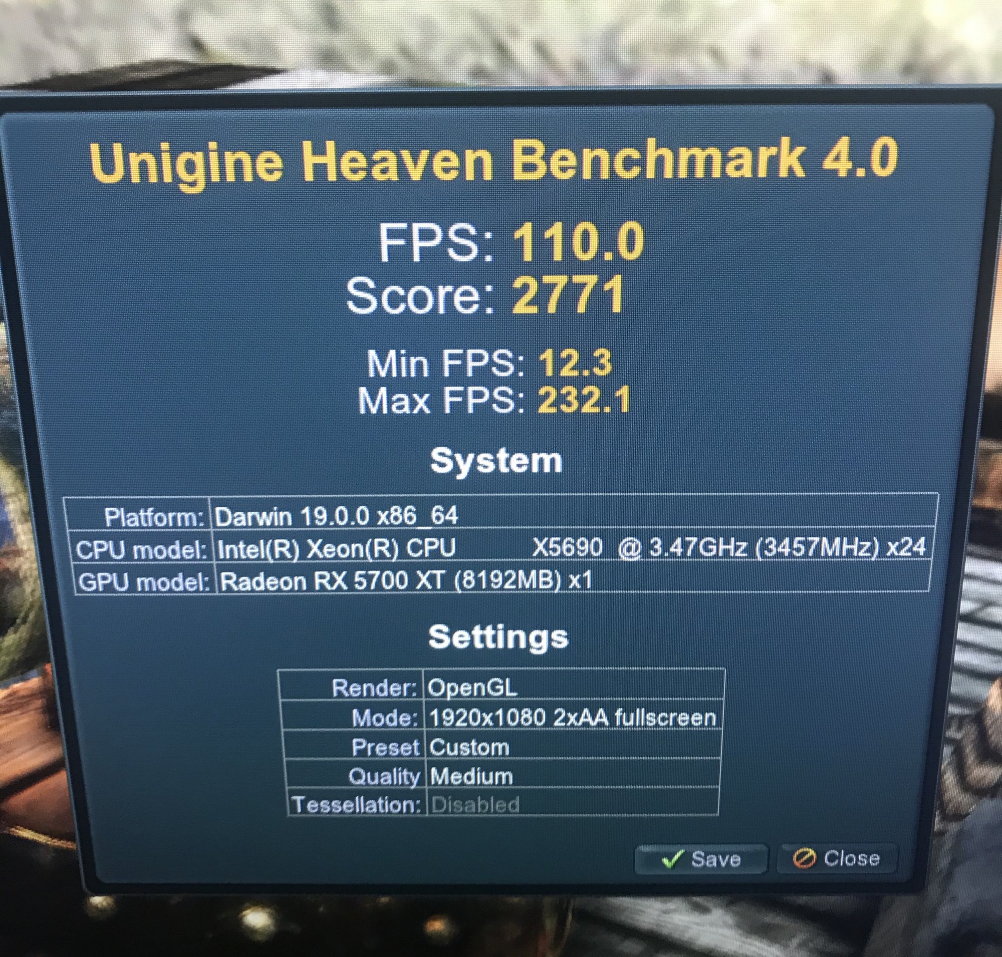

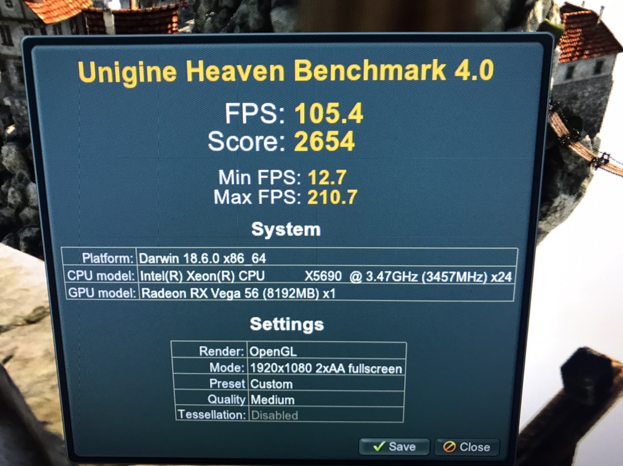

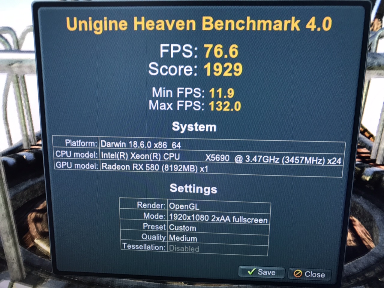

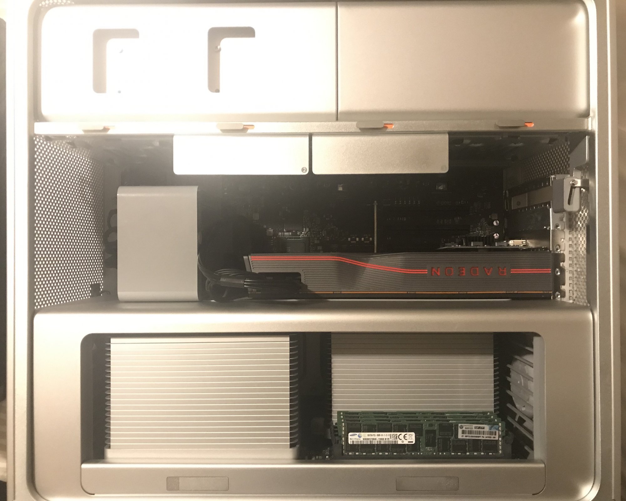

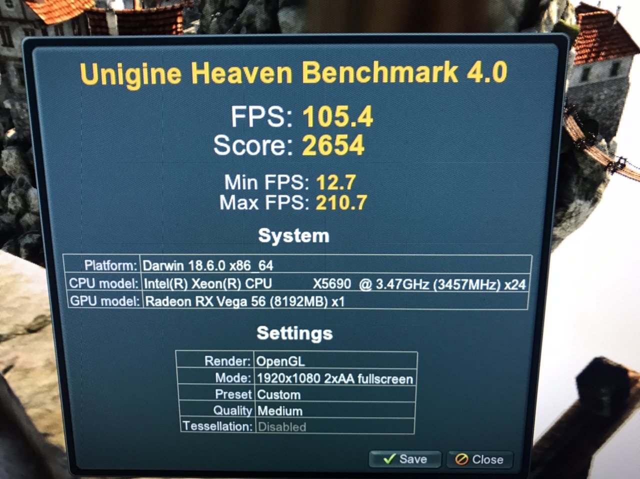

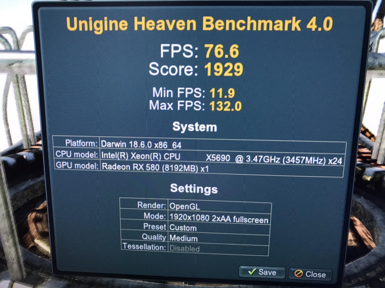

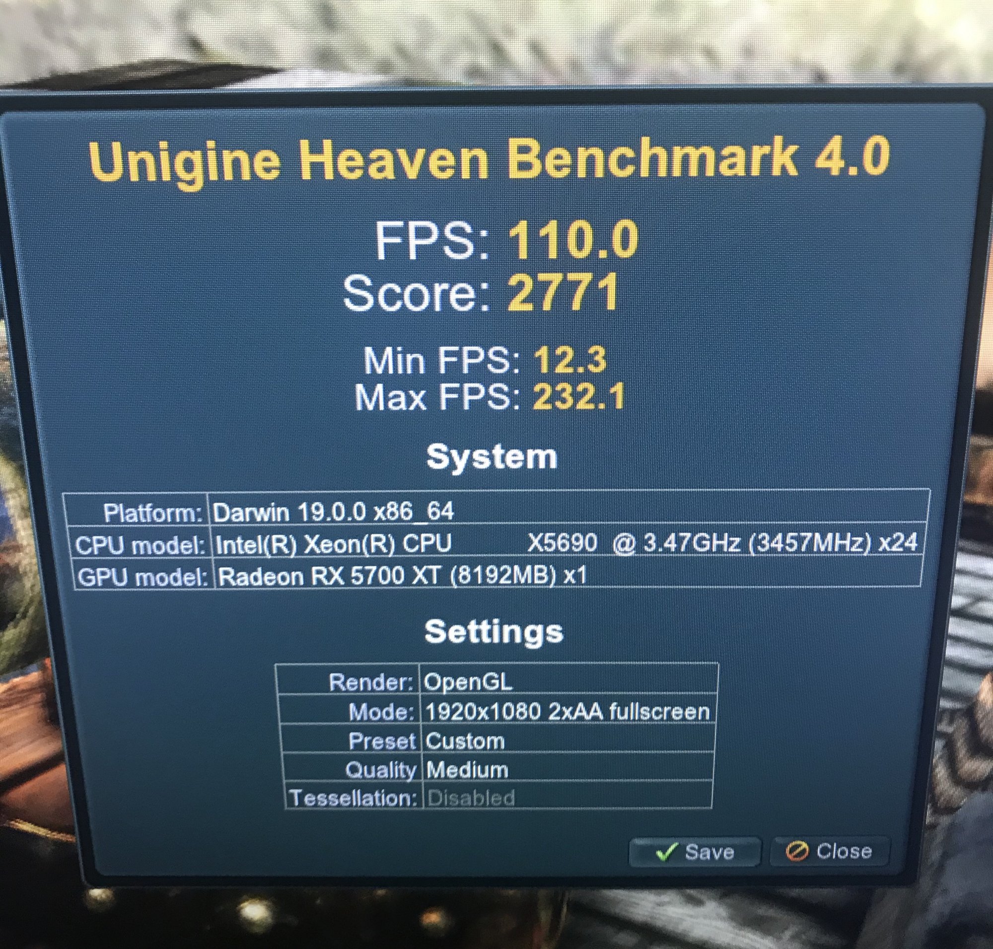

Comparisons for various Radeon cards in Heaven benchmark, all on Medium/2xAA/1920x1080 all on a vanilla Catalina install on the same machine.
RX 580 (Sapphire Nitro+)
RX Vega 56 (Reference blower model)
RX 5700 XT (Reference blower model)
Geekbench 5 results for the 5700 XT were:
Metal: 46182
OpenCL: 49839
the 5700 XT card draws around 220W during high load with instantaneous peeks up to around 260W. The reference board spec for the card is 225W so I’m quite happy running it on an un-modified 5,1.
I think what the benchmarks tell us is that the Navi drivers have a little way to go yet to see the cards full potential. I’m certainly already happy with the figures when taking into account the power draw of this card when compared to a Vega 64.
5700 XT Temps and noise was a lot better than when I tried this card in my PC. The blower models allow for a card directly above the GPU slot as well as getting all the hotter air directly out of the case and I prefer the look of it to the 5700 pulse models, but I can see why people would go for them.
And I think the blower models look neater

Thanks for the info. But I suggest you may try Tessellation Extreme, 8AA, and highest possible resolution.
Otherwise, it’s easy to get into CPU limiting situation, and unable to compare the GPU performance difference.

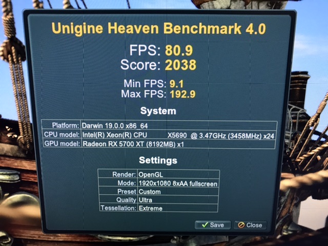

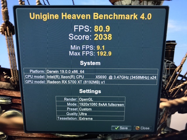

Here you go, Ultra Quality, Extreme Tessellation, 8xAA at 1920x1080.
I watched the benchmark all the way through and it looked stunning, sitting around 78 FPS for most of it. Card was above the system noise, but def not what I would call loud. Temperature of air coming out the back was warm but not hot. What tool can I run on a Mac to log temps during a benchmark?
Reactions: w1z
Yeah, Tessellation really makes a huge difference on the visual. Especially when you look at the rocks, the dragon, the roof... in this benchmark.
Anyway, I just ran the same benchmark with the same settings in Mojave with my Radeon VII. As expected, at the same performance level as the 5700XT.
And I think if you run this benchmark (with this setting) again with the Vega56, more likely you can see the expected performance difference now.

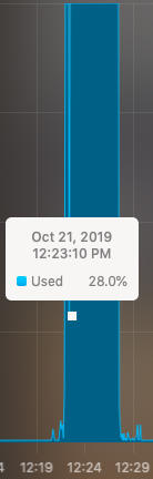

Reindeer_Games
macrumors 6502
Nov 29, 2018
286
228
Pueblo, CO
Like has been mentioned, maybe the CPUs in out MacPro5,1 are getting to weak to feed modern GPUs?

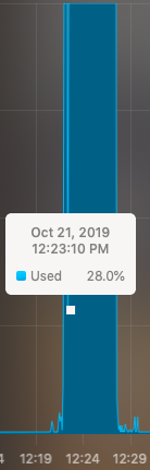

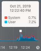

At only 7.2% CPU usage at peak in scenes 2-4 (with RX 580), probably not (IMO).
RX 580 peaks out (with a slight dip, prob at scene change) at 100%.
Does the RX 5700 peak out at 100% usage as well, or cause a higher spike in CPU usage due to the higher frame rate?
For a 6 cores 12 threads CPU, 8.3% CPU total usage may means 100% single thread loading.
If your cMP has 12 cores 24 threads, that will be further lowered to 4.2%. Even we put Turbo Boost into consideration, that will be also just about 4.5%.
If you turn off Tessellation, set the quality to low, AA to off, and resolution to 640x360... (make sure the benchmark is now CPU limiting). You should able to see that there is a process from Unigine Heaven cost about 110% in Activity Monitor (CPU single thread limiting).
And when the benchmark is GPU limiting, that process in Activity Monitor should stay below 100% (not CPU single thread limiting).
In no circumstance you can see 100% total CPU demand even you benchmark the GT120 or even worse GPU. Unigine Heaven isn't that CPU multi thread optimised.
