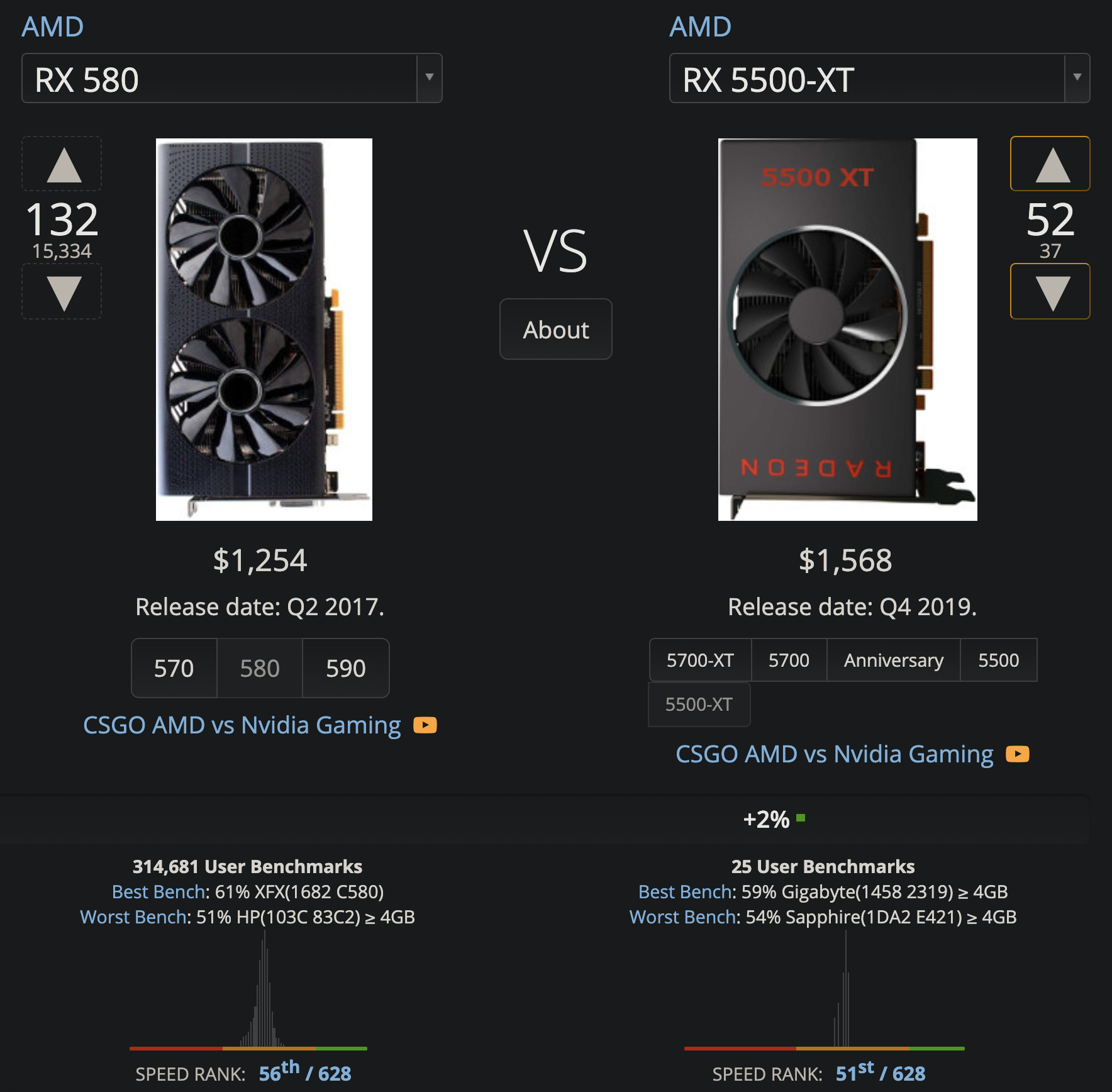

I've read several reviews of 5500 cards and I liked a lot the reference card, but got an impression that is a very improved RX 560 successor and AMD is positioning the card more in this space than the RX 580 one.
Yeah, I also think AMD position that card as the "Navi version of RX560" (low end card in that family). But what I was saying is that 5500XT is at the RX580 performance level (not at the RX580 position in AMD's marketing strategy).

Significant differences also seen at lower settings and the 8GiB model.
I think sometimes it might not be about overflowing the VRAM, but cycling it very fast. Unfortunately, no VRAM numbers are shown.
Not a good video title, it would not be 3.0 crippling but x8:

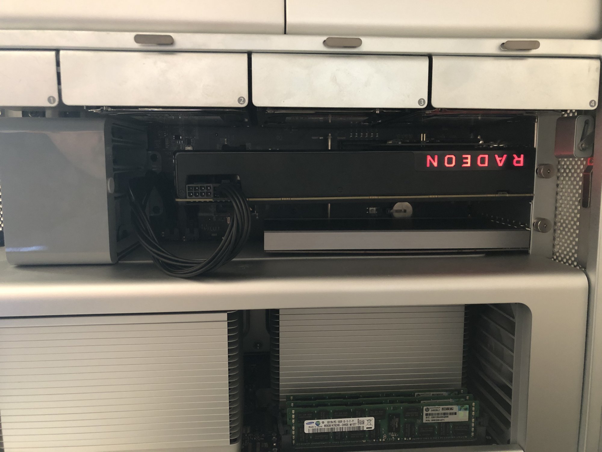

I took a sapphire amd Radeon Vega 56 used, installed in MacPro in signature, connected by hdmi cable at the display of the display 20 "I have the black screen, but it seems to me that the Os has uploaded it correctly, Mojave 10.14.6 last.
What can I do?
What can I do?
Test via screen sharing from another Mac, use a DVI to HDMI adapter, etc.
