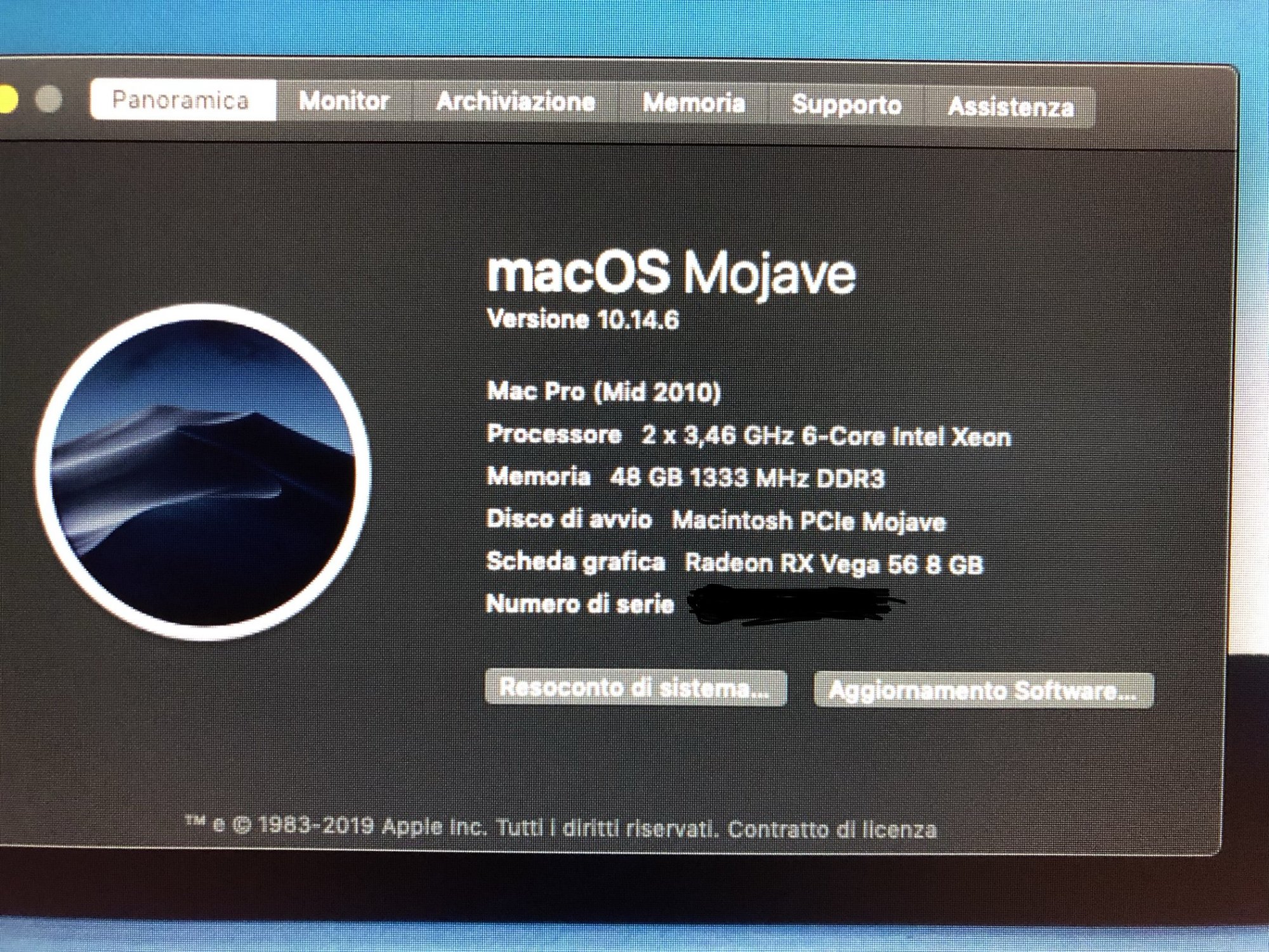

Okay, I'll put the rx580 and the screen clears on the screen so we can see how it recognizes the gpu. Thank you, 1000.
Update:

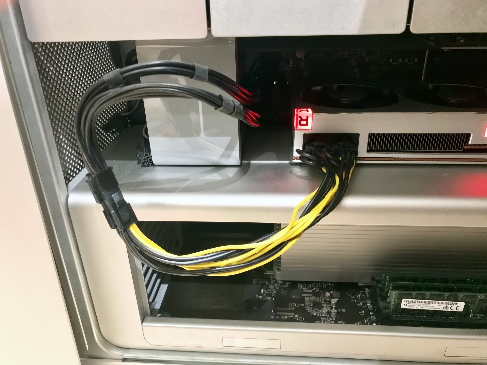

With a good cable I had managed to get her to leave.
At least I have confirmation that it works.
For the wires, I have to do something cleaner.
There is reason to use that cables combination. Which is balance the power draw between the mini 6pins.
The card not necessary draw power evenly from the 8pins. Better to balance them by ourselves, in order to avoid over stressing one of the mini 6pin.

the card must be supplied at both power connections
and the power from backplane will end in shutdown
when the card is claimed
