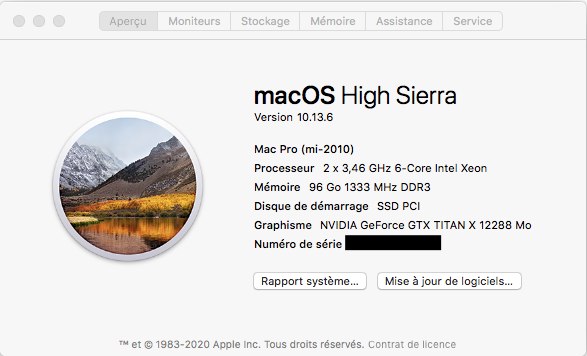

My cMP 5,1 specs :
- As you can see I have a Titan X (it is still a pretty great GPU actually) so no OS update possible.
- I understood all the process so I can upgrade to Catalina (With a native compatible GPU, OpenCore EFI and SIP disabling) I guess will have to buy an Amd Radeon Hd 7950 just to do the update since I don't have any GPU that is compatible with Mojave or Catalina
- I will then try to make it to Big Sur and install an AMD rx 6000 series inside

^^^^The RX6700XT is not supported. Sorry! The RX6800 series requires OS11.4 or higher. I know of no Nvidia GPU that will run in a MacOS past High Sierra 10.13.6.

NVIDIA Kepler GPUs are still fully supported with Mojave/Catalina/Big Sur and the first two betas of Monterey.
Several 2014 Macs that have discrete GPUs have GTX 7xx series GPUs and are fully supported with Big Sur and the Apple NVIDIA drivers still support other Kepler GPUs and that's why you can still run a MacPro5,1 with a GTX 680 with Big Sur.
