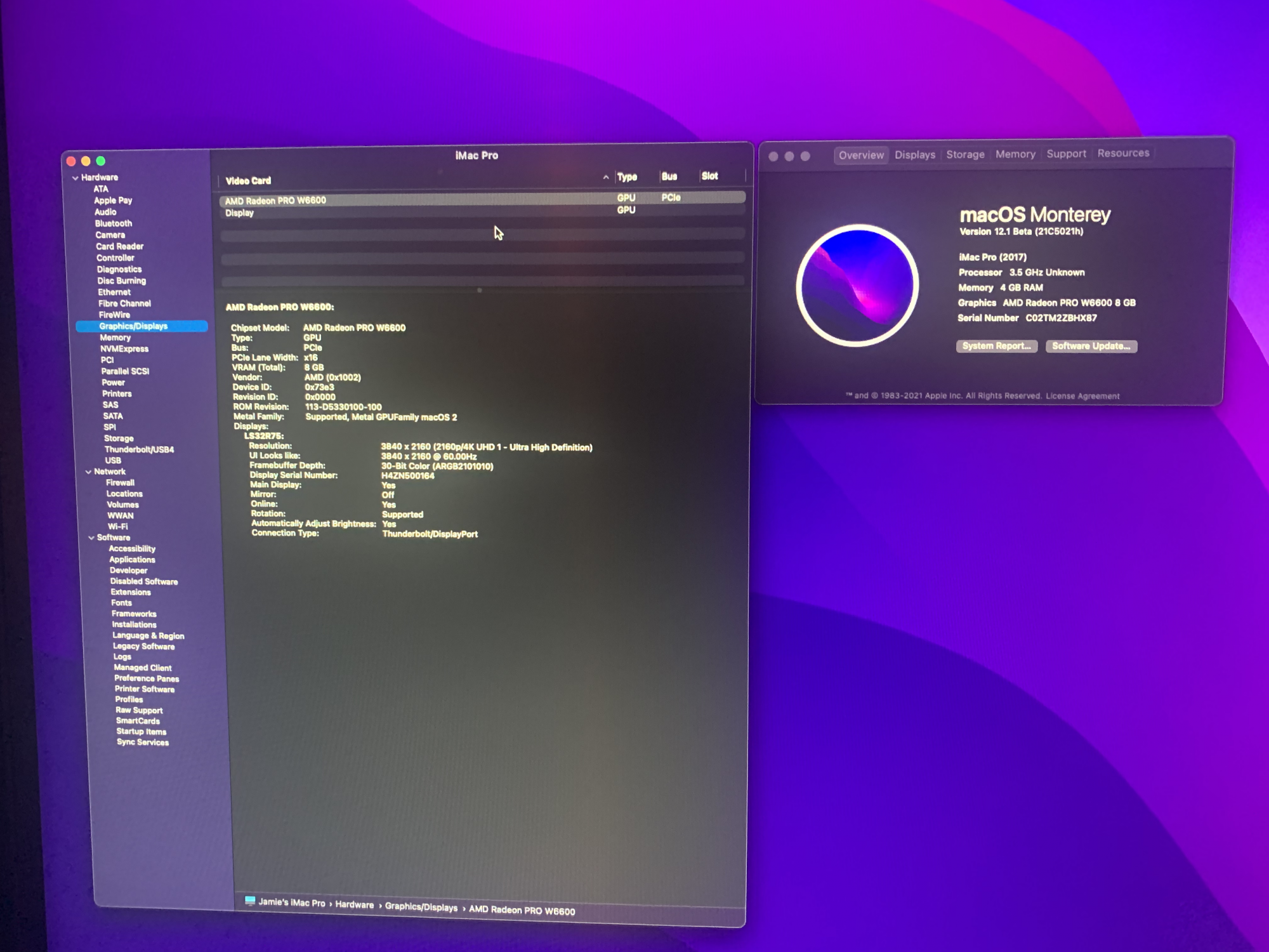

Have just tested W6600 on 12.1 and it does not work.
Never mind, I just got it working, for some reason had to have a 2nd GPU as well and then it fired up.

Hi,I bought a rx6600xtGPU yesterday,5.1mac pro can not open,I see you have w6600,How can I use it? thank you🌹
AMD RX 6600XT will not work with your Mac Pro. Navi 2x GPUs are only supported on 2019 Mac Pro.
A MacPro5,1 will only work with Ellesmere/Polaris/Vega and Navi 1x GPUs. The newest GPU supported on a MacPro5,1 is RX 5700XT, the fastest is Radeon VII.

OMG😭,I thought macos12.1 can do it
You could probably use OpenCore to make OSX think your Mac Pro is a 2019, or an iMac Pro.... look in to it.
While macOS Monterey support your GPU, your Mac Pro hardware itself don't.
It's not yet known exactly what is missing could be AVX support or PCIe v3.0 Atomics/Read-Modify-Write Transactions. Anyway, it's a hardware requirement that is not present on MacPro5,1.
AFAIK, no one ever got a NAVI 2x GPU working on a processor older than Ivy Bridge - not even on a Hackintosh.
If you can't even power on and complete POST of a MacPro5,1 with any Navi 2x GPUs installed, how your gonna use OpenCore?

This is a different situation, I am using a virtual machine, I had to add a 'vmware compatible display' to trick OSX in to booting with the W6600 using GPU pass through. I am not using a Mac Pro I am using a Threadripper PC.
