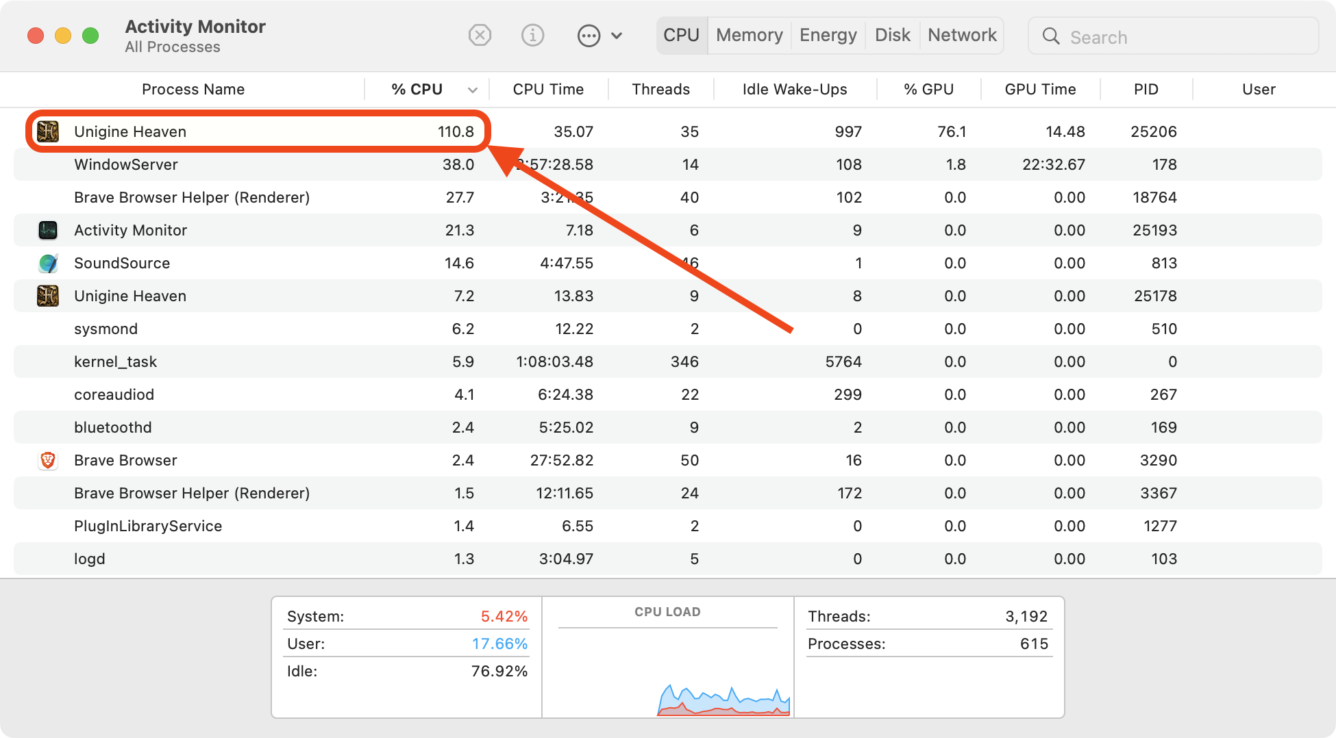

No matter how many cores the game / benchmark can use, there is always a main thread. And if the multi threading optimisation isn't good enough, then that main thread will become the bottleneck.
You can run Unigine Heaven (Extreme preset). This will run the benchmark in window mode. So that you can watch Activity Monitor at the same time. You should able see a process that stay at a bit more than 100%. That's the sign of CPU single thread limiting.

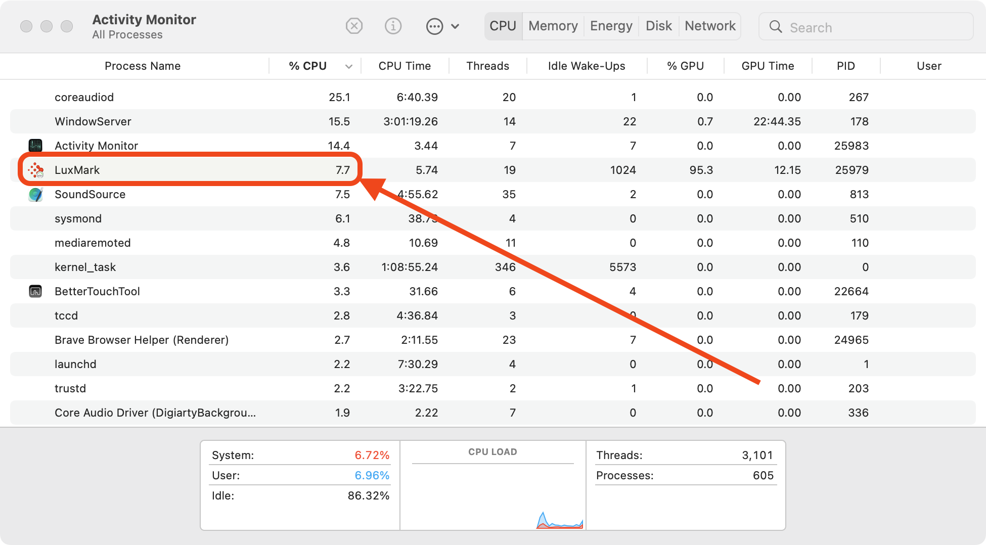

But if you do the same thing for Luxmark, you won't see the same thing. The CPU loading is very low and never reach 100% during the test. That's why it's so effective to avoid CPU bottleneck on GPU benchmark.

You can try, but most likely it won't work, the CPU will try to balance the workload between cores (to balance the heat exhaust, therefore, reduce the chance of having thermal throttling on a single core). e.g. For a ~110% CPU loading process, you may see ~9% loading to each core, but not 100% on one of the core.
The CPU works at more than 3 millions cycles per second. Even the process is CPU single thread limiting, it can be...
Core 0 complete the 1st step computation at first CPU cycle.
Core 1 use the result from Core 0 to perform step 2 computation at the 2nd cycle.
Core 2 use the result from Core 1 to perform step 3 computation at the 3rd cycle.
And after a second, each core performed around 300,000 computation already, but you can only see ~9% workload on each core, nothing is saturated. However, since each step must wait for the result from the last step (which is from another core), therefore, the process is still CPU single thread limiting.
CPU single thread limiting is the process itself cannot utilise multi core effectively, but not the CPU will only use one core thread to finish the whole process.
