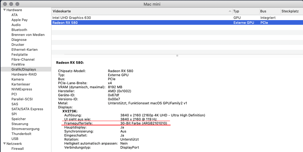

4K HiDPI resolution 'looks like 2560 x 1440' not possible in 120 Hz in macOS Mojave
No benefit of the RX 580 and DisplayPort 1.4.
My new monitor Acer Nitro XV273K supports resolutions up to 144 Hz (10 Bit ARGB 2101010 up to 120 Hz). The native resolution 3840 x 2160 pixel will be displayed @ 120 Hz.
However, not the scaled resolution 'Looks like 2560 x 2160', only 60 Hz possible. Any thoughts?
In Windows, however, no problem, scaled resolution 150% works @ 120 Hz.

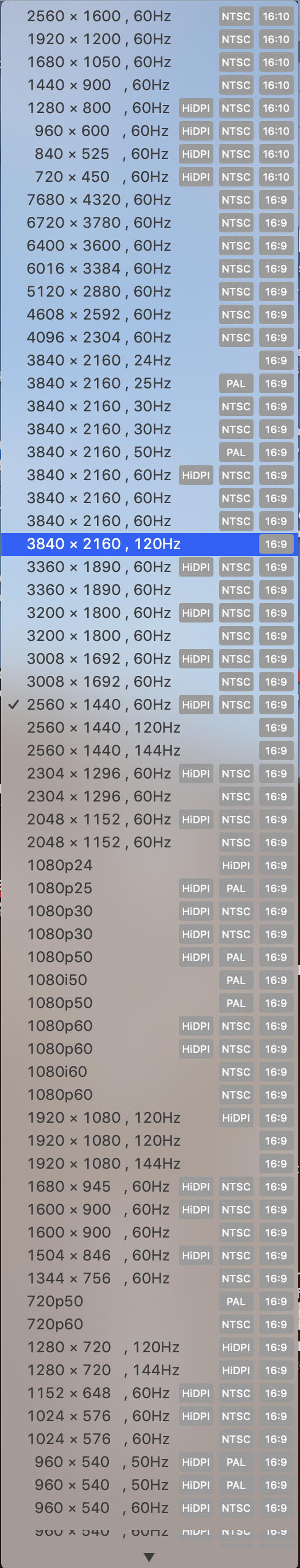

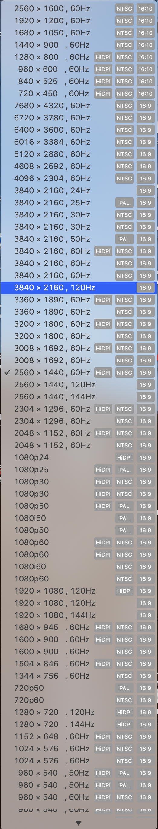

Here all my possible resolutions with the new monitor:
Same options in ResXtreme?
http://resxtreme.com
It's free, worth to try.
Yes, the same in RexXtreme.
I found out that even DisplayPort 1.4 has not enough bandwidth to support 3840x2160 at 120Hz with full 10 Bit RGB 4:4:4 color. This is a very informative article: https://www.anandtech.com/show/13060/asus-pg27uq-gsync-hdr-review/3
In Windows I had to enable Chroma subsampling 4:2:2 to get 4K/10 Bit/120 Hz. Whereas 4K/8 Bit/120 Hz with full RGB 4:4:4 is no problem.
In macOS I can get 4K (native, not scaled)/10 Bit/120 Hz, but I guess macOS is cheating.
Either the unscaled fonts of Mojave are very bad, or macOS activates Chroma subsampling 4:2:2:
