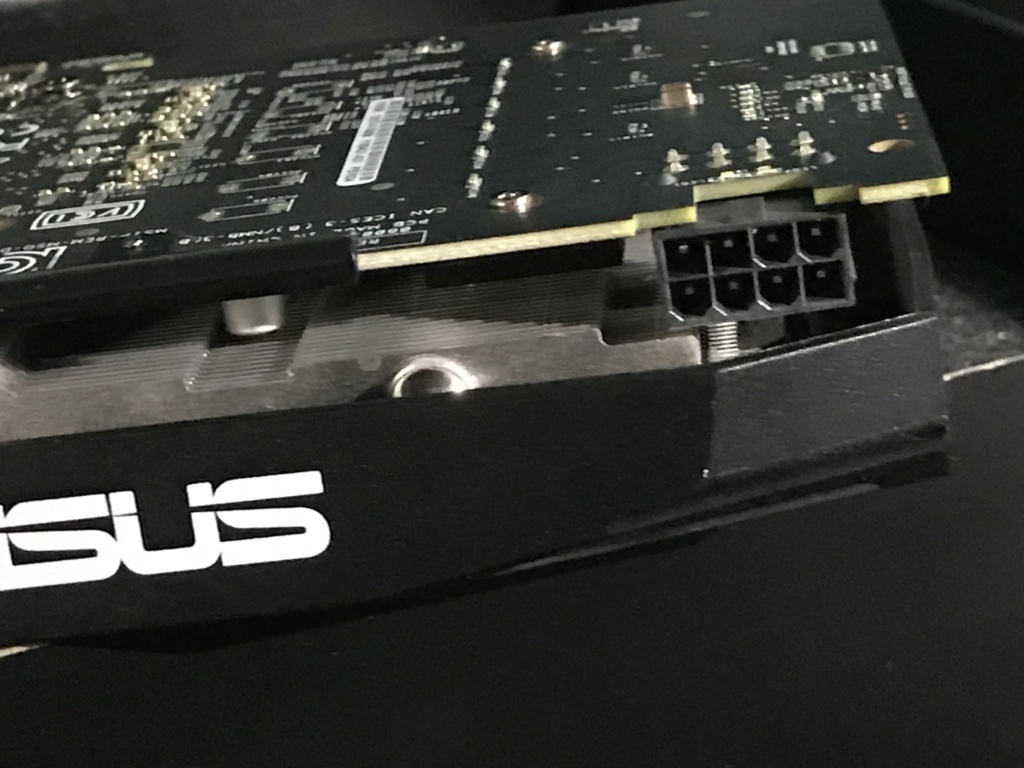

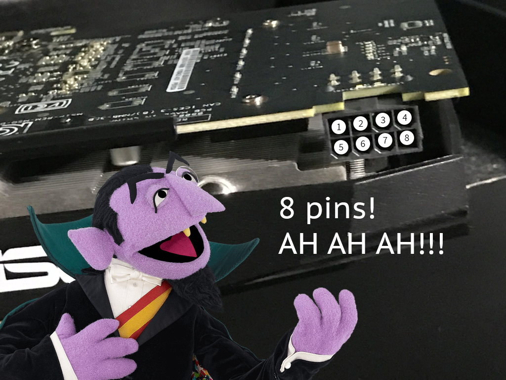

Ok i'm in this situation and i hope this will help me out, I have an Asus Radeon RX 580 8gb OC edition card, what is the best way to connect the power to this card, if i understand you correctly, i need to buy 1 dual mini 6pin to 8 pin, and one 8 pin female to dual 6+2 pin ? on this card i only have 1 4 pin plug to connect to, would this apply to me?
Single 4pin? Please post the picture here.
This is what i'm referring to.
This is the label on the box:
you can use a dual mini 6 pin to a standard 8 pin cable (all male plugs on the cable)
another alternative, but likely a few $ more due to more individual cables, is to use two separate mini 6 pin to standard 6 pin cables (male plugs on these cables), and then a dual FEMALE 6 pin to MALE 8 pin

I think you'll find that's an 8-pin, and not a 4-pin, power connection. Let's get some help from a friend of mine to be sure...
LOL... AHH yes sorry my bad, was thinking if the connector itself , when composing my post.
@skizzo, Thanks, i ordered the first one.

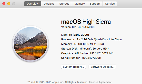

While i'm at it, what would be the best OS to run this setup? I'm currently on 10.13.6 would Mojave offer me more? (ps i do love the dark mode :) )
Reactions: BillyBobBongo
YMMV, but Mojave is the most stable OS for me so far, better than anything since 10.6.8. And it’s performance is definitely beyond 10.6.8 due to much better GPU support, and designed to run with SSD.

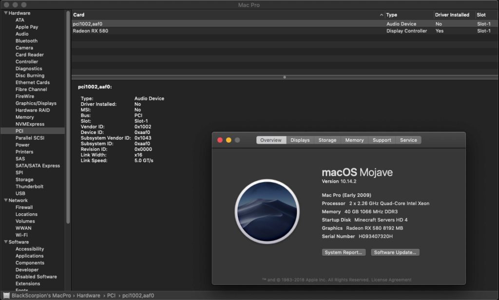

Update. Installed the card and booted up with no issues it's showing the card model correctly., I hAve no boot screen, but it's not a problem for me. I'm in the process of installing Mojave, hope all goes well. Will keep ya posted.
OK so after an hour of Mojave installation , im proud to say i have successfully upgraded!
Now can someone tell me what this pci1002,aaf0 is?
