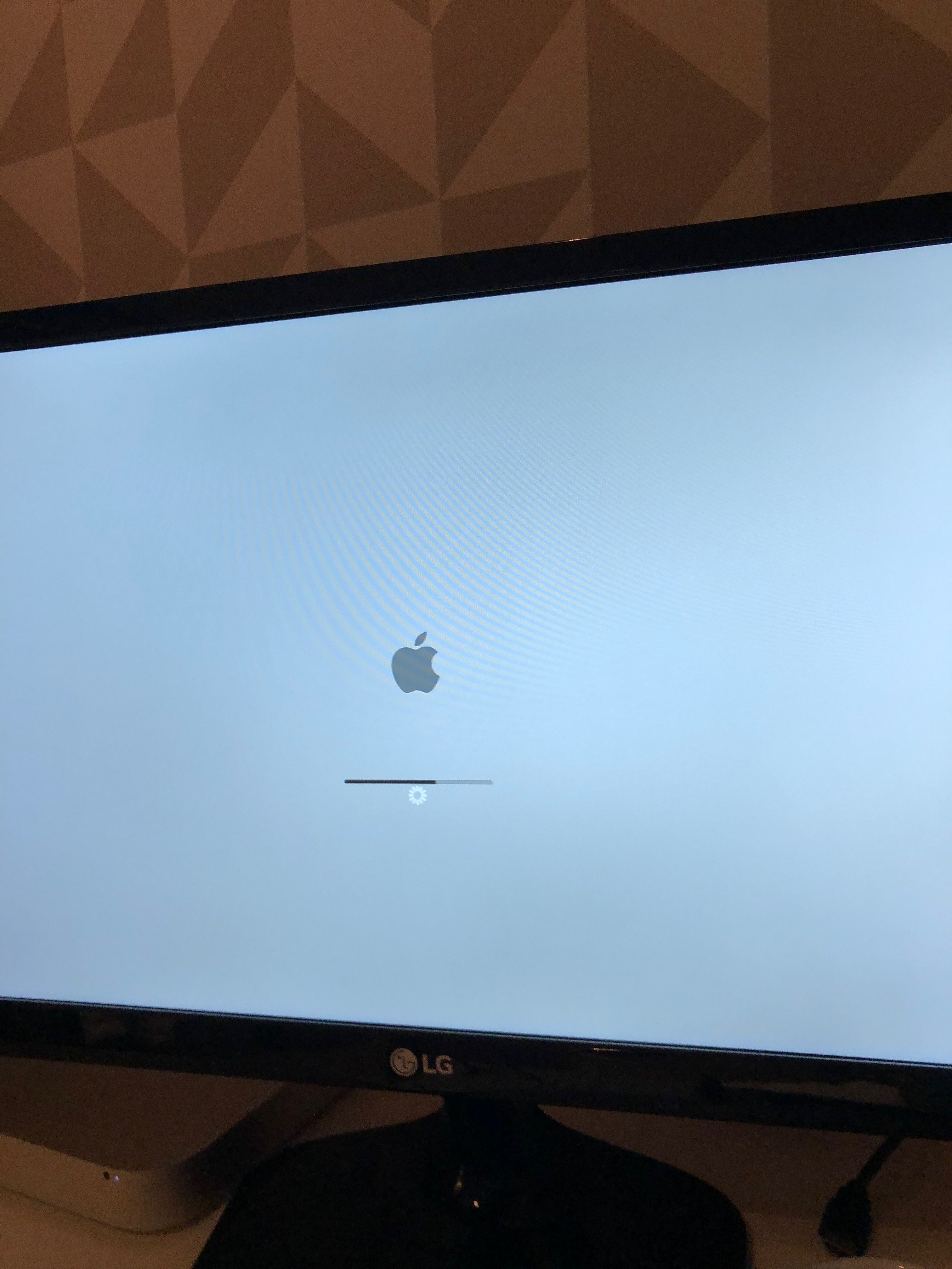

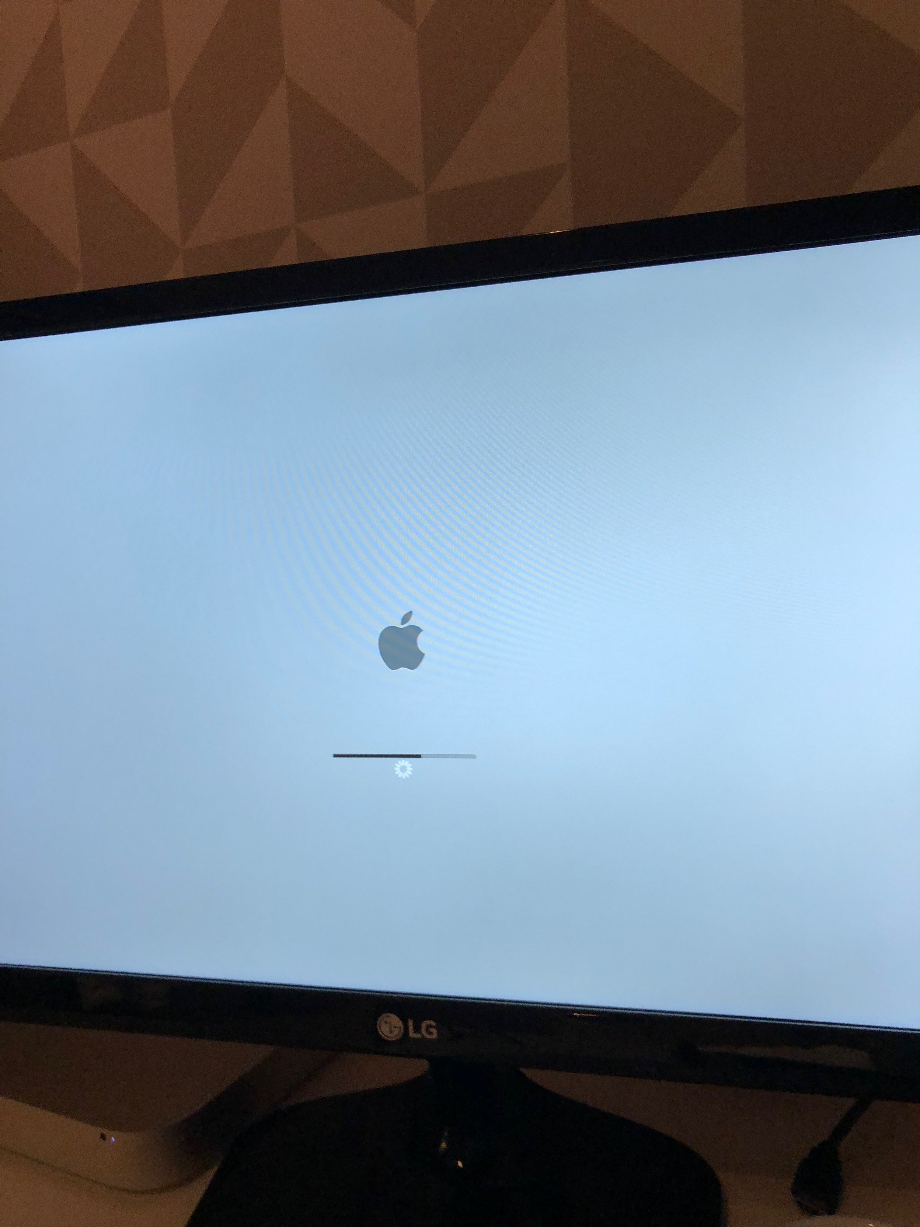

Hi, need a little help
I just bought a Sapphire Rx580 Nitro+ 8GB for my cMP 3.1 early 2008.
After installing it, when I boot up, the screen is completely grey and nothing happens.
I tried to connect both VGA (hd2600xt) and then I see boot image, but it hangs out with the apple logo and a strange loading icon, attached is an imaged with the problem.
My cMP has High Sierra 10.13.4 with dosdude1 patch
What could it be?

If I start the Mac Pro in safe mode, it turns on, and can login and see on System Report, that the rx580 is recognised by the system, but it is unusuable in safe mode.
Need help, don't know what else to try.

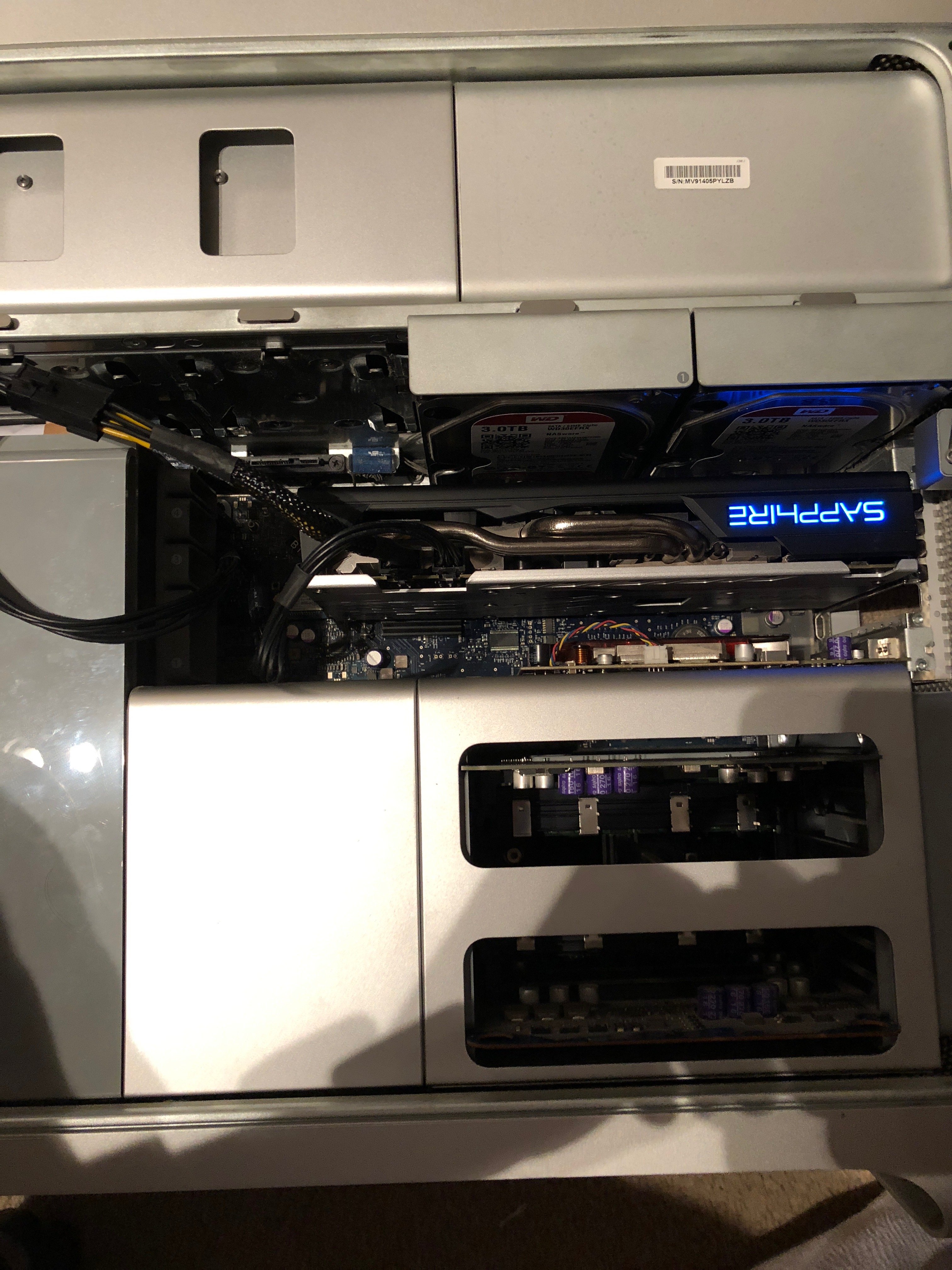

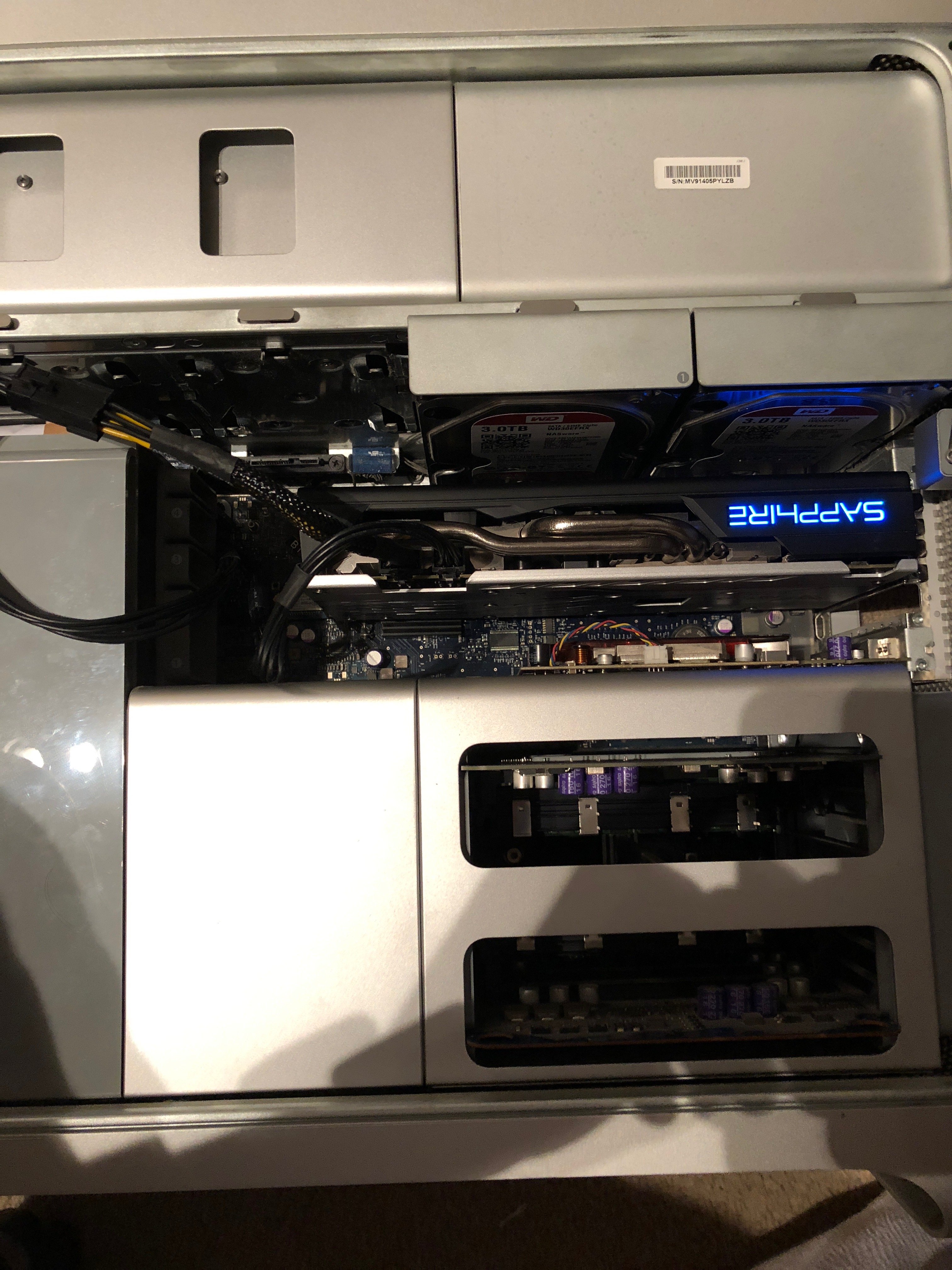

[doublepost=1524792854][/doublepost]I believe that I have encontered the problem.
Since the VGA has 2 power inputs (1x 6 pins, and 1x8 pins), I have read that the 6 pins it's just for showing since doesn't gets any power.
So, I will try to power the 8 pin, with a splitter using both 6 mini pin pcie connection. I'll buy the cables and post the results.

When ever there is a 6+8 pin on the card. You should connect ALL of them properly. Occasionally, some card can only work with the 8pin connected. But I never see a card that come with a completely useless 6pin, or even connect the 6pin will stop the card to perform properly.
Anyway, you should move the RX580 to slot 1 (the bottom slot), and remove all other GPU if not required.
I've tried everything you say, remove al PCI cards, connect all of the power cables, but nothing happens, the same results.
After reading half of the internet, I do believe it's an under-power problem. The RX580 might need more power than what cMP 3,1 can deliver.
I will try to connect both mini 6 pins to 1 8 pin on the VGA to see if that works, and if don't, might try to connect the optional 6 pin on the VGA to SATA connection and see if it works.
Last solution that I can try, is an external PSU, but my electrical skills are not that advanced.
UPDATE: I made it work.
I have reinstalled high sierra with dosdude1 patch, and selected the AMD fix, and now the cMP boots and it's usable, but...
It made the mac boot, but the screen is super laggy, and I cant even run a benchmark. Even the colors look really strange
