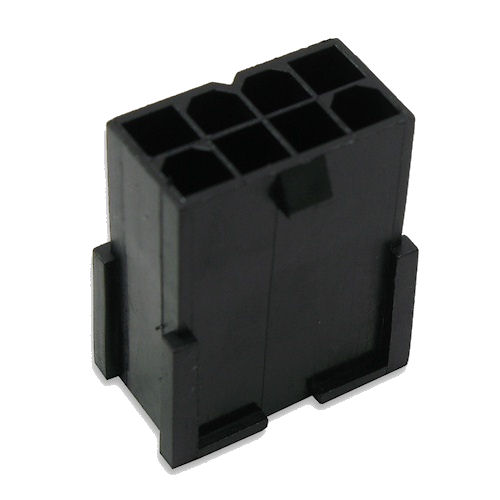

The picture looks correct to me, why it doesn't fit?
Now that i'm looking at the picture on the website it looks like they sent me the wrong type. The one I got looks like this:
