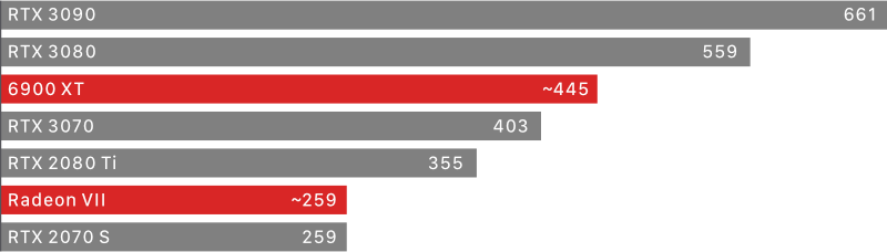

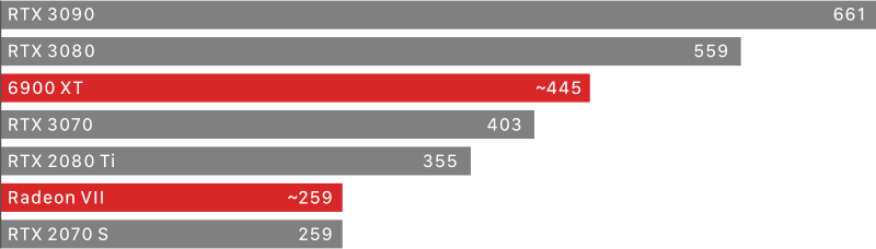

Based on the information so far, I have created an interpolated chart for Octane bench. If these results are confirmed then the 6900XT is insanely fast taking account Octane X does not use hardware RT on Radeons at the moment.
These are the numbers I gathered during 4 months wait.
I got pieces from here and there so please take it as a grain of salt.
Numbers might be off and outdated.
OB Score (Octane Bench Score)

As Xenobius pointed out, I am also assuming an OB Score for 6900XT as 400-420-440ish, which in my opinion, is great in terms of cost and performance balance.
Reactions: hifimac
Beppe has updated his Octane X graph with my 6900XT result:
It is probably faster as the current OB benchmarks are very few and we don’t know the exact configurations of the system they are running on. Looking at the metal benchmarks gives a better understanding of the cards capacity I guess, it’s more in the range of the 3080 there.
The 6900XT should be on the performance level of the RTX 3080/3090 (or even higher) if Octane X will use Radeons RT cores. Hopefully Apple will introduce support for hardware raytracing in their Metal drivers soon.

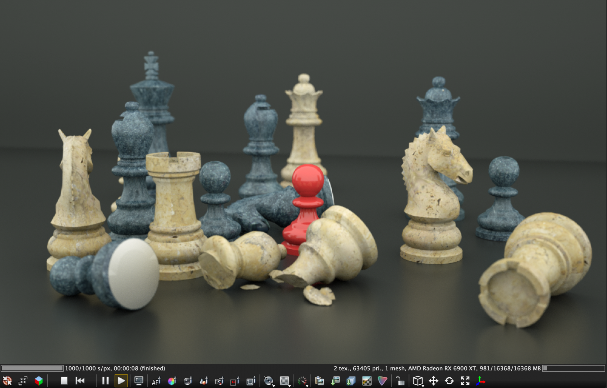

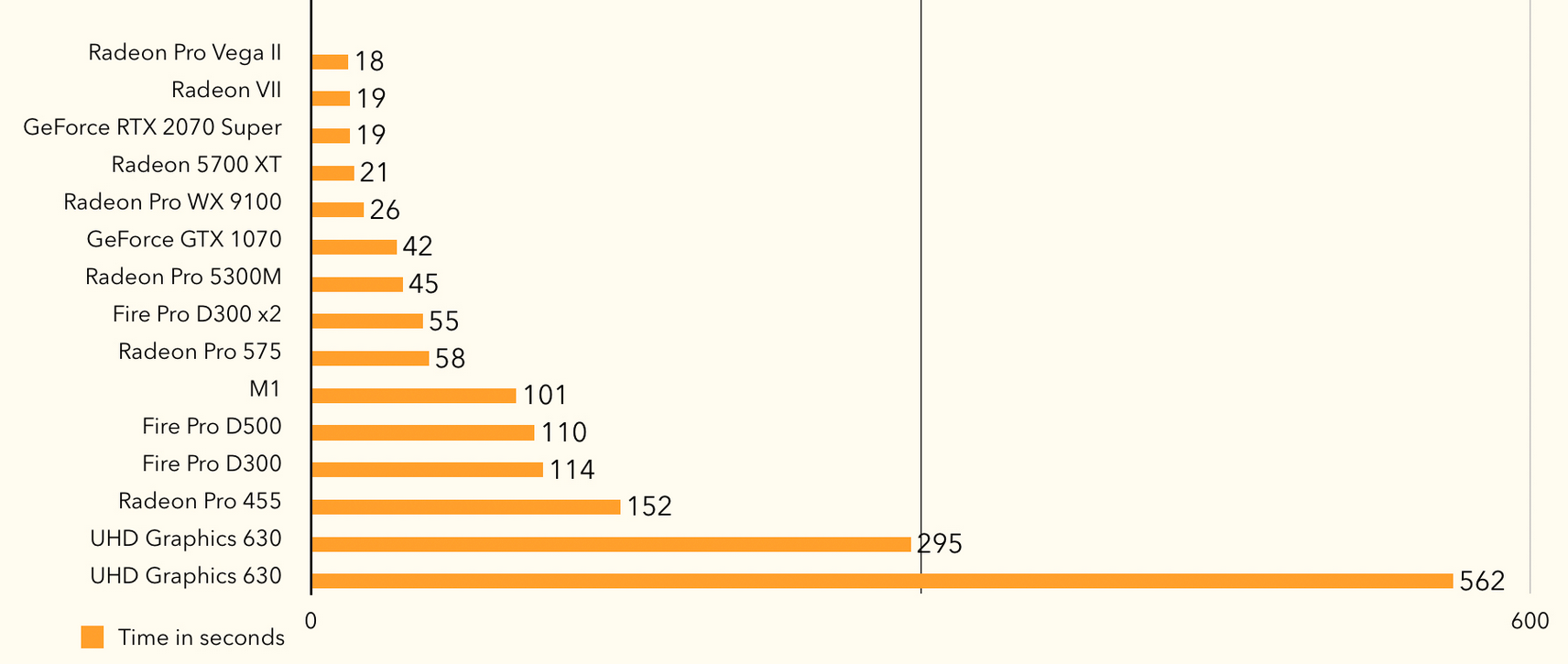

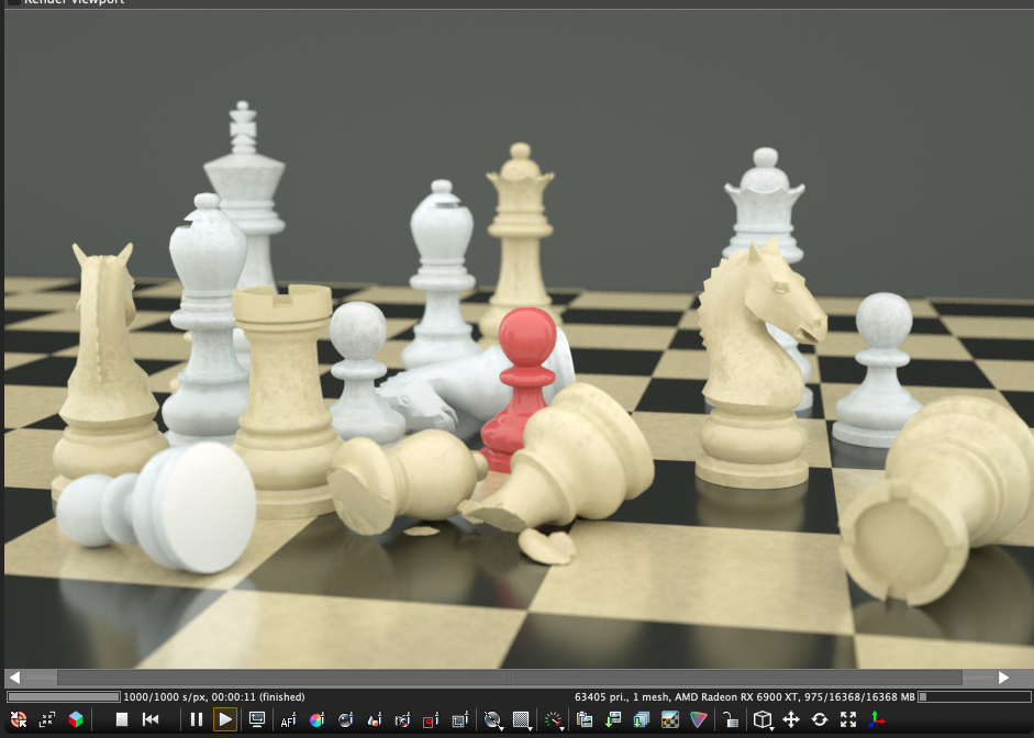

@vslab I heard back from Beppe of OTOY that Octane Benchmark doesn't support Metal GPUs, and won't until later in the year. So that's out for the time being.

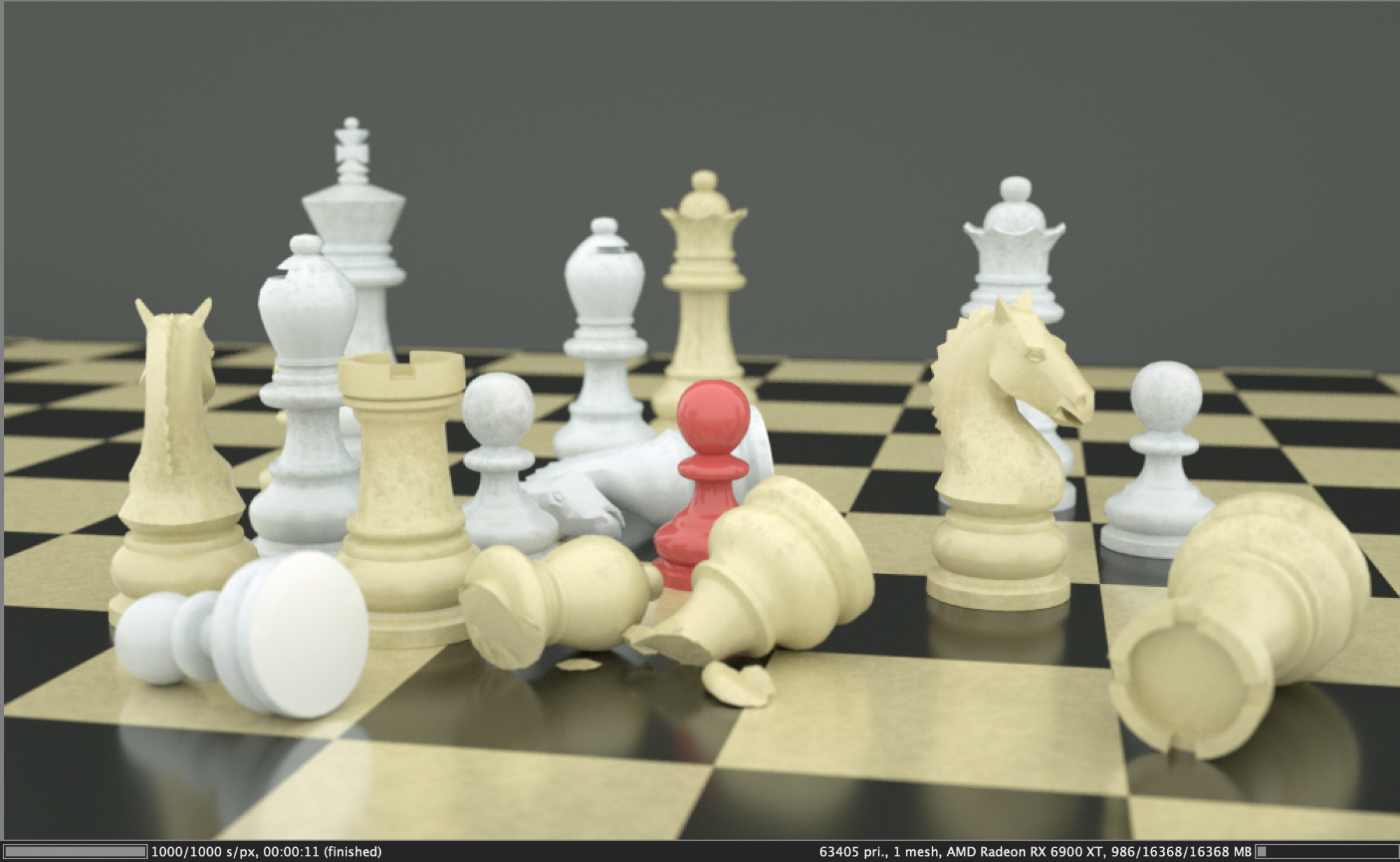

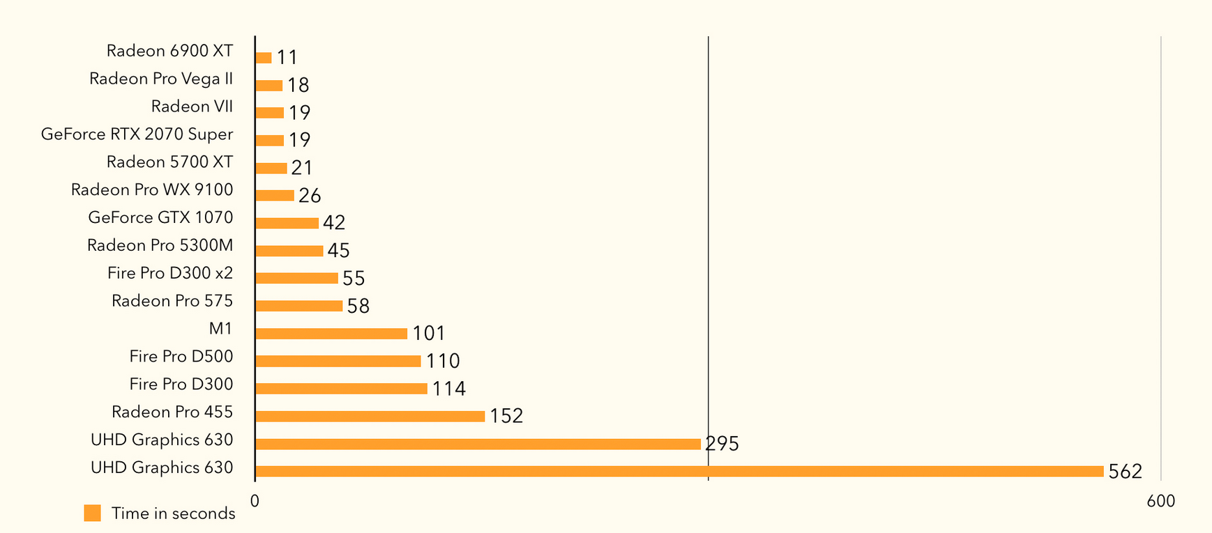

But he did give me an alternative benchmark, in Octane X: a "Chess Set Procedural" orbx file which he's been using to benchmark different GPUs.
I've got the 6900XT in my main system now, and I ran the benchmark as per his instructions.

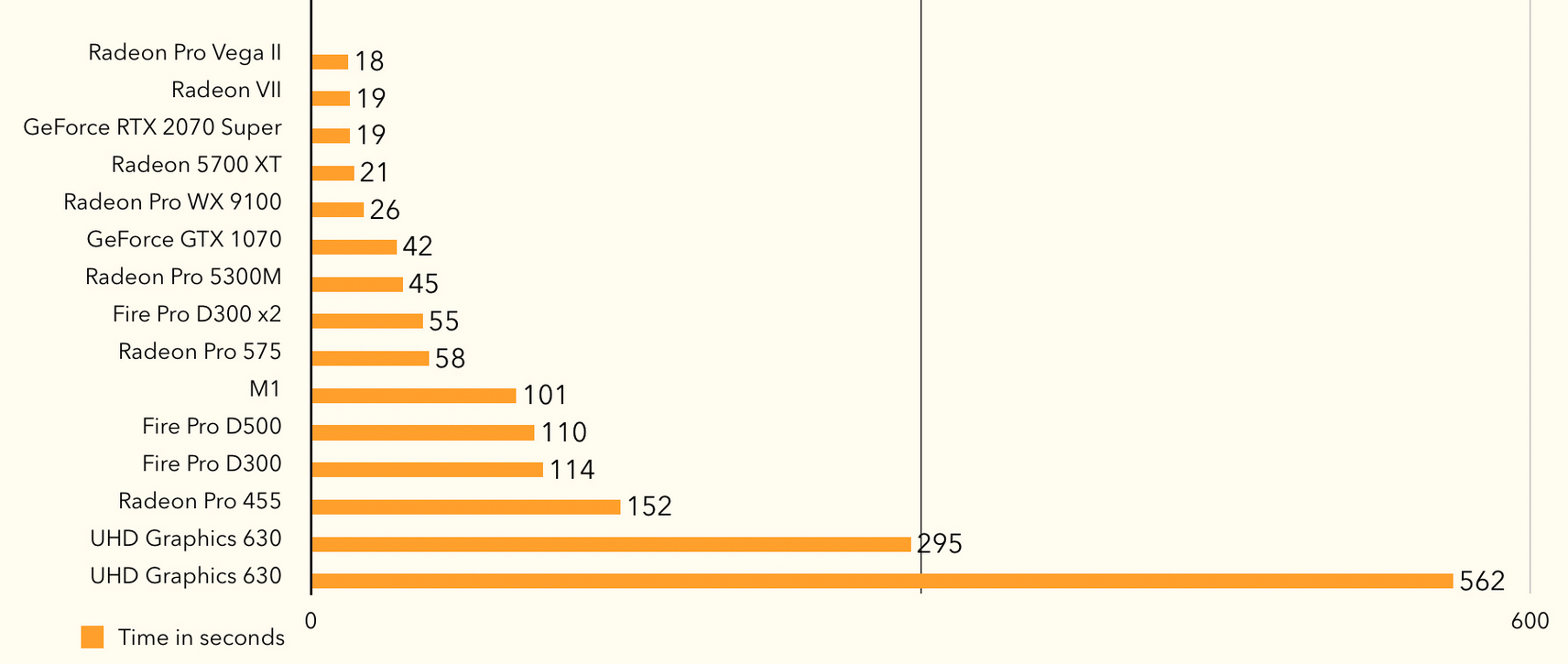

Here's the competition:
My result...
11 seconds!
Very pleased :)

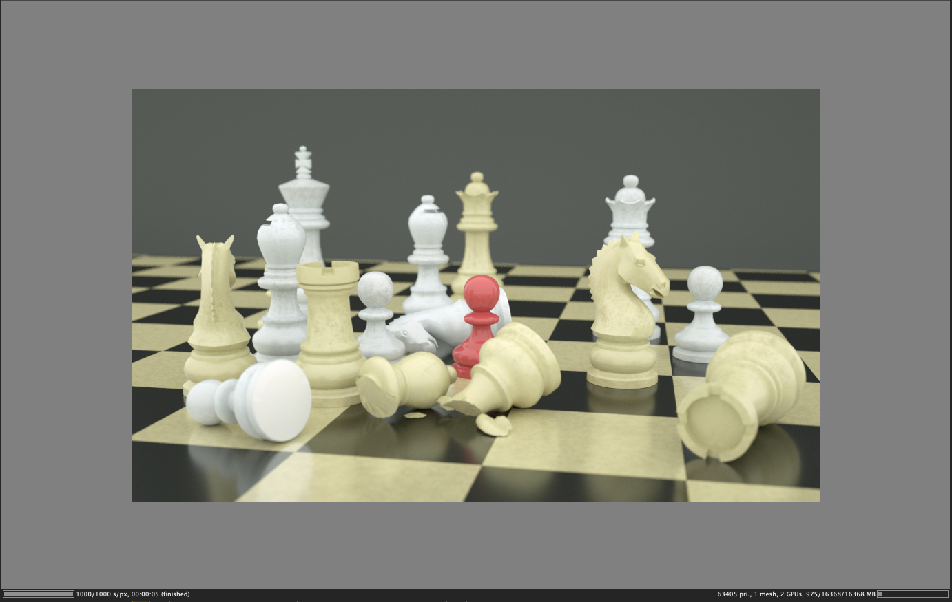

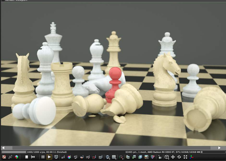

8 seconds here!
8 seconds here!

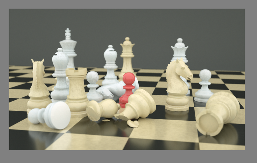

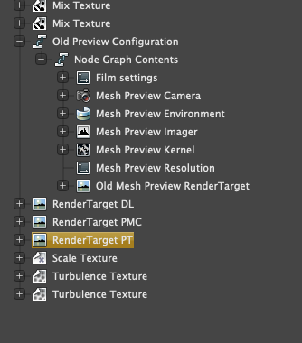

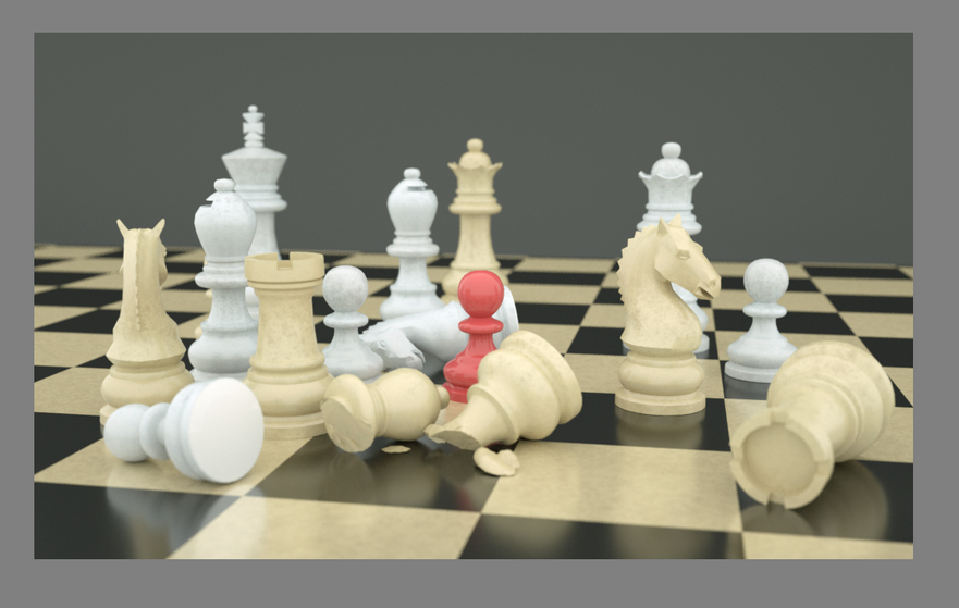

Nice result - but your picture looks different. I think you rendered a different target. Mine looks like this:

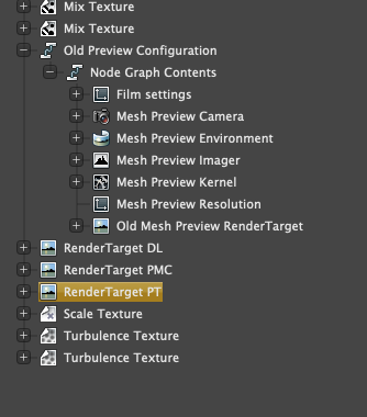

The target to render is "RenderTarget PT"
Attached is the file to open in Octane X - unzip it, and then double click it while Octane X is open (I found that if you double click it before opening Octane, it doesn't register it and opens the Demo project, which confusingly also contains a version of this scene.)
Then render "RenderTarget PT" near the bottom of the Scene list in the left pane

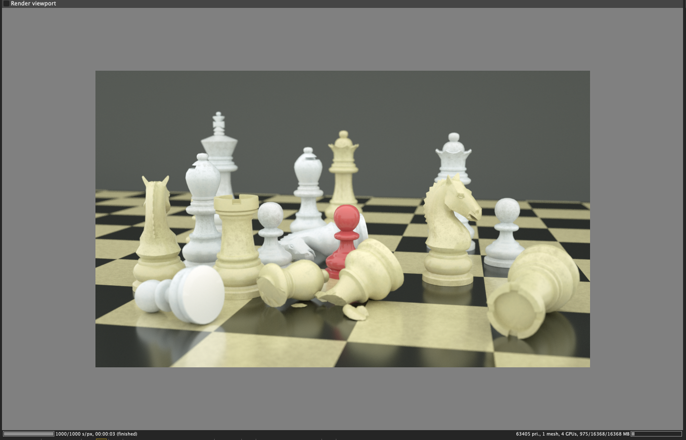

you were right, the same 11 seconds ..

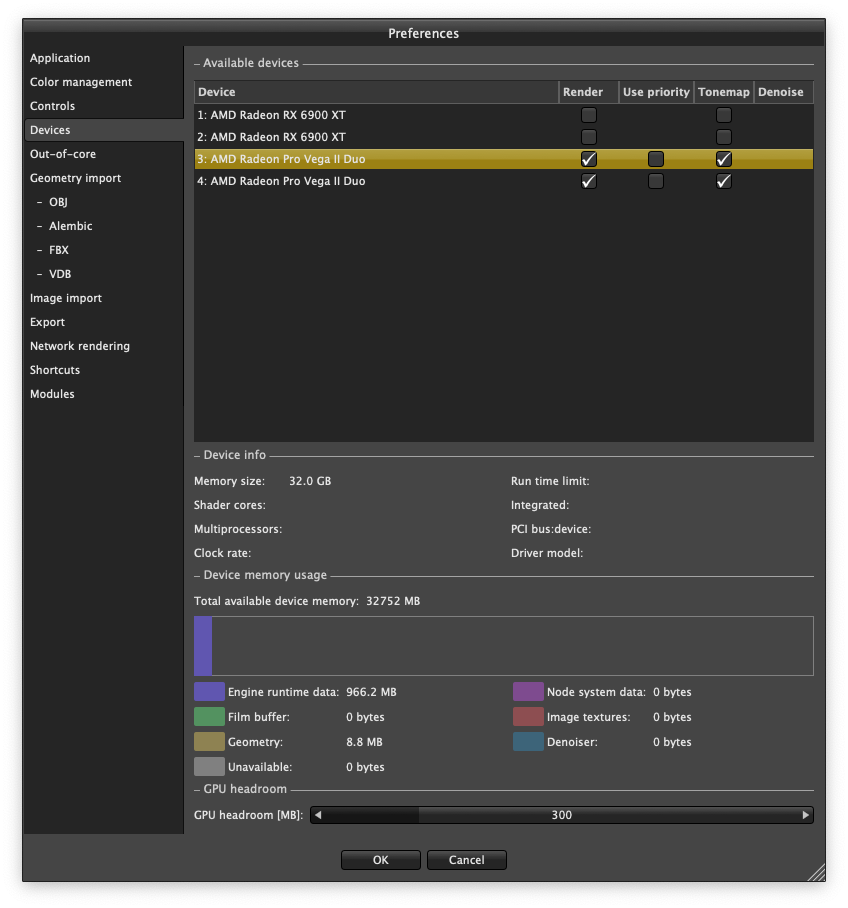

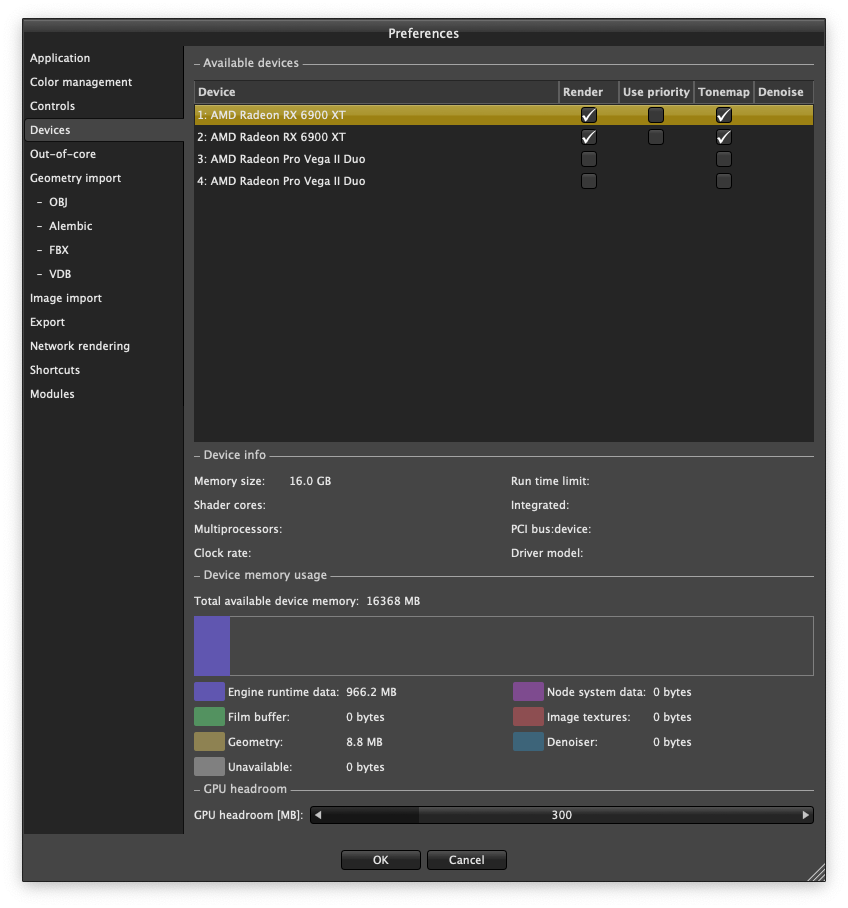

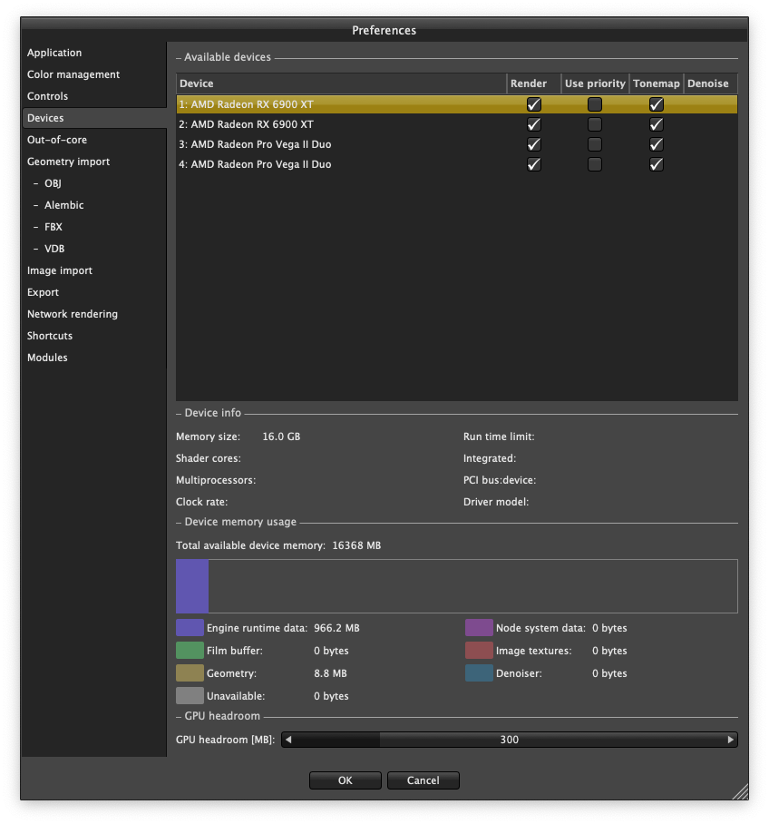

OK, I couldn’t resist installing Public Beta 11.4 Beta1 on my production machine, which is something one should avoid especially in the middle of a project…
Anyway, my 6900XTs are fully working now! Wow.
I was lucky enough to get some reference model 6900XTs and one 6800XT when price was lowest. My MacPro is loaded with Radeon Pro Vega II Duo, and two 6900XTs as show in the picture on post #87.
I was concerned about wattage consumption but as long as I monitor with external wattage checker when using Octane X, it seems OK so far.
Tried few tests;
- Octane X PR11 “Chess Scene”
Radeon Pro Vega II Duo (using both) 9sec
6900XT x1 11sec
6900XT x2 5sec
Radeon Pro Vega II Duo + Dual 6900XTs 3sec
Yes. Dual 6900XT is faster than Vega II Duo. Using all of them results 3sec, which I think hitting the ceiling because even if I attach another card via eGPU makes no difference. If I switched to heavier load by rendering with PMC kernel, the speed increase of adding eGPU can be seen.

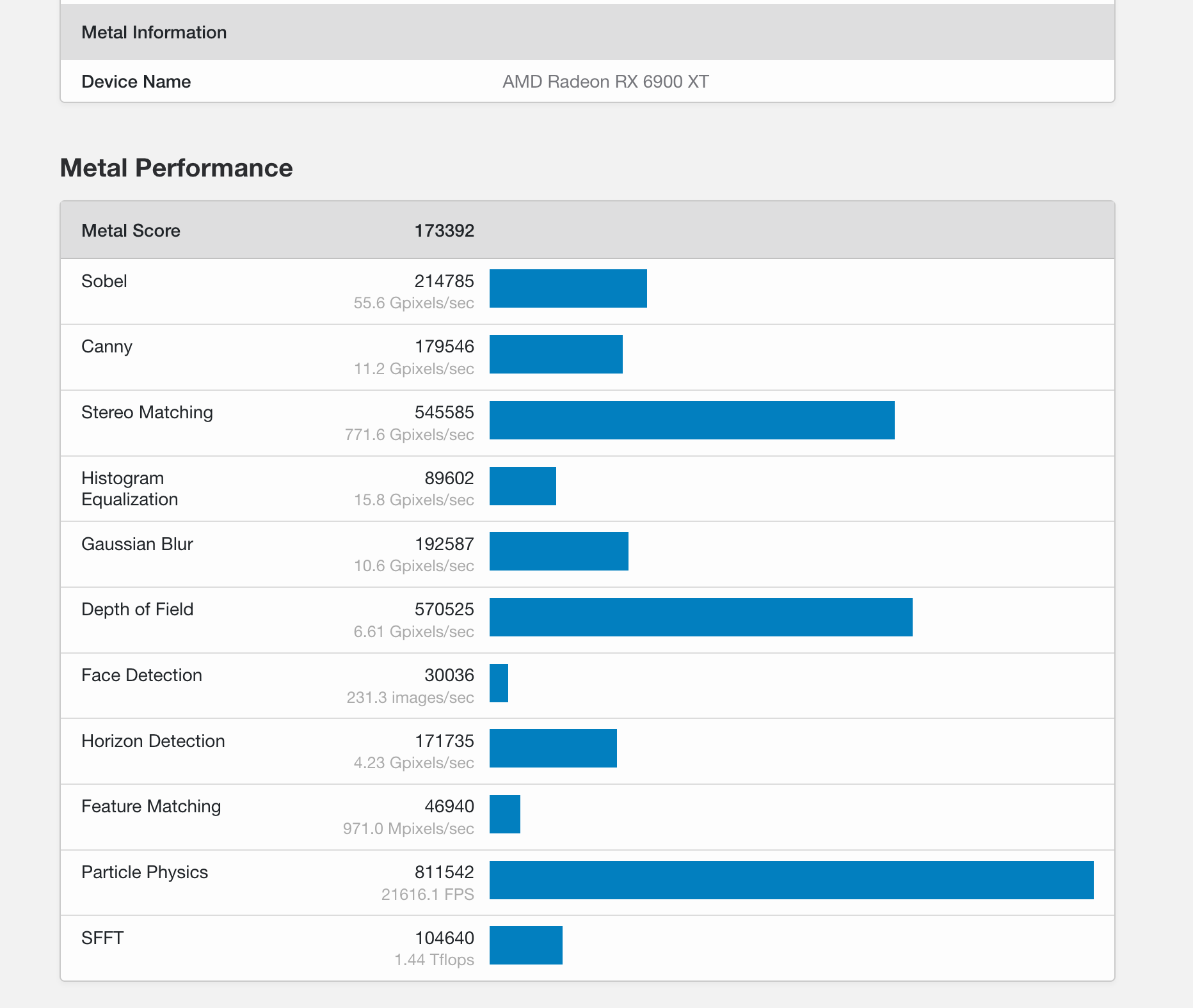

- BASEMARK GPU (MacOS Big Sur 11.4 Beta1)
6900 XT no.1 15404
6900 XT no.2 16019
Radeon Pro Vega II Duo (single) no.1 8184
Radeon Pro Vega II Duo (single) no.2 8458

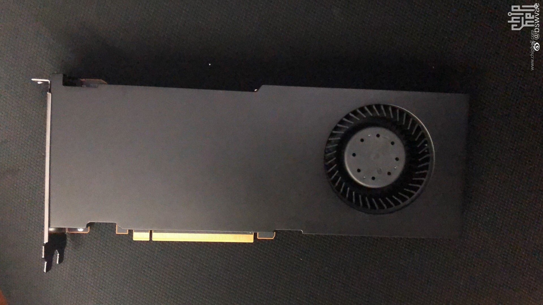

Looks like apple is prepping a MPX module?
We can hope, it might even be one of the first time in history when the Apple GPU price is competitive with the "market" price.
Where I am, getting a MPX 5700 is within a $100 of the second hand or scalped 5700 XT...
The photo is not of a MPX module, but from a standard PCIe GPU (seems to be the OEM version of Radeon Pro W6000) and the original Geekbench is from a hackintosh. It's very easy to spot, since no Mac Pro has Core i9 as a CPU, all real Mac Pros identify as Mac Pro (2019), a detail frequently overlocked by hackintoshers, and no other Mac has PCIe slots.
Yeah I know, but it look's promising with the product naming. It could be used for a mpx module. Time will tell :p
The naming scheme is definitely for an MPX module. A Radeon's Pro product would be like W6900.

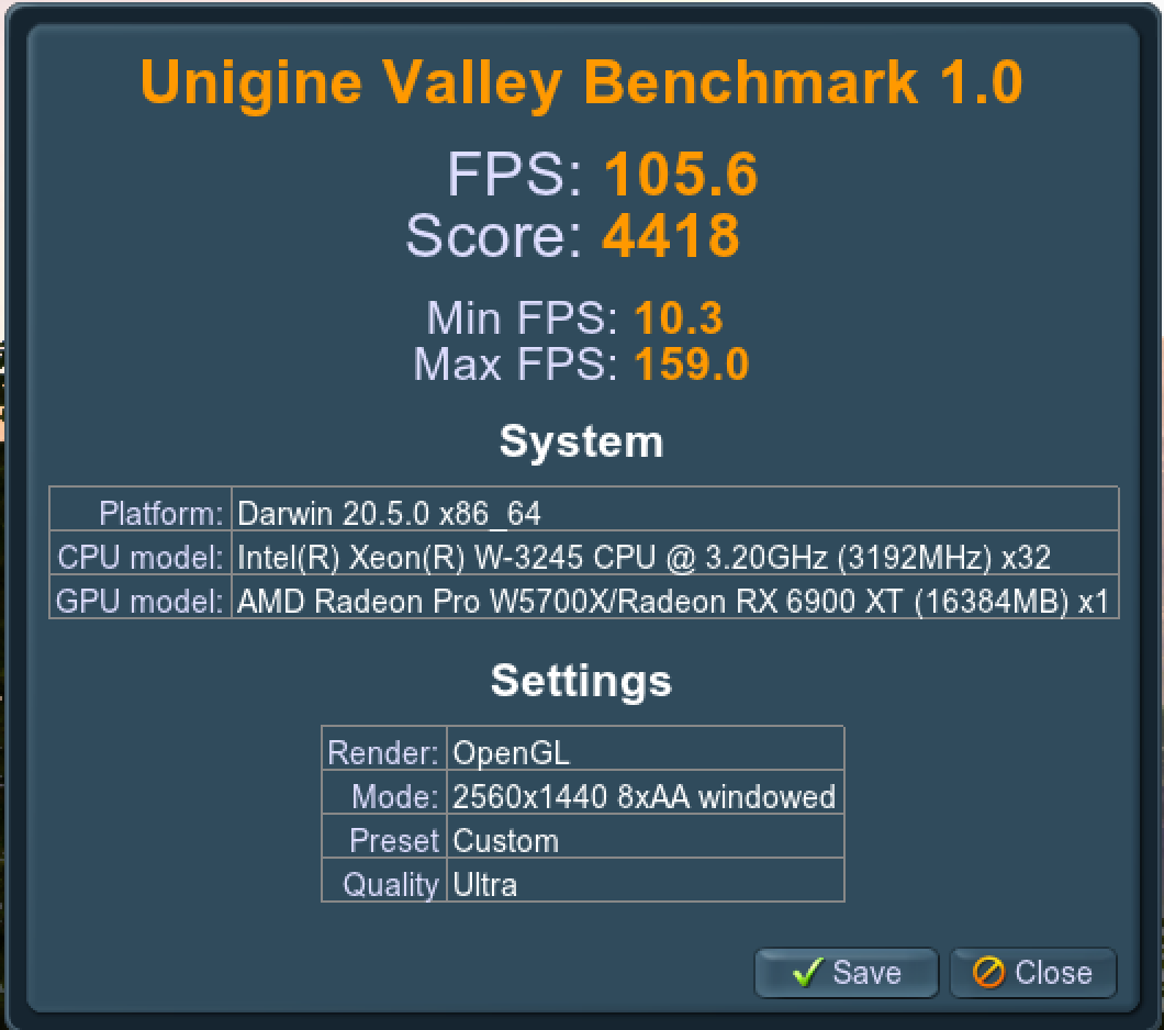

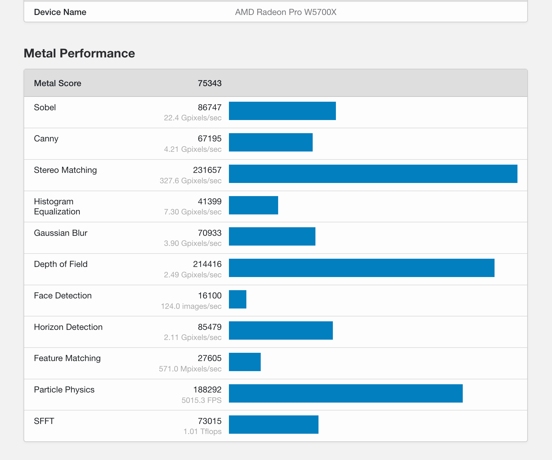

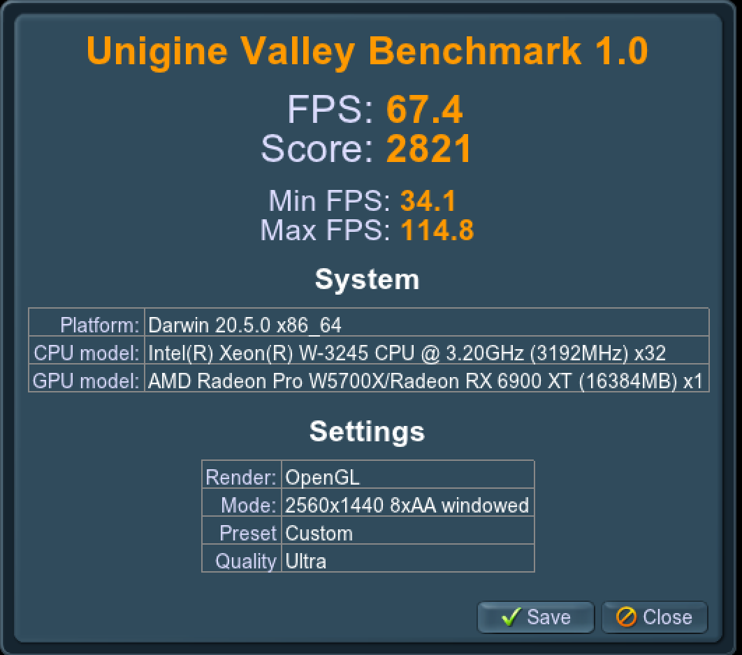

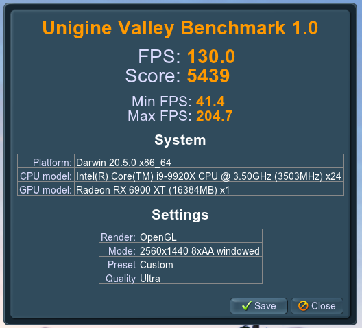

I couldn’t resist too. i installed the Beta on a pci M2 SSD. Seems stable so far and sleep is working again.
Would like to see some real time ray tracing demo or game on macOS if there are any.
Do you use it with your display(s)? or only as a "compute" card for rendering?
with the displays. one time i connected my LG WQHD+ on the 6900XT via thunderbolt and my Benq SW271 via HDMI on the w5700W.
and the 2th time my LG WQHD+ to the w5700X via thunderbolt and my Benq SW271 via HDMI on the w5700W.
