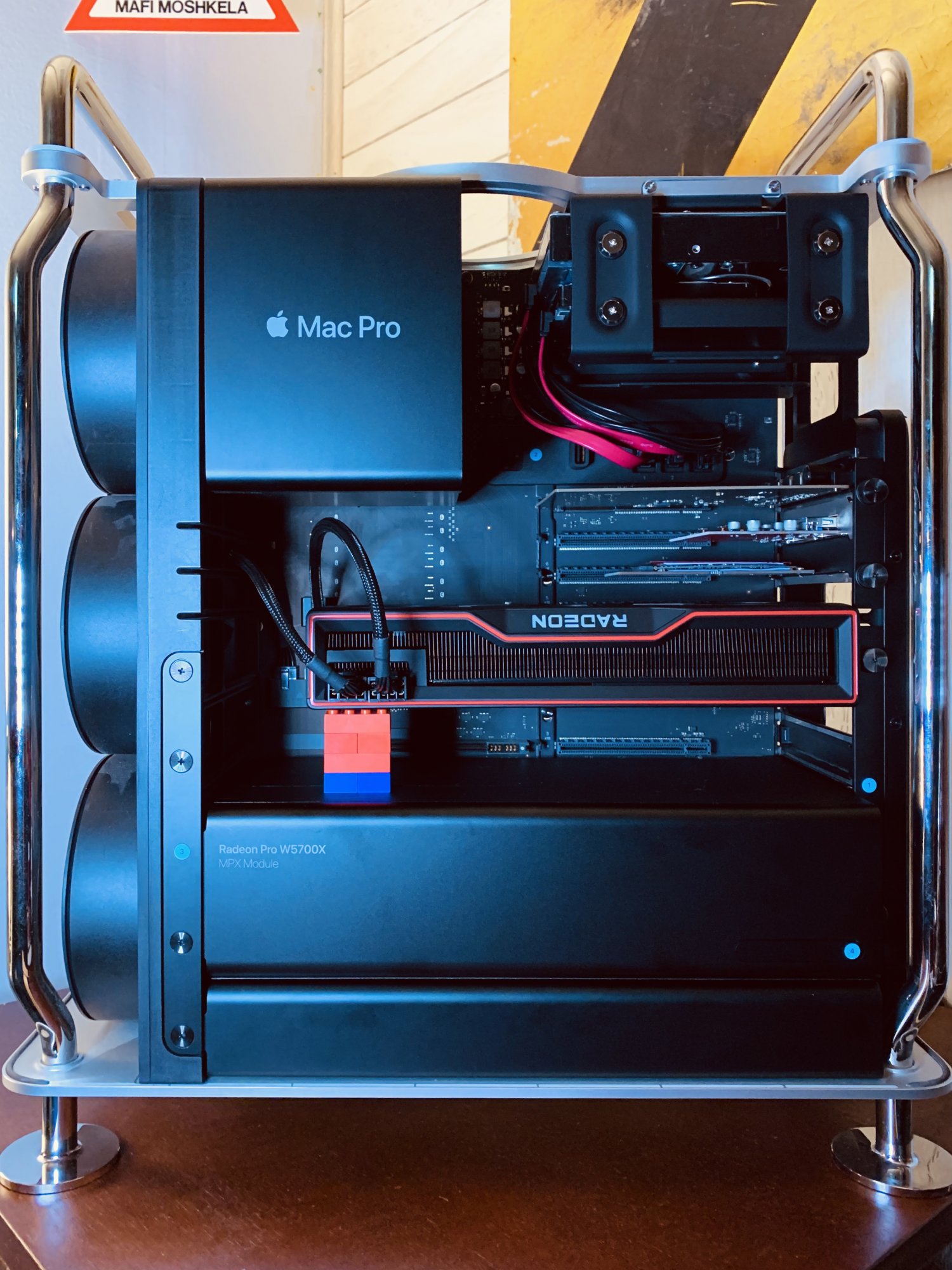

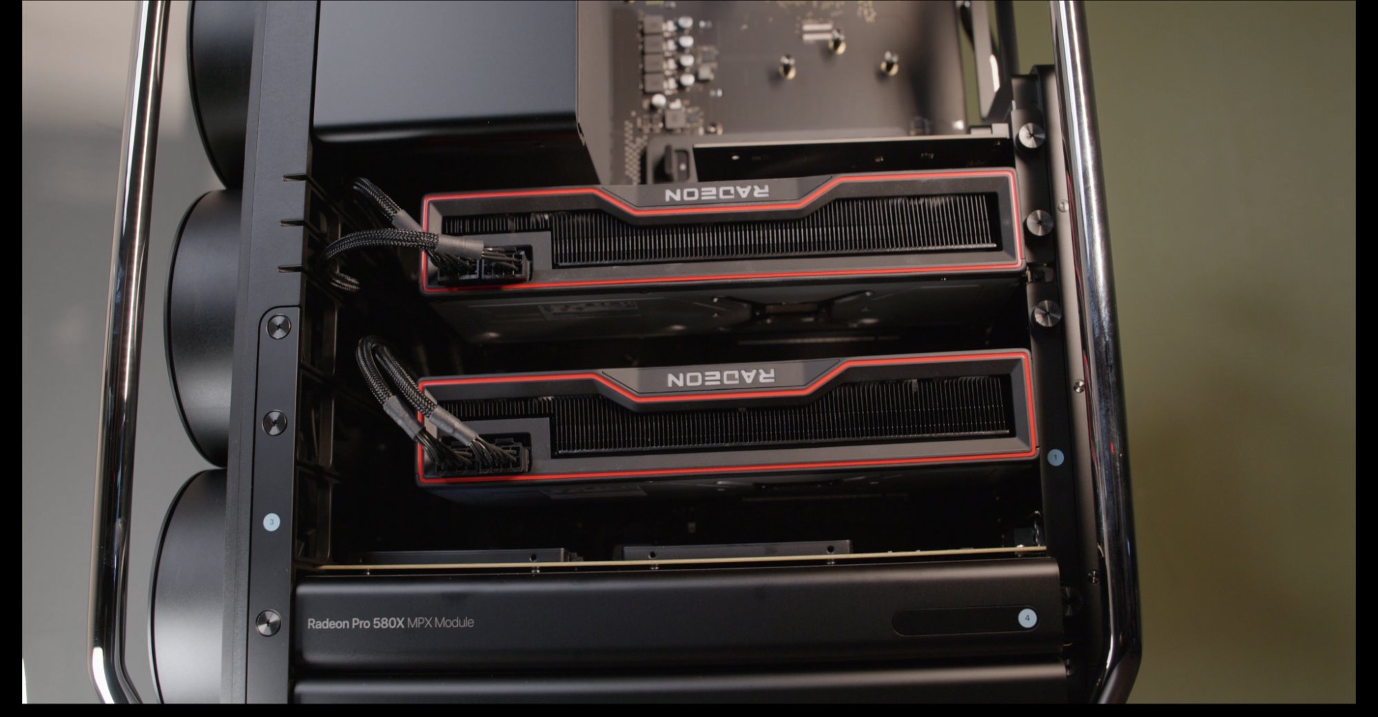

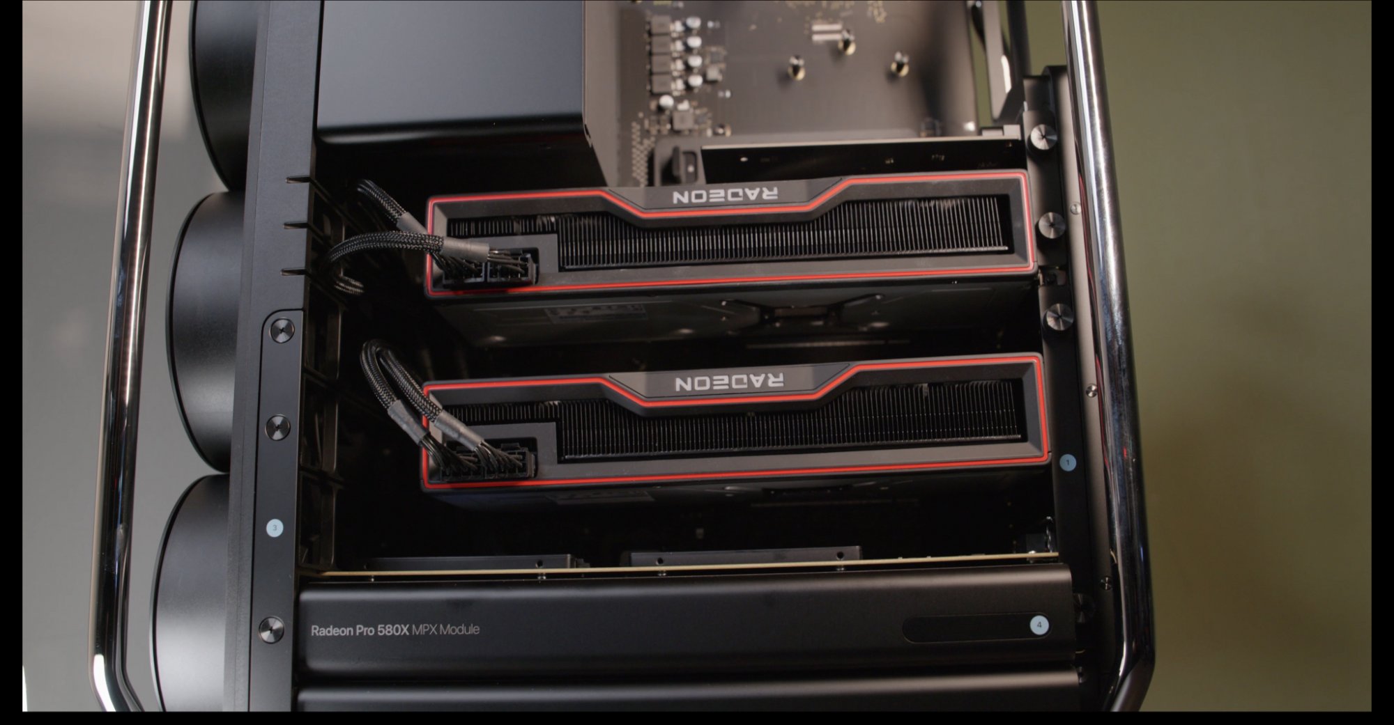

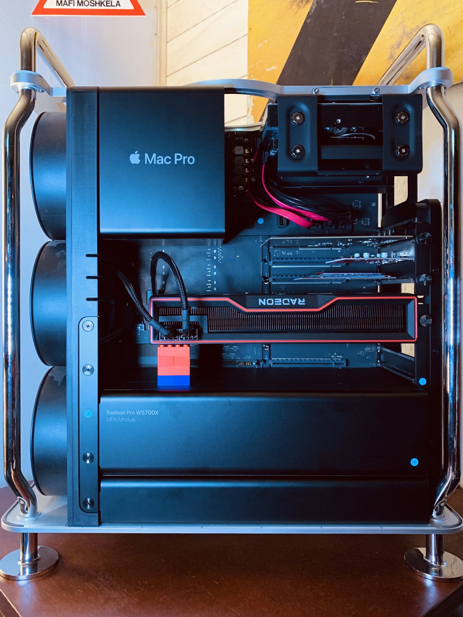

How are the thermals holding up for you fine folk? Especially those that have the reference cards.
Thermals have been good so far with two of them
