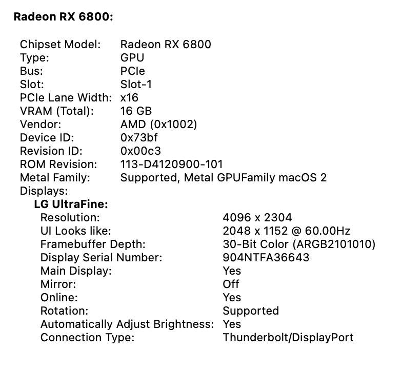

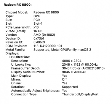

I understand that LG 5k 27MD5KL monitor will not work at full 5k @ 60Hz with the bidirectional USB-C to DisplayPort cable while being connected to the display port of the 6800XT / 6900XT GPU. May I confirm whether it will work with for example HiDPI 2560 x 1440 or higher? Appreciate if someone with a LG 5K monitor could try that (retina setting under display), thanks.
goMac
macrumors 604
Apr 15, 2004
7,663
1,694
The display will default to a 4k mode, with a UI scale of 5k HiDPI. Basically a 5k HiDPI resolution that's being downsampled to 4k resolution/output.
kennyman
macrumors 6502
May 4, 2011
279
38
US
Thanks, I will not get 5k dot per dot but it will be 4K upscale to 5K (I understand).
LG 5K 27MD5KL requires two tiles of 2560 x 2880 to do full 5K. Since USB-C to DP bidirectional cable does not have enough bandwidth, I should not be able to get 2560 x 2880 HiDPI (Pixel Doubling) with the USB-C bidirectional cable to DP directional.
Max resolution should be 1920 x 1080 HiDPI with the 6800XT / 6900XT with the USB-C bidirectional cable to DP directional unless I`m mistaken.
flowrider
macrumors 604
Nov 23, 2012
7,321
3,003
^^^^My resolution with a 4K LG24" with an RX6800 running with a USB-C Cable is:
This is the same resolution I was getting with a BiDirectional cable with my RX5700XT.
Lou
