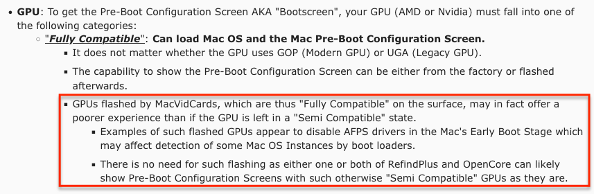

OpenCore and MVC cards works just fine. Also please note such unlocked cards without full EFI will either not always boot or will be boot with some crazy PCIe values like PCI 2.0 x2 despite macOS always showing x16.
Good to know. Let me bring to your attention if you are not aware what problem I had with my RX-580 MVC flashed card. I have 2 identical cards, one with MVC vbios and the other one with the original OEM vbios. Booting Opencore or Refindplus (they share the same boot code) with the MVC card would hide all APFS partitions in the OC or RP boot screen. Only the HFS+ partitions and Windows were displayed. I masked the issue by loading APFS.efi with RefindPlus. @Dayo is aware because we did the testing with that card together. The OEM vbios on the other hand worked fine with OC or RP.
I remember that as a puzzling one. It wasn't actually to do with RP or OC specifically but that the GPU OptionROM was apparently uninstalling APFS for some reason.
The GPU OptionROM is run by the firmware as part of the hardware initialisation process BEFORE any boot loader starts. So basically, the firmware loaded APFS drivers on MP51 as usual, ran the MVC Card OptionROM which seemed to remove the APFS drivers so that when the firmware later ran a boot loader such as RP or OC or AnyOther, APFS volumes were absent as there was no driver present to allow dealing with such.
The GPU worked with APFS when RP and OC (would have been the same for any other) did not interrupt the process which suggests it was reinstalling the APFS drivers at some point.
It is conceivable that the GPU EFI was set up to uninstall APFS drivers (Not sure why this might be needed) do some initialisation steps and then later, most likely just before showing the Apple Picker, reinstall APFS drivers. If the MVC Apple Picker display step is not run however, such as when using tools such as RP or OC or AnyOther, then APFS drivers would be missing in those tools and they would therefore not display APFS volumes, being unable to interact with such. Just speculation but possible.
Initially, the workaround was to specifically install an APFS driver in RP as stated and this was later superseded once APFS Jumpstart was incorporated into RP. APFS Jumpstart automatically loads APFS drivers from available MacOS installations so there was no need to manually add such any longer.
MyBootMgr documentation still advises against MVC Flashed GPUs following that experience and at least one or two others:
Maybe specific to your GPU run only or a particular version of their OptionROM that was later changed?
Are you using genuine MVC card or some stolen RX580 rom? The stolen ones got issues because it's not made for such specific model of the card. Example just for Pulse RX580 8 GB there are at least 16 different roms.
For Big Sur 11.2.3 and Monterey 12.2.1 usage with flashed cards there is no need to use OpenCore at all unless someones needs Wi-Fi/Bluetooth under Monterey and updates.
Genuine made by Dave.
I run UEFI Windows both 8.1 and 10 together with High Sierra/Mojave/Catalina/Big Sur and Monterey and never had any issues inside NVRAM.
I've checked the problematic rom and it wasn't made by us (we've never had such card) so must be somewhere from the US guys ;)

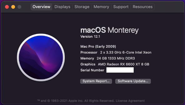

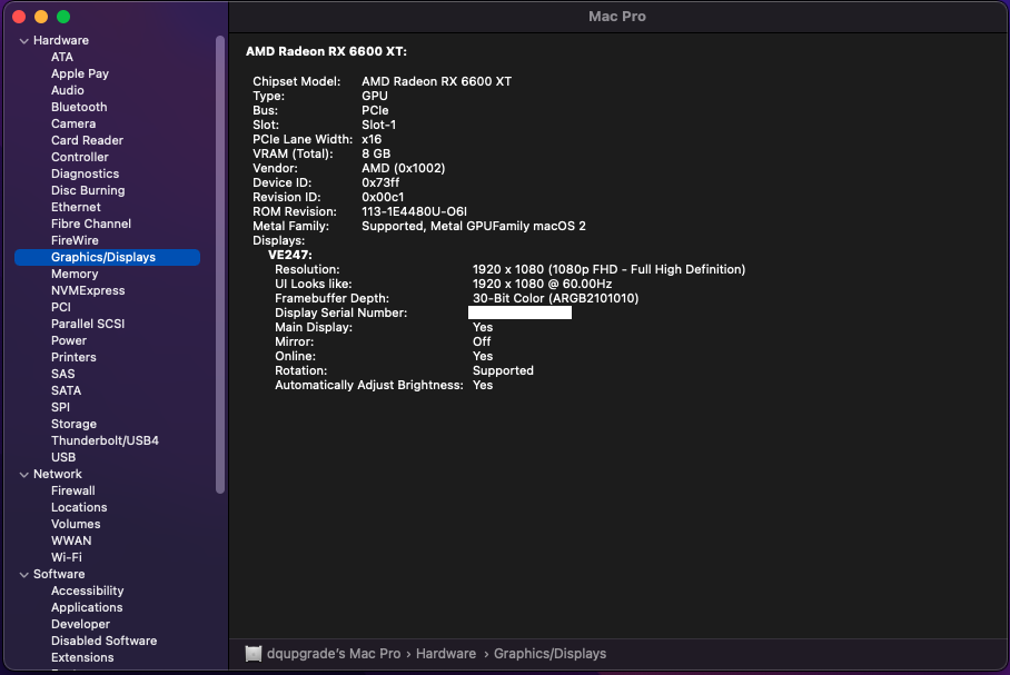

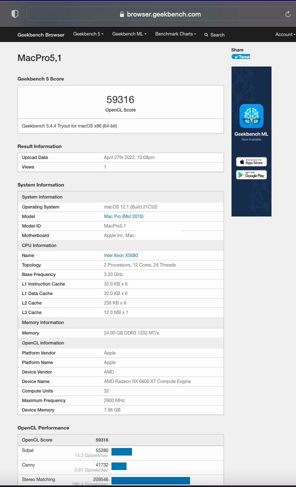

Just tried on Sapphire Nitro+ 6600XT. It works great with Montery 12.1.
