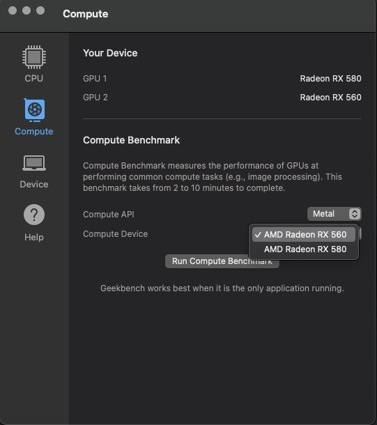

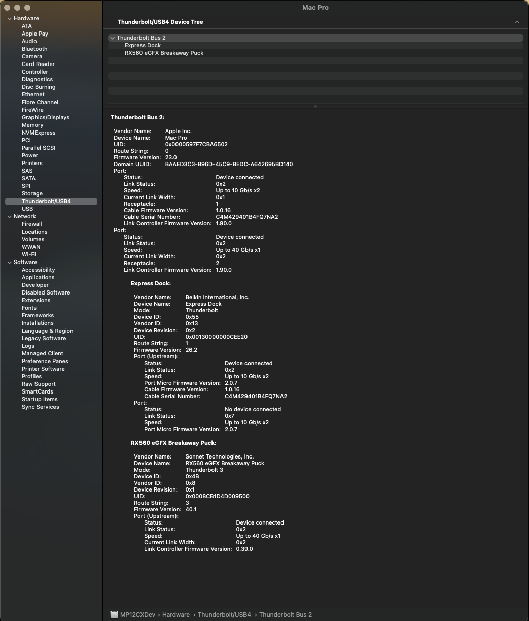

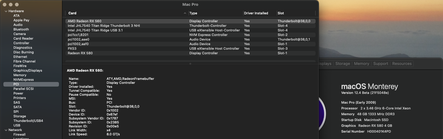

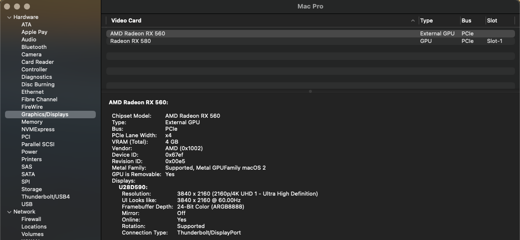

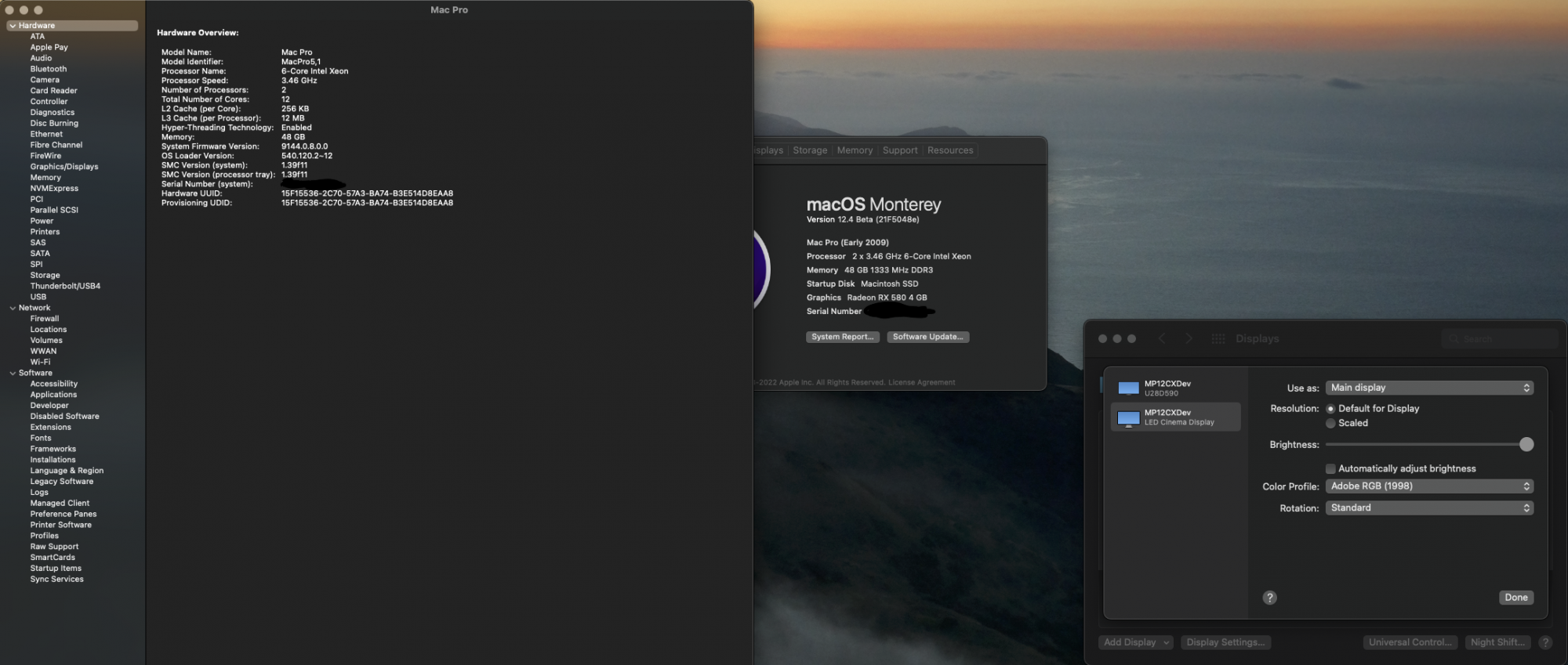

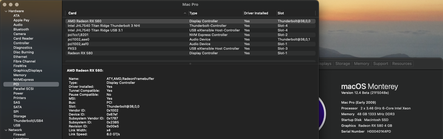

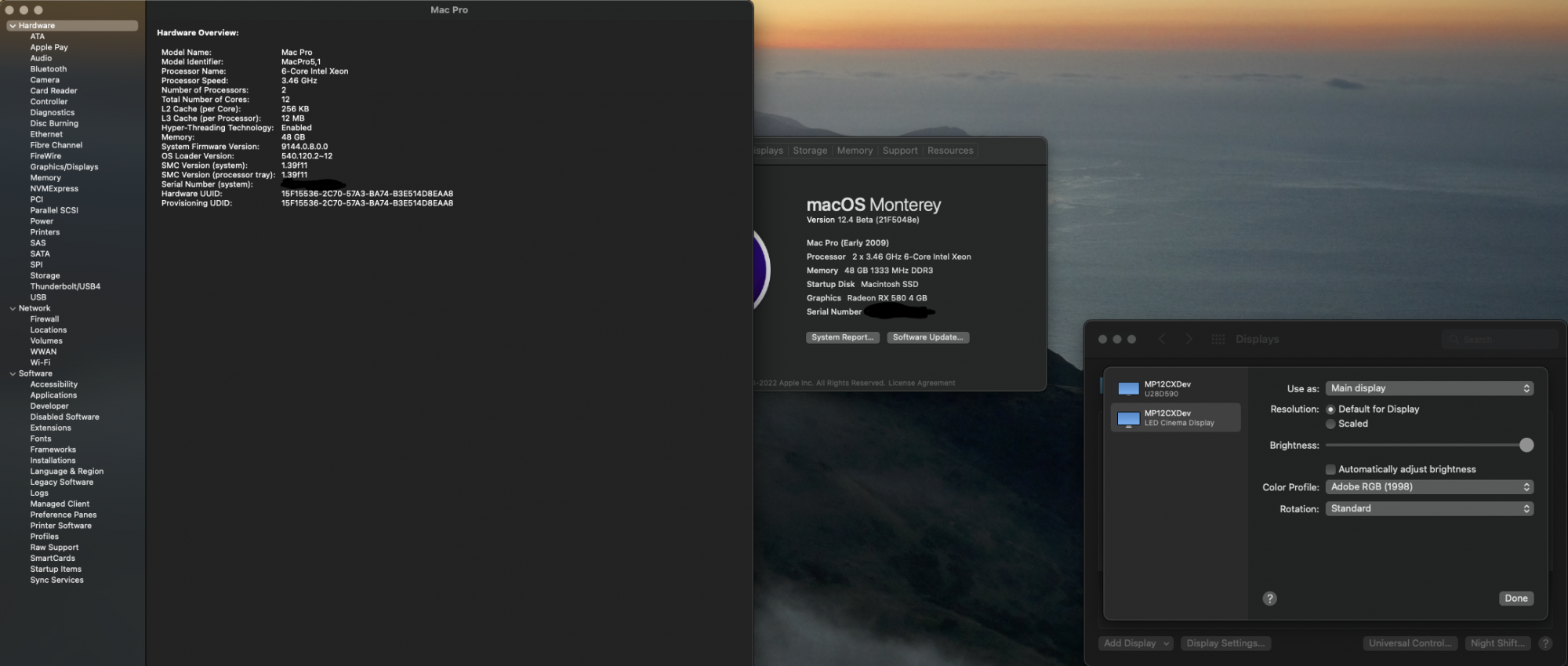

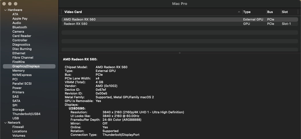

see here for cMP working with eGPU in thunderbolt
Reactions: prefuse07

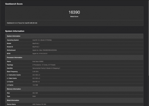

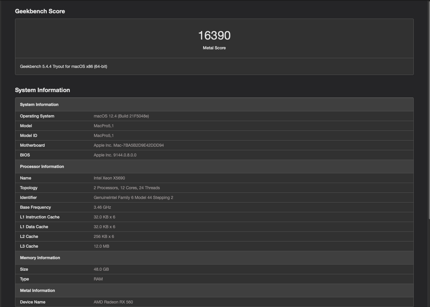

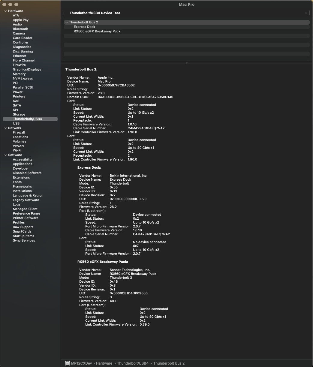

In Geekbench with the Sonnet RX 560 Tb3 eGPU
