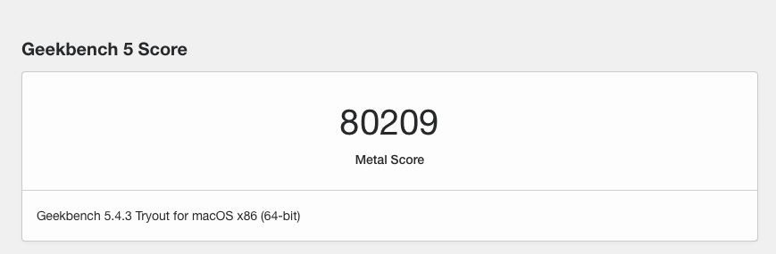

Not sure if GB is affected, but here is RX6900XT test result in BS:

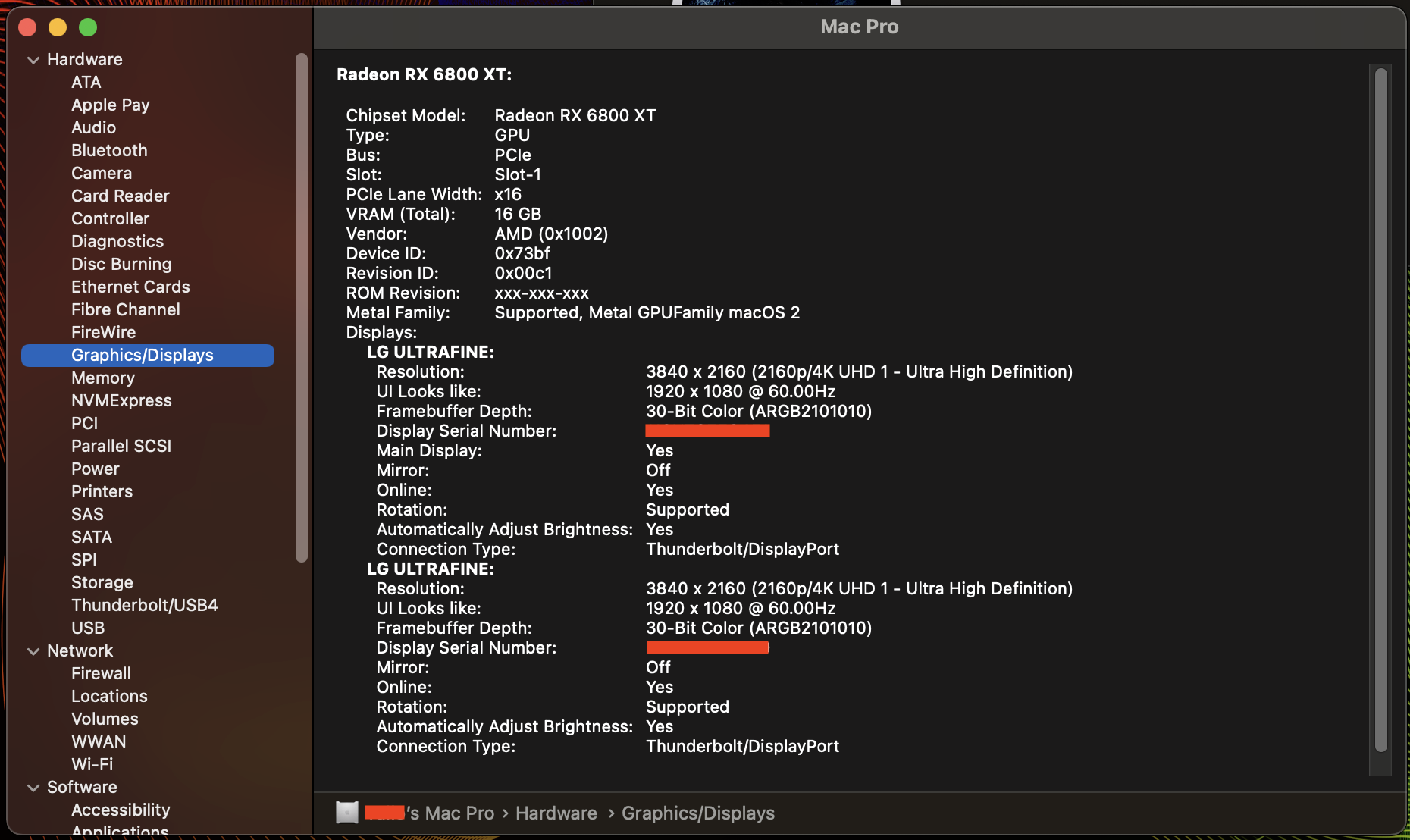

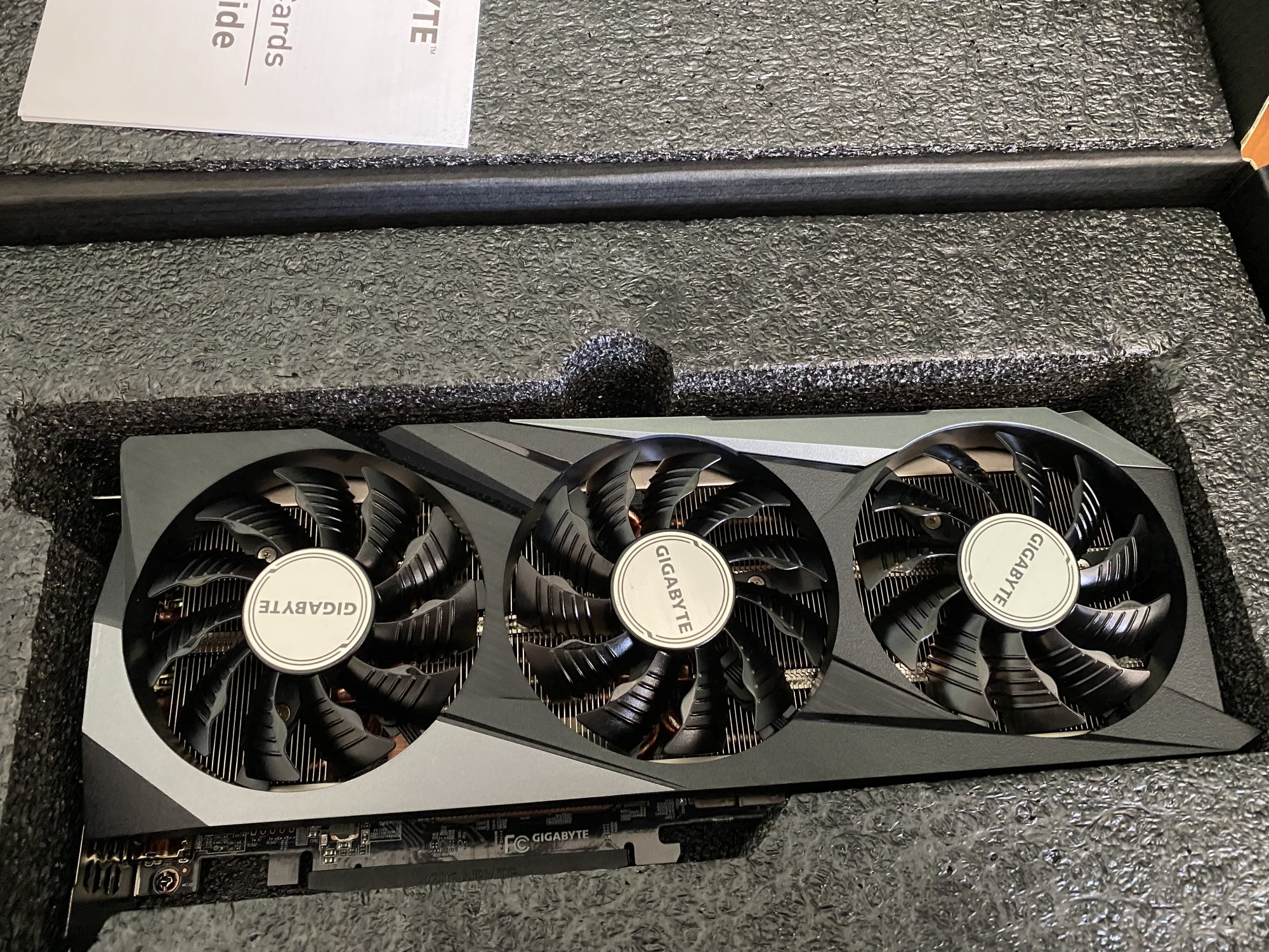

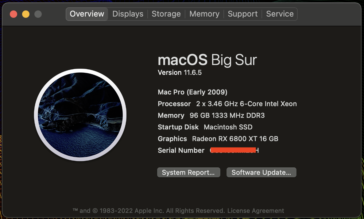

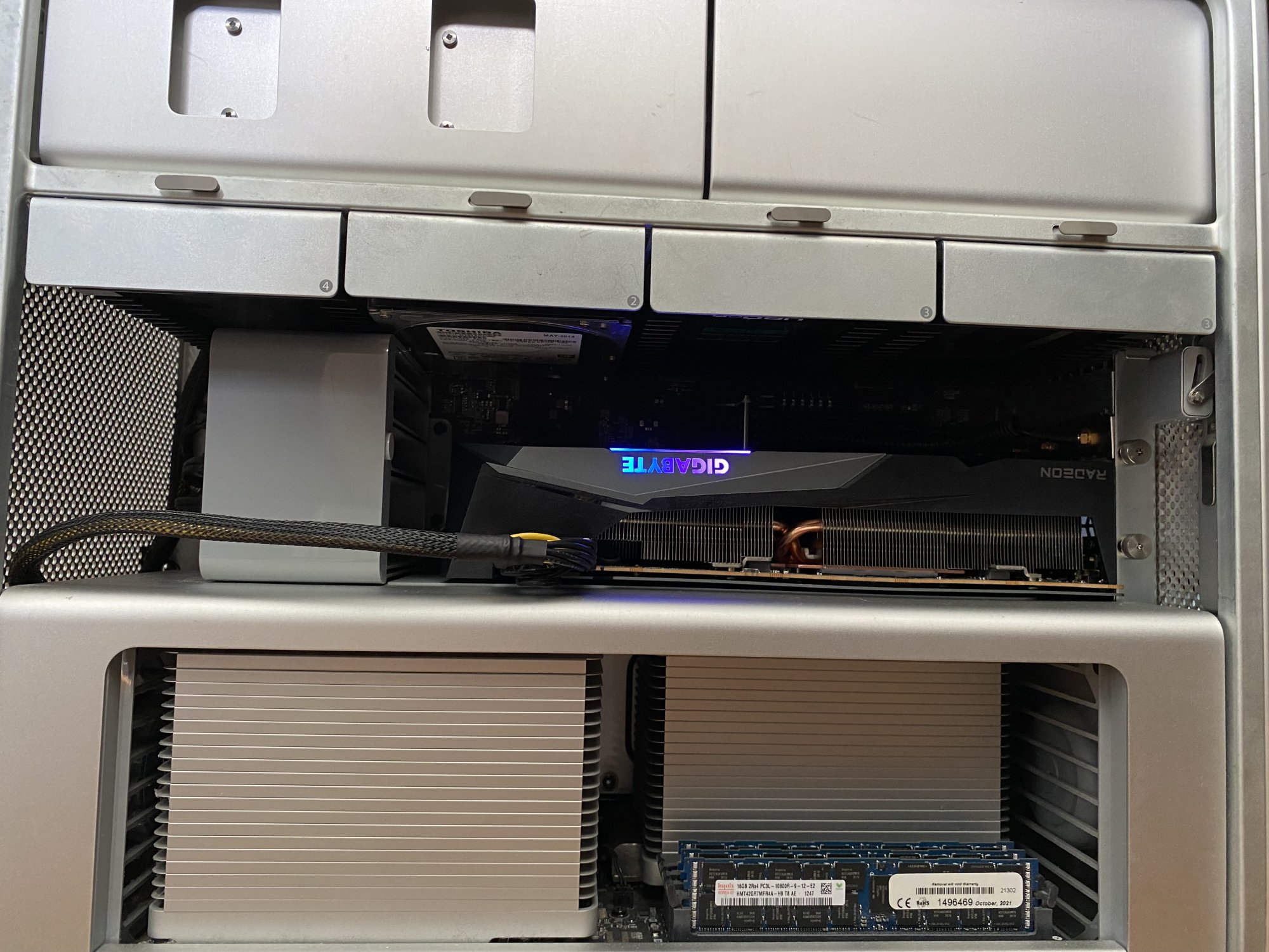

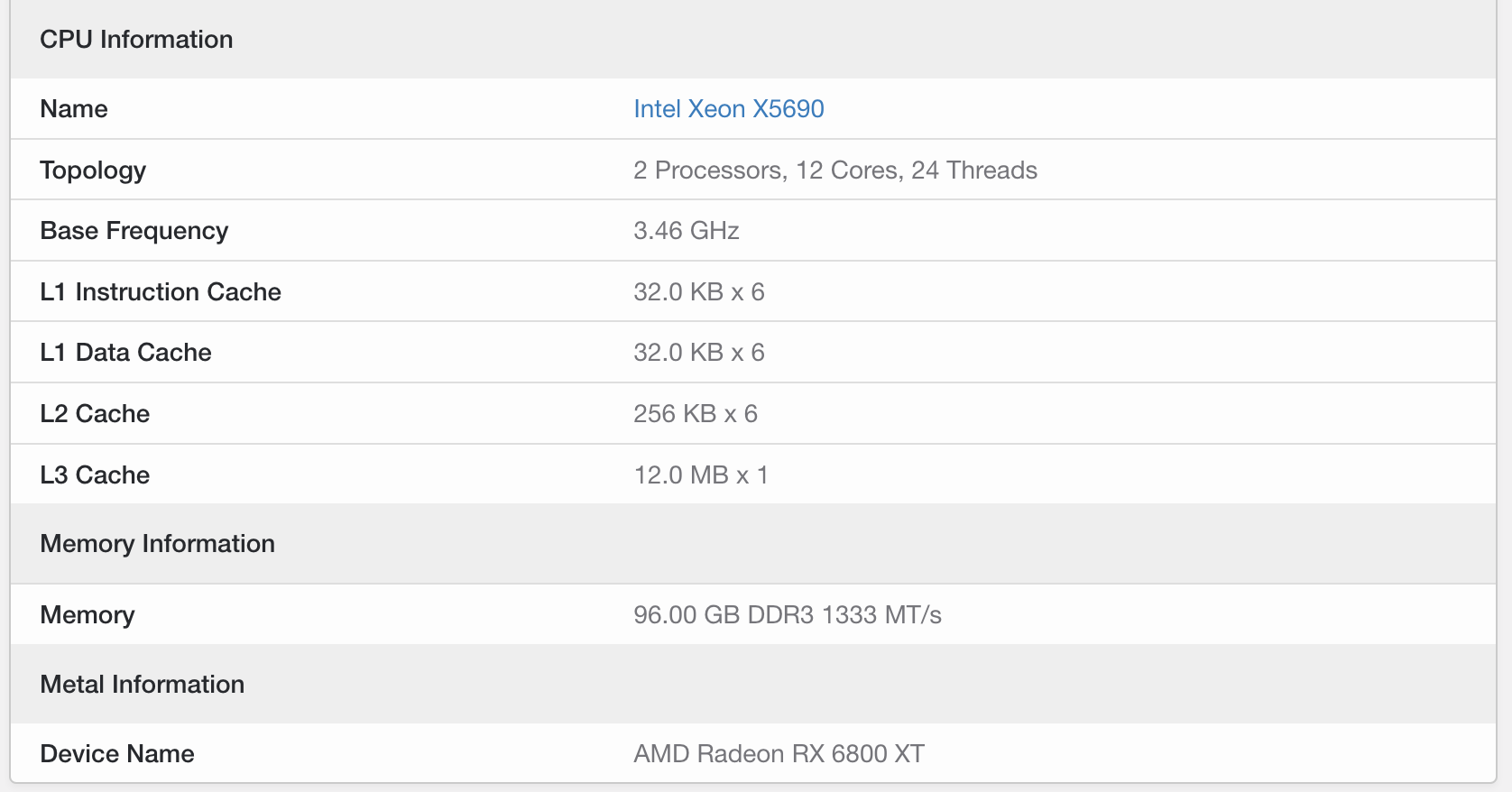

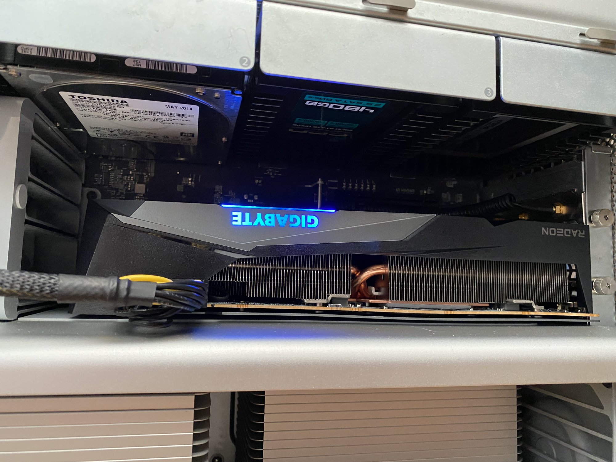

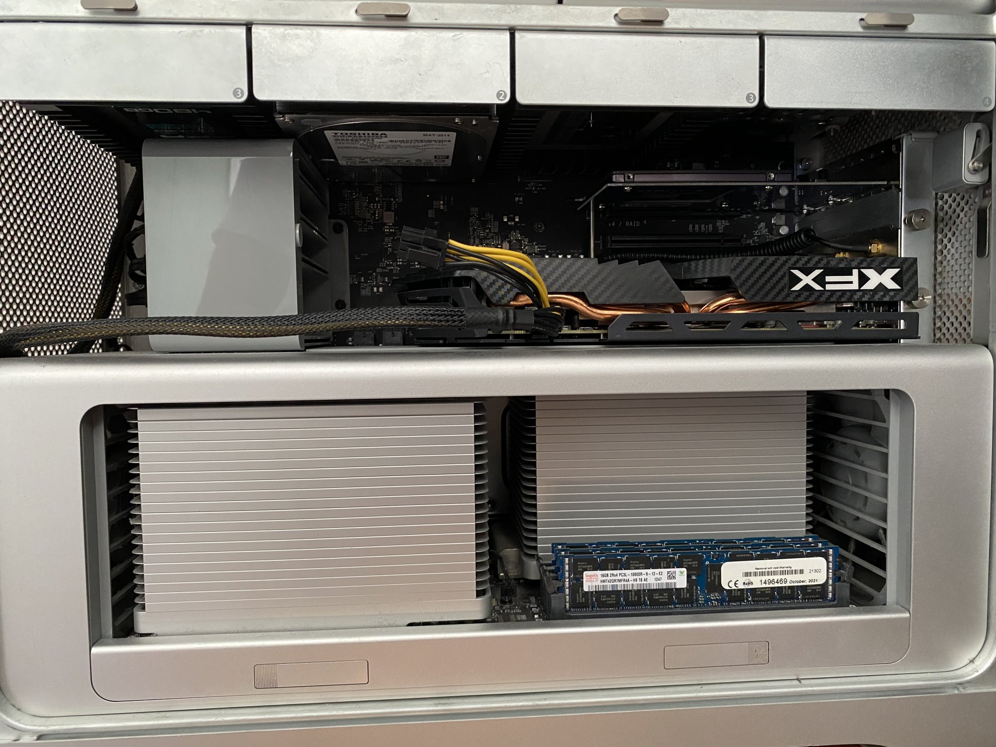

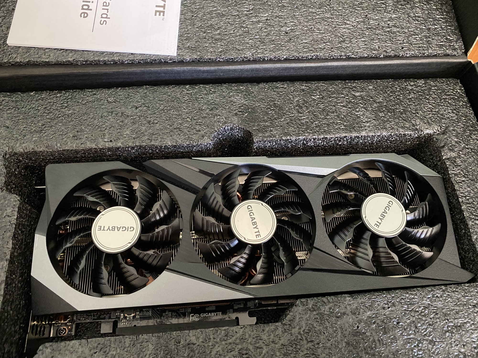

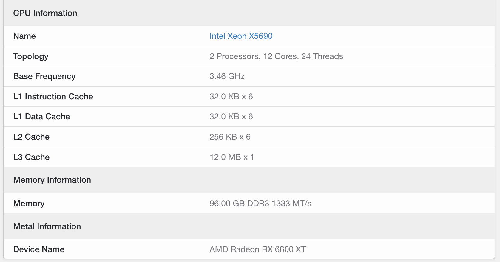

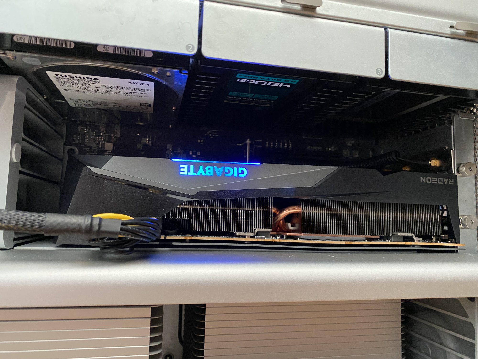

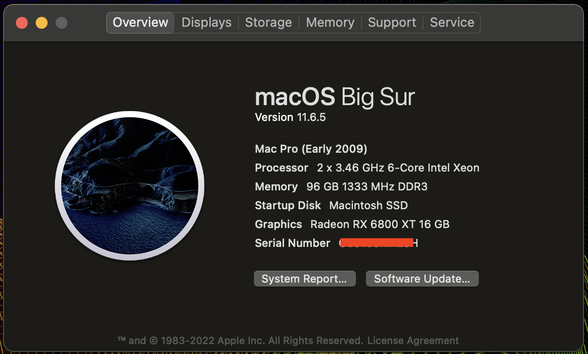

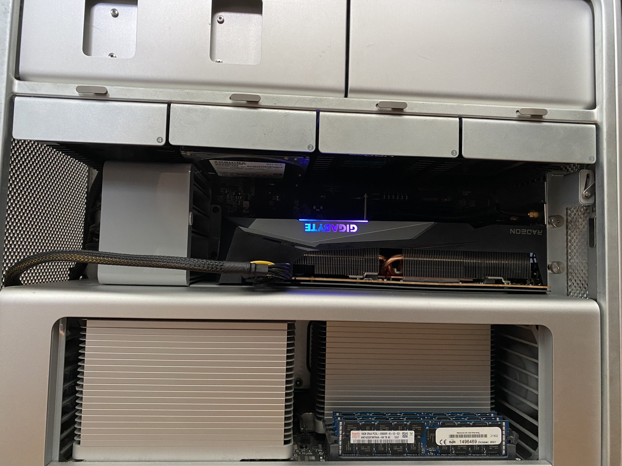

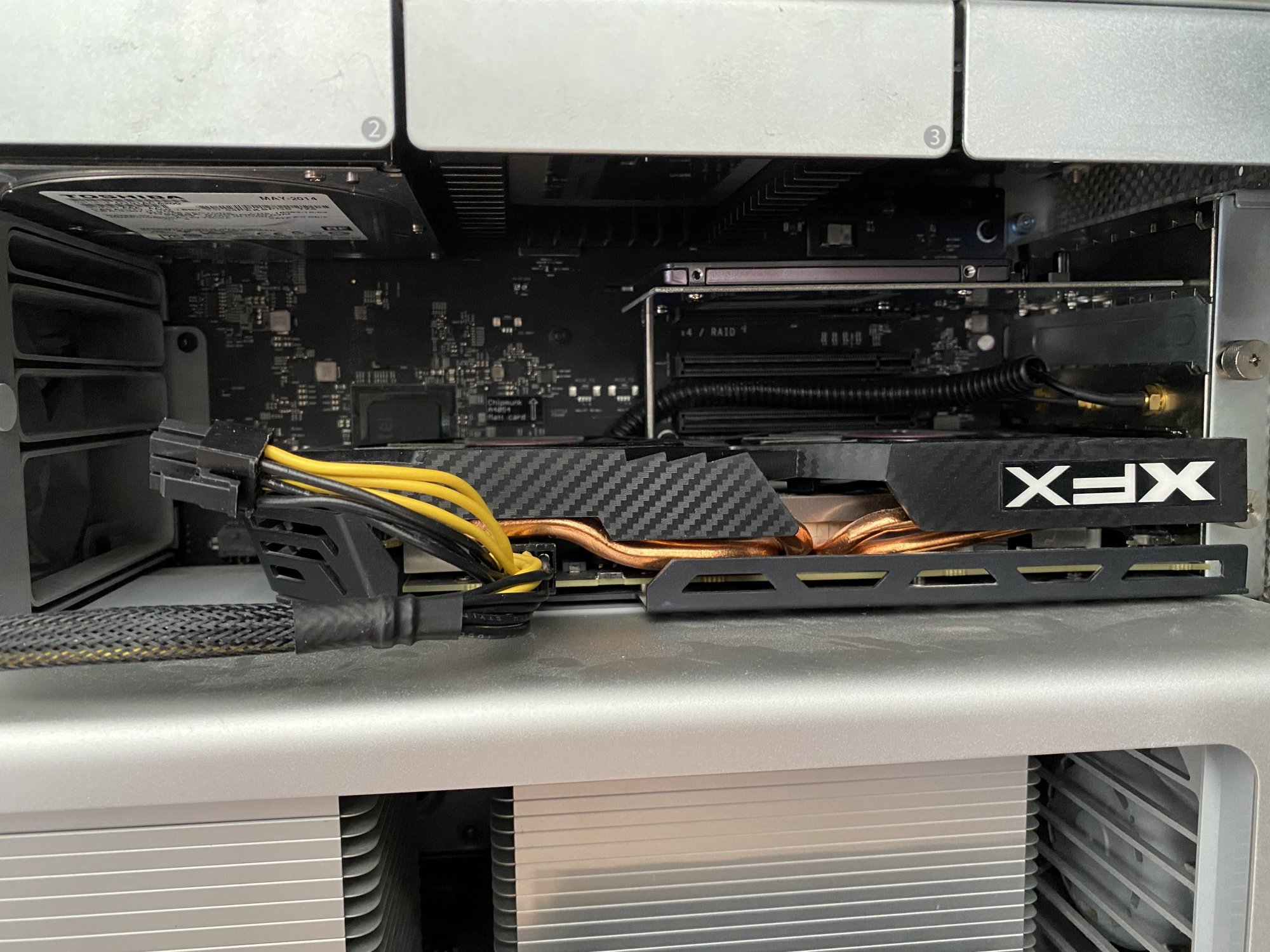

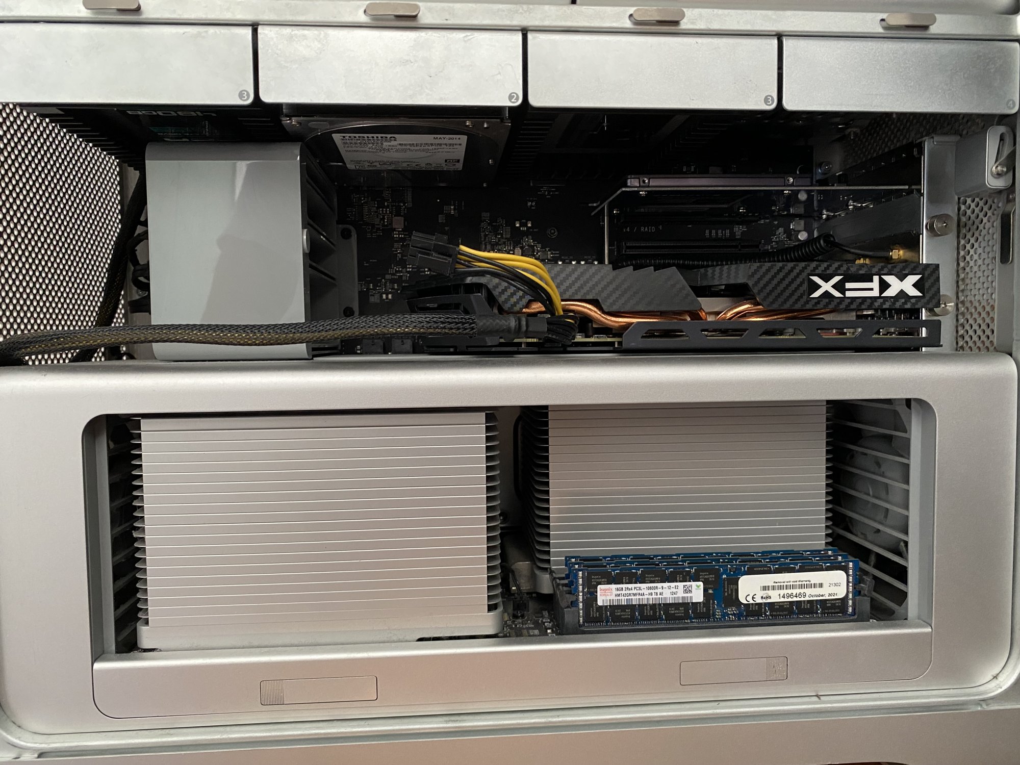

I am more than happy to report that Syncretic's patch does work 100% to use an RX-6800XT on a cMP 4,1>5,1 running OpenCore 0.8.0, Big Sur 11.6.5, the rest of my specs are in my sig. (@Greggant, if you wanna mention this confirmation on the DMUG youtube, gimme a shoutout! :p)
As soon as Syncretic made this post, I returned my RX-5700XT and acquired an RX-6800XT.

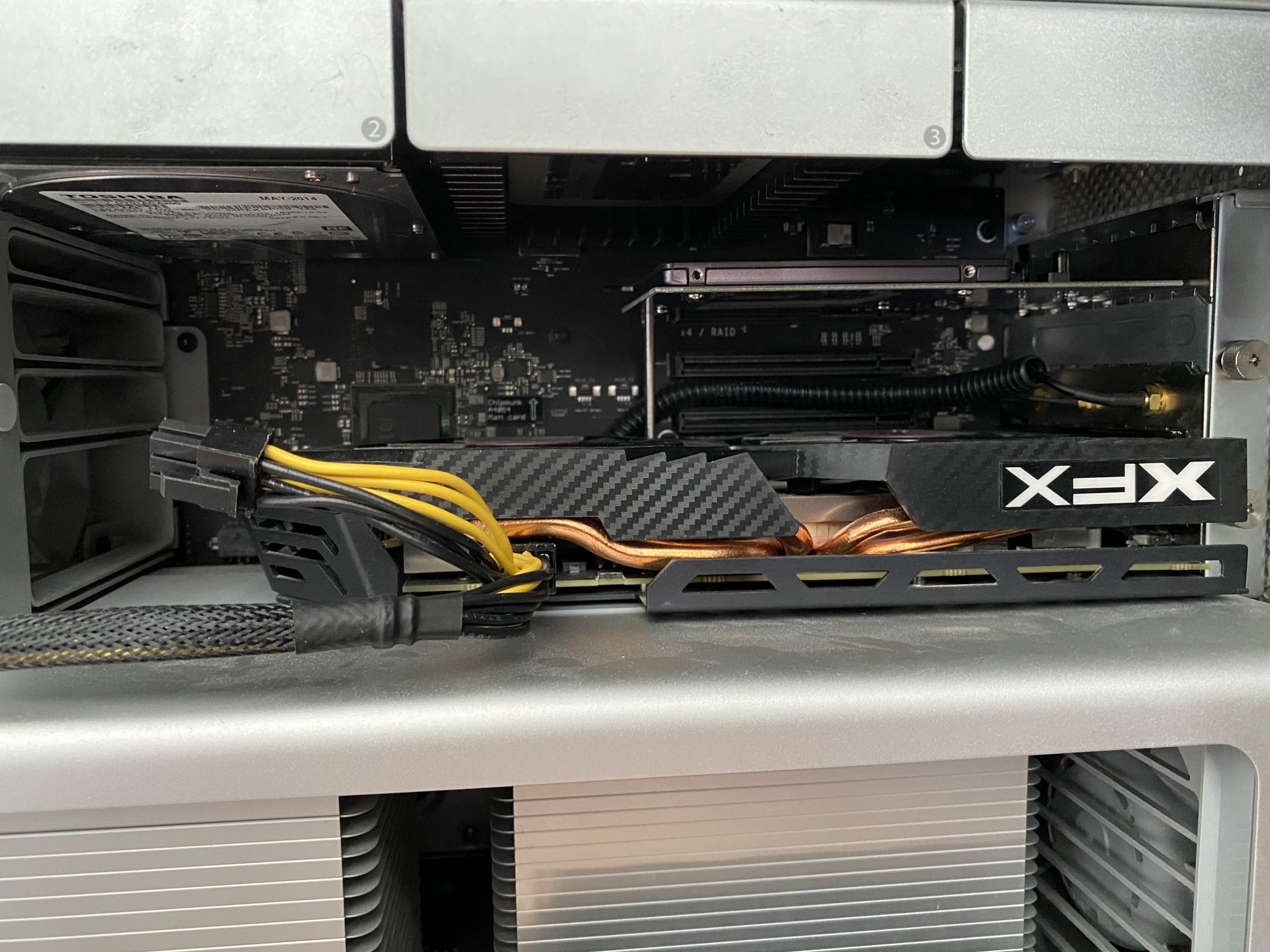

I was using my XFX RX-580 while waiting for the 6800XT to arrive, and all of the parts to get this working, so you will see it in the before and after pics below. Since I had previously already done the Pixlas mod for my 5700XT, it was a simple plug and play.

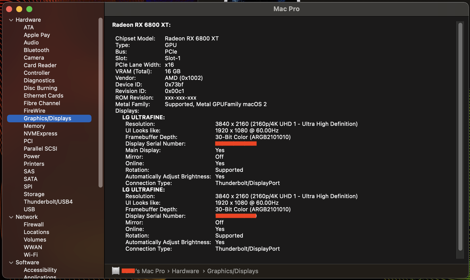

Here you go folks, as promised, the excitement!:

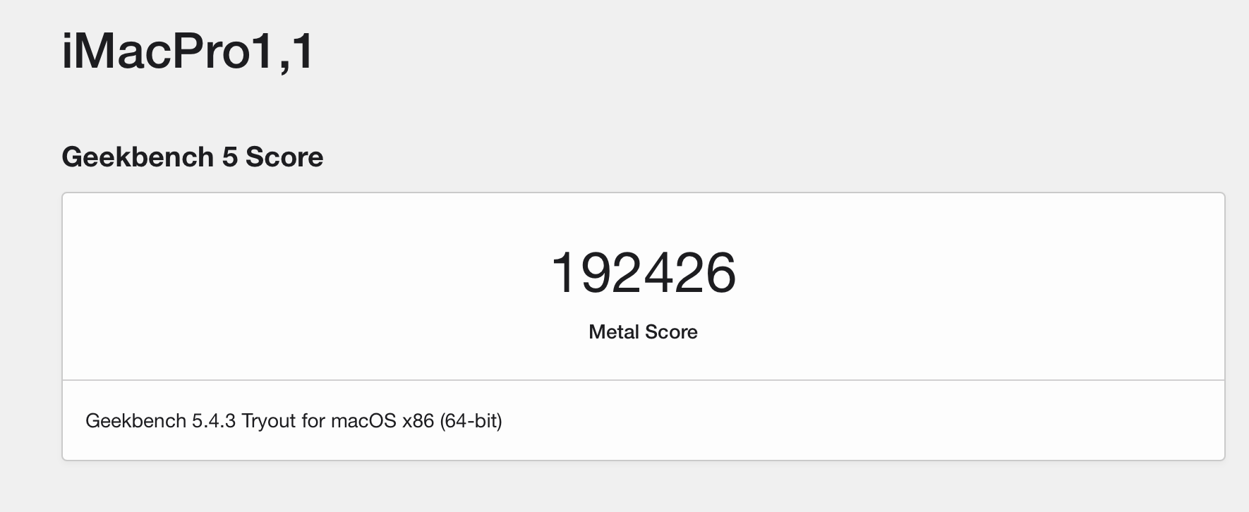

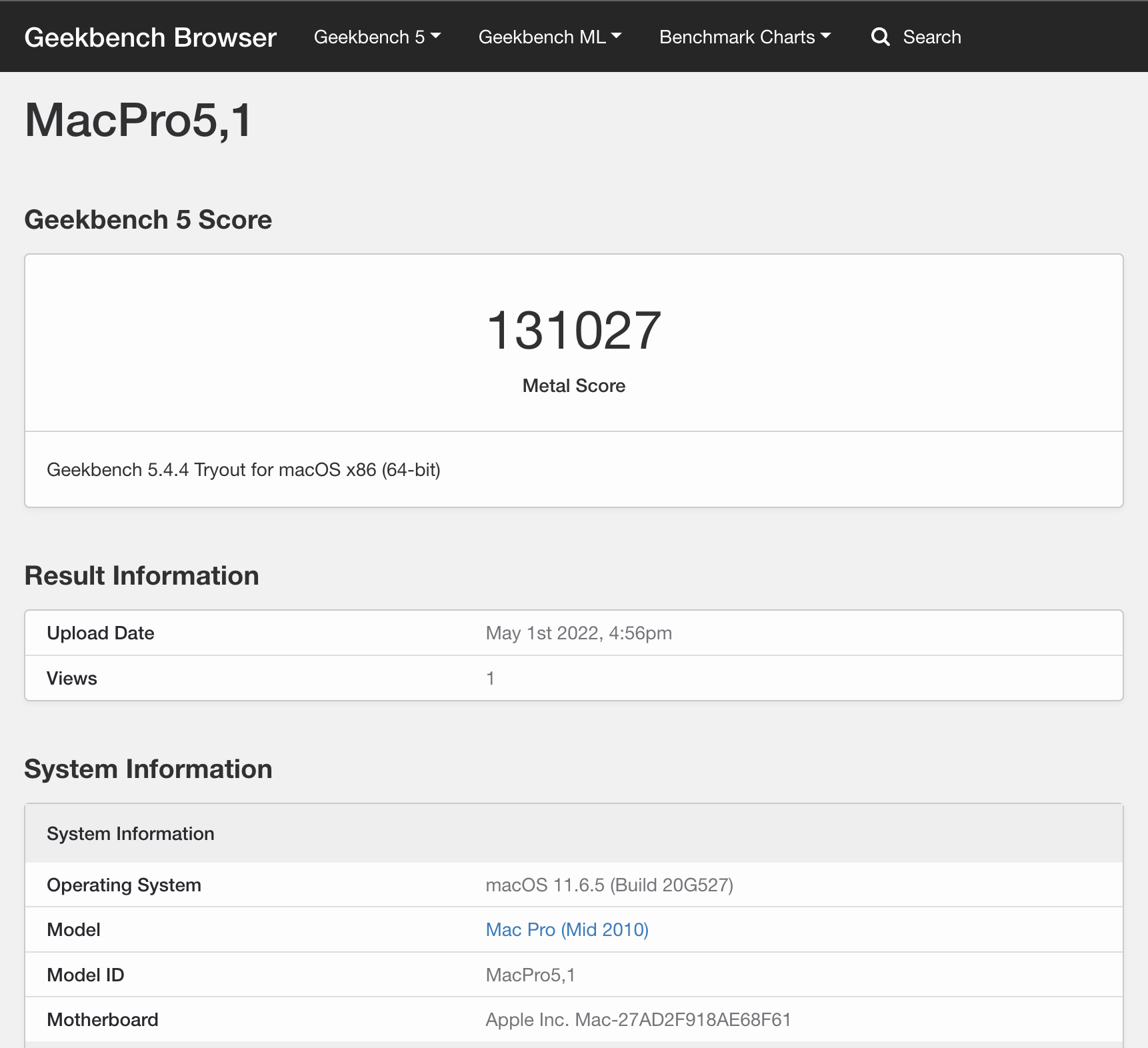

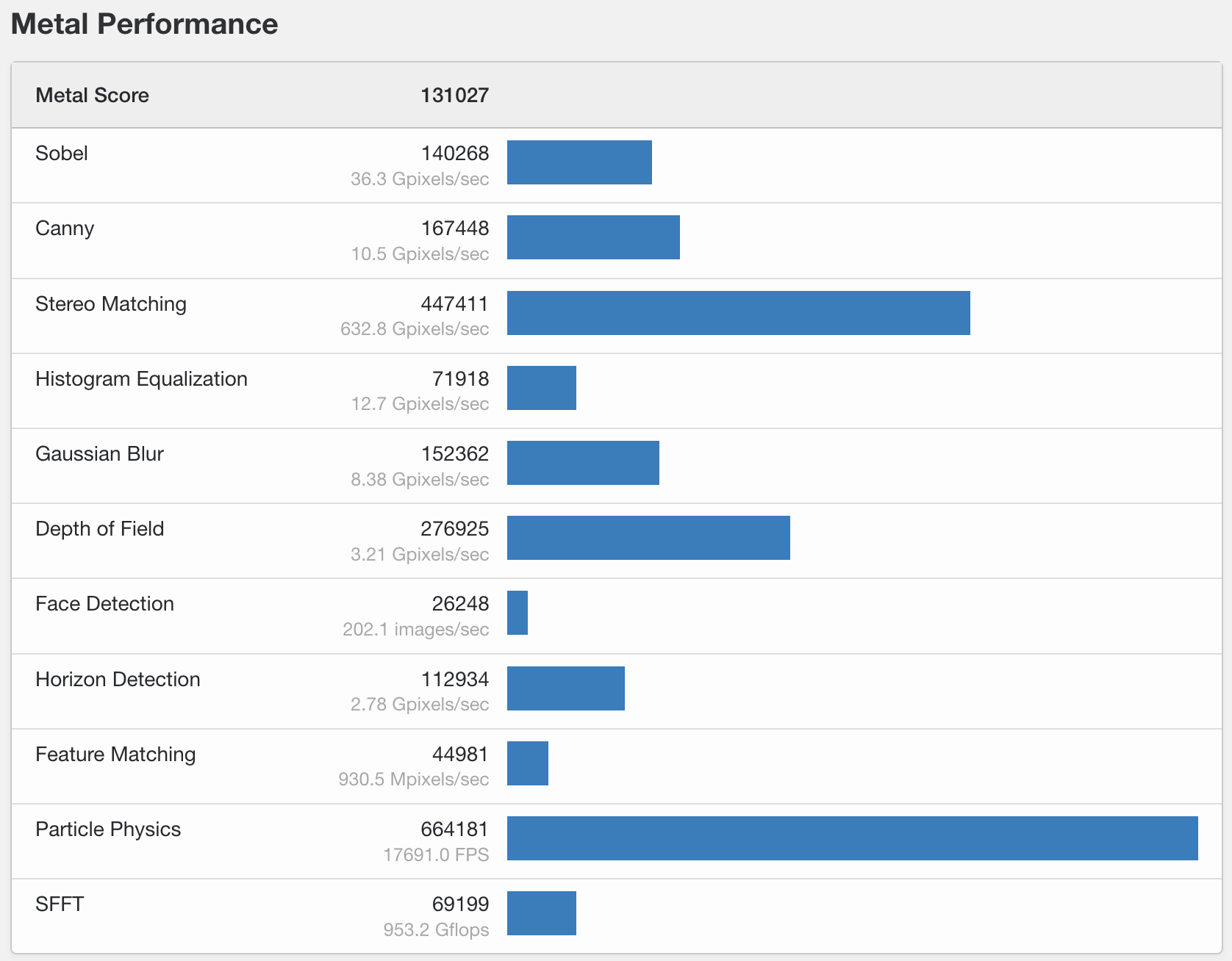

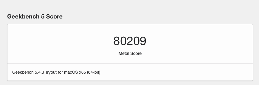

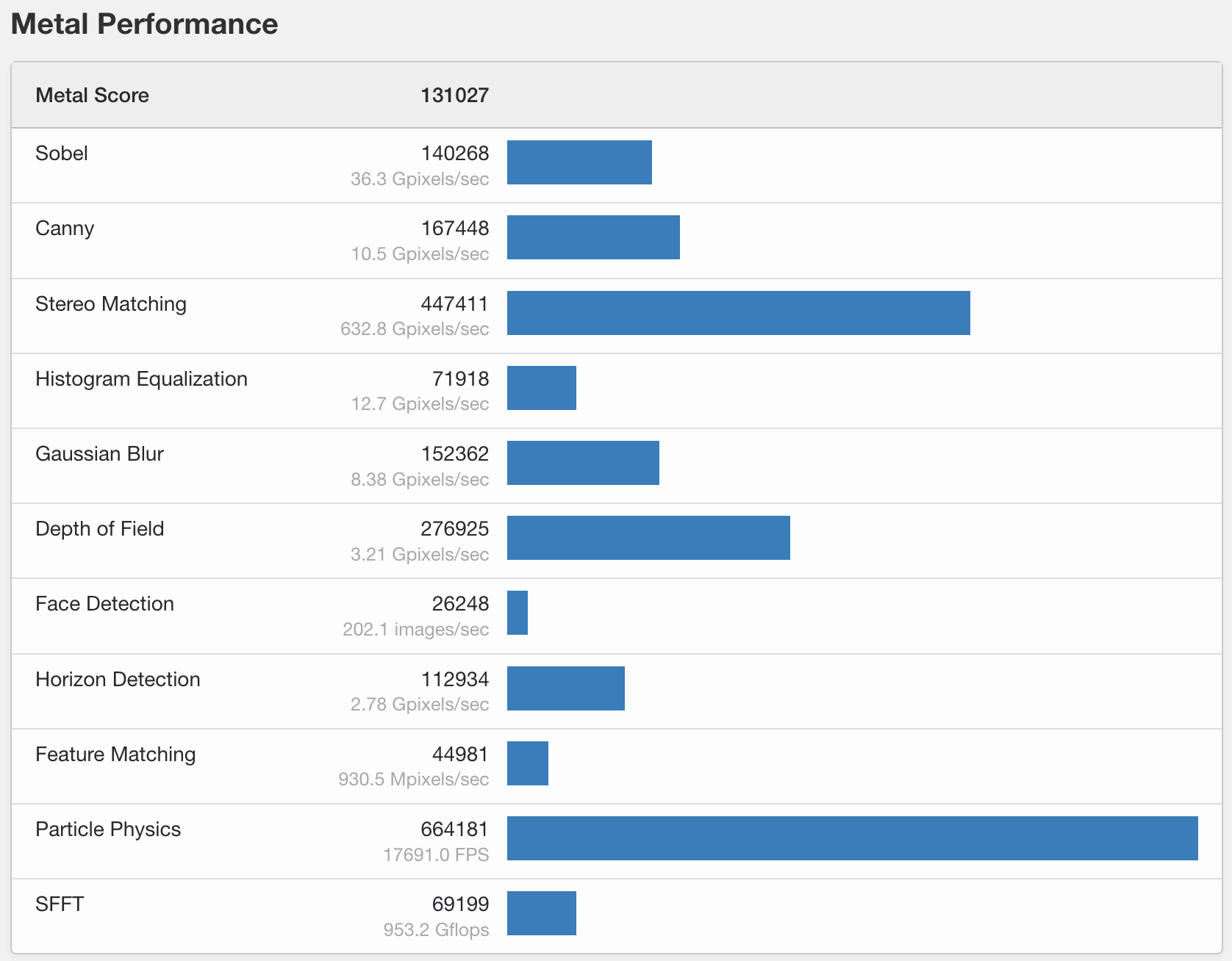

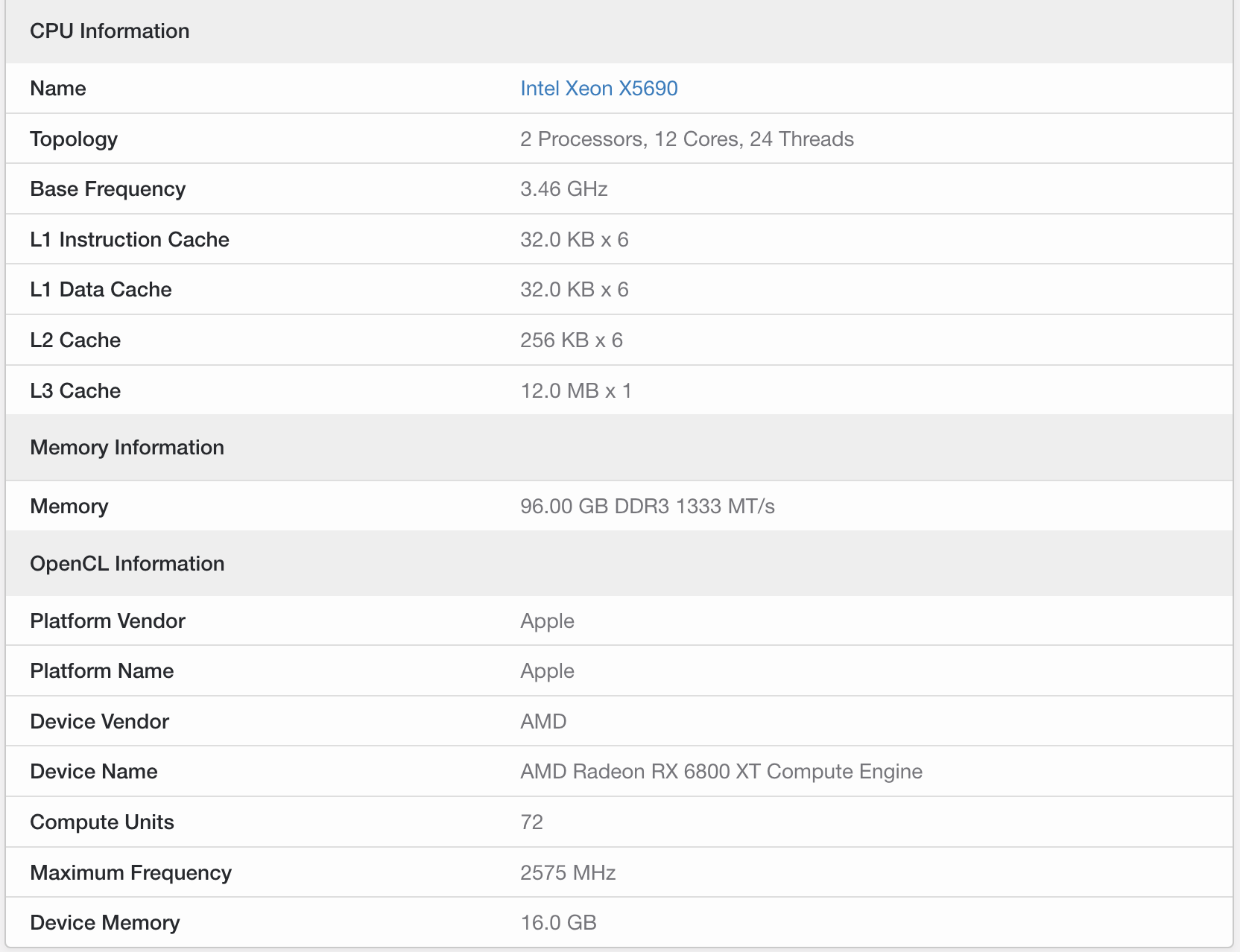

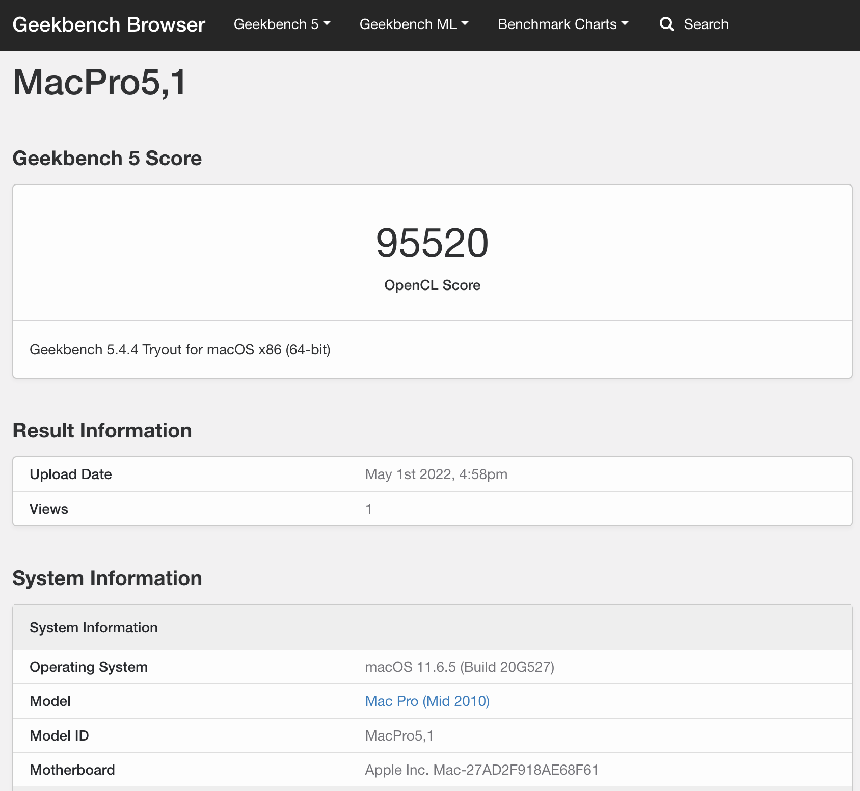

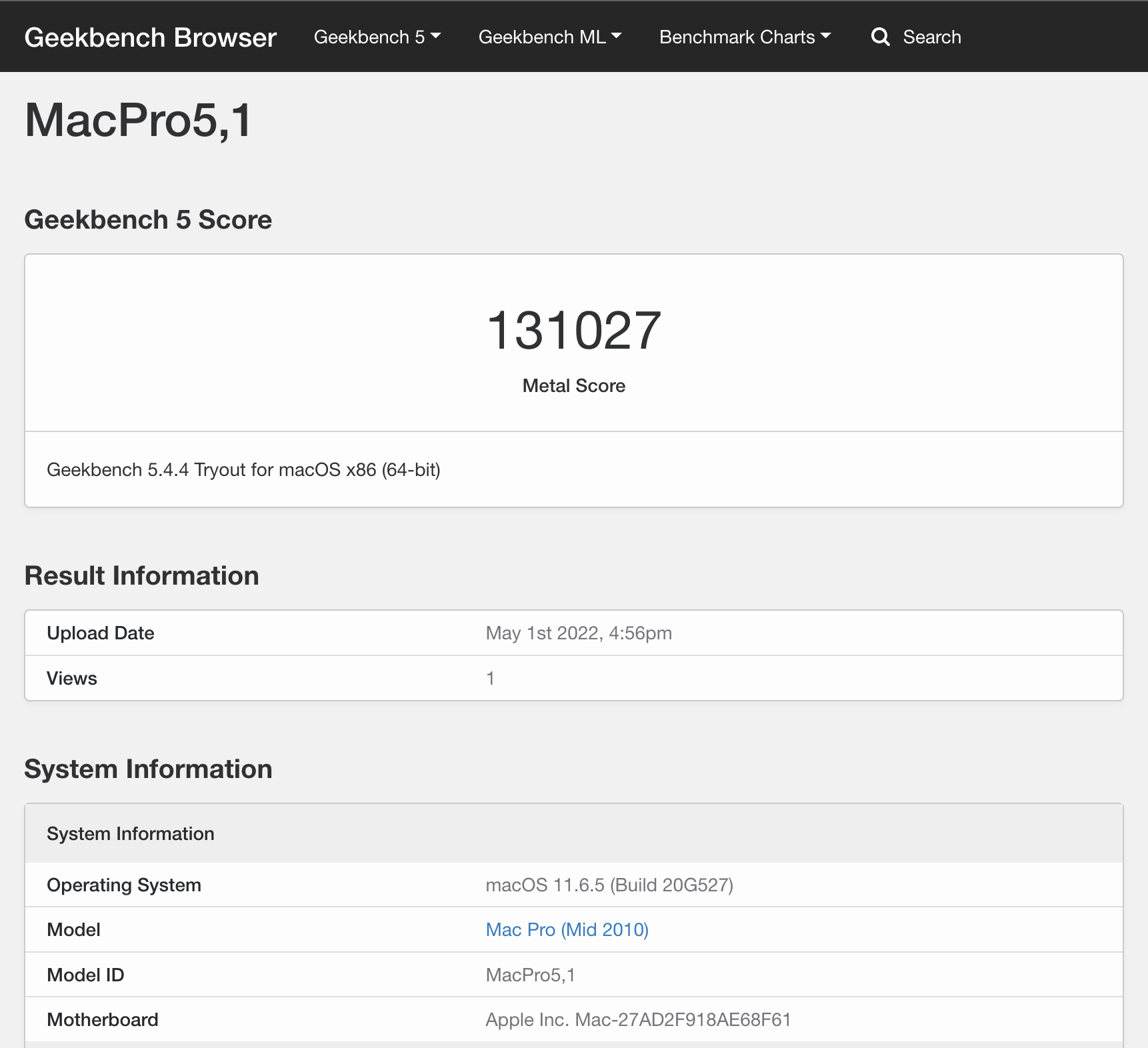

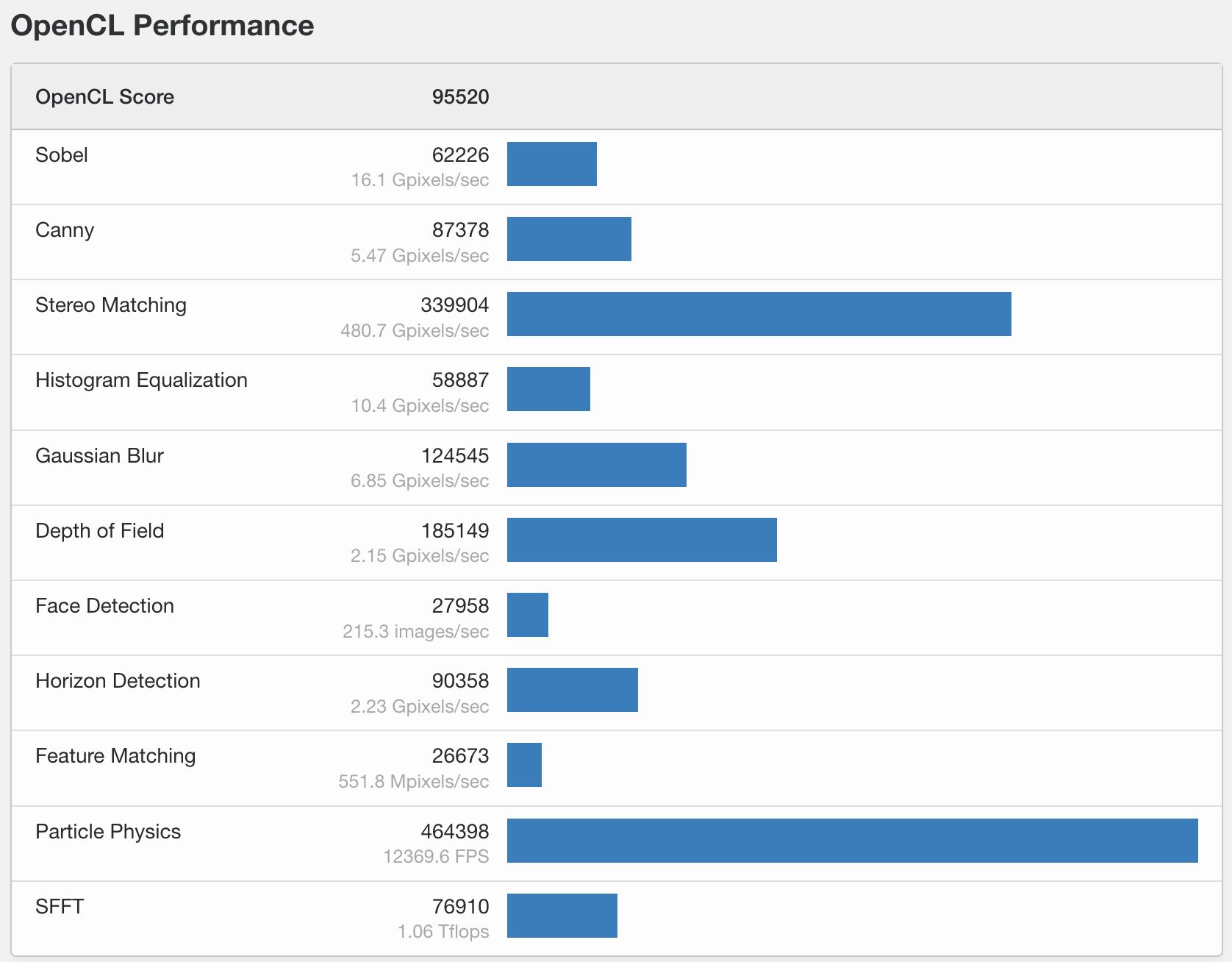

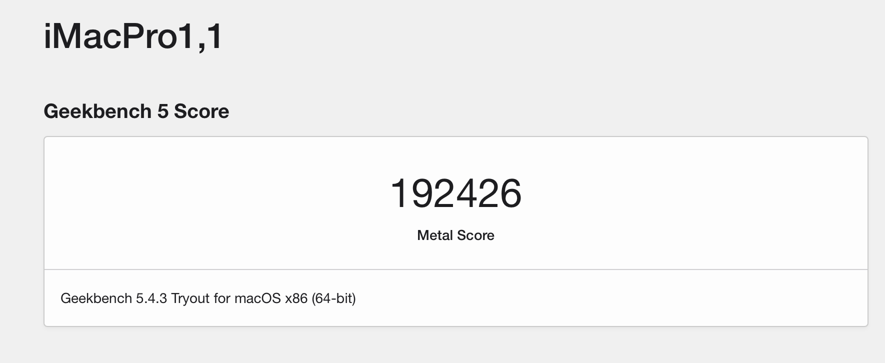

Here are some benchmarks using GB5:

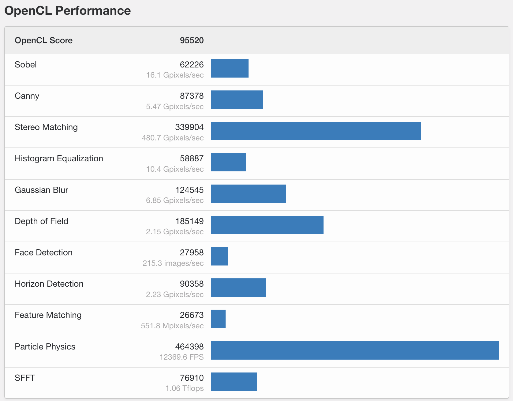

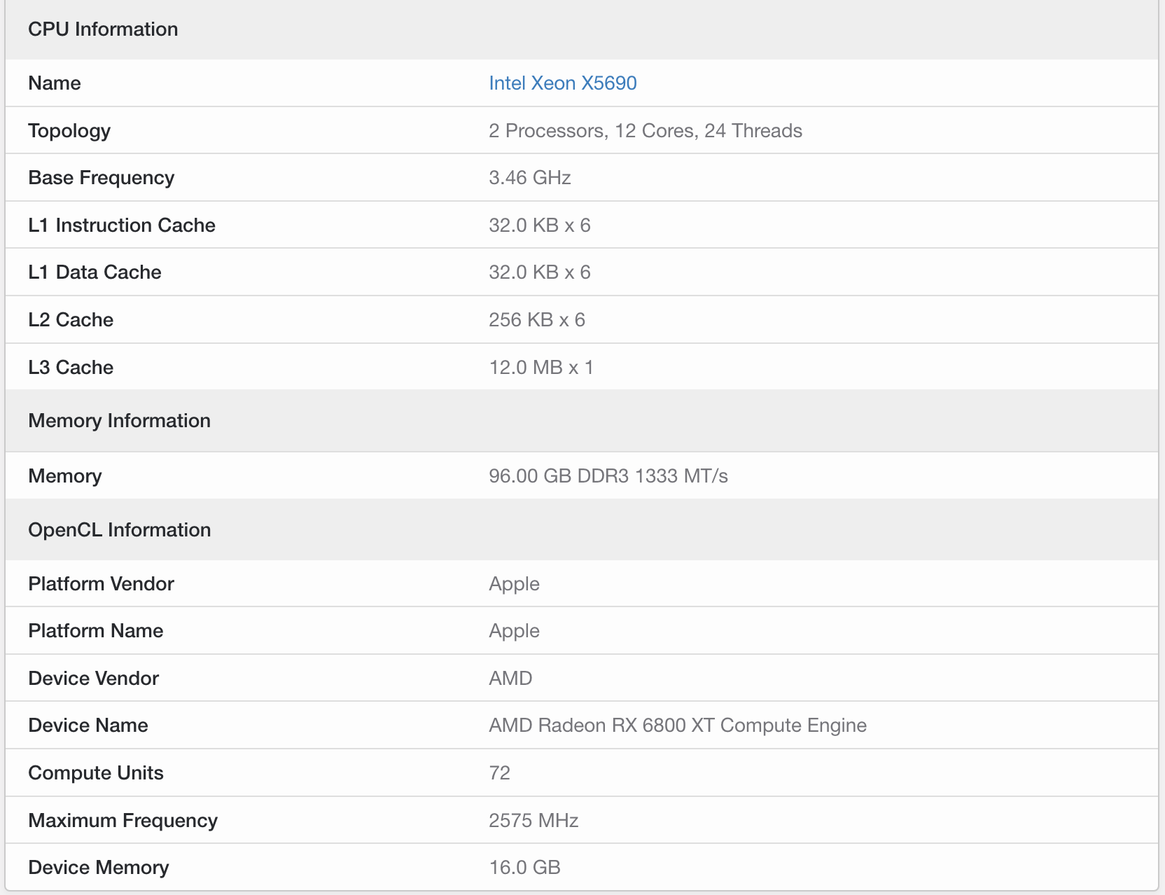

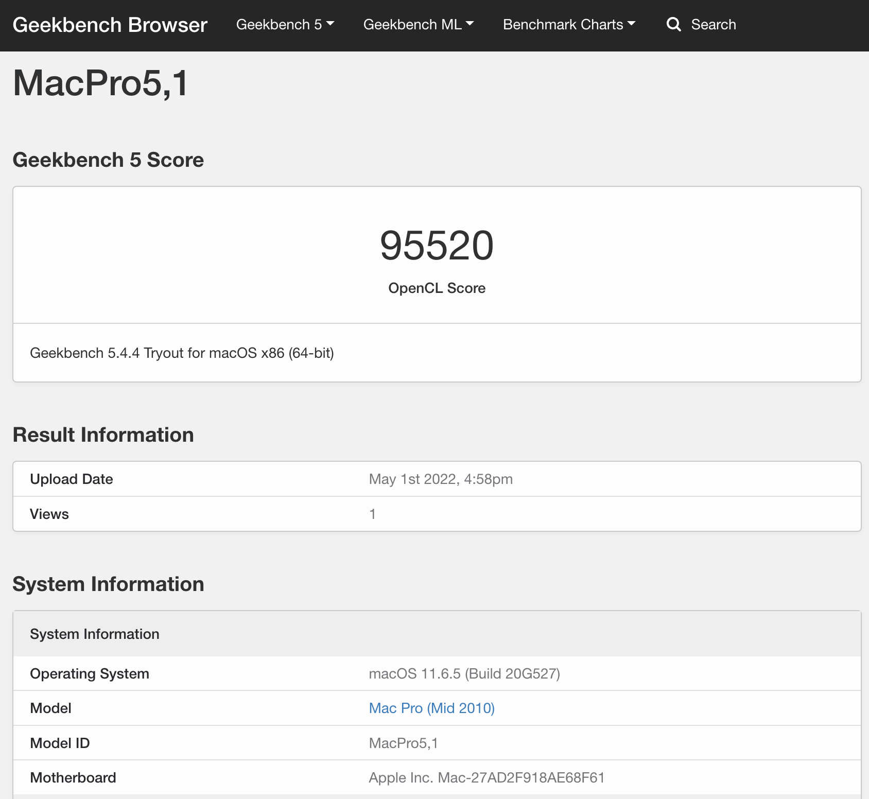

And now OpenCL:
I'm going to jump into Windows shortly and will run benchmarks in there to see if there are any differences.
Also, I'm thinking of seeing if anyone wants to help me start a fund to see if we can build up enough cash to buy Syncretic an RX-6600XT (or some AMD 6k series card), so that he may enjoy the spoils of his labor. If anyone else has benefitted from this patch, and is interested in that, please send me a PM. I really think he should be able to enjoy this, and I want to thank him x1,000,000.
Let me know if there are any other specific benchmarks you'd like to see.

Nice. Maybe the classic luxmark, and maybe what ever other GPU benches there are. Just to see them all coming from a cMP+6800XT combo.
If I didn't have a VII, I would be tempted to go this way too. About the well deserved reward to Syncretic, it's a good idea. It seems Syncretic has got a PayPal account already, see his sig. So I'm donating too, even if I didn't use the patch ever.

Am I reading this correctly. A 12yr old Mac Pro with better graphic scores than a Mac studio? If that doesn’t tell you why we MUST demand slots, nothing will.
really? I hadn't seen Mac Studio benchmarks, but now I am laughing my ass off!
Edit: Here are more benchmarks! (I decided to make a GB5 account)
Windows:
