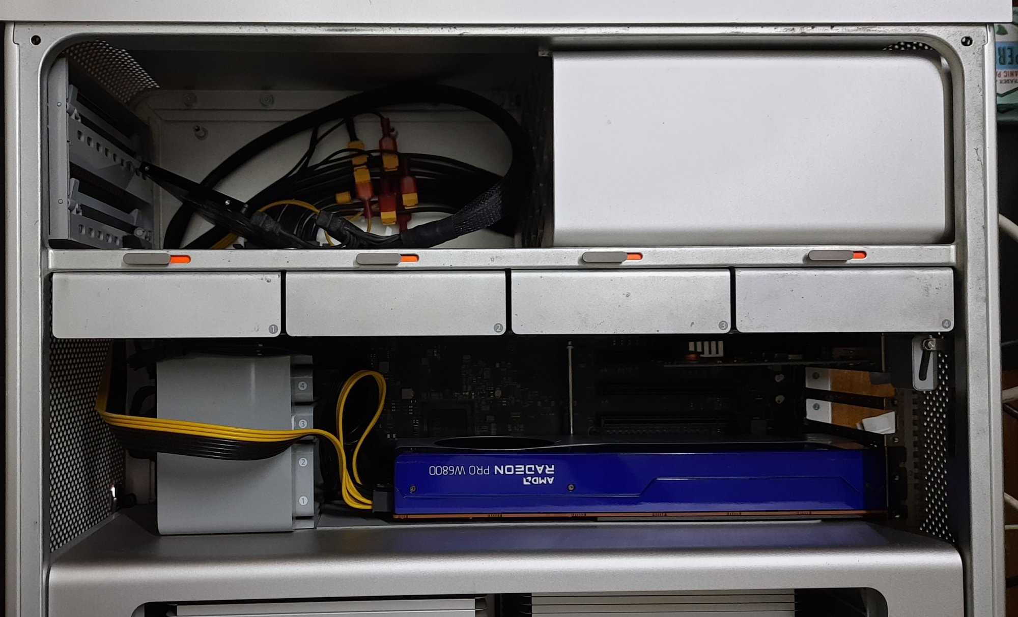

Attached is a patched version of the W6800 reference BIOS from TechPowerUp.com - if your card uses a different version, dump the ROM and PM it to me, and I'll have a look when I get back from holiday. IMPORTANT NOTE: I do not own a W6800, so the attached ROM has not been tested - whoever tries this is the guinea pig for this ROM. (That said, the patch is basically identical to the earlier ones, so it seems likely it should work without issues.)
SUCCESS!!!!
The W6800 is working perfectly in my MacPro 5,1 (mid-2012) after flashing @Syncretic's patched ROM onto it.
As indicated earlier, to get the x6xxx series cards to work natively after flashing their ROMs using the patcher, the minimum needed:
macOS BigSur (or higher) along with Open Core.
I am using Monterey & Martin Lo's 0.8.0 Open Core build.

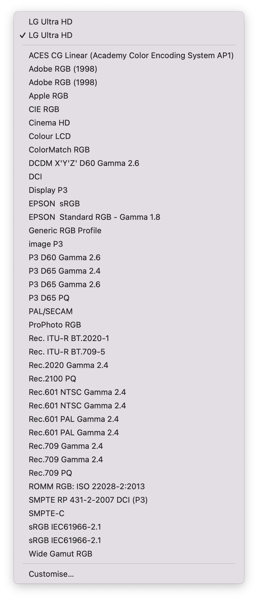

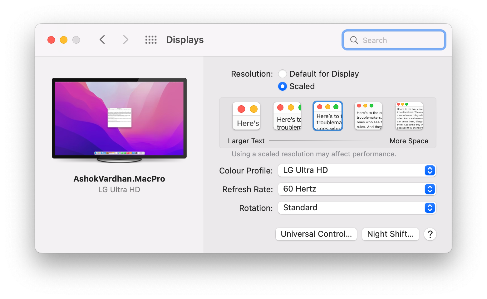

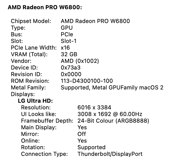

the 6x displayport config of that card is kinda hot... can you get it to full 10 bit colour (ARGB2101010)?
What I have typically seen is that, that is a function that depends more on the monitor (for a card that is capable enough--which the W6800 most definitely is).
Currently, I am not using a monitor setup that will make the most optimal use of the card (usually HDR monitors are fairly expensive, some of my color-correction friends use them, my plan was to go for that upgrade next, when I have the budget for it) however, I am making do with a basic UHD monitor from LG.
This according to the AMD marketing information "Even if you want to use 10bit for truer colors" :
The cameras that I use can shoot 10bit and 12bit, but I doubt my monitor can view that level of footage accurately.
These are the options that are possible on my GPU (whether the monitor support them is a different issue):
Use AllRez to list display modes. For Intel Macs, each display mode will include color info such as depth (8,10,12 bpc), pixel encoding (RGB/444/422/420), dynamic range (HDR10/SDR/Dolby Normal/Dolby Tunnel), etc. The Colour Profiles are something else. I'm not sure they affect the display modes but you can try comparing the output of AllRez between REC.2020 and Rec.709 for example since the display modes do have a colorimetry setting (NativeRGB/sRGB/DCIP3/AdobeRGB/xvYCC/WGRGB/BT601/BT709/BT2020/BT2100).

SUCCESS!!!!
Excellent! It’s a fine card.
You now have one of the highest spec 5,1 machines here. :) And look inside, it doesn’t grab all of your PCI slots.
