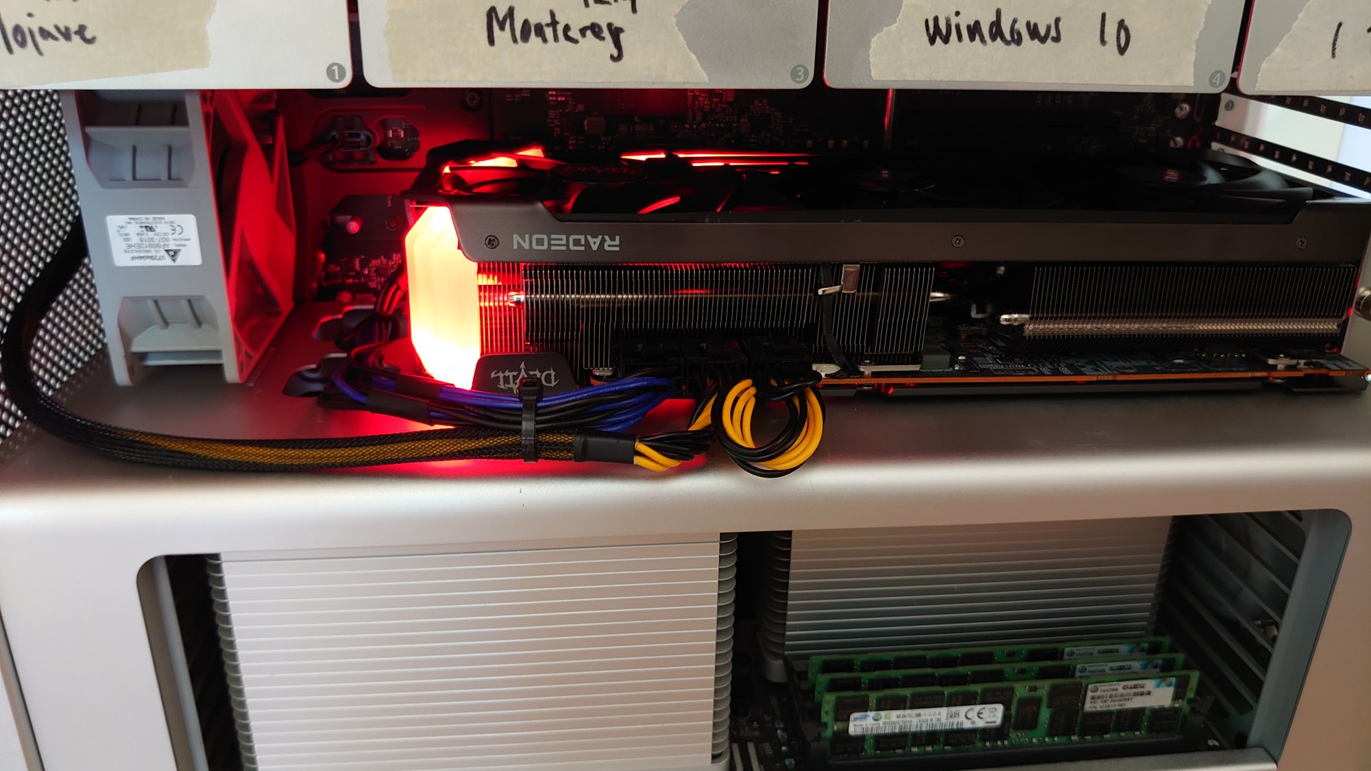

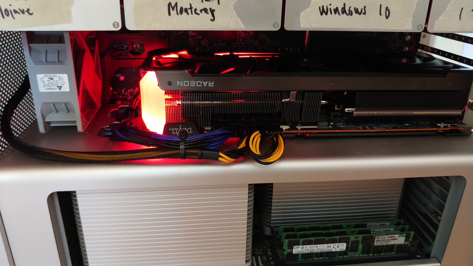

Happy to report my Powercolor 6900 XT Red Devil Ultimate is up and running in Monterey 12.4 on my 5,1. Doing some tests now but everything appears to work correctly.
Big thanks to @Syncretic and also @tsialex for pointing me in the right direction (6900 XT cards with XTXH like mine are not supported in Mac OS).
I tried spoofing the card in OC at first but wasn't successful. What I did then was to flash the normal (non-XTXH) and patched Red Devil bios to the "silent" bios switch of the card using my Ubuntu server. That way the card boots fine in Monterey and Windows 10 using the silent bios/switch as well as both switch positions in Windows 10. This will suit me fine until if/when these cards are natively supported.

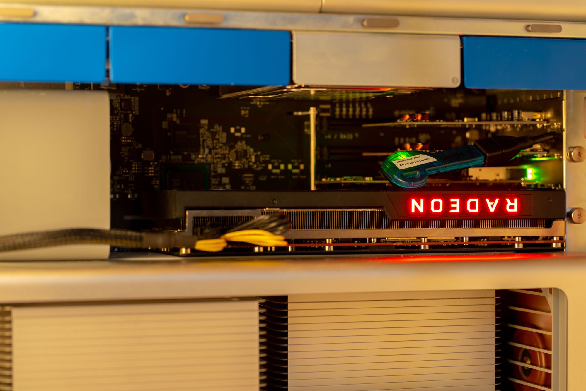

Card was too long to fit but I've made a PCI fan mount you can 3D print yourself for free, you can read more here:
