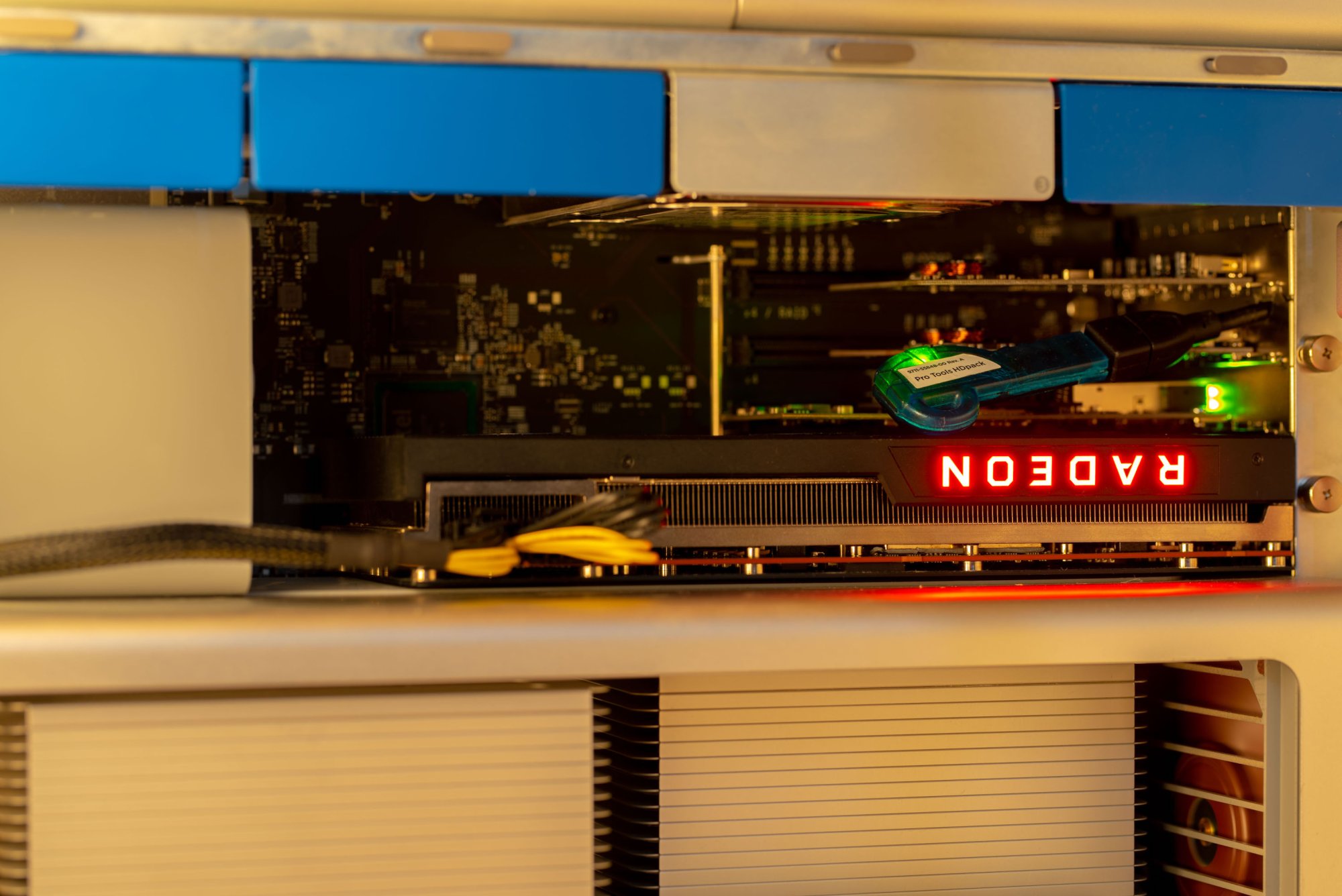

Since I haven't seen it mentioned in this thread at least. For those complaining about the size of these cards, I got my hands on a Dell (Alienware) 6800 XT, and thanks to @Syncretic it's working perfectly, at least for my use cases. 2-slot, and doesn't require a PCI fan mod. Still wish MFC could react to the GPU temps, but according to RadeonGadget, this thing seems to run cooler than my reference RX580 while dancing on its grave.
Nice find! So you can only get it when someone pulls it from there Alienware computer and sells it on eBay?
Awesome! Been following this thread on and off trying to decide if I revive my old 5.1. Had lightly contemplated the idea of installing one of the 2 slot water cooled cards, but only as far as looking at prices, not whether it would even be viable. Have just ordered one of these Alienware cards, cheers!

FYI: The the Alienware card, I used one of my Windows PC's to flash the GPU using the "Dell" ROM, in the "All6800Patched.zip" package @Syncretic posted in post #909 (it matched my ROM exactly, but do check yours first to be safe). I used the Windows amdvbflash program.

Since I haven't seen it mentioned in this thread at least. For those complaining about the size of these cards, I got my hands on a Dell (Alienware) 6800 XT...
Nice find! The PCB markings look like this card is made my MSI.
The backplate screws also seem to match other MSI cards. It just has a thinner heatsink and fans.
It might be similar to what MSI did with the RX 580 mini; that card appeared to be the same board as their Reference Model a with different heatsink configuration.
Reactions: splifingate
