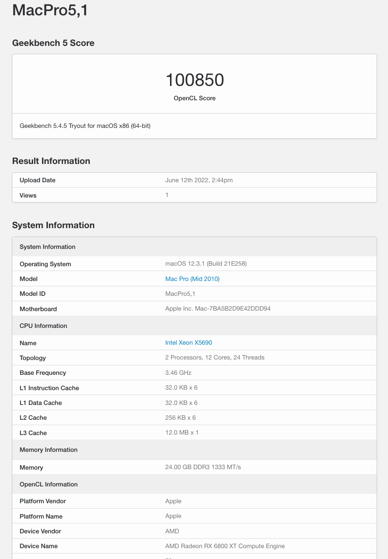

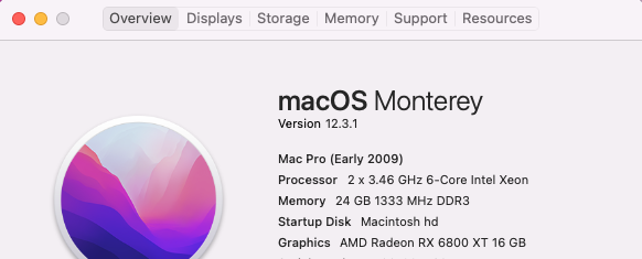

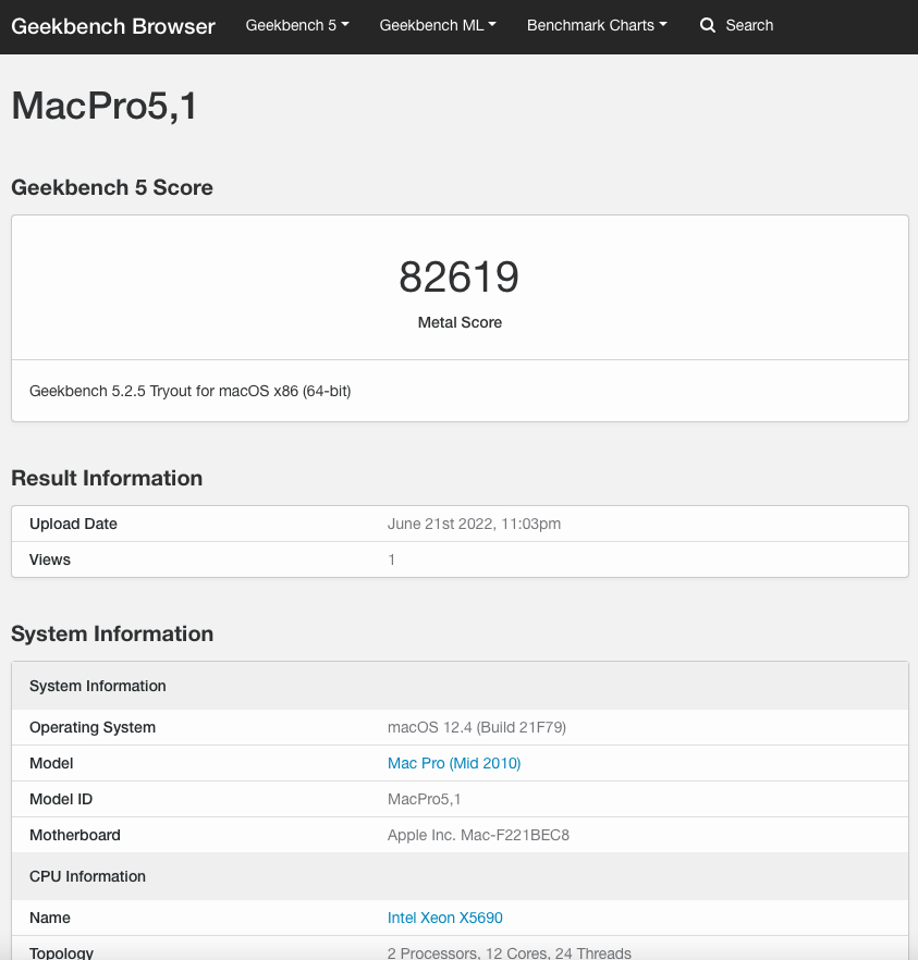

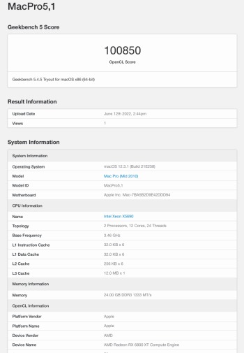

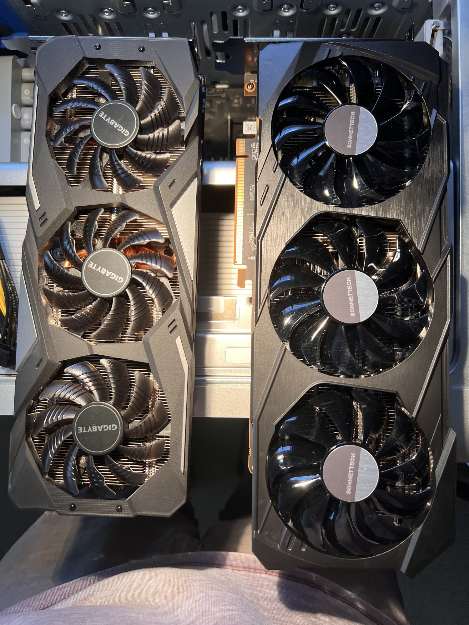

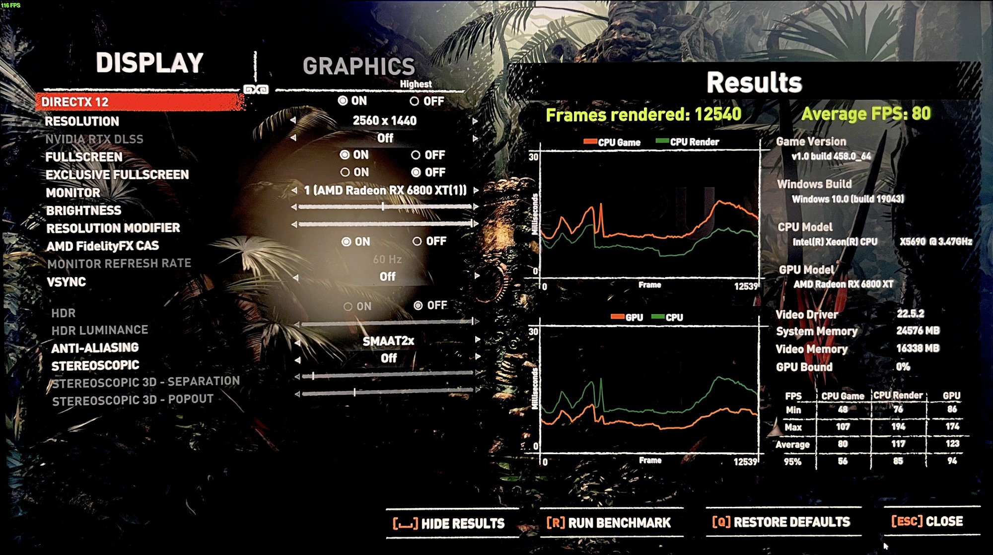

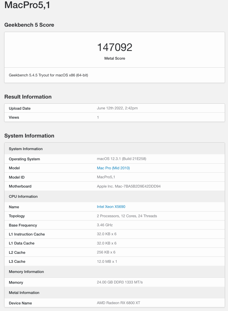

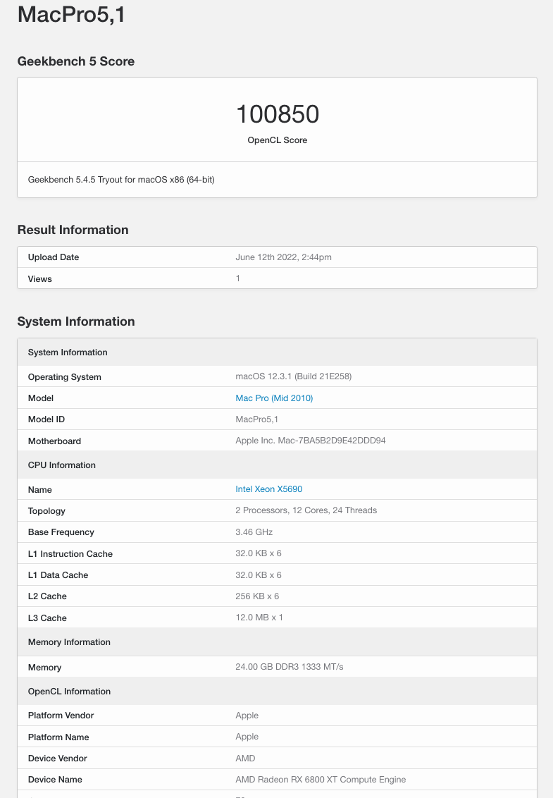

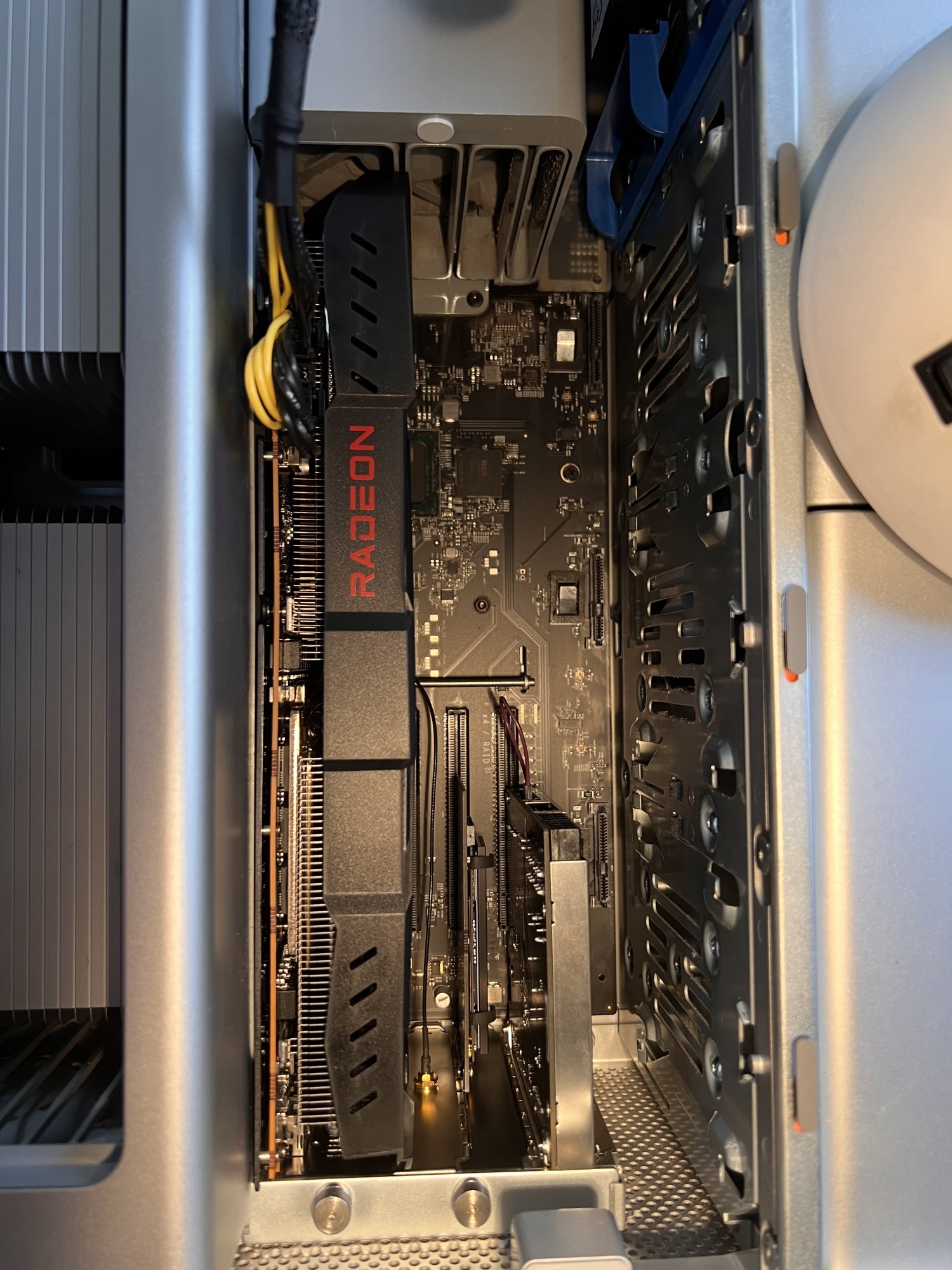

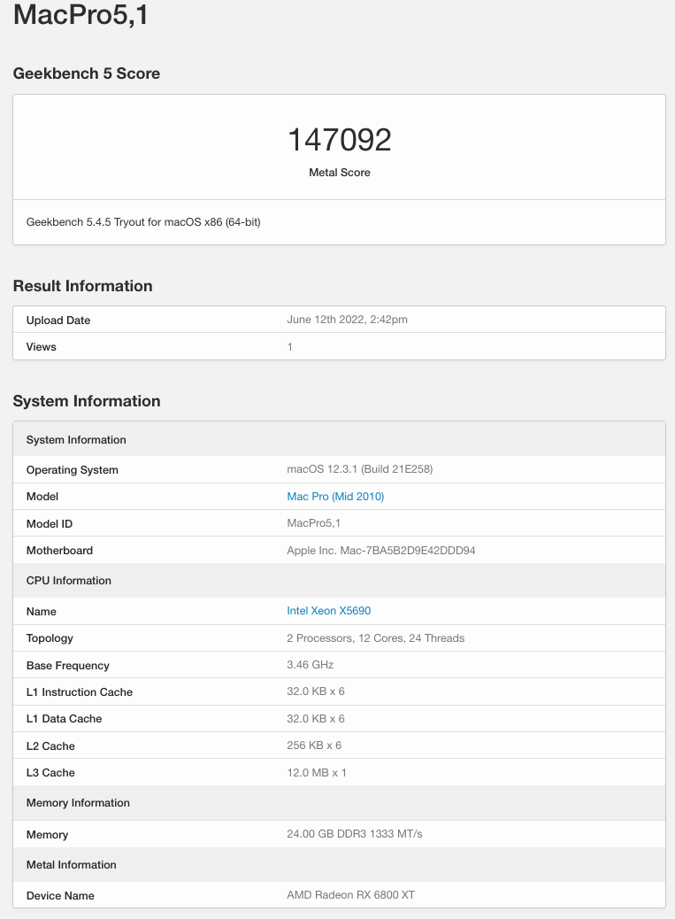

Thank you! @Syncretic You Rock! I have succesfully patched a Sonnet RX6800XT https://amzn.to/3MHAb3g after doing the Pixlas Mod. Installed it today after a late night doing the mod. My 5,1 lives to fight yet another year! Is there a link so I can donate and add to my videos?

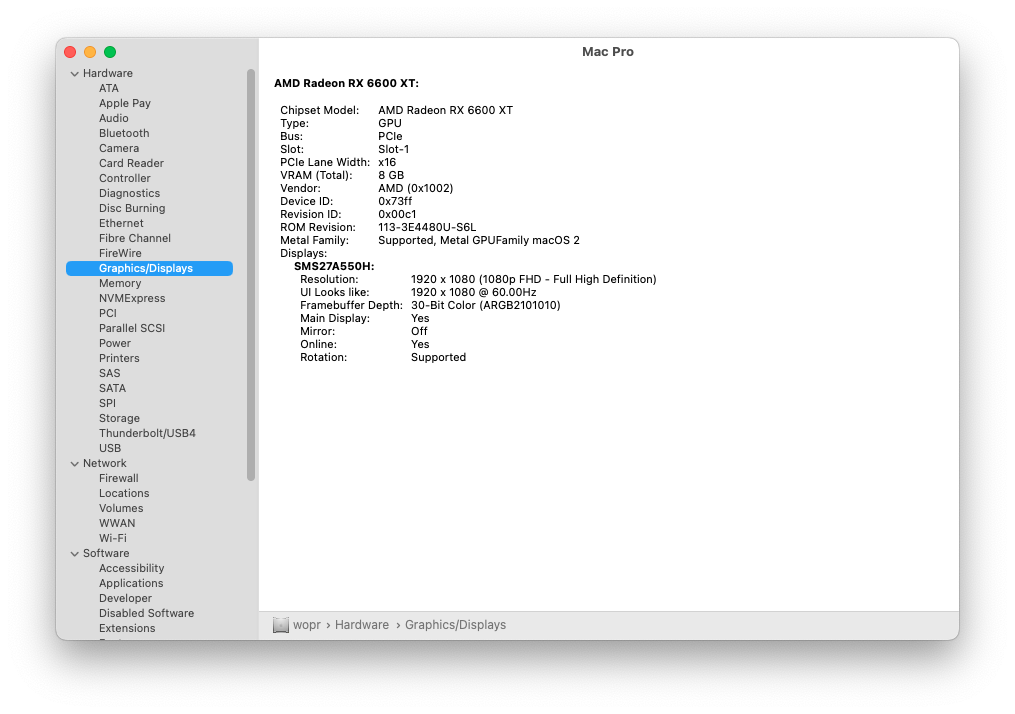

I finished purchasing a XFX 6600 XT (SWFT 210), followed the instructions and now it flawlessly works on my cMP 5.1. Now, how can I reliably test its performance? BTW I attached a 2010 27" iMac via display port and it works perfectly as an external display! Monterey on cMP and High Sierra on iMac
Luxmark scores usually quite stable. There, it can help to check if your card is performing reliably.

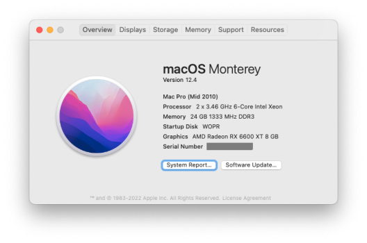

Huge thanks to @Syncretic for the patch! I just updated my 2010 cMP to Monterey and a Sapphire Pulse 6600XT (11309-03-20G). It seems to be working great. The Geekbench Metal results are over 8x the GTX780 I replaced.
No real issues with the update/upgrade, except for the typical RTFM ones. 😉 I used my original ATI 5870 to have the boot screen when I did the OCLP macOS bump, then reverted the root patches to get the GPU acceleration working. The 6600XT BIOS patch was cake on a Windows machine. Also, no power mod is needed for this card. For now, I'm just using the 2x6-pin to 8-pin adapter I used on my 780. I have a 2x mini to 8-pin around here somewhere...

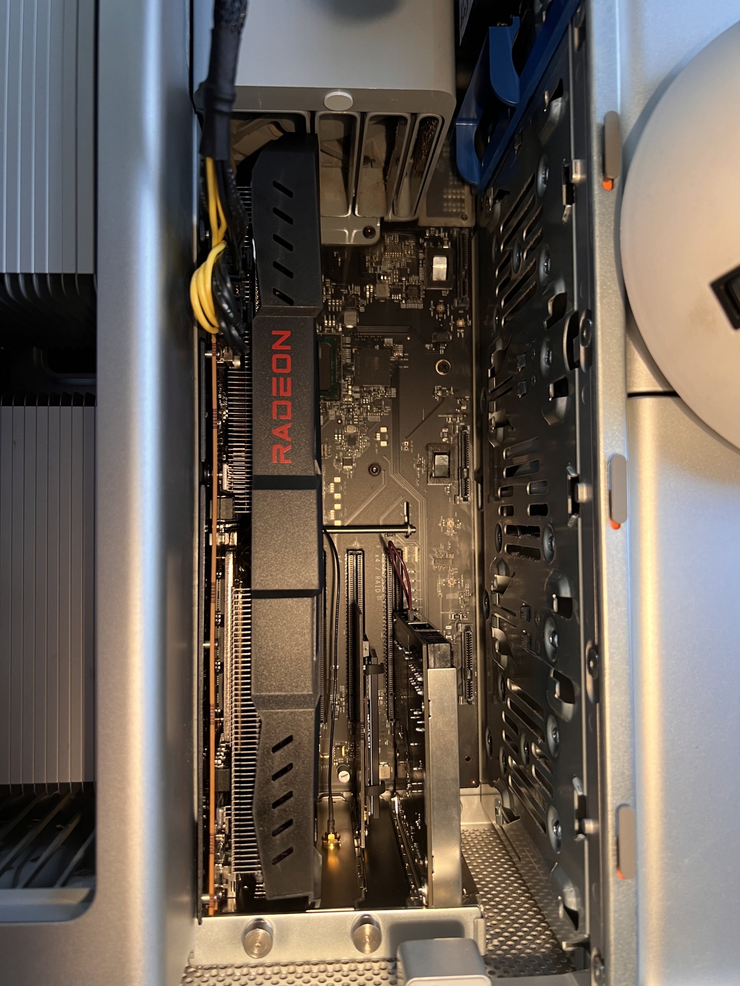

Just curious, is the Gigabyte 6900 XT the only 6900 XT card that fits in the 5,1 without removing the side blowing fan? Most seem to be 320 mm or so while the Gigabyte is only 286 mm.

The Gigabyte 6900xt is one of the only cards that fits in the 7.1 mac pro also. I have a sapphire 6900xt which would not fit inside, 320mm long. but have to say the gigabyte card works well. The reference AMD 6900xt also fits inside, both cards are 2.5 slot though, so in a mac pro 5.1 swallow up 3 pcie slots.
