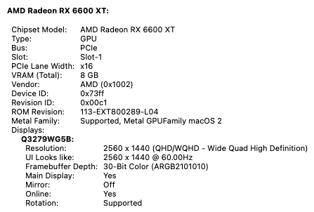

After upgrading to Monterey(12.4), my ASRock Challenger D Radeon RX 6600 XT 8GB is recognized now!
Straight Martion Lo 0.8.0!
This is Great!!! Thanks!!!

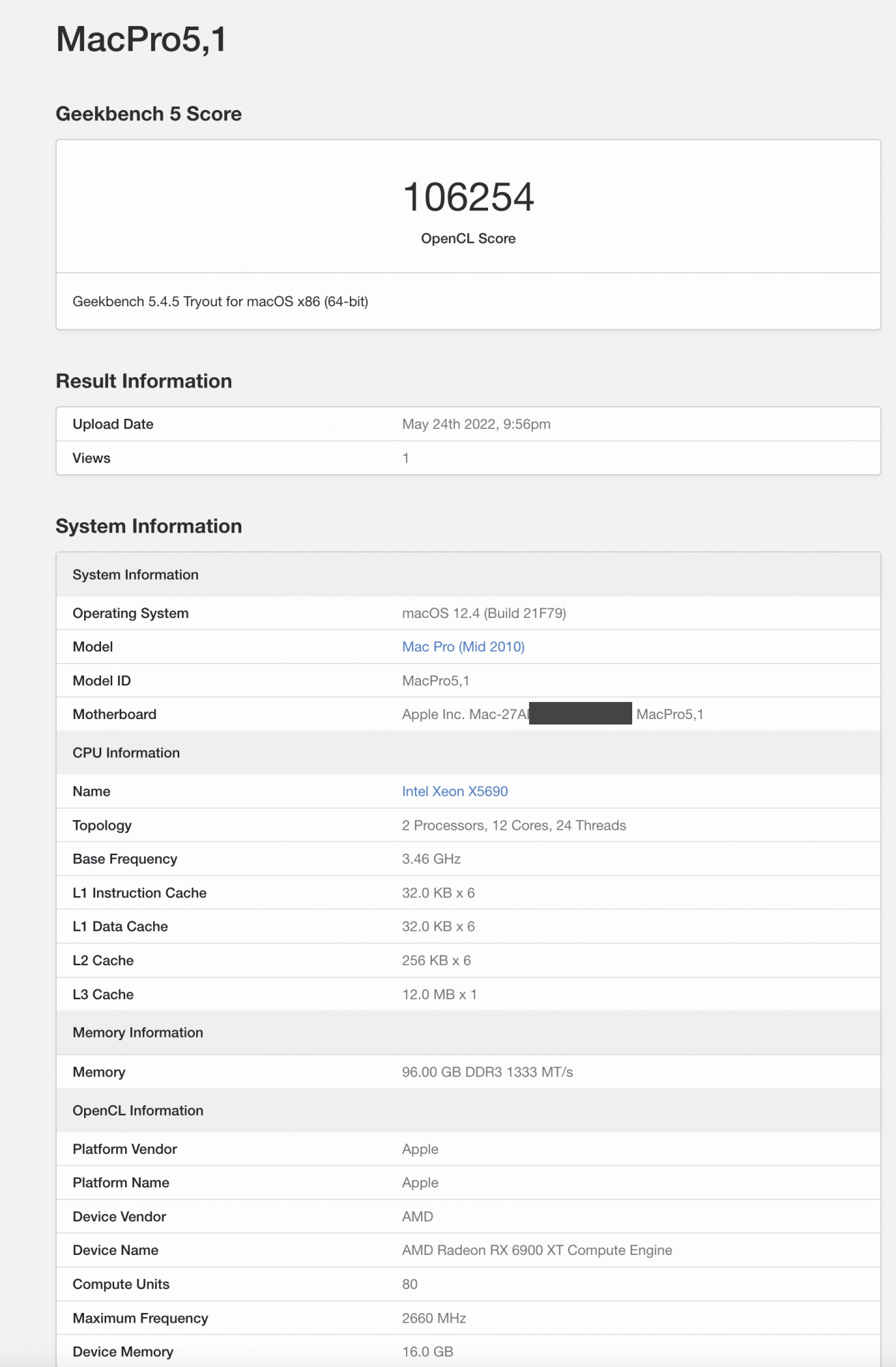

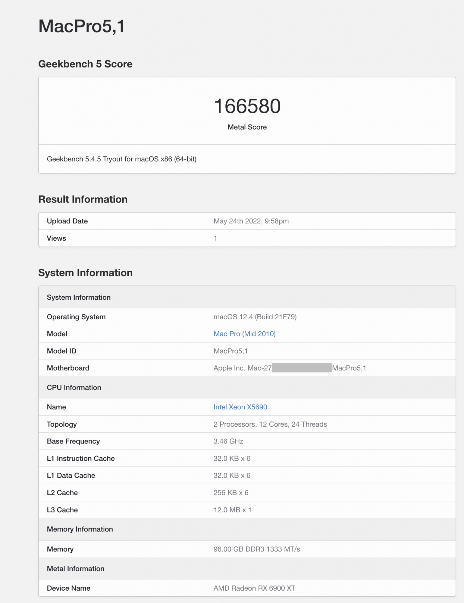

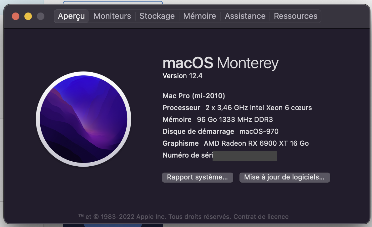

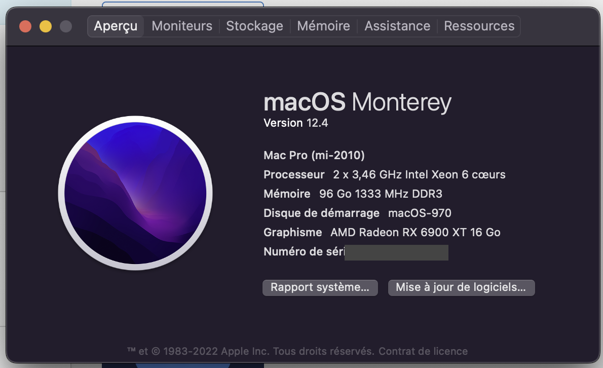

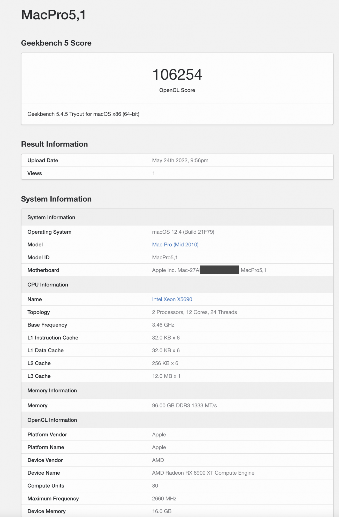

Hello,
Just to share some results regarding a RX 6900 XT Reference Design in a MP 5.1 2010 2x3.46, freshly flashed with Syncretic patch :
Incredible results for such an old computer !
Of course Pixlas mod mandatory.
Just one drawback, it seems the card do not POST anymore on a recent UEFI PC, but absolutley no issues to boot with Open Core to macOS or Windows.
Again, many thanks to Syncretic for this small miracle (I really though my Mac Pro was at the end of the road with the RX 5700 XT).
