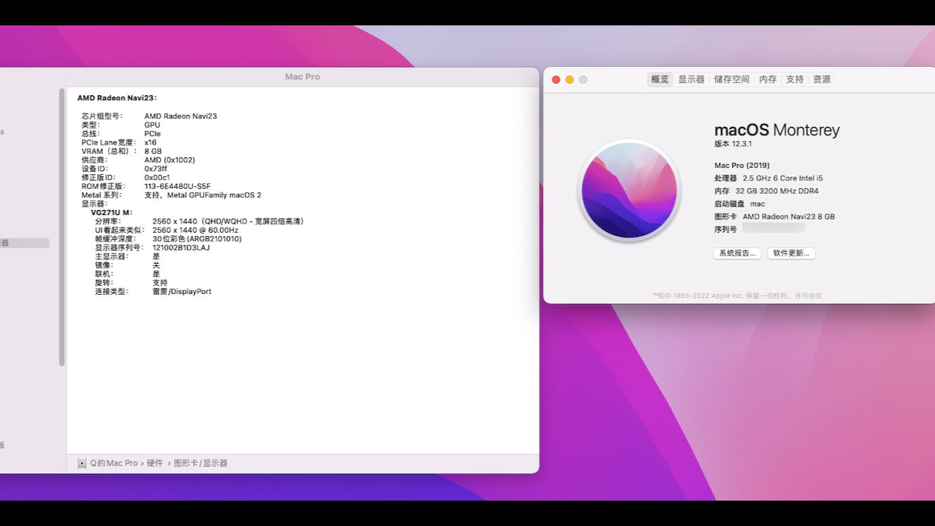

Just to share some results regarding a RX 6900 XT Reference Design in a MP 5.1 2010 2x3.46, freshly flashed with Syncretic patch :
Incredible results for such an old computer !
Of course Pixlas mod mandatory.

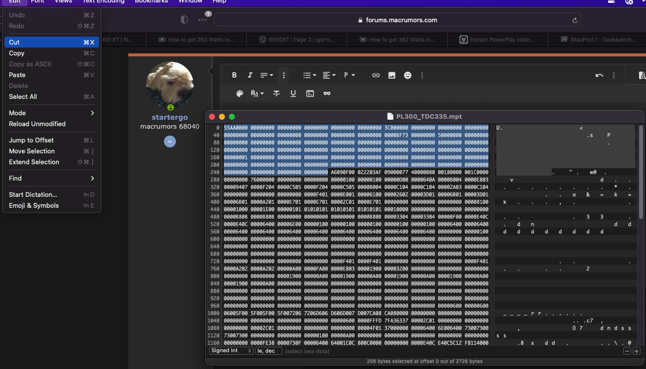

Edit 05/26/2022:
You can modify the PPsoft table in Windows with MorePowerTool
Save the edits in .mpt file
delete the bytes in the MPT file upto A609:
And you have a modified table extracted.pp_table ready to be applied using the script to SSDT.

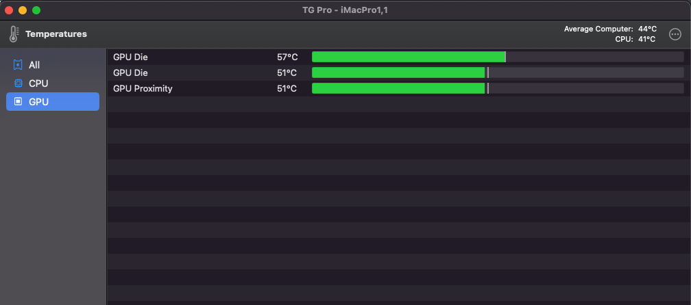

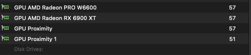

A little bit convoluted, but here are the Radeon temperatures in MFC:
Using:
https://github.com/aluveitie/RadeonSensor. Radeon Sensor app readings:
Look at the GPU Proximity temps above:

[2022-05-26 18:14:15:468] [thread 8670] [Provider_mac.mm#351] addGPU AMD Radeon RX 6900 XT with MTLDevice
[2022-05-26 18:14:15:468] [thread 8670] [Provider_mac.mm#22] Device hold AMD Radeon RX 6900 XT
[2022-05-26 18:14:15:471] [thread 8670] [Provider_mac.mm#351] addGPU AMD Radeon PRO W6600 with MTLDevice
[2022-05-26 18:14:15:471] [thread 8670] [Provider_mac.mm#22] Device hold AMD Radeon PRO W6600
[2022-05-26 18:14:15:471] [thread 8670] [Provider_mac_watcher.mm#82] eGPUWatcher started
[2022-05-26 18:14:15:471] [thread 8670] [TempSensorGPU.cpp#92] Discrete GPU: GPU AMD Radeon RX 6900 XT, matching SMC - yes
[2022-05-26 18:14:15:471] [thread 8670] [TempSensorGPU.cpp#92] Discrete GPU: GPU AMD Radeon PRO W6600, matching SMC - yes
[2022-05-26 18:14:15:497] [thread 8670] [TempSensorProvider.cpp#132] InitialLoadThread: number of supported GPU sensors: 2
TG Pro temperatures:

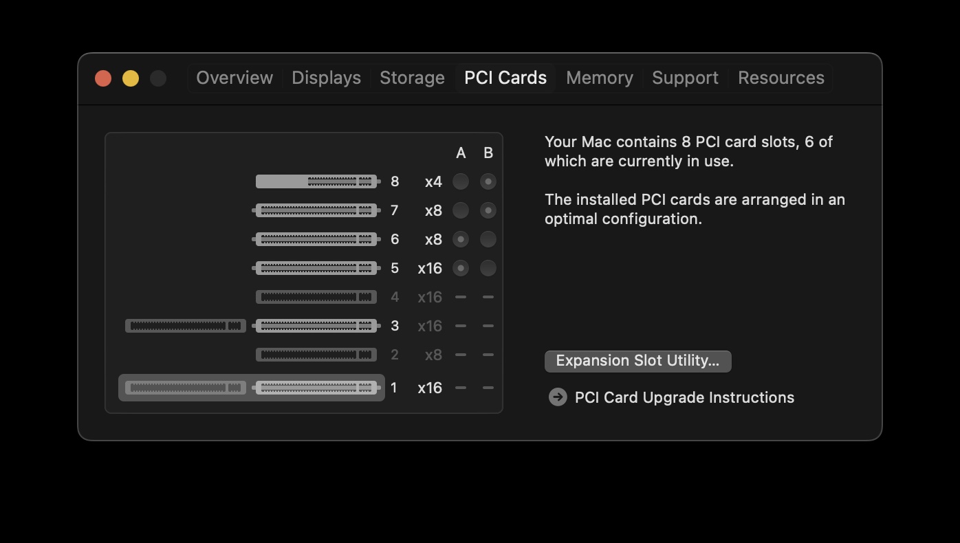

Now that we're talking about space:
Does the 6800 XT fit together with a highpoint/sonnet x16 SSD card? I get the 6800 XT is a 2-2.5 slot card, but do you lose one of the x4 PCI?
Or can you only install the GPU in slot 1 and lose the 2nd x16 PCI?
That's the only thing I haven't figured out from the photos.

I would advice you to open the MacPro and do a check to be sure. That being said you can see my setup in the screencap. Slot 1 has the 580X (which I'll remove eventually) and Slot 3 the 6900XT, they each cover the PCI slot beside it, so they effectively use 2 PCI slots each. 5,6,7 have a NVM PCI card. And slot 8 is the IO card.
Slots 1-4 are double width slots, so if the card in slots 1-3 covers the next PCIE slot in reality it is a 3-slot card (which it is).
My bad, I didn't clarify. I was talking about a 5.1. The plan is to get parts that I could transfer to a 7.1 later. My hope is that the new Mac Pro will be so good that everyone will want to upgrade and the price of the 7.1s will fall.
