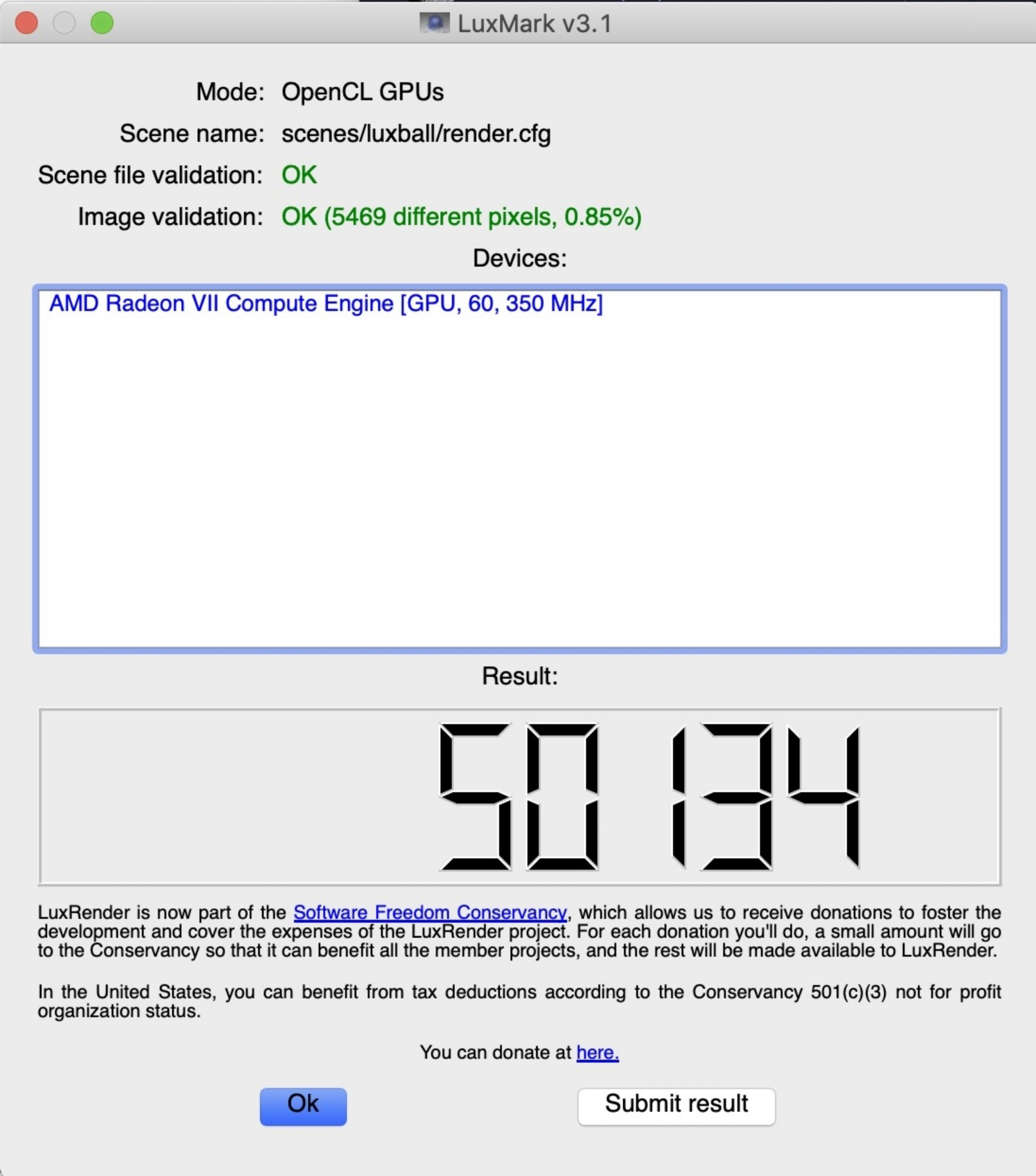

Any good?

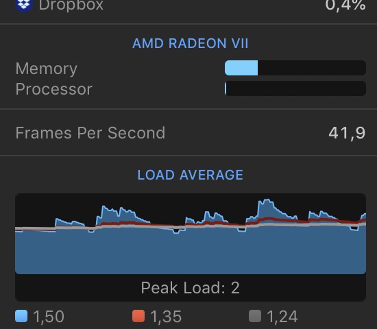

Does your Radeon VII show it's temps and clocks in OS properly? Mine does not.

Any good?
Consistent, a single VII scored ~50960 on OSX.
Windows top score is 66258 for a single VII, topping the charts. Consider removing power containment, etc if it exists for the VII, not sure if it exists, but seeing a 30% improvement on Win, I’m sure you can improve powerdraw and increase your results.

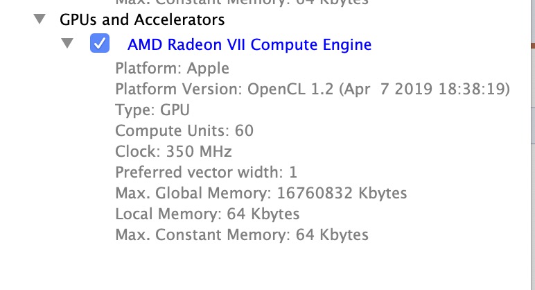

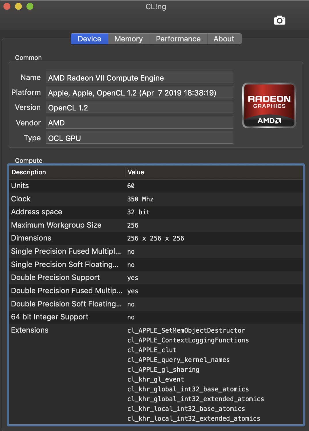

Thanks Pval. I’m a bit confused with the
Clock speed of 350mhz. One VII is in the chassis and the other is out side on a riser cable. Both are powered by the external power supply. The specs state that its fan will spin when it supplies more than 400 watts. The fan does not spin at any time during luxball.

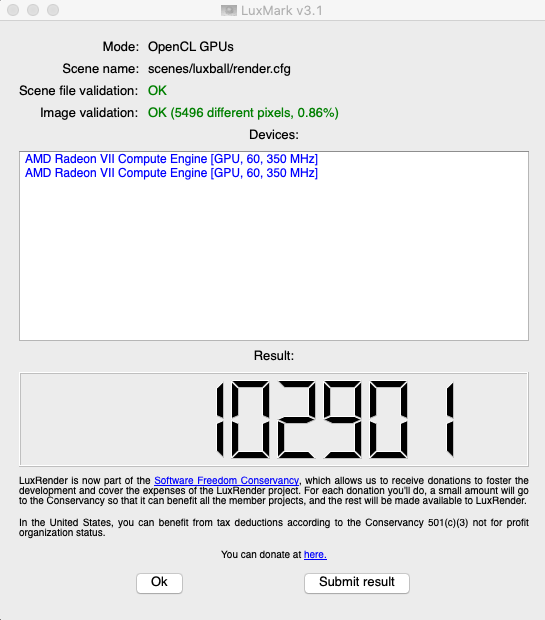

I assume you know that's old result. OP get the Radeon VII working by editing the plist file for Vega 10 or 20.
If you read post #130 and do some simple maths, a single Radon VII now is about 2x faster than your Titan X Pascal in Luxmark.

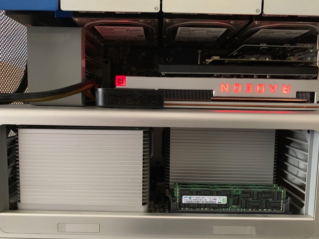

Could you post a picture from your impressive 3XGPU Vega 7 setup. This is.. out of this world. What do you use it for, Resolve, FCPX, Adobe Premiere ?? wow, just wow...
Hi Alex, I use Final cut x but I haven’t gone totally crazy my set up is only 2 GPUs.
Pretty nice setup for a Resolve color grader working on films/shorts in up to 7-8K Raw.
We built a similar setup for a client recently.
