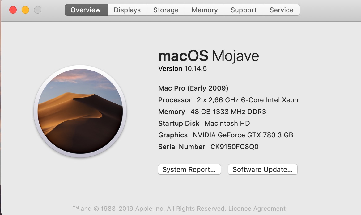

Hallo I have the Mac pro 5.1 2009 cpu i need to upgrade the Mac pro 5.1
i need help please about to build more faster and how to add in my mac pro 5.1 2009 this graphic card and cpu to upgrade 3.46GHz 2x 6-core Intel Xeon
AMD Radeon™ VII
Hallo I have the Mac pro 5.1 2009 cpu i need to upgrade the Mac pro 5.1 View attachment 850169
AMD Radeon™ VII
