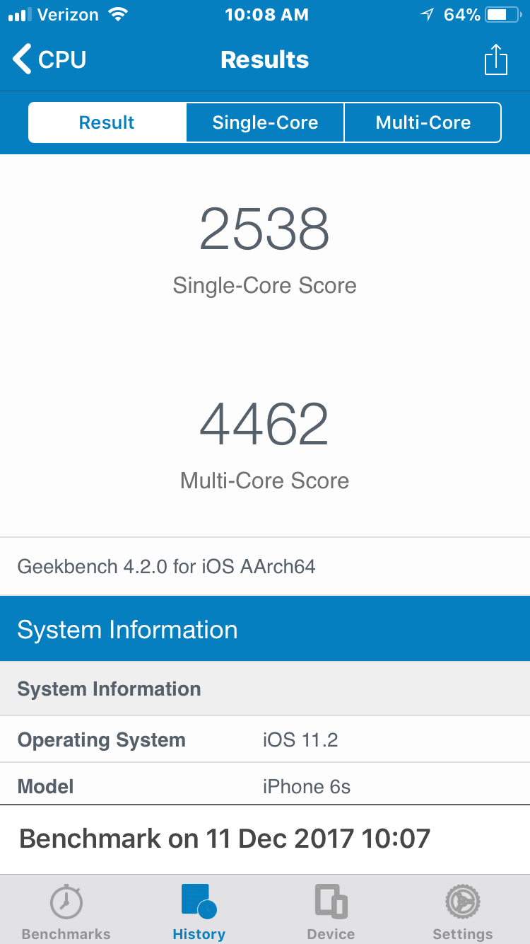

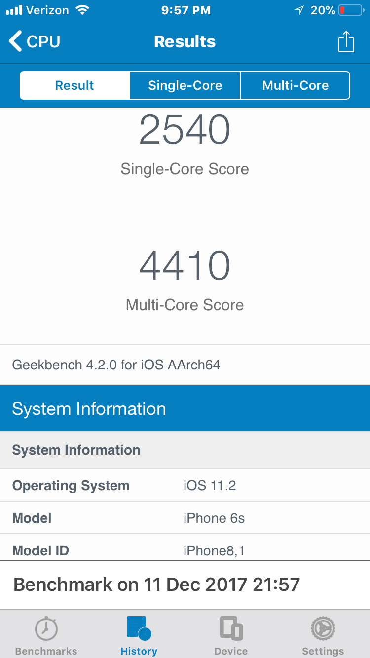

Whatever.....got my battery down to 44% and NO CHANGE in Geekbench scores. Phone is over a year old and I have historically used it a lot. I'll keep running it down to see if anything changes but I seriously doubt it will. So far, debunked.
I don’t buy it either. I have a 2 year old 6S plus with 30% wear and it still gets the same benchmark numbers. There’s got to be something else causing the slowdowns.

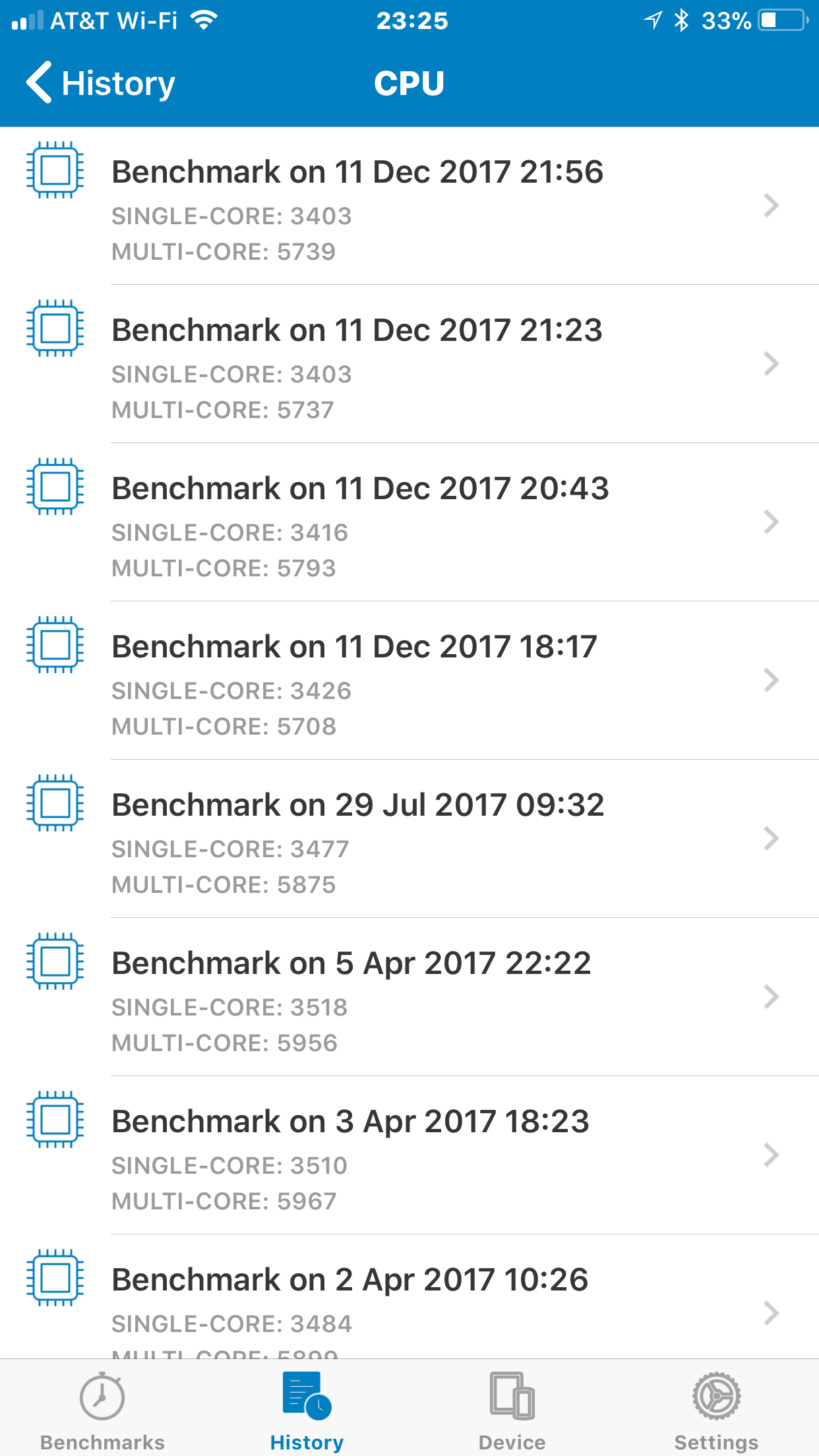

Oh, you want screen shots? See below tough guy - a little extra history too. You think I'm biased, why? I'm asking for scientific proof. The "slowing down the processor with iOS updates" to force people to buy new phones was hilariously debunked through lab testing. Just like this one will be. Well, maybe the 6 series if they have faulty batteries. We'll see.
