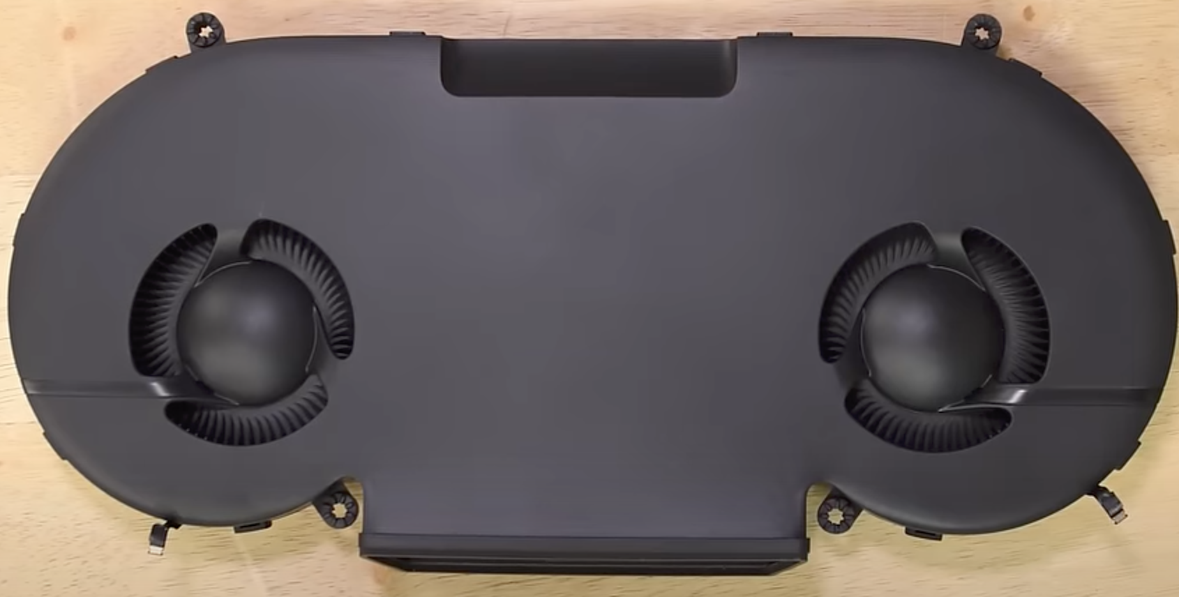

I didn't know that the iMac Pro has dual fans compared single for the iMac 27.

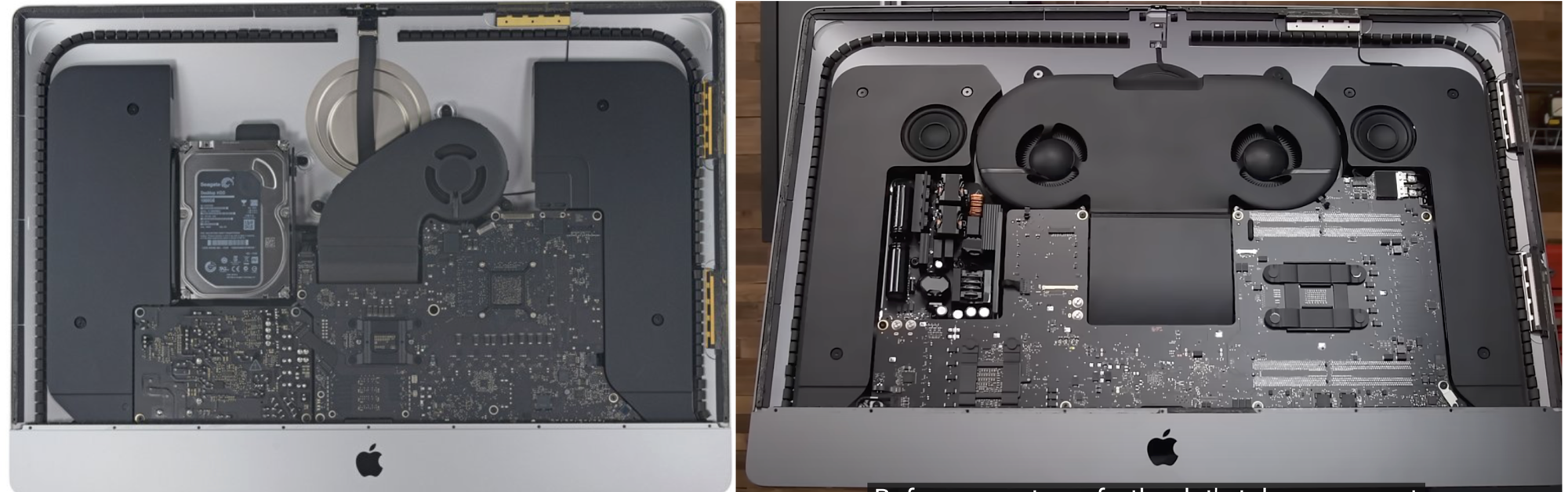

Yeah, that's the key difference between their cooling systems. iMac on L, iMac Pro on R. Note all the empty space in the iMac that could have been used to accommodate dual fans. And it wouldn't need to have been as beefy as that in the iMac Pro, since the latter's max thermal output was 1,262 BTU/h.
Closeup of iMac Pro dual fans:
The iMacs single fan wasn’t the problem.
The iMac Pro has ~4x the heat exchange volume and about 4x the heat pipe cross section - for about +40% more heat dissipation.
To have cooled the iMac properly would have meant moving the RAM away from the CPU, losing the RAM hatch…
