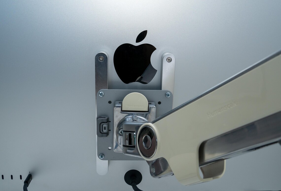

I knew someone would have created an adapter to lower the VESA attachment. Nice, I guess.
